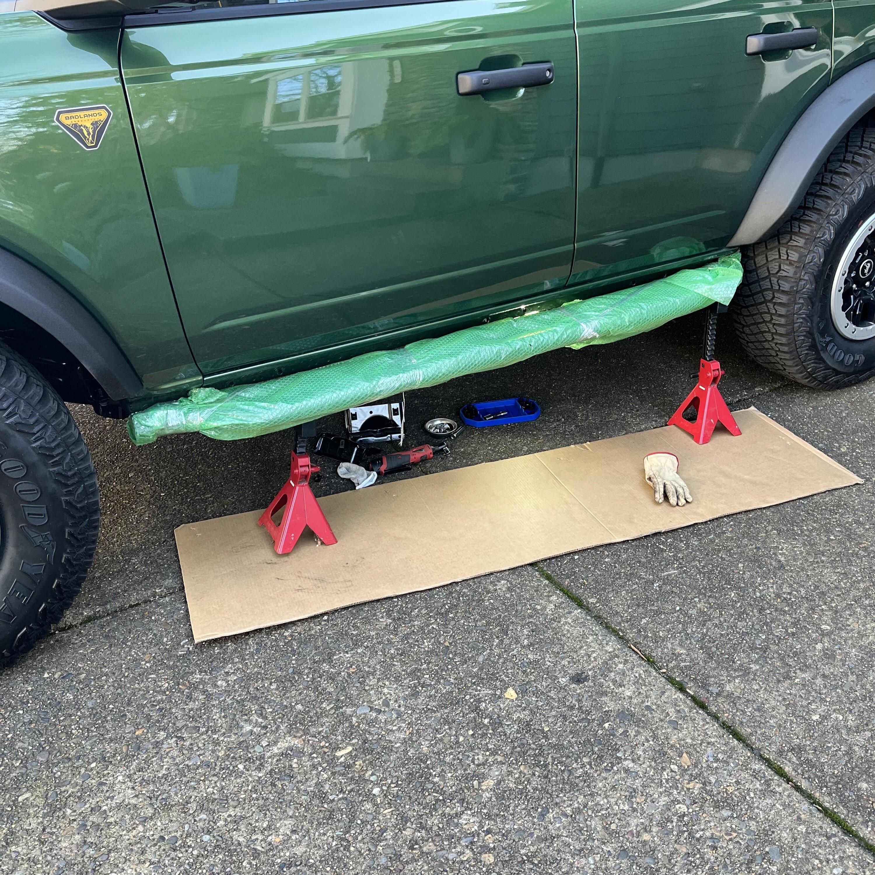

I tried to muscle them up but then I remembered I have a bevy of jack stands...

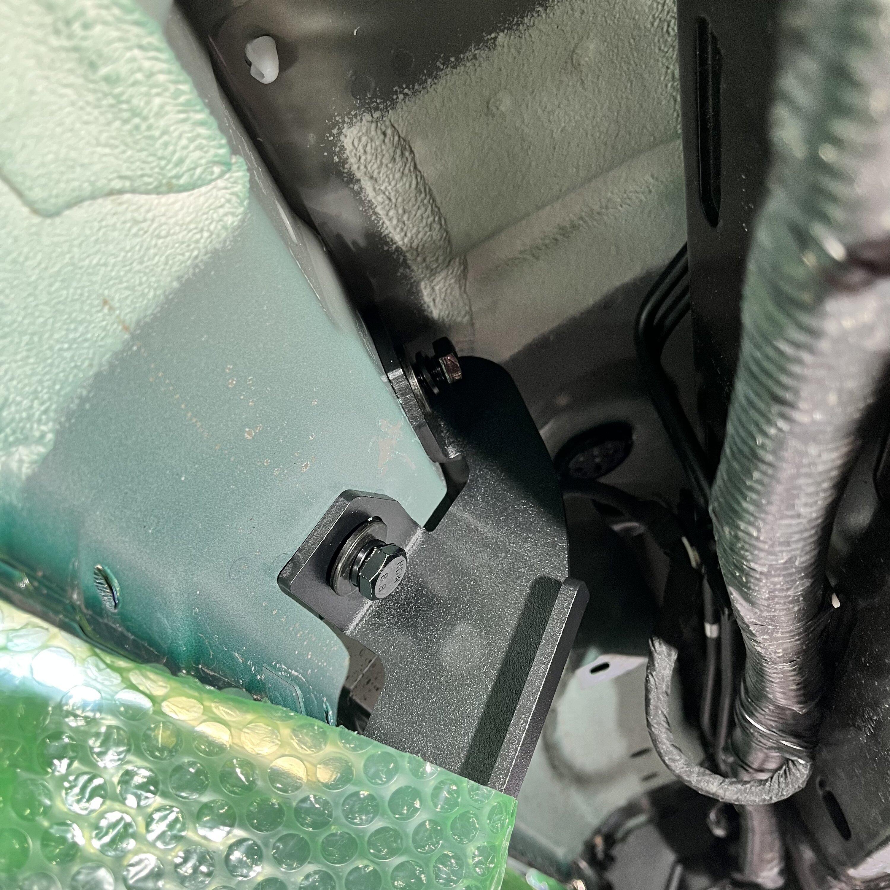

The factory rock sliders come off with a 10mm and 13mm socket. #protip charge your Milwaukee batteries first. You can undo all of the factory hardware and the sliders won't fall on you.

Just getting the sliders up on the jack stands (they don't have to be perfect) allows you to get one bolt in one end and then the other. Then just get the rest started. They didn't have a torque spec so I just cranked down with a ratchet after I spun them on with the power tool.
The Havoc bolts are 16mm.

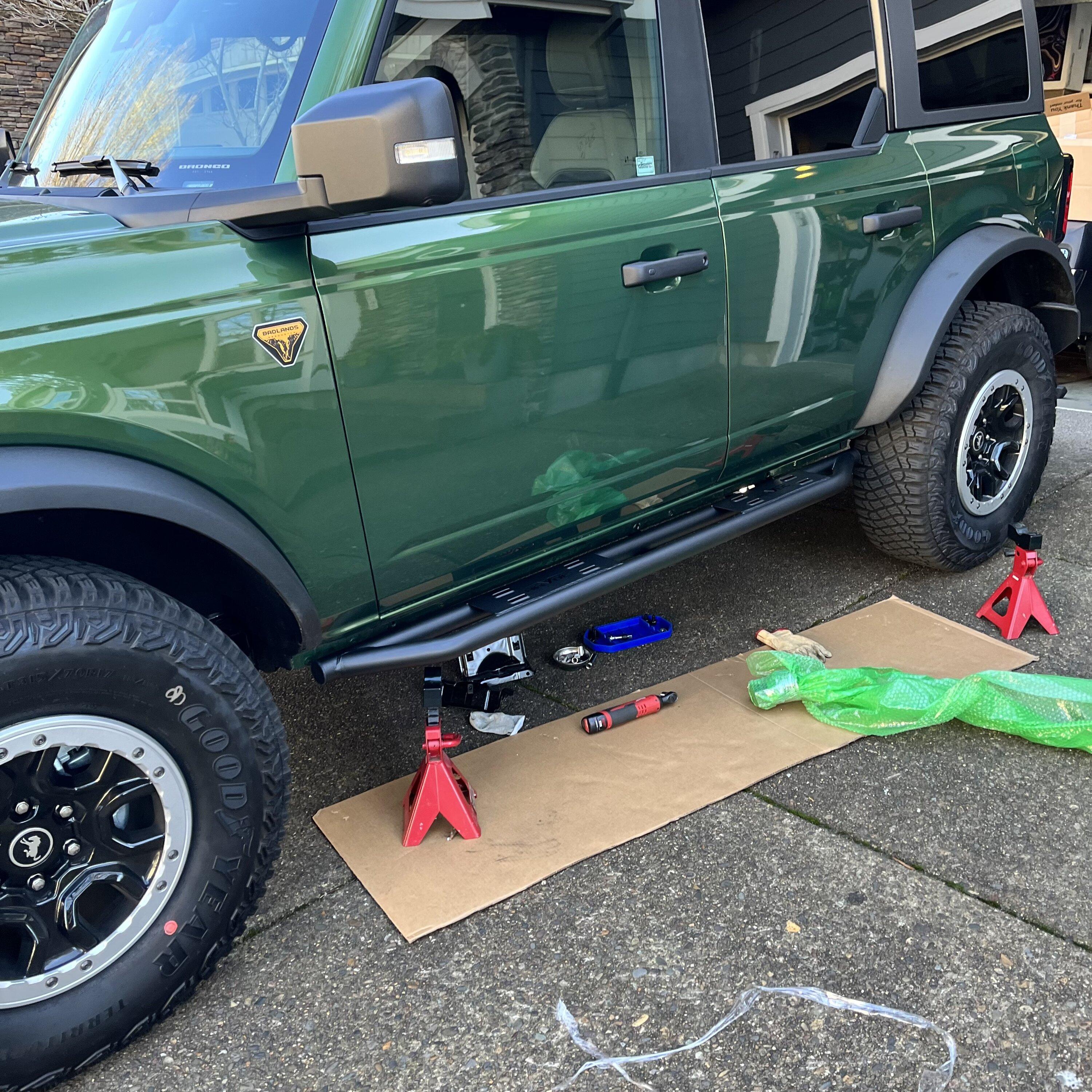

I'm not sure if they are perfectly level but they are on there and I can adjust later. But you can jump on them and nothing moves.

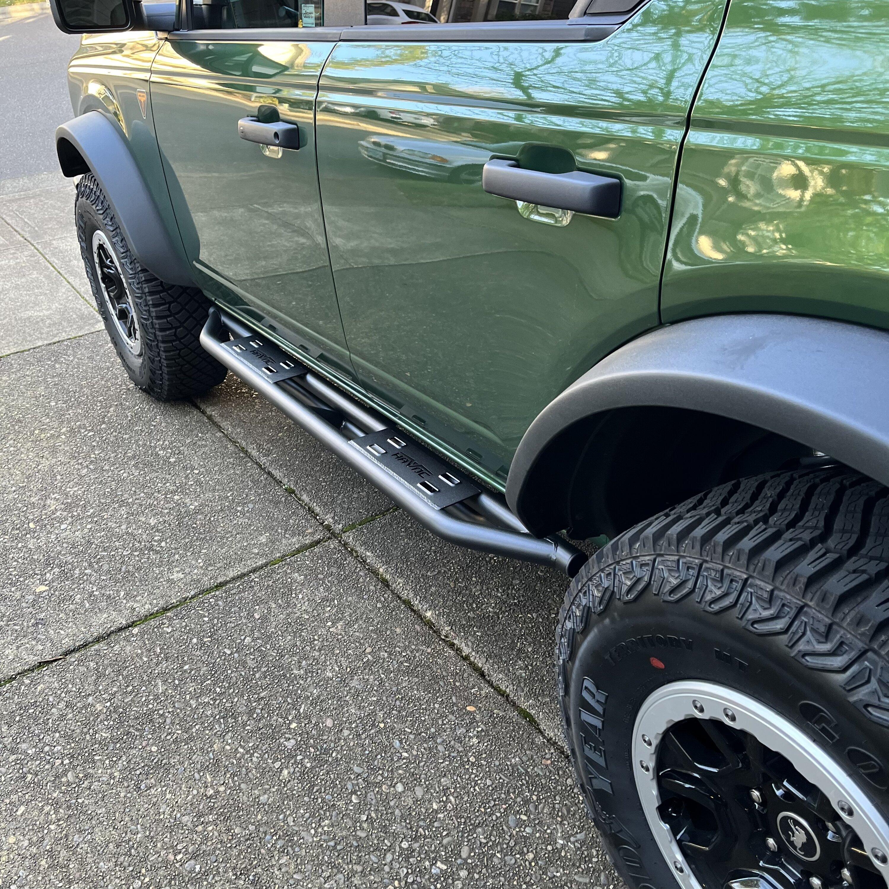

Nice, they should of made the step patch continuous across. If I owned them it would be my luck, go to step off and miss the foot patch and break an angle while my foot is hung up in the tube bars. LOL!

I don't even think my son's size 2Y shoes could do that.
