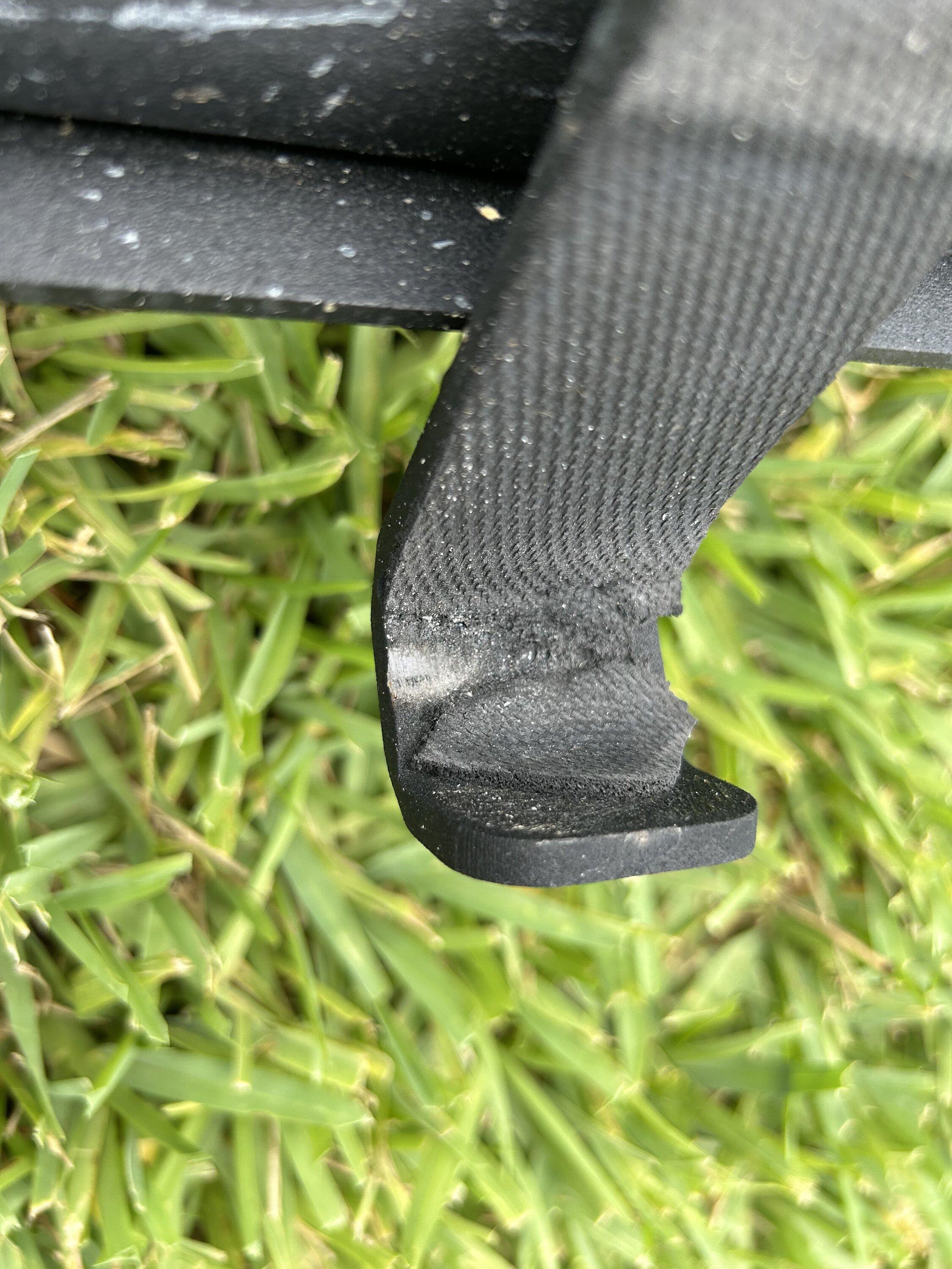

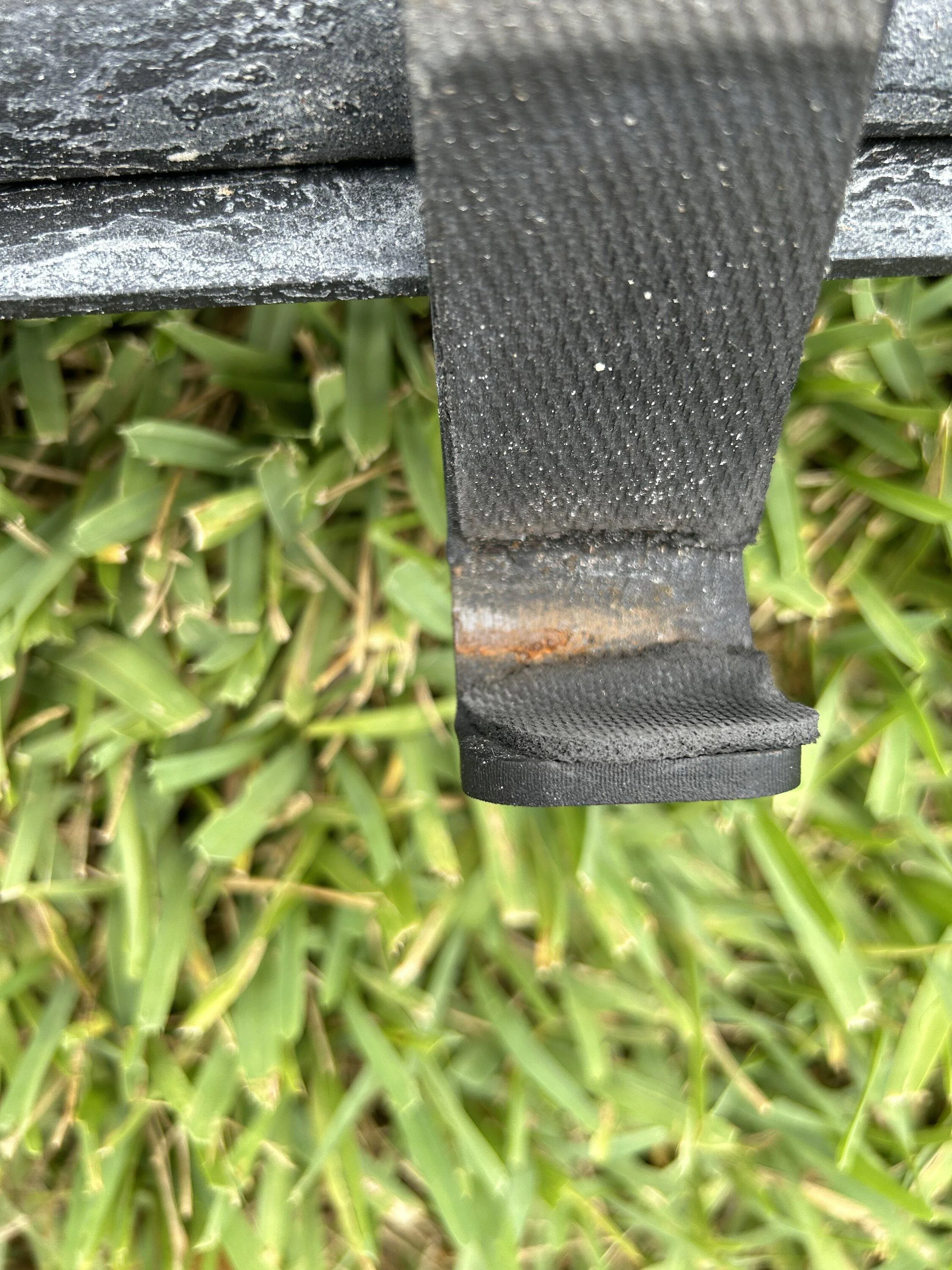

After nearly 2 years and 10 k miles I’m still liking these steps. Finish looks good as new. I started hearing a noise when stepping on them. The rubber insulation between step mount and OEM rock rail wore through. Only the two inner mounts that don’t actually have fasteners on the rail. Not a knock on IAG. I just replaced it with some harder rubber I had laying around. So if they get noisy that is the reason. I will still highly recommend these steps.
