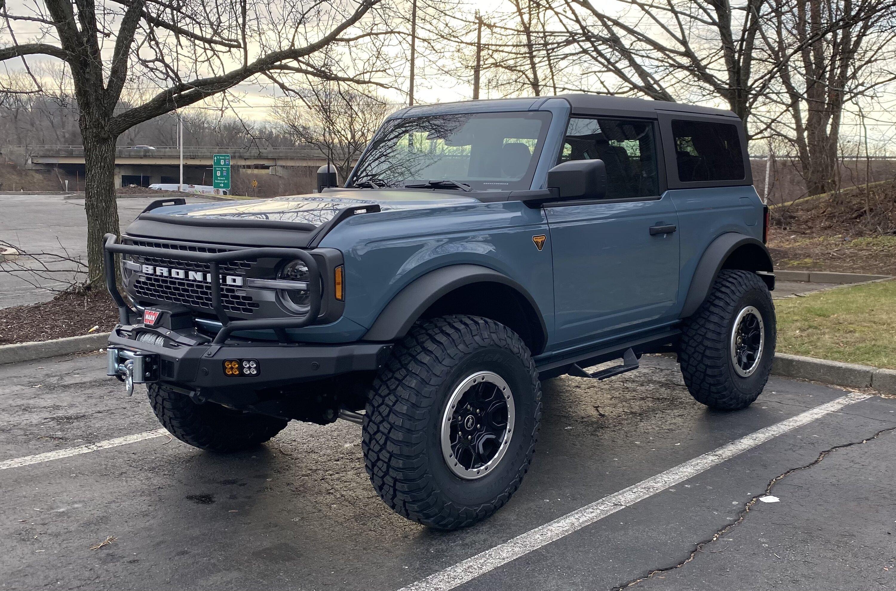

I did mine in my garage. Zone 3”. Not terribly difficult. Took me two days because I also wired and changed out both bumpers, added a winch and added the JKS MaxTire Kit while everything was apart. Of course, you will need a spring compressor if your doing more than just adding the top spacer. You should look up the zone lift instructions online. That will give you a good idea of the work involved.

I did the lift completely by myself (the bumpers too). I have the MaxLider front and rear bumpers.
