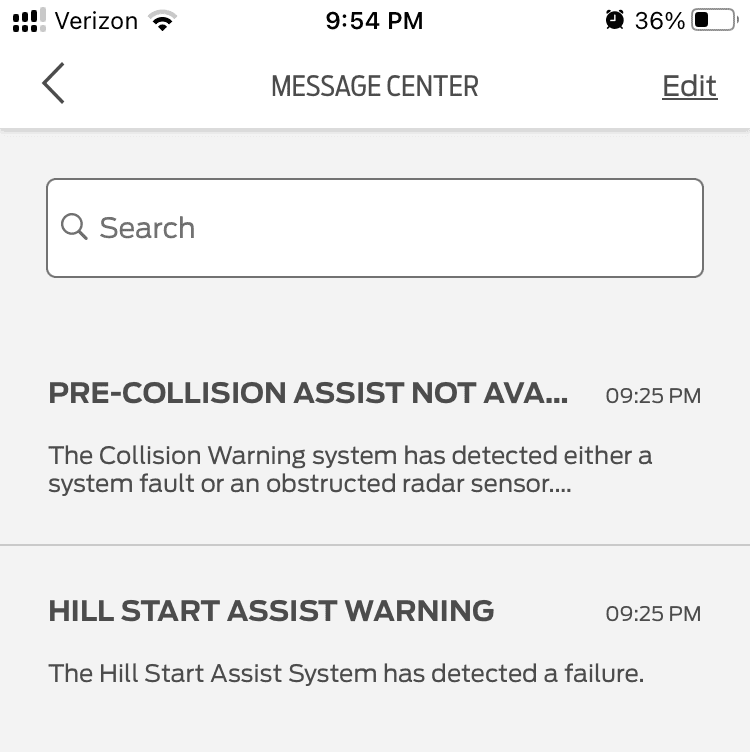

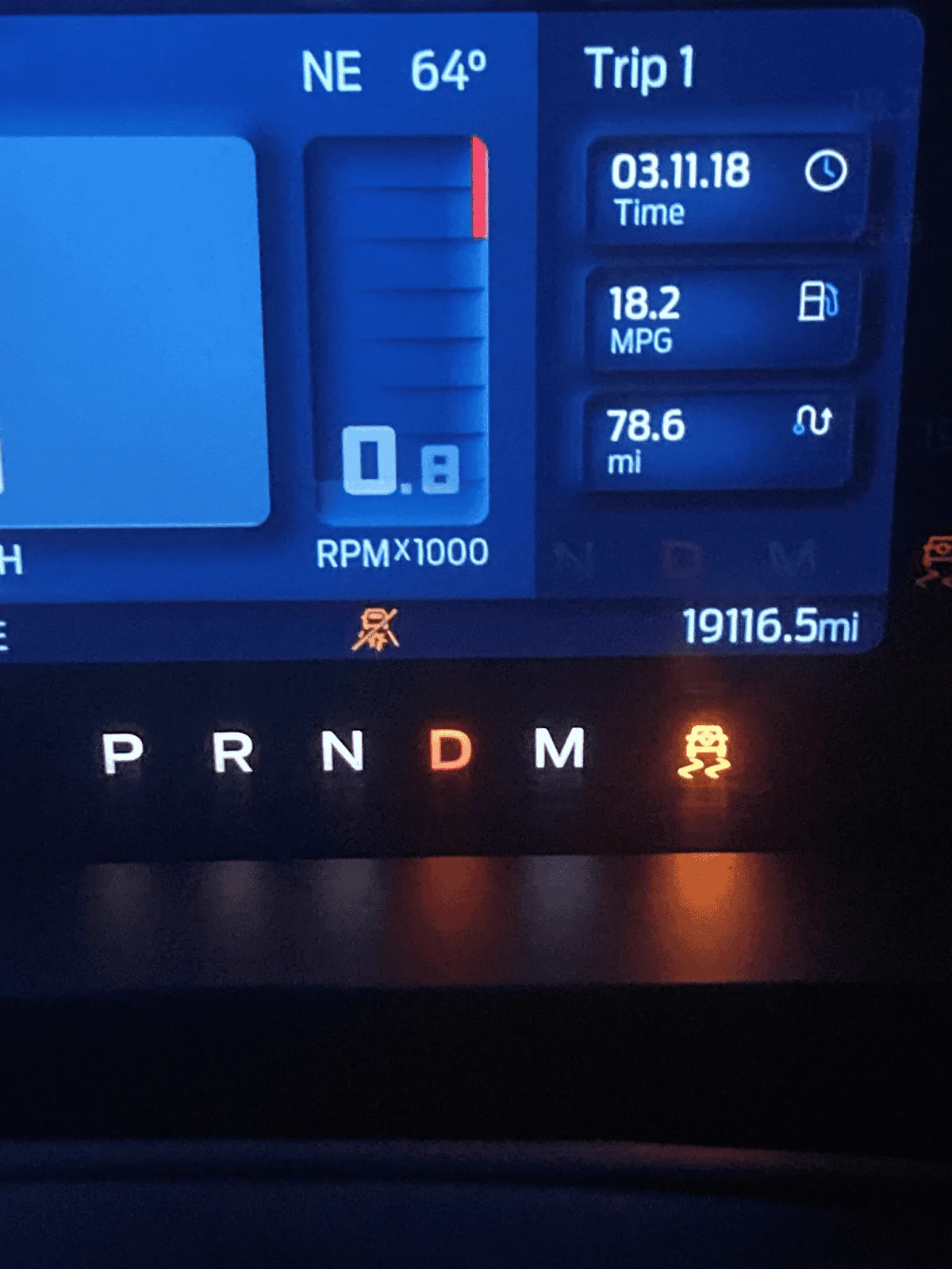

Hello,
I see that others have had Hill Start Assist and Pre-Collision Warning errors but I didn't see any instances of this happening after pushing the Trail Assist button.
It happen to me so I turned the Bronco off and then started it again, still errors.... The Cruise Control also did not work...

Hello,
