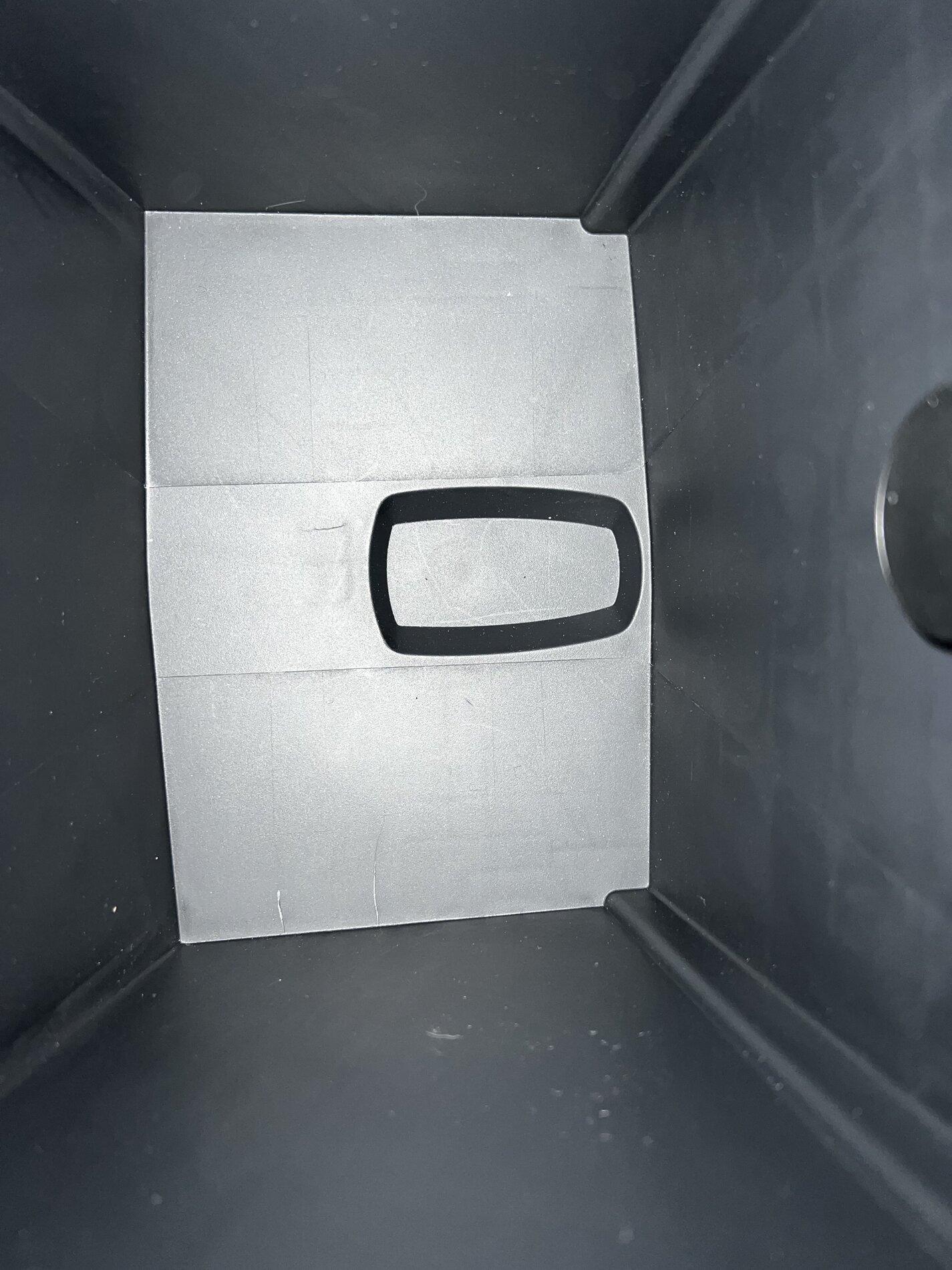

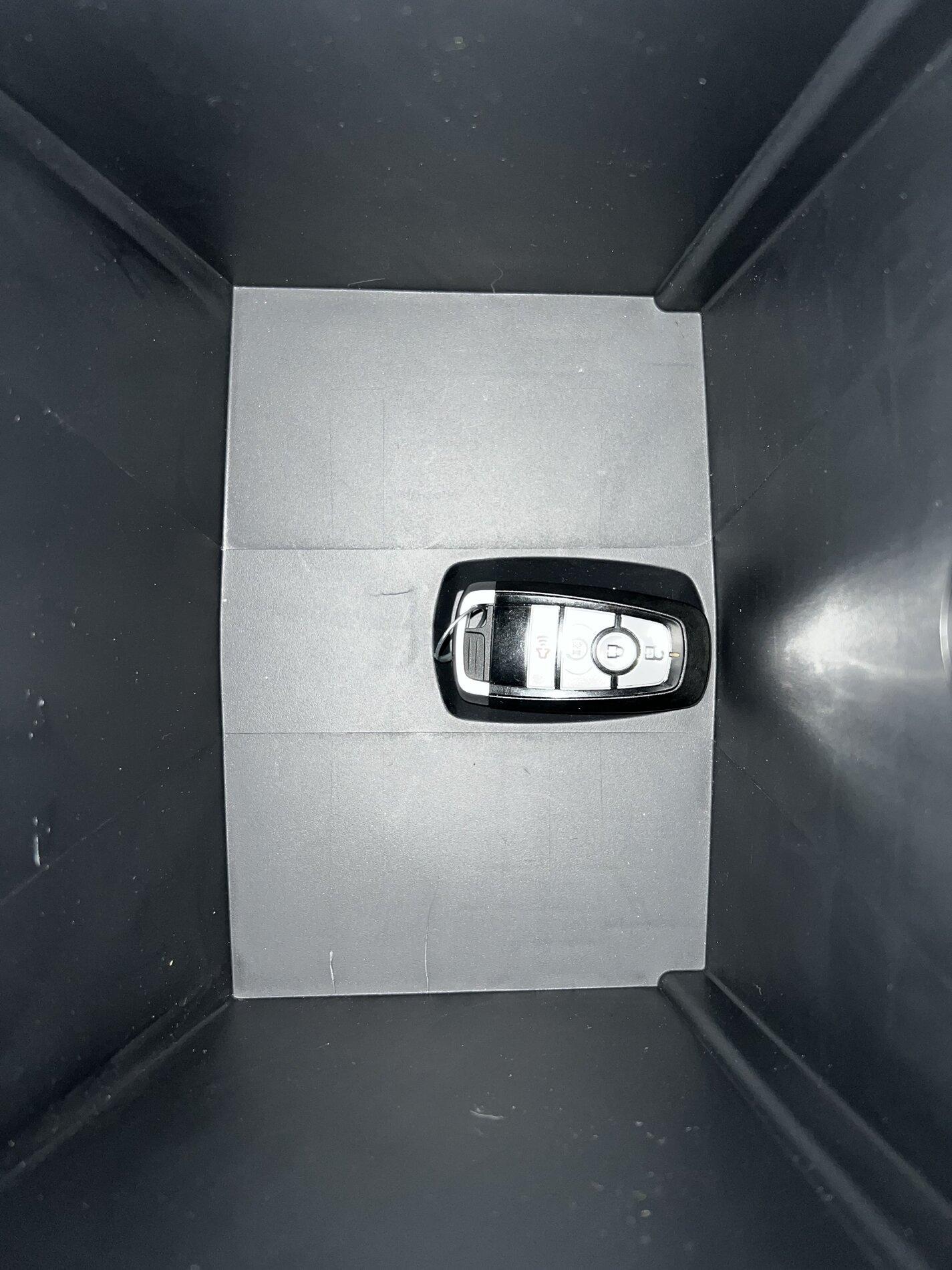

If your key fob battery dies, place fob there and it will work anyway, town and country demo’d it on YouTube. Pop out the battery of your fob if you want to try it!
This is not new, Ford has been doing this for years

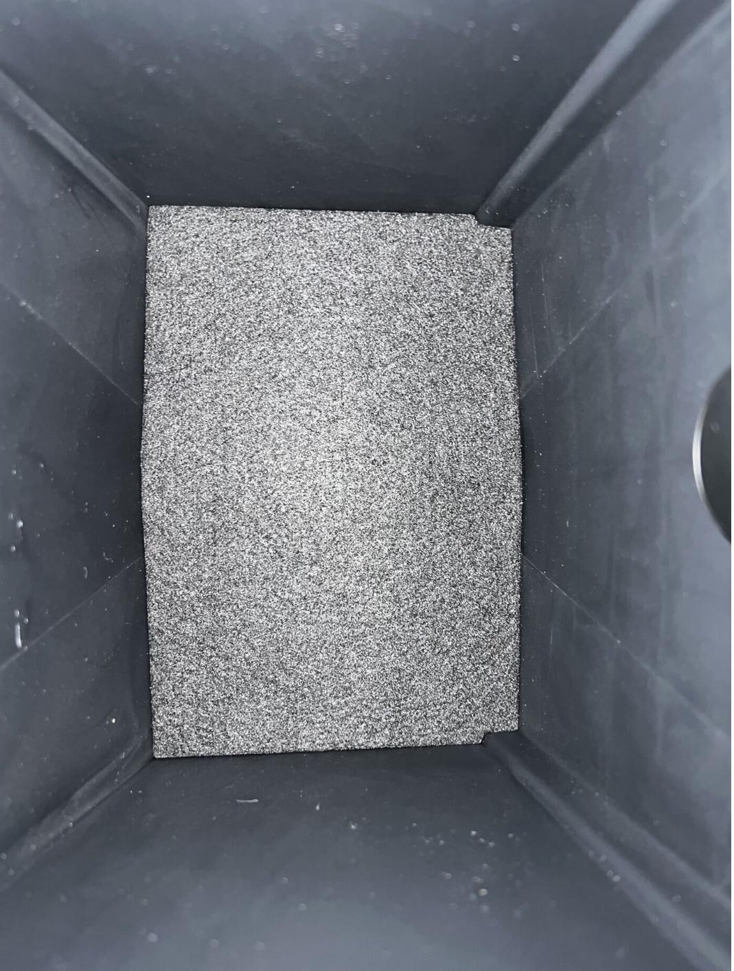

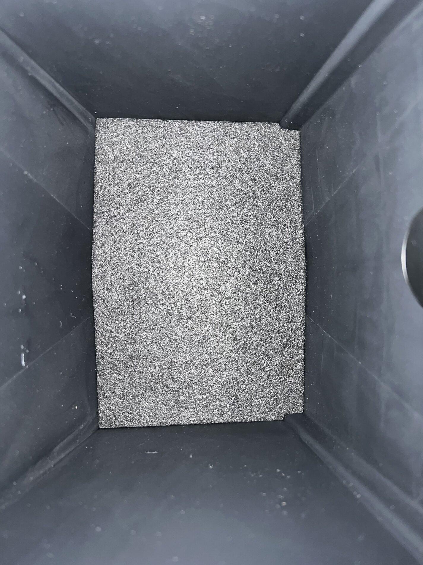

It's just a cheap trick to prevent stuff from rattling around in there while driving and making a bunch of noise. Ended up making my own out of some spare packing material for my Focus.

I found myself in a pickle the Fob wouldnt work. Called my sales guy and he told me to place the fob there and it worked. Battery wasn't dead. Think i was in a spot with interference or something??

If the battery in your key fob is too low to start the Bronco, you place it in that spot and you’ll be able to start it.

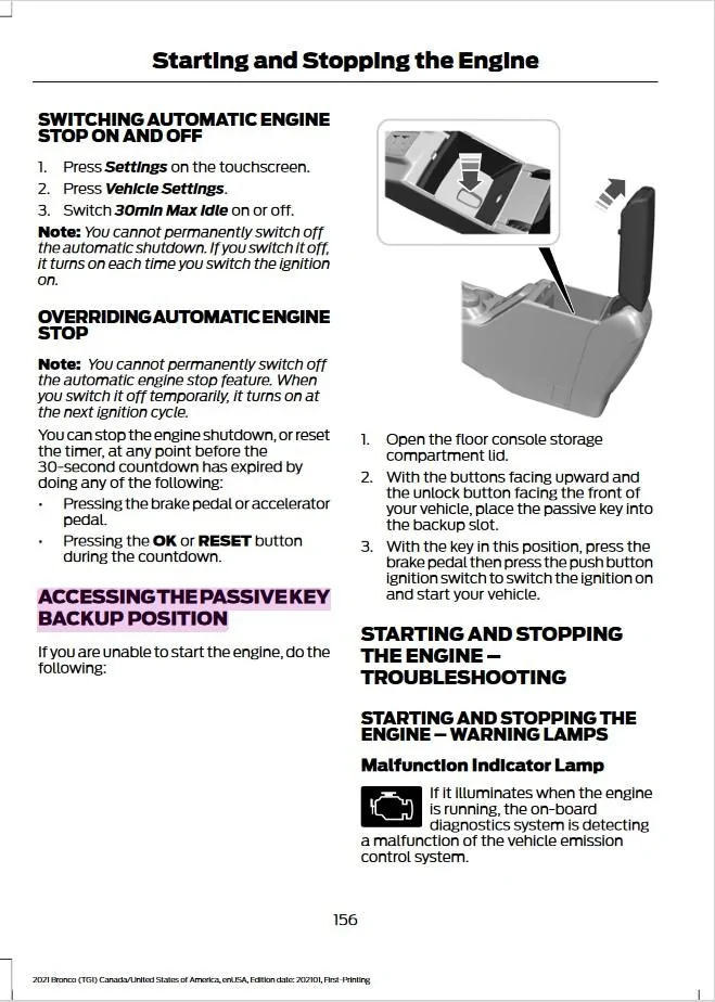

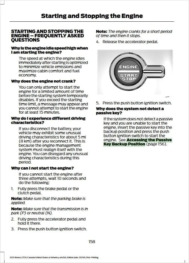

From the online PDF version of the Owner's Manual...
Ford Bronco Hidden key fob storage? Accessing the PassiveKey Backup Position - Pg 158
Ford Bronco Hidden key fob storage? Accessing the PassiveKey Backup Position - Pg 156
