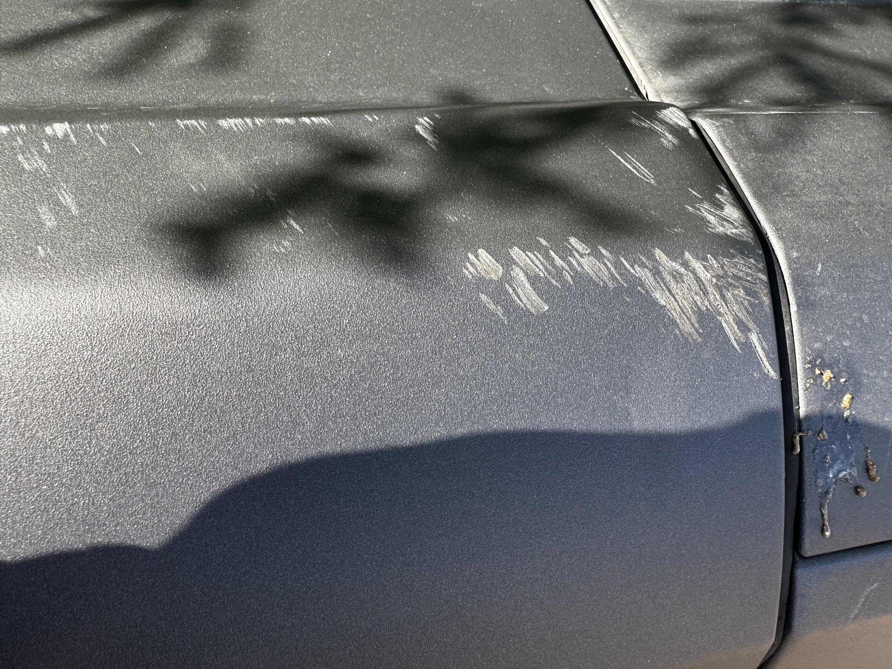

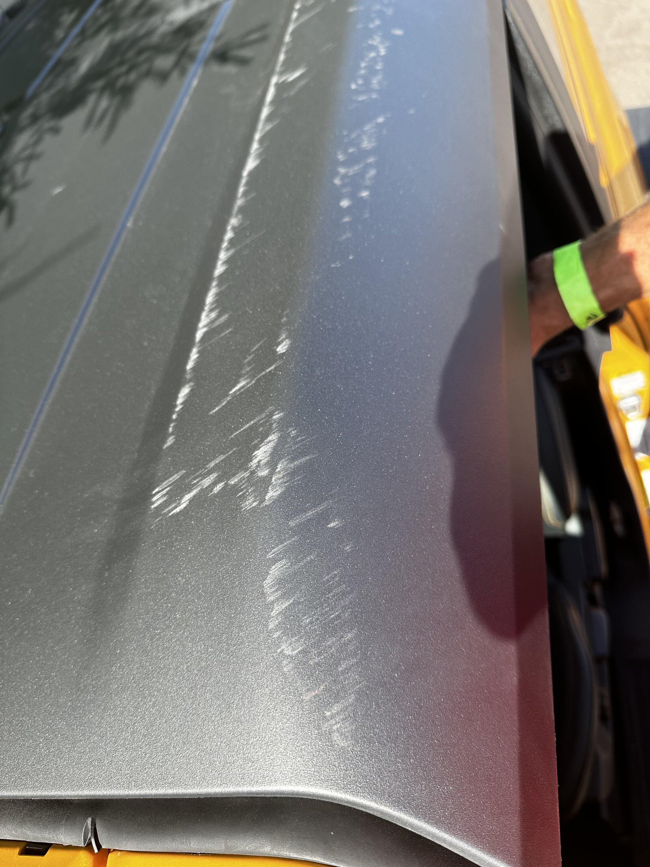

Got a few scratches in my hardtop. Regular body shop be able to take care of these? Appreciate your guidance.

Its molded in color. Try rubbing out with a mild abrasive. Maybe a green scotch brite pad. Dont get aggressive with it tho. Worst case it can be painted.

agreed I would try to buff that out, its one of the few instances where "that will buff out" applies.
Then consider getting that area covered in a vinyl to match, it will be more resilient to scratching and bird :poop:
