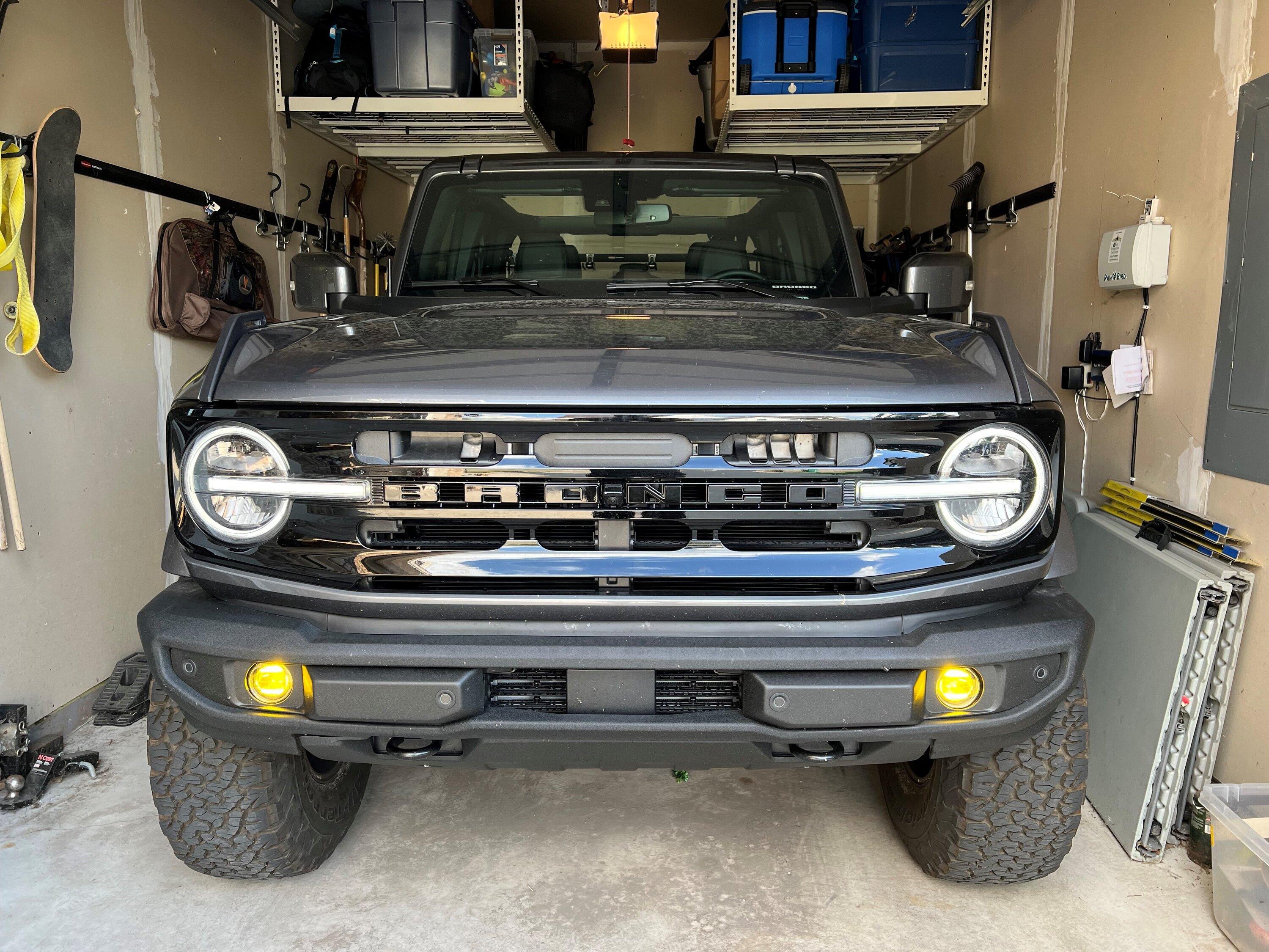

I ended up doing the soldering technique. I used this kit from Amazon: https://www.amazon.com/dp/B07QNPFXX3?psc=1&ref=ppx_yo2ov_dt_b_product_details
I ordered the new black painted letters from BFN which meant I had to drill out my old letters. My technique was not great, I would have had a hard time re-using those letters. I simply melted down the plastic stakes to meet the holes in the grill and it seems to have work. The letters are mounted firmly.
Here is the final outcome (picture attached).
