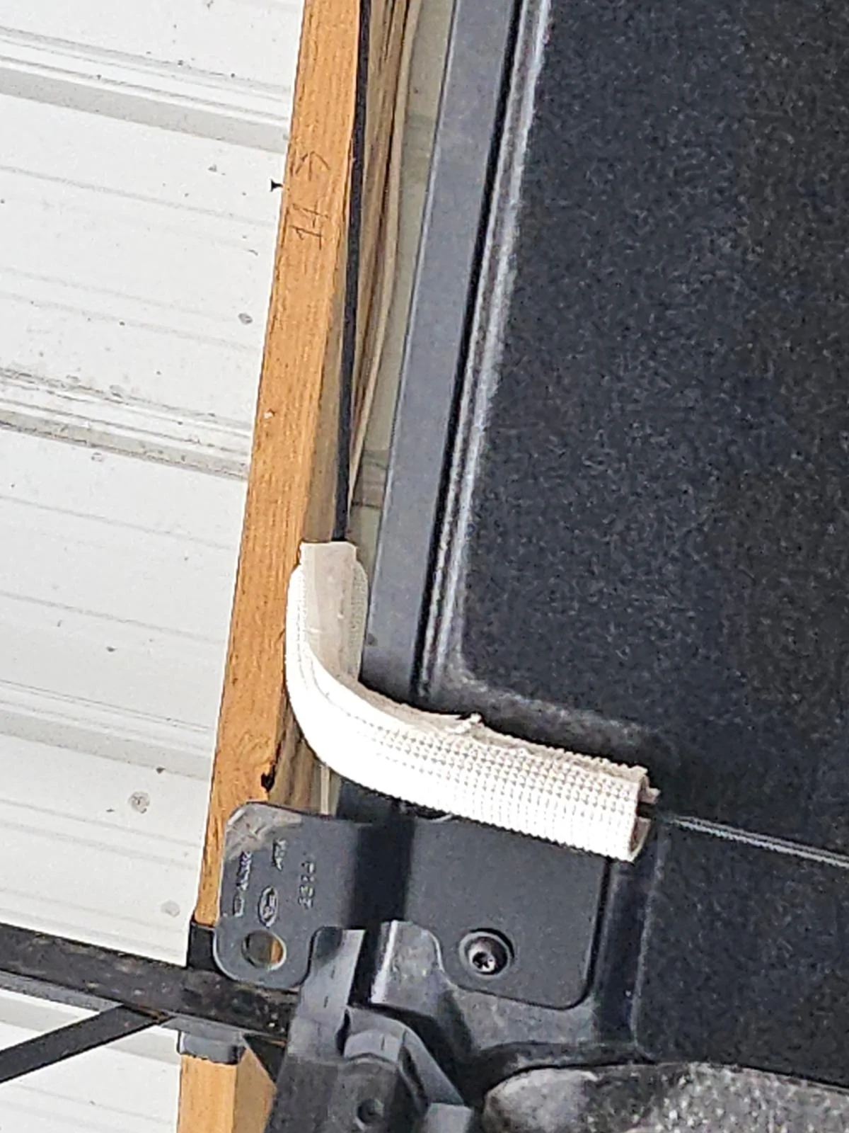

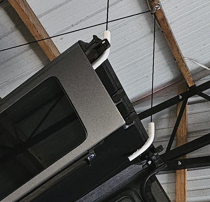

My concern was from the photos of people lifting from just the two rear slits and there being a noticeable widening of the gap at those points. Straps going underneath spread the load out more evenly IMO.
Ideally it would be best to support from the bottom after lifting but maybe I'm just overly cautious with the MIC top and all the issues it has had.
You are right to be cautious. I am too. Overly so. Massive OCD so I think through a lot and would be horrible if top seperated. . I understand your concern but I’m not sure the physics support it..I could be wrong..
It seems it wouldn’t matter how much points you lifted from. Once hanging in the air the weight of the legs are still pushing down force and are unsupported in either strap or hook scenario. The bigger risk IMO is with those two slot lift points the top piece cracks there. If that’s what you mean then I could see that..
The MIC top at the point the flat hooks enter is supporting 40lbs each. Is the top and slits right there starting enough not to break at 40lbs? 🤷🏻‍♂️

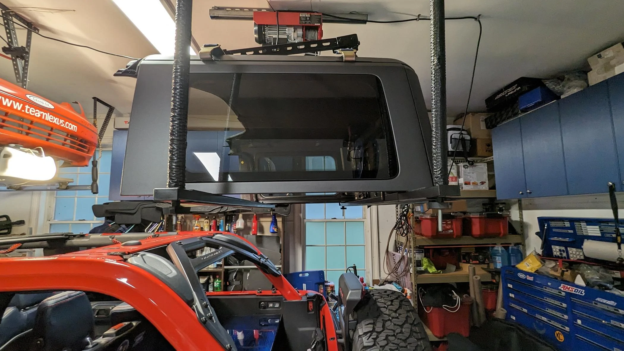

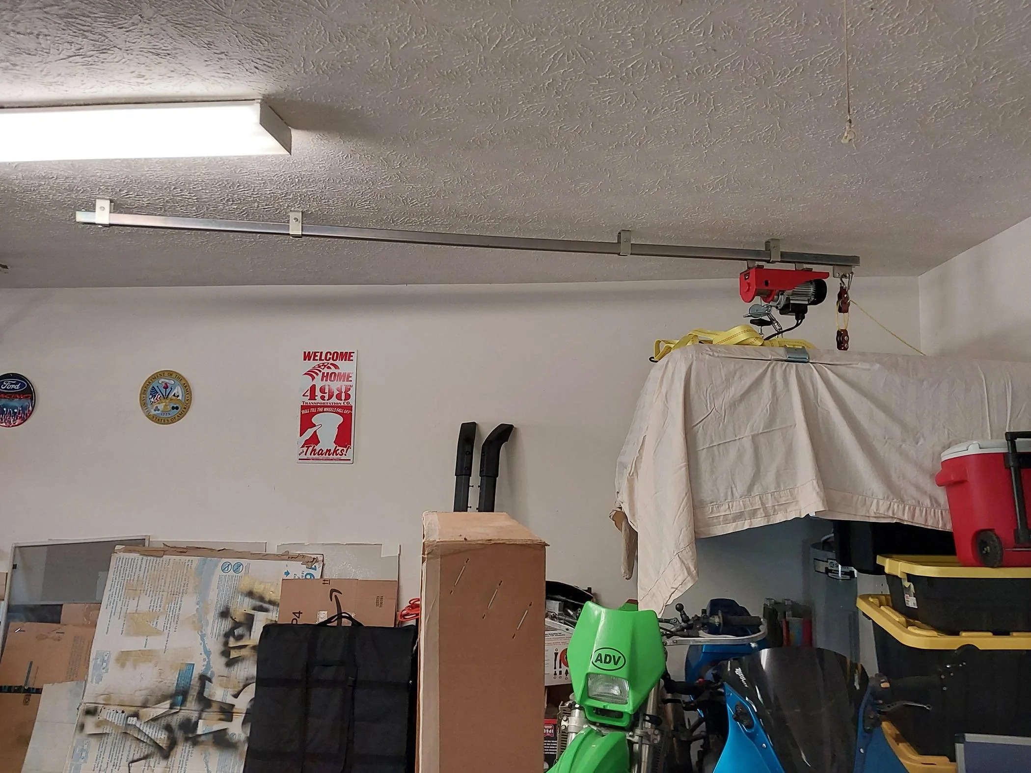

My garage is 24' long so I lift the top off then have enough rope to lower it to the floor and still park in front of it. My plan is to have a shelf of sorts that folds up against the back wall that it will lower on to when I am running topless. I also made sure the ropes were suspended a bit wider than the top front to back so that they angled away from the rubber seals when lifting. The ropes should never put any pressure on the seals if rigged correctly.

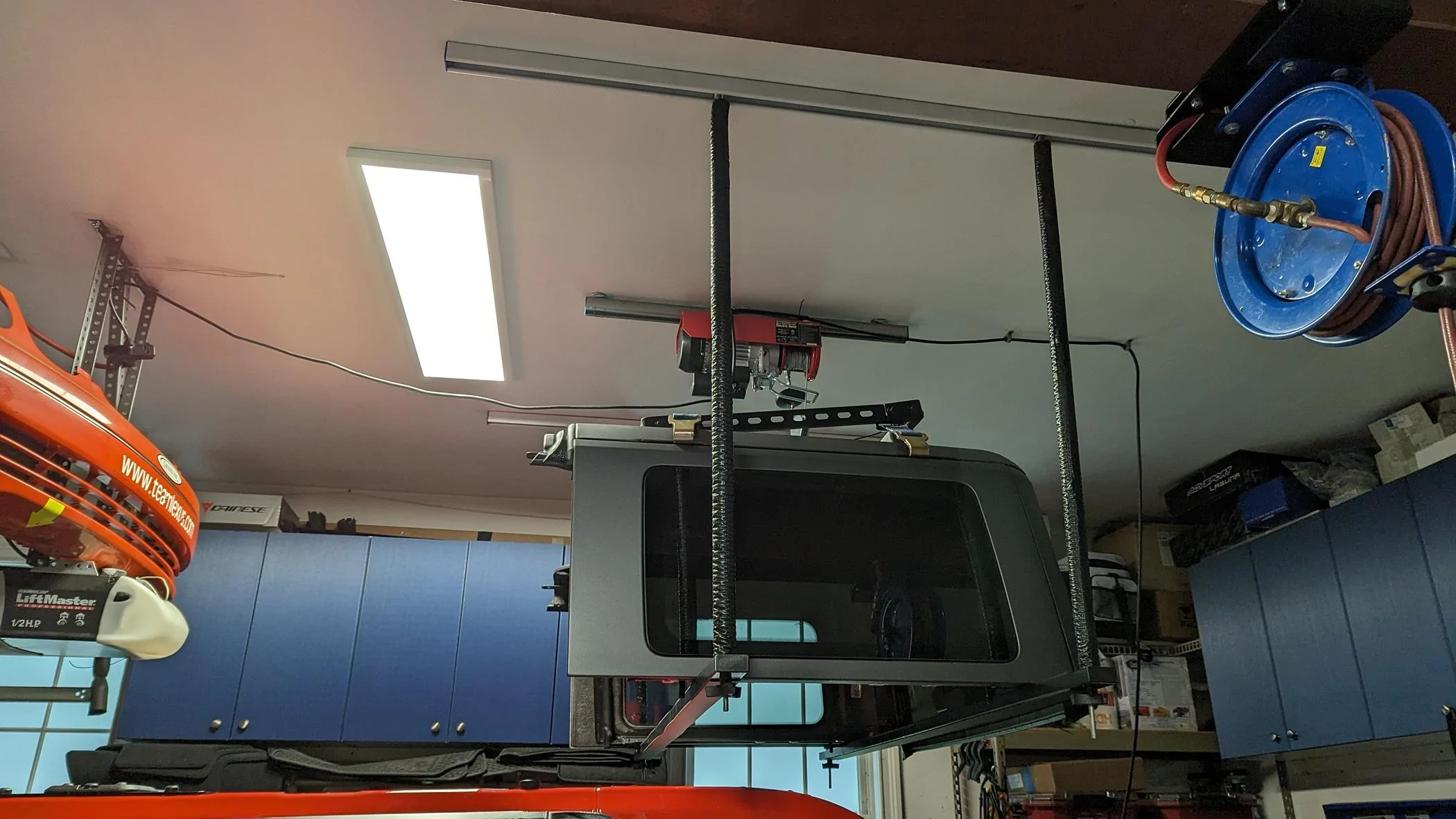

Nearly 2 years hanging mine. No issues with the Lange hoist. Takes me less than 10 minutes to remove or install using my electric ratchet .
THIS is exactly what I want to do too. HeliPilot, can you share some additional details on what you used for the brace bar that is holding the top, pulleys, etc? Thank you!
HeliPilot
Kenny
Dec 17, 2021
1,705
3,613
CT
2022 2.7L SAS

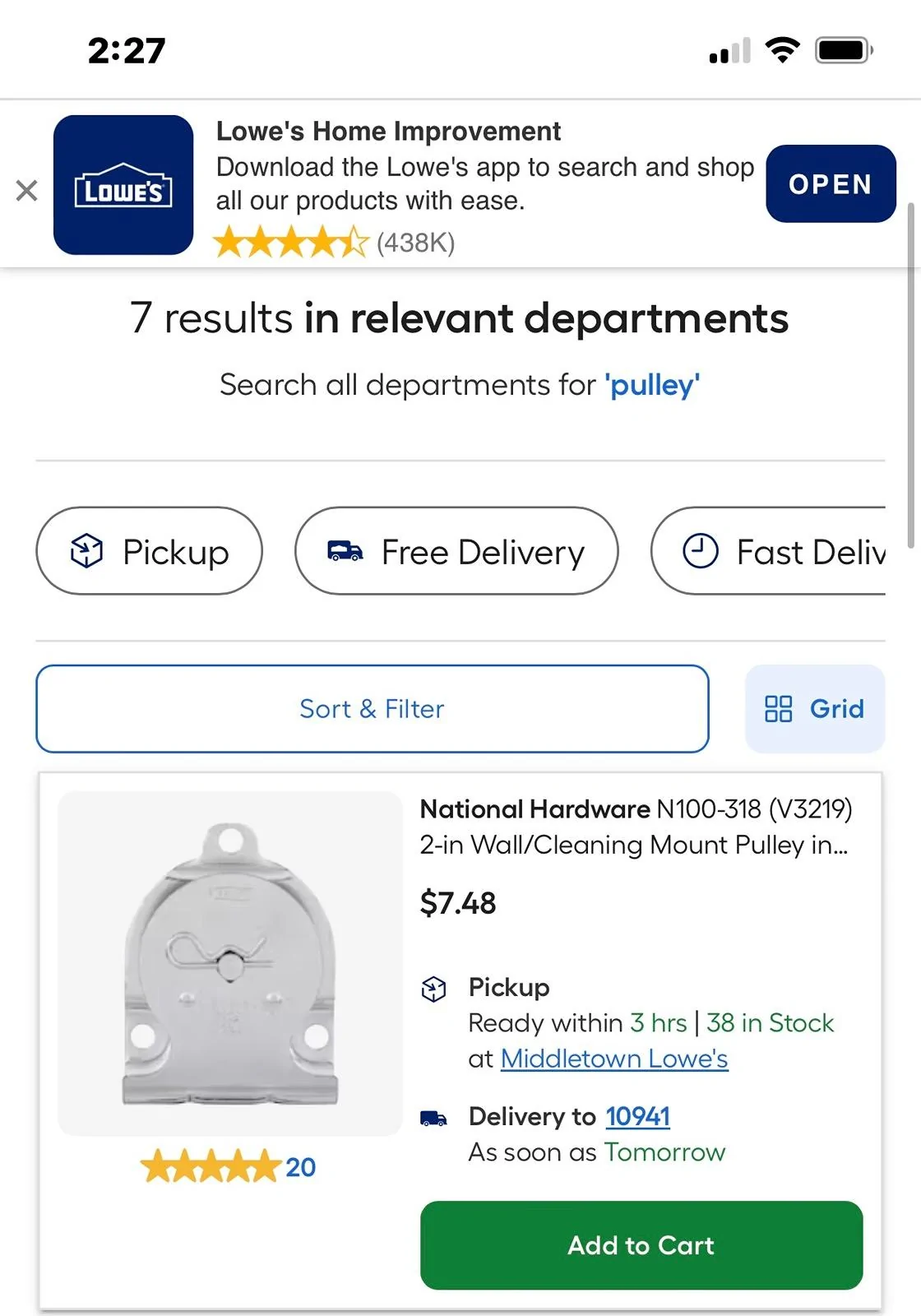

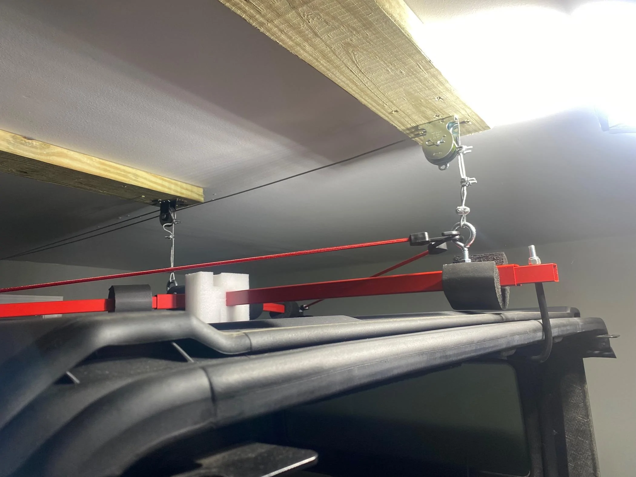

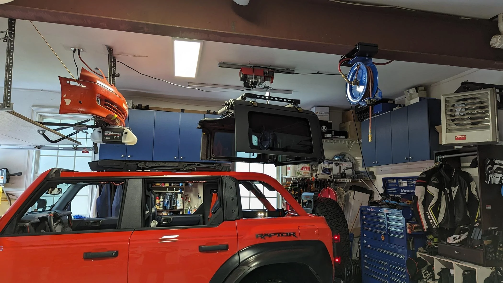

Cut 2x4’s and screwed them into the ceiling joists. The winch plate is mounted into the wall studs. With the exception of this additional pulley, all items used to mount came with the Lange Hoist. I picked this pulley up at Lowe’s.

I’m curious what lengths you used for your length of cable with the Crosby clamps. IE how long is each Crosby clamp section in total
I spaced them a little over an inch apart. That way I had plenty of time to detect any slippage in the cable. This is what i meant when I told you the Crosby clamps would dictate your overall clearance. IE…how far apart do you want to space them. When I worked power line construction, many moons ago, we would use Crosby clamps to pull high tension wires. Because of that experience, I was confident in their ability to hold.

So that mean the total length of cable that is looped around the eye bolts with the Crosby clamps is then about 6ish inches (1.5 before the first clamp 1.5 after that then 1.5 after that = ~6inche​
HeliPilot
Kenny
Dec 17, 2021
1,705
3,613
CT
2022 2.7L SAS
Yes and I left about an inch long tail through the final clamp. Now you see why your clearance is roughly 12 inches with pulleys, eye bolts, and clamps in place.

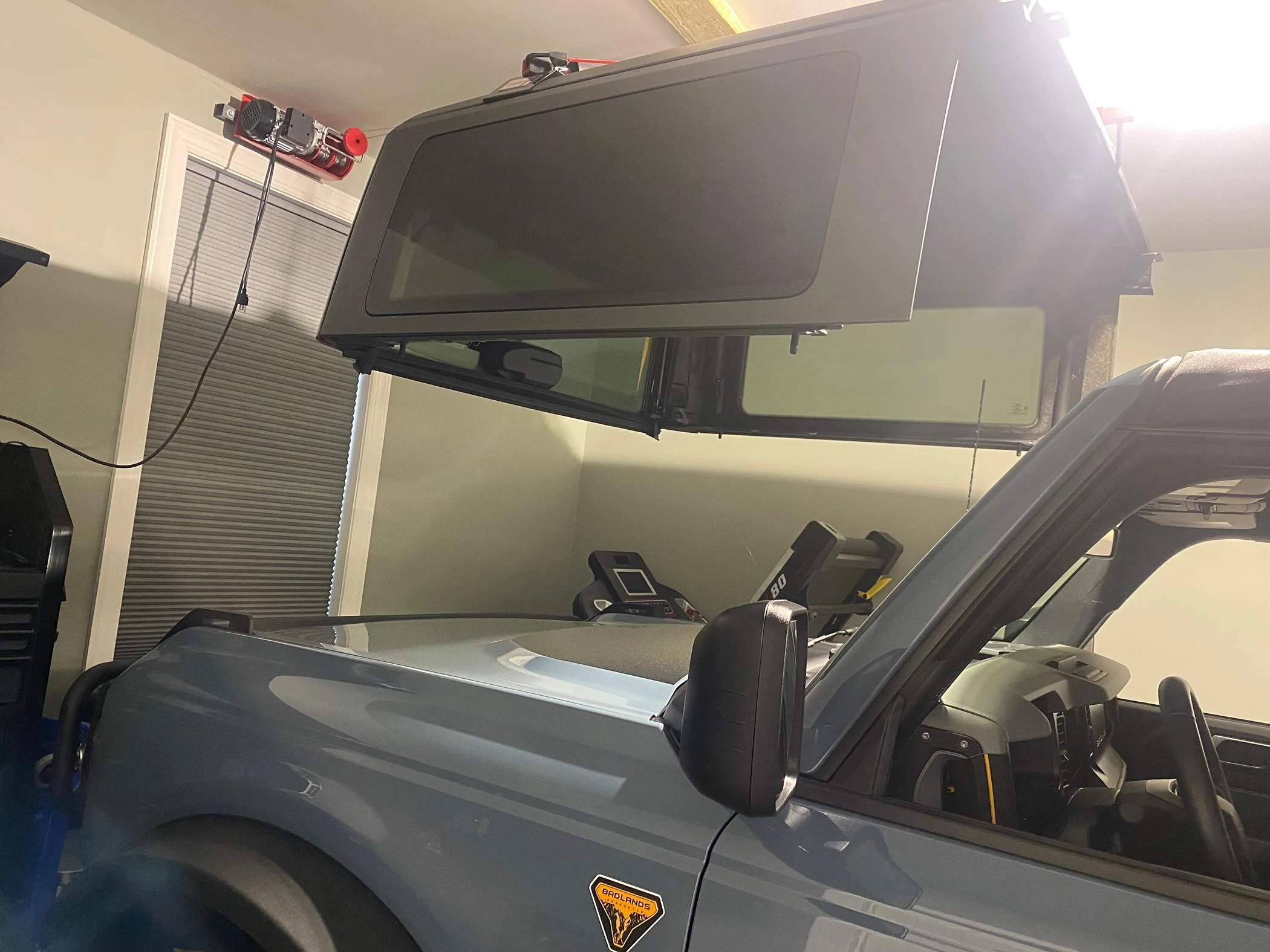

Do you need to drive completely under your top, like pass all the way underneath it? Because, technically, you only need to lift the top a few inches in order so drive out from underneath it. Then, it only needs to be high enough to park your front end underneath it. I literally drive in until the top almost touches my windshield frame and stop. I raise mine as high as I do to give me the option of backing underneath it without worrying about the roll bar making contact with the top as I approach. But it’s not required to be that high by any means.
Yes I need to fully be able to drive under it. If I can make it 1 foot or less from the top of the ceiling to the top of the hard top this will work.
