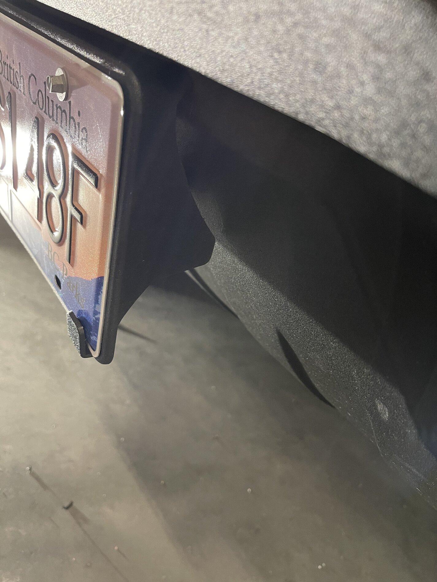

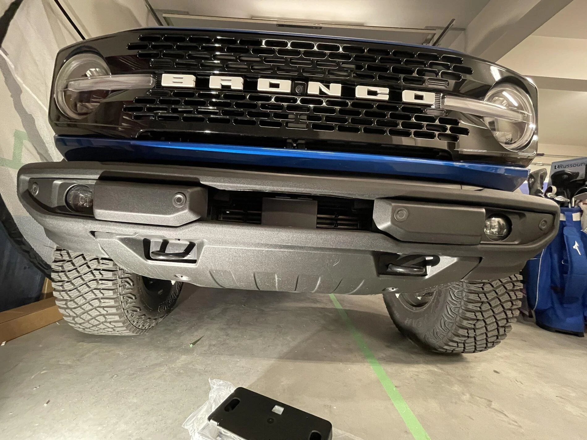

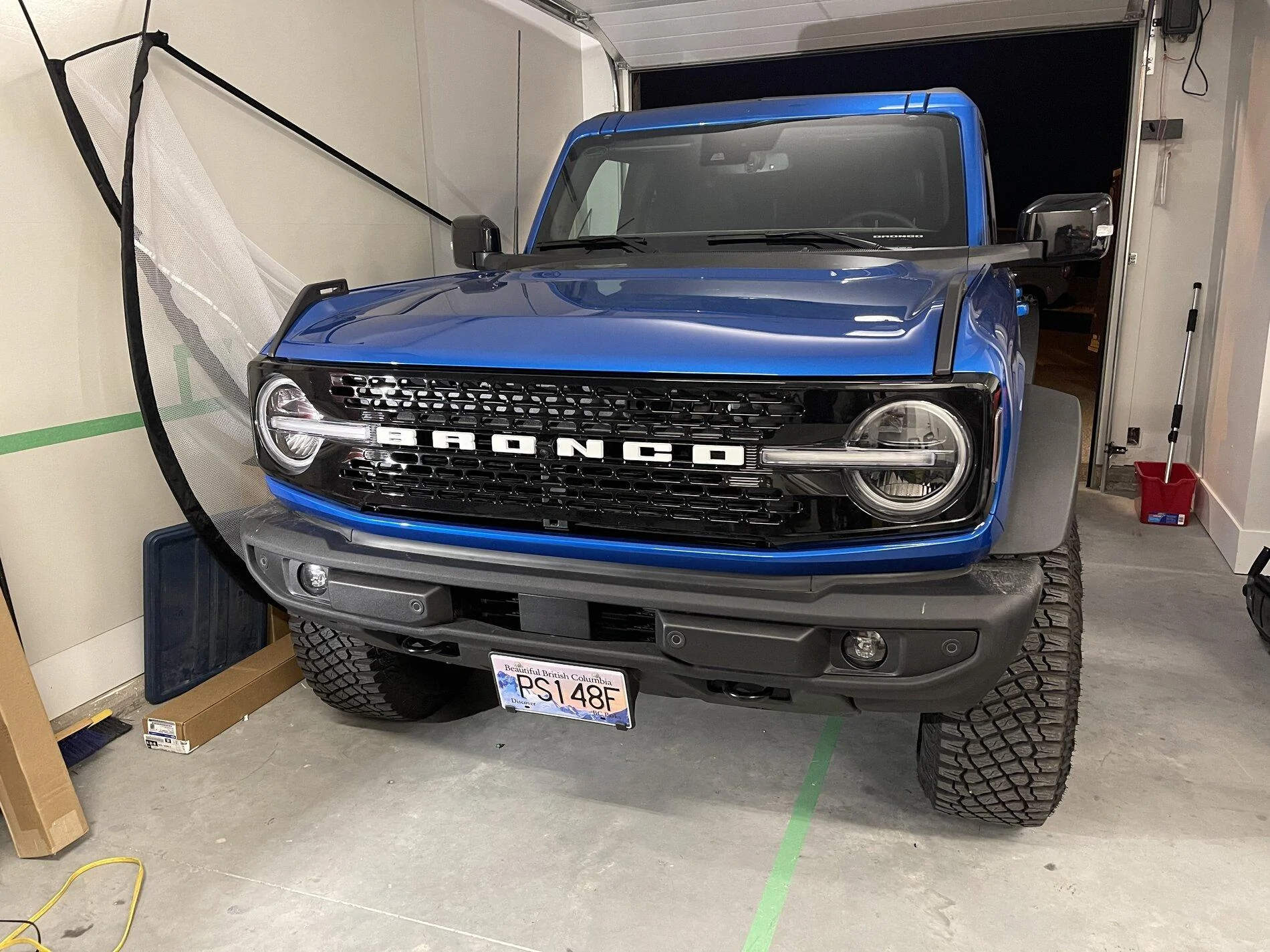

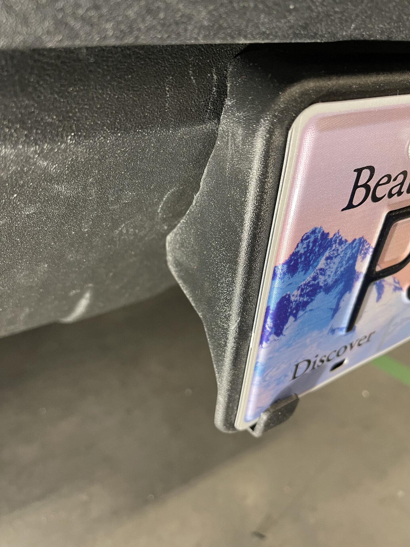

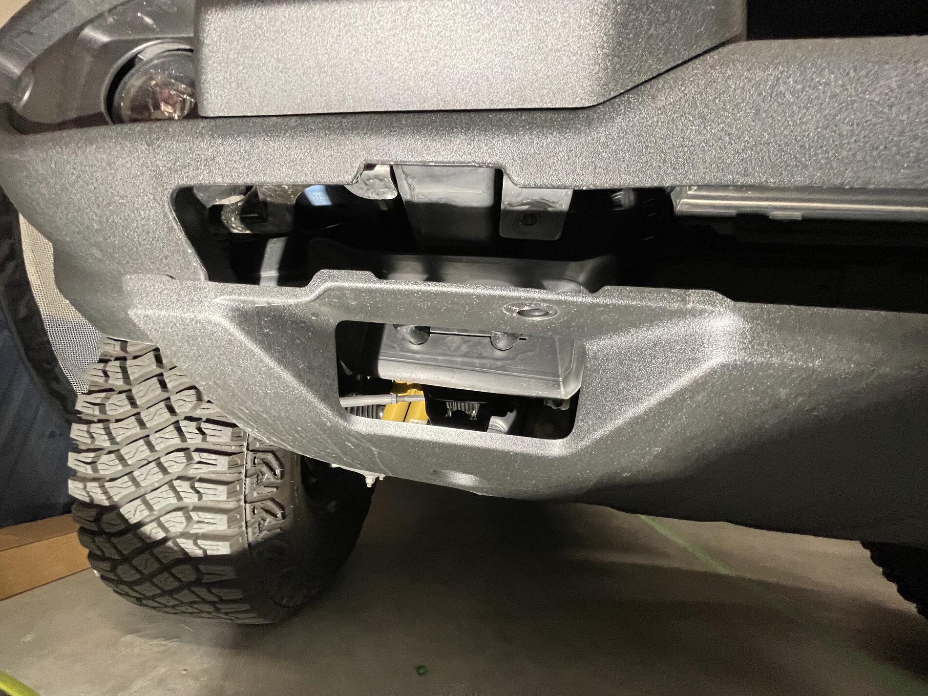

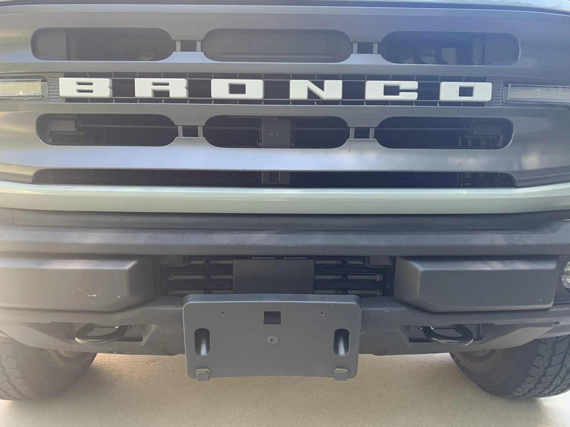

I wing’d it for 3 weeks without installing the front license plate holder which could not have been preplanned to be in a worse location. My dealer was kind enough not to install it and save me the cosmetic scar. I seriously thought about never installing it and asking for forgiveness and simply paying the fines for not having a front plate. There are lots of drivers in town from out of town so its possible I could have gone more than a year without detection. But alas, after three weeks driving to work past our local cop shop, prudence got the better of me.
1) I repurposed the factory holder
2) loosened the front plastic cowel (just the two front fasteners)
3) bought a license plate screw kit with washers, longer bolts (the kit uses a hex key)
4) a sharp blade to manually trim the bracket
5) a couple test “try-ons” and some more cuts, two washer each side and ta da!
Cost me $3.99 CAD and about 30 mins, 3/4 of a beer.I know its not the idea spot for off roading but for now, it will do.
Now I wait for the aftermarket to design a killer front bumper with winch that allows me to keep the sensor and the front plate might go MIA again.

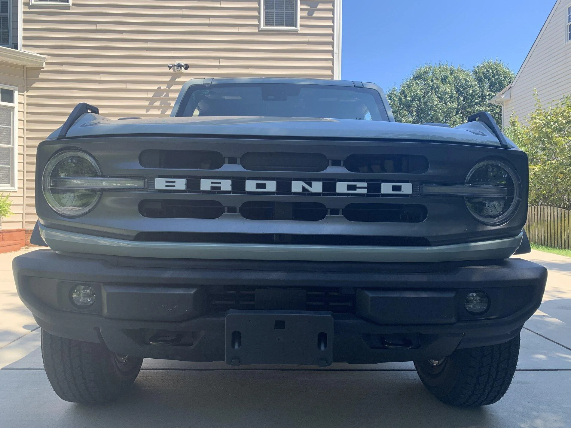

Just did the same thing to my BB today and was about to post. I just used 2 galvanized screws after drilling a pilot hole. Looks soooo much better!

Great idea! You should start a business for BC Bronco owners! I’d pay.
Just need a sharp knife and a 5/8’s socket. Hard to corner the market,
