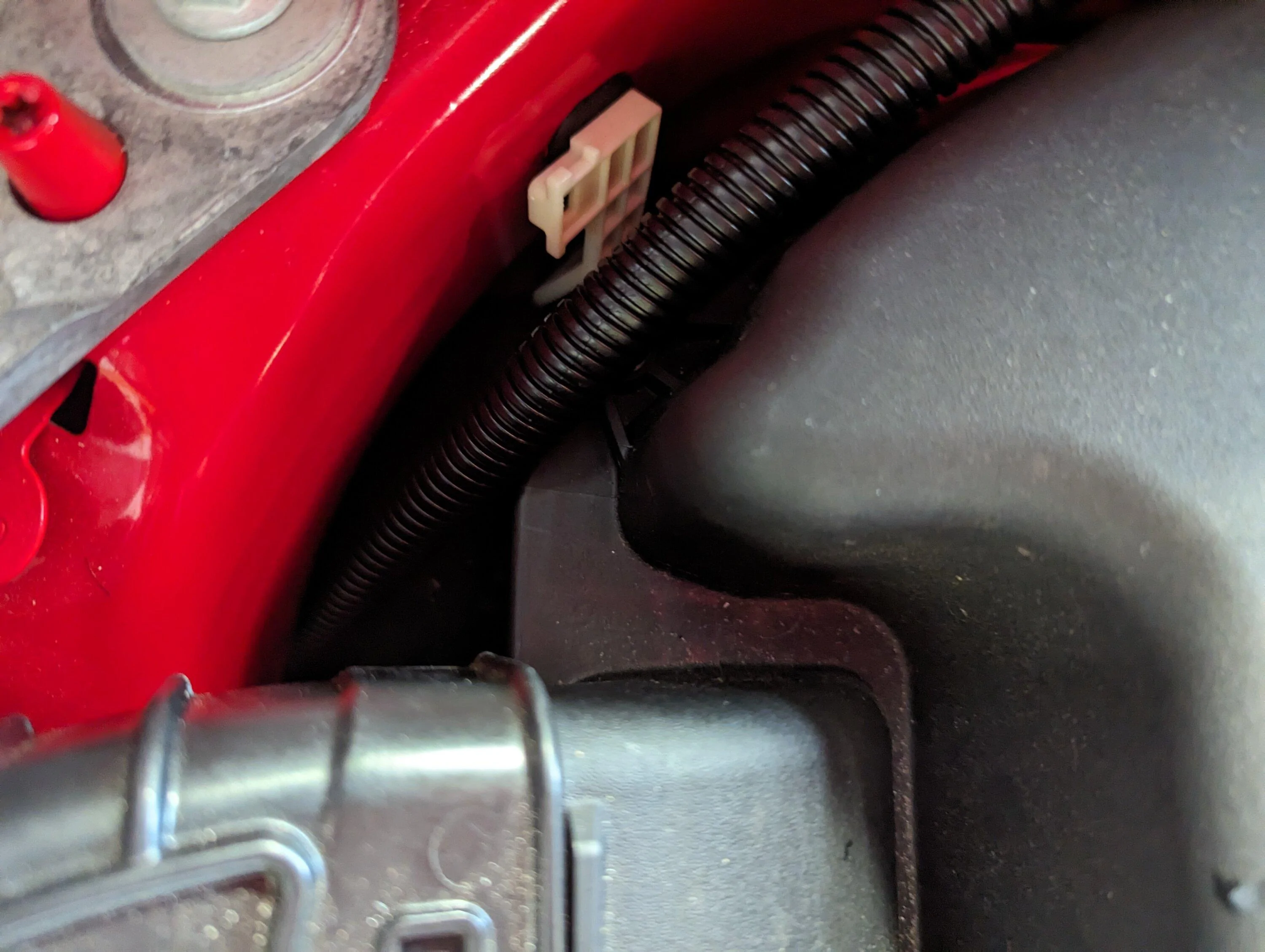

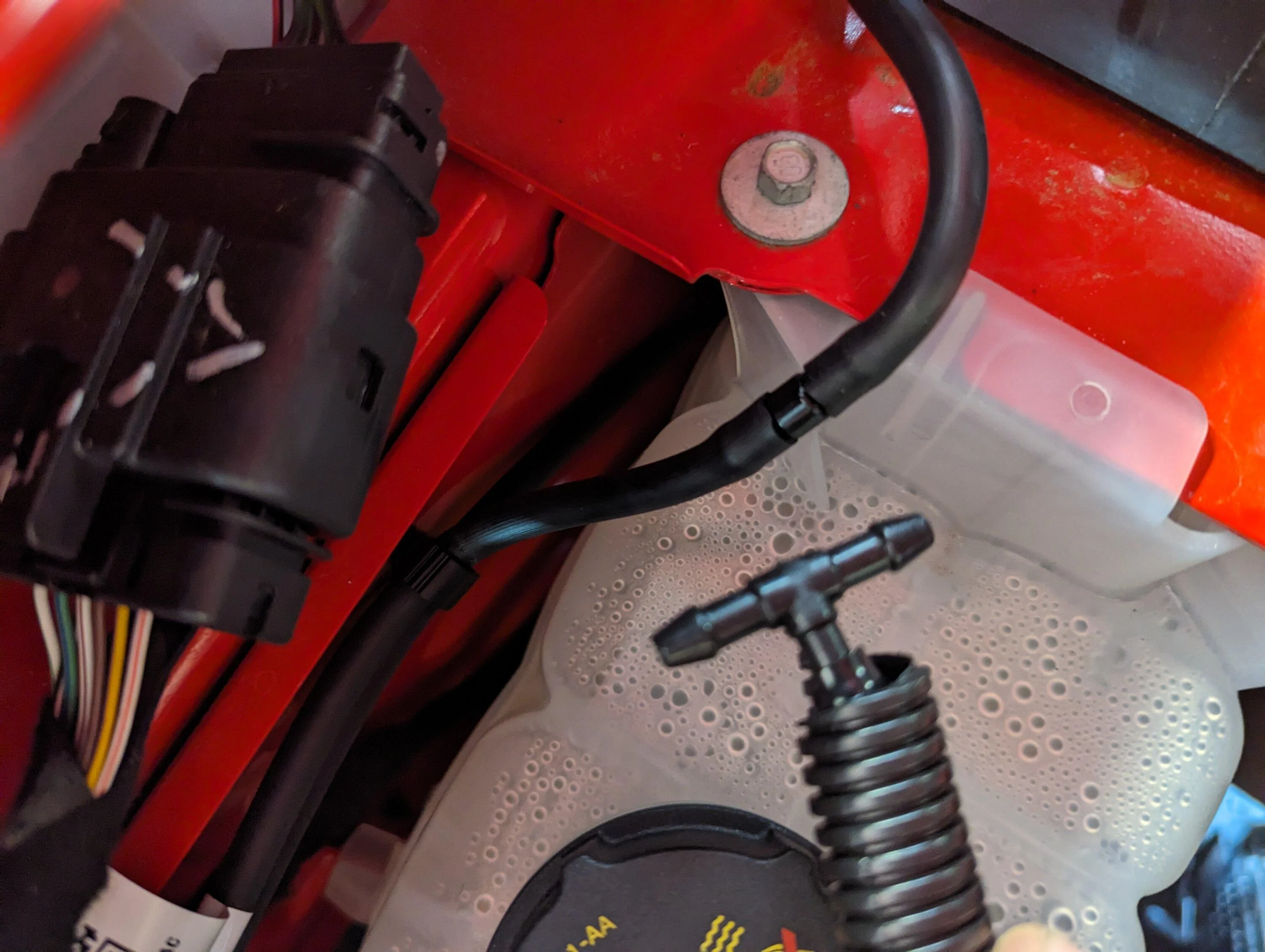

So I added the RC Winch Mount and Warn Winch. Seemed logical to add a front nose camera and I did. That works fine. Decided to get fancy and add a camera washer. I cut the windshield washer line and put in a Tee with a line to the camera washer. No leaks. NADA. Then I tried it with the Bronco running and it worked! Well, it worked too well. Once the line started it would not stop even with the engine off. So I figure, that just maybe, just maybe I need a check valve. Not sure which one to order since I'm making this up.
I'm thinking I will reinstall the T and then install this check valve after the T. https://amzn.to/3QKnN83
The picture with the camera shows the nozzle and line.
The picture with the T shows where I had cut the line and installed the T. Since removed to stop the flow of fluid. It spit more than 16 ounces before I yanked the T off and stopped the flow.
The third picture just shows where I routed the hose down behind the grille frame.
