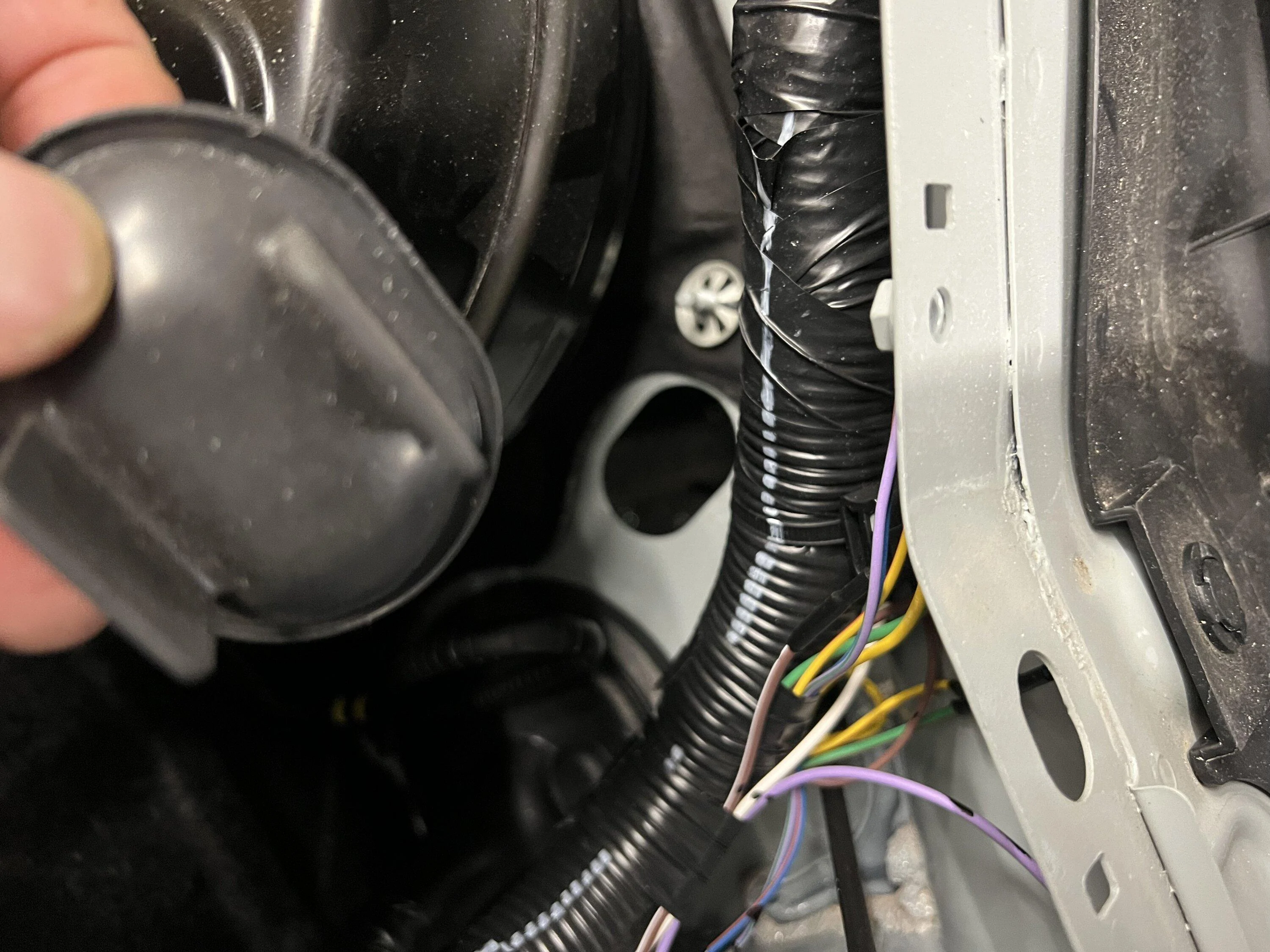

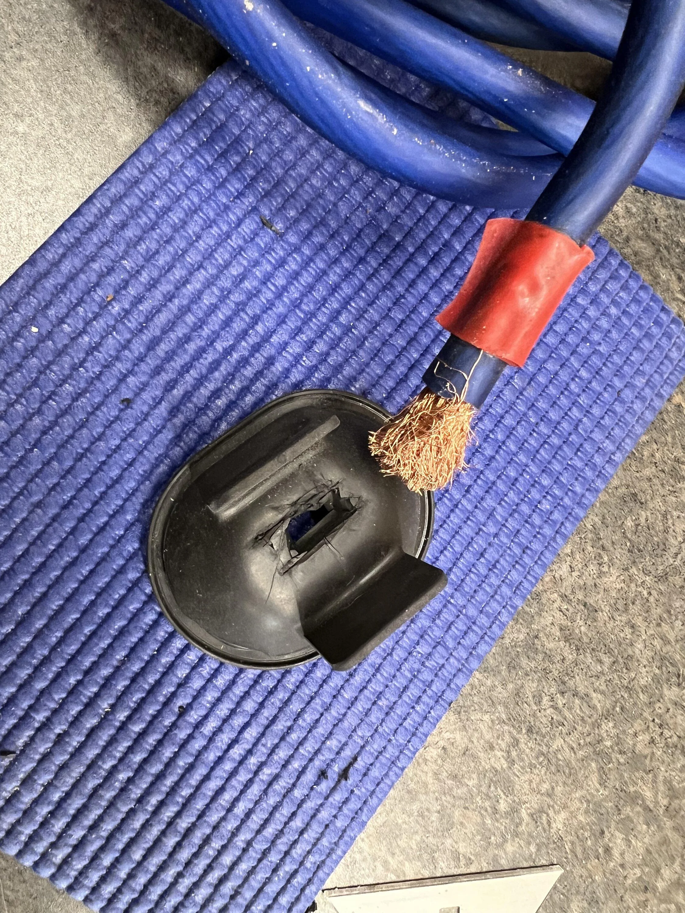

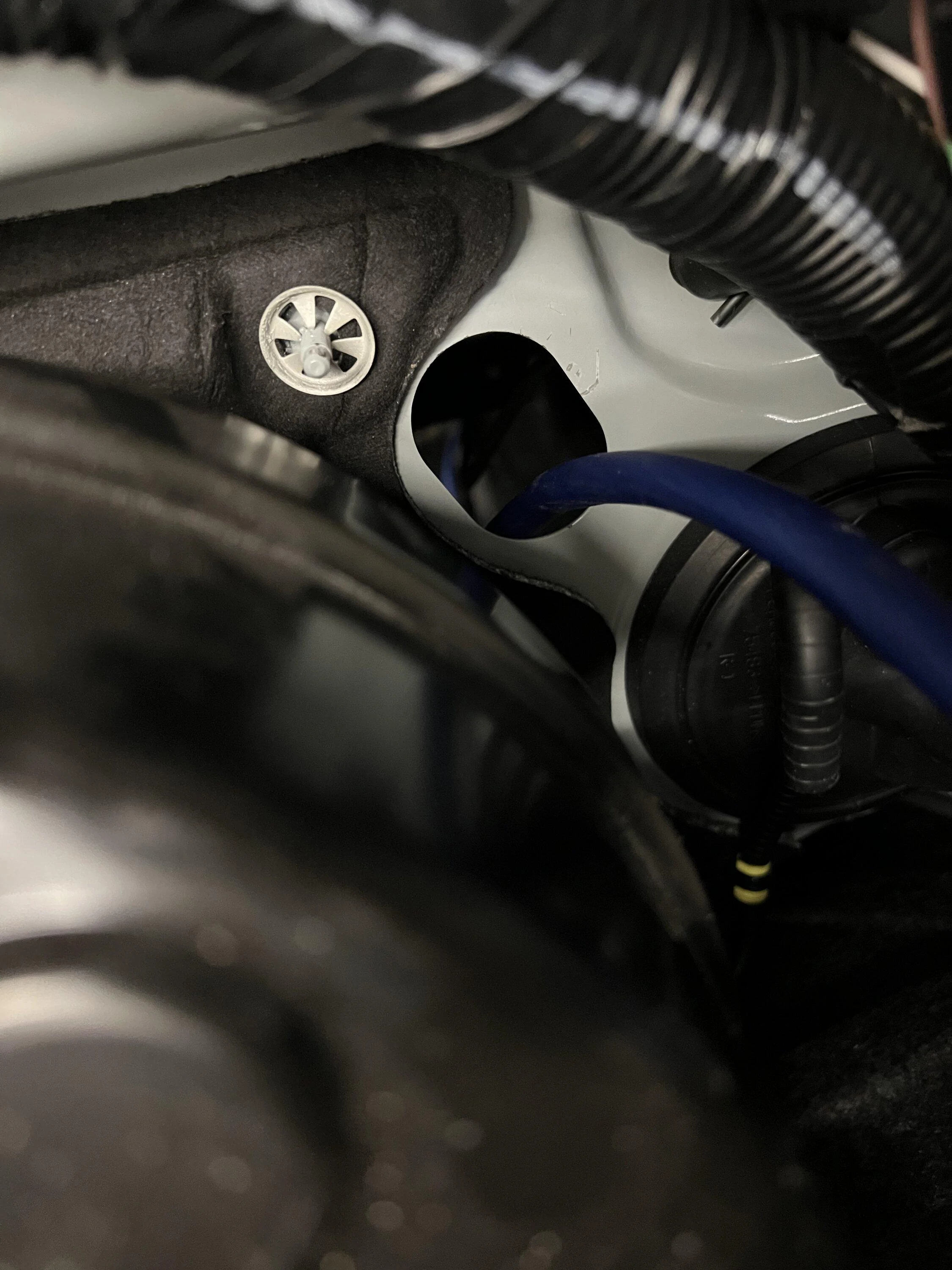

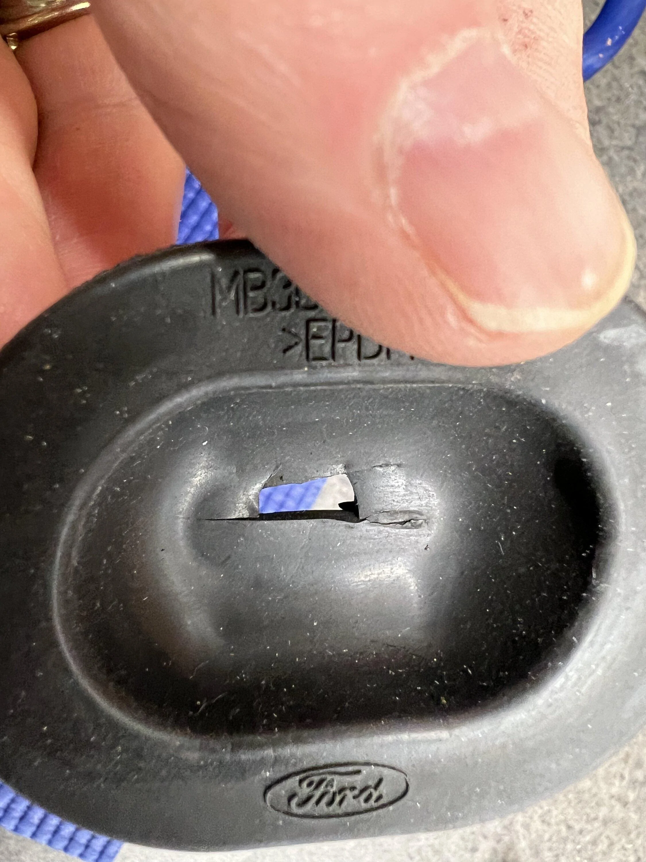

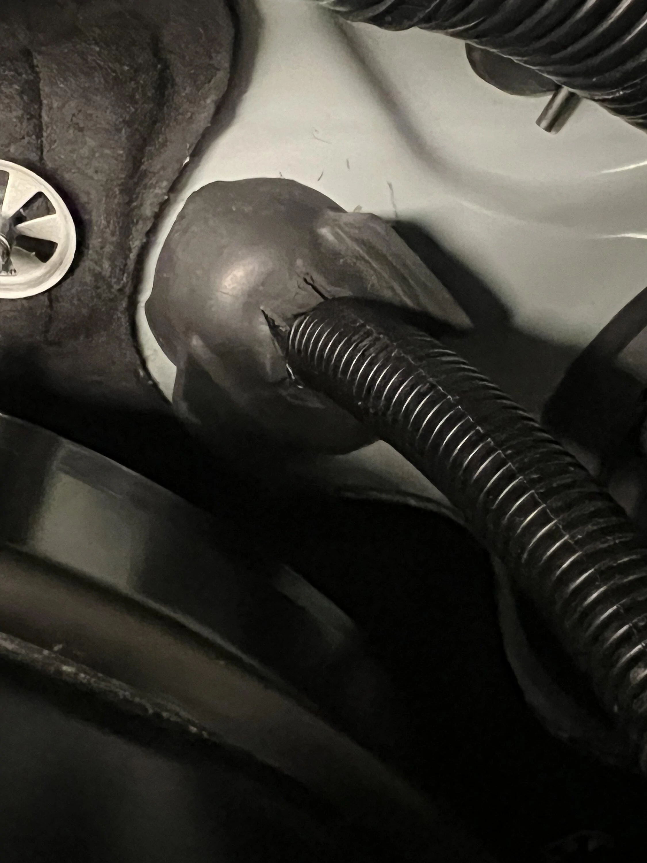

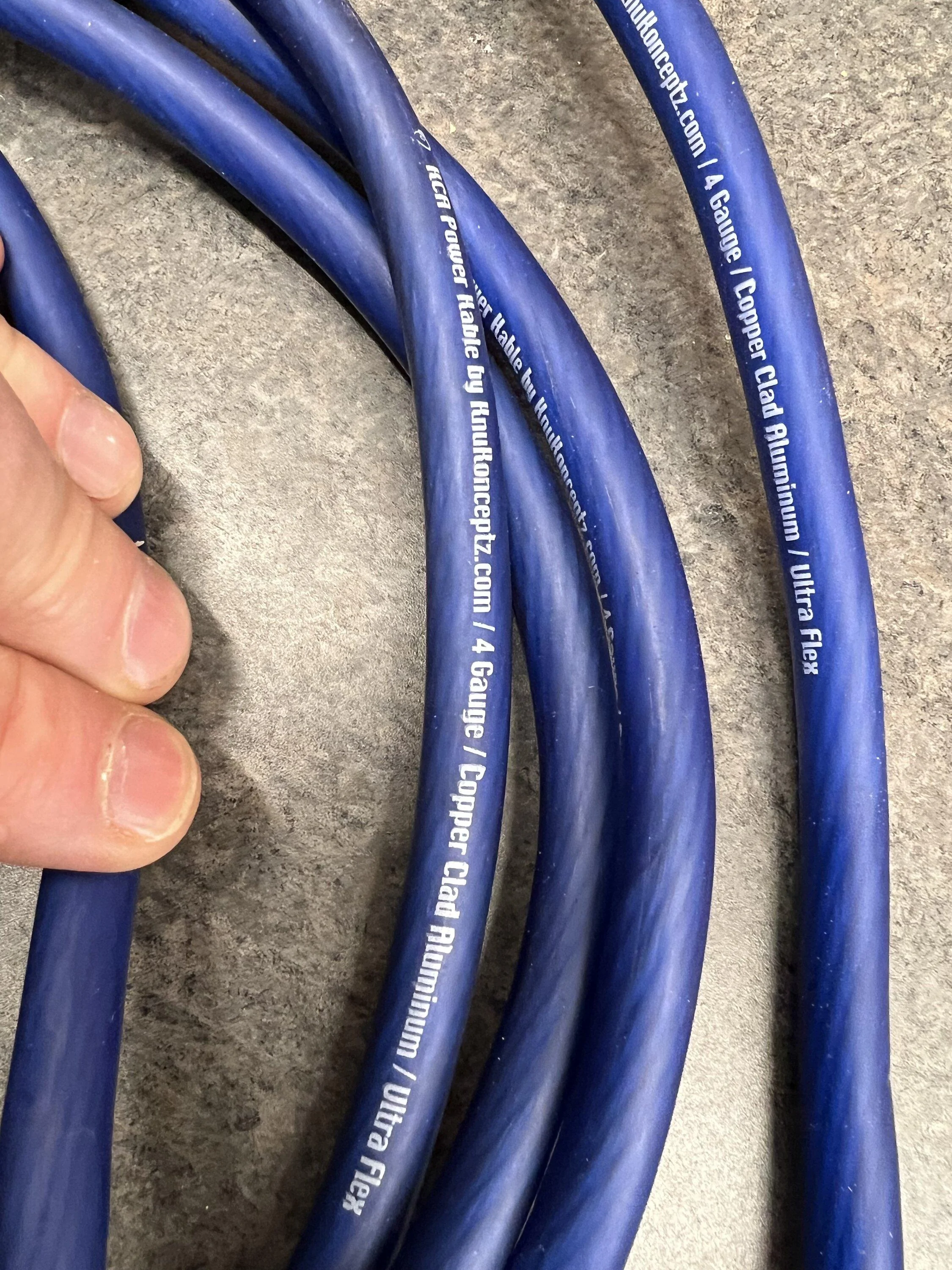

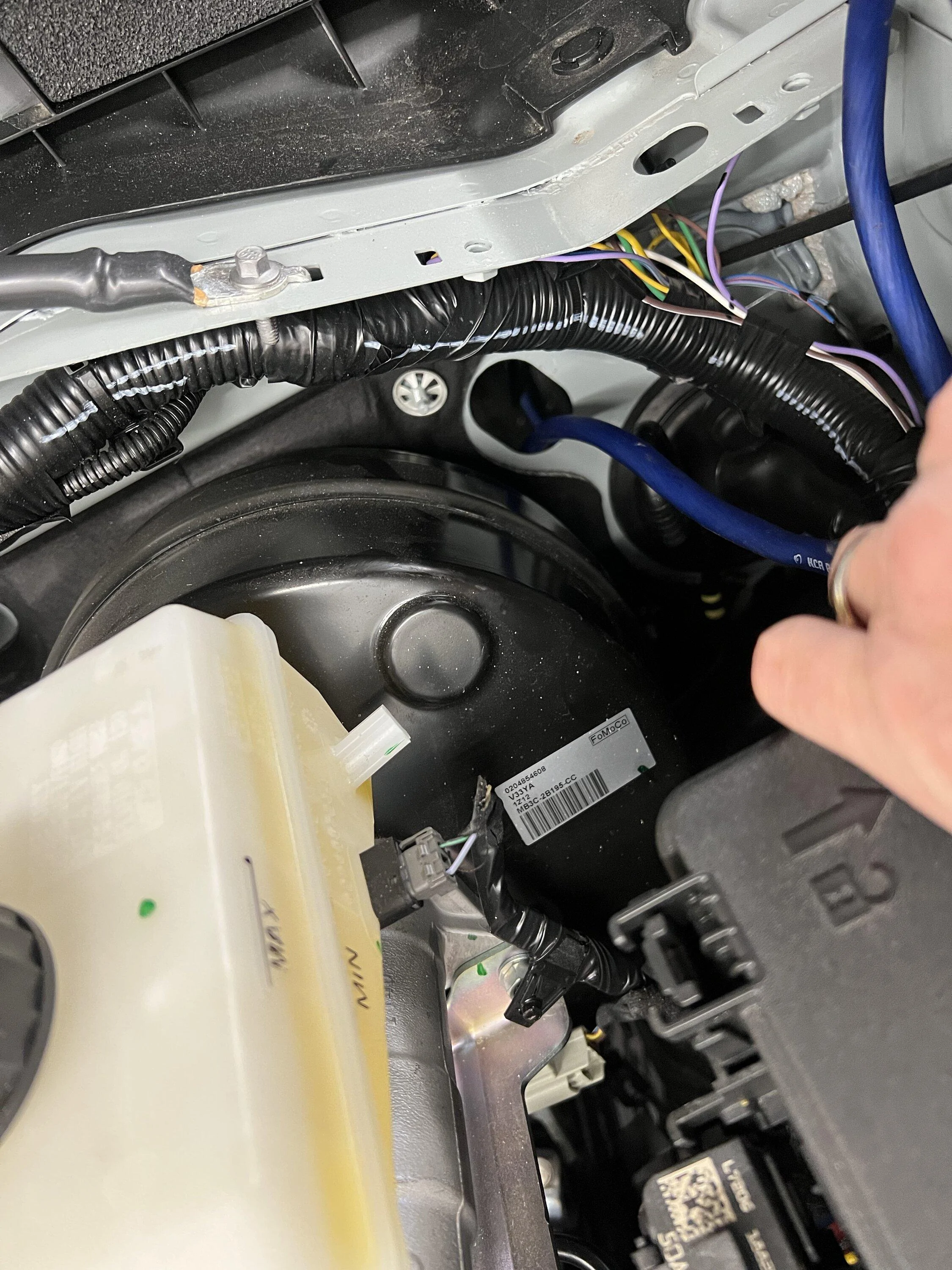

I was Looking for easy hole to pull the power cable to the battery from the amp and on the driver side Ford made very nice big 1” oval rubberized cup you can remove it slice hole in it and send your audio electric cable
I used good quality 4 G cable

It is a convenient location. I’ve got an 8 and two 12 gauge wires running through it to power both Kicker amps and the USB-A/USB-C charger I installed.

Yep, I also used this to run some cable. Very convenient.
