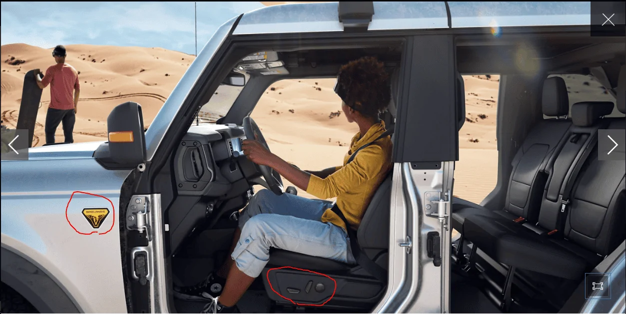

this image on the Bronco Ford page shows a Badlands with power adjustable seats

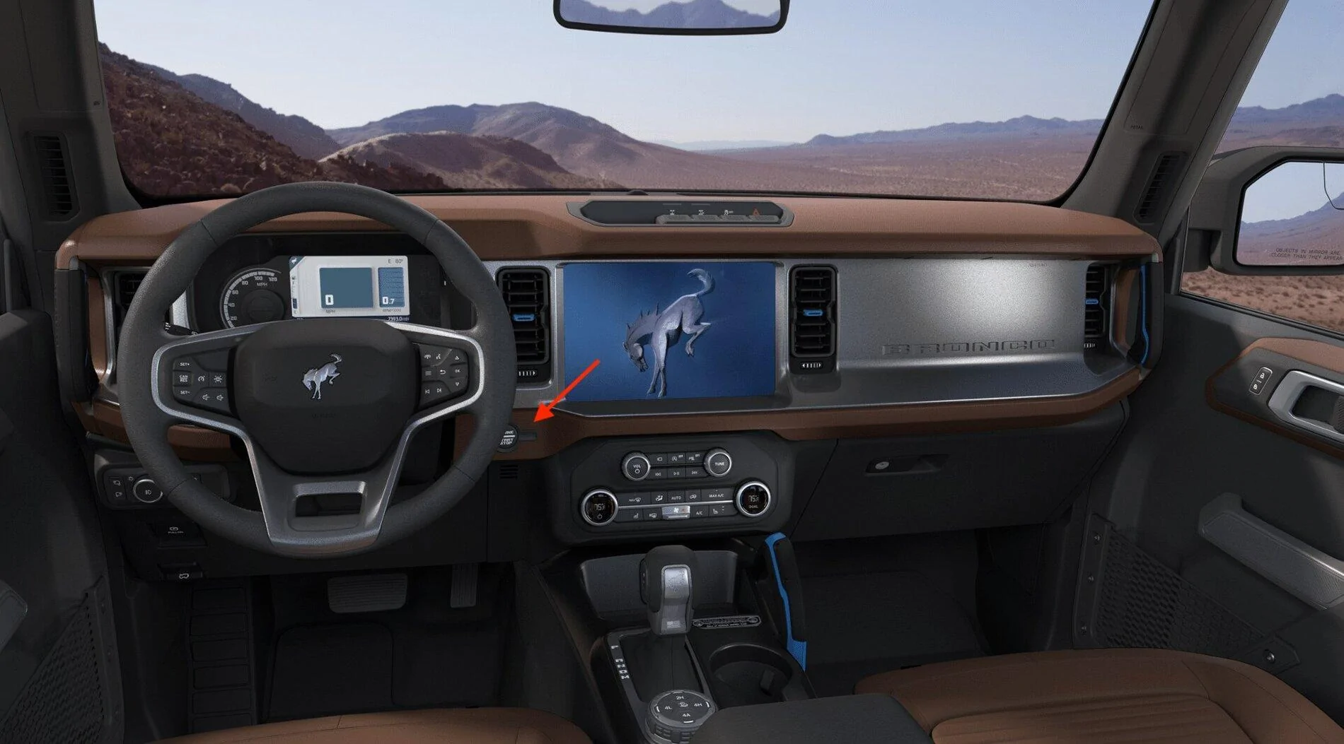

That picture is a computer generated image. Just like this Badlands apparently doesn't get a gas pedal ;)

I also noticed the orange accent is missing from the photo as well. probably before they knew what the package looked like in it's entirety.

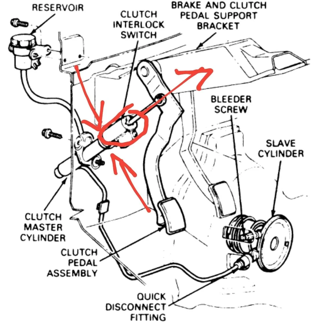

With the push button start, you still have to have the clutch pushed in to start it. The problem with remote start in a manual vehicle is that you have to have a clutch override, and some people leave their vehicle in gear when parked, meaning it would lurch forward and potentially hit something. I am not sure of a vehicle on the market from the factory with manual transmission and remote start. It is a CYA for Ford.
The clutch interlock/neutral safety switch was a little sensor on a rod, that when you pushed the clutch, it rode up the shaft and disconnected the connection.
My first prototype was a piece 1" length of 1/2" PVC notched to saddle and keep the connection from happening. The down side the cruise control sensed the clutxh was kicked and wouldnt engage fuel delivery.
Prototype two was a solenoid arm that pulled a string that I tied to the interlock barrel, it held for 5 seconds then released. I got the idea from the guys with shaved door handles and remote door poppers. This gave just enough time for the remote starter to engage.

Does adding leather delete the wash-out floor and add carpet? If so, then power seats would be available on the Badlands, with leather and carpet. Not sure, I have not spec'ed out a leather Badlands, I want the wash-out floor and I'm the only one driving the vehicle, so once the seat is set, no major adjustments will be made after that!

No, I am pretty sure that it's been confirmed that power seat adjustment is NOT an option in the Badlands with either MGV or Leather. You still get the washout floor regardless of the choice. I cannot recall the reference because I have read so much!
