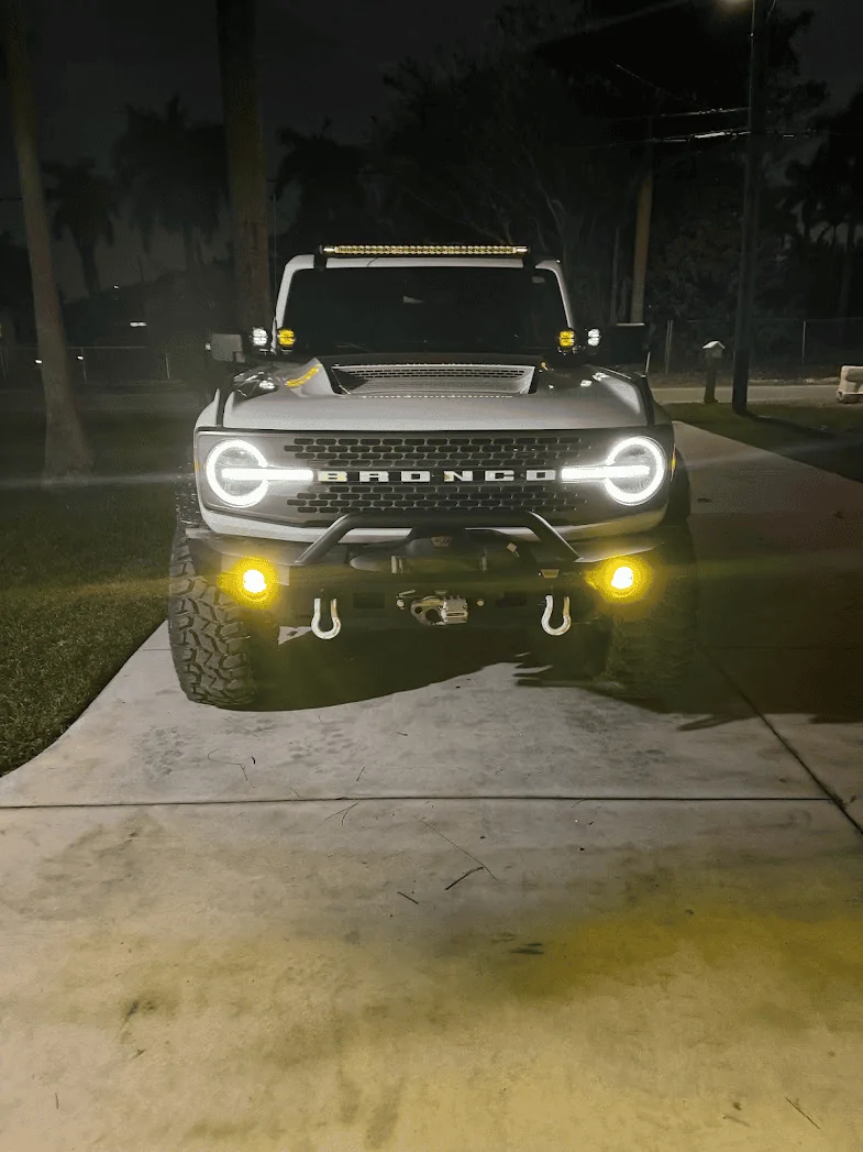

Awesome! Thanks for taking the time to make the video! So dang bright, can’t wait to get these bad boys installed.
That's me testing them out in my parking lot.
Below is Steeda's video of installing it on my Bronco:

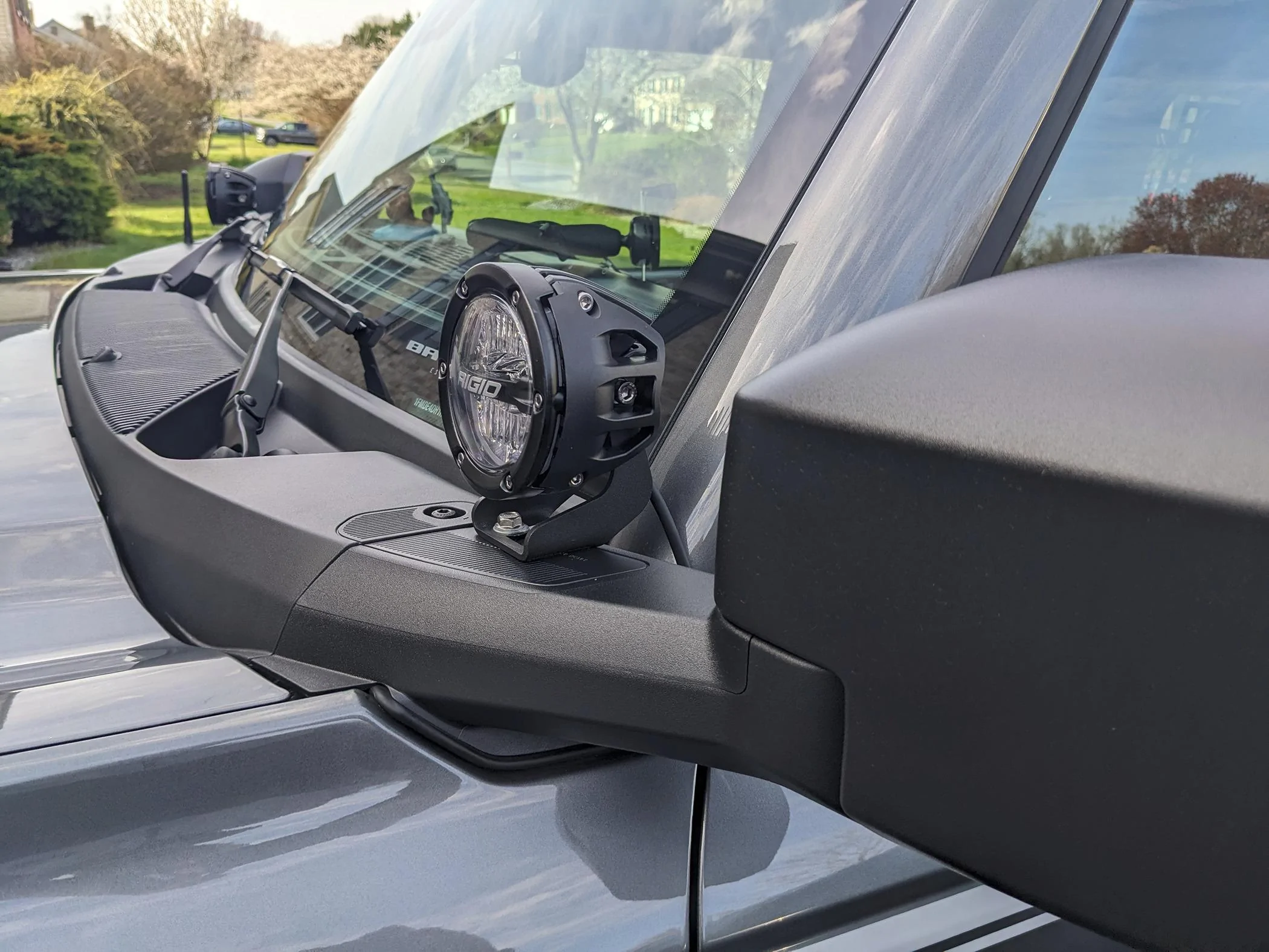

Agree this is all you need. I park by the salt water (puget sound) and they have held up great...look like new. I did replace the oem bolts with black stainless that have more of the theft proof heads to at least slow someone down if they try to take them. Super easy to install and I think they look great on the hood with the round black design. Have bajas in the bumper but I like the 360s on hood they sit low and blend in nicely.was quite easy, hardest part (which wasn't that hard) was getting my hand to reach the wire into the engine bay, here is a list of some stuff I used fwiw:
- felt (under mount)
- blue locktite (mount bolt)
- wire strippers / heat gun
- wire terminals / wire connectors
- heat shrink wraps / electrical tape
- Braided Sleeving (to run the wire from passenger along firewall to aux wires)

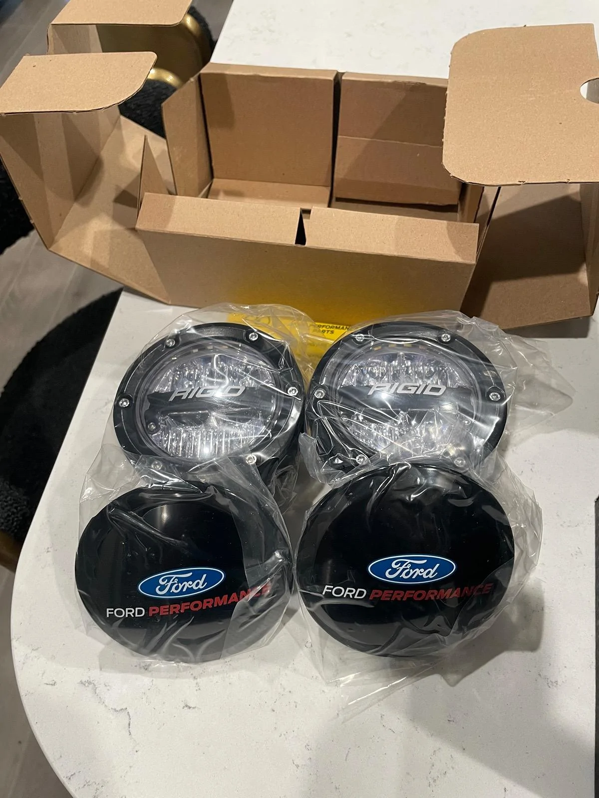

I know Ford sells them as a dual for each side if that’s what you’re looking for:I'm thinking of going this route on my rig. Does Rigid have a spot and flood option if one wants to mount four lights up front? Two facing straight forward with two angled out with floods? I'm trying to decide if using up two aux switches for four lights is worth it. Are the two drive pattern Rigids effective at illuminating the ditch and out? I am mainly concerned about mountain driving, spotting critters off to the sides, and additional illumination out front.
Thanks for posting. How does color temp compare to stock headlights, same, more blue, or more white?

Don't quote me on this because I'm not well versed in the lighting department..but it's literally night and day.Thanks for posting. How does color temp compare to stock headlights, same, more blue, or more white?
I did the dual with a spot and drive on each side. Didn't like it. The spot or rigid direct lights have a stainless no offset bracket. The Ford version has an offset black bracket. I would do 2 Ford drive lights on each side if you want dual so you get the black matching brackets and ford covers. I didn't think the spot did much. Now I just have one ford rigid on each side of the A pillar and 3 bajas on each side of my bumper and it is plenty of light....together about 24k of lumens between the 8 lights.I'm thinking of going this route on my rig. Does Rigid have a spot and flood option if one wants to mount four lights up front? Two facing straight forward with two angled out with floods? I'm trying to decide if using up two aux switches for four lights is worth it. Are the two drive pattern Rigids effective at illuminating the ditch and out? I am mainly concerned about mountain driving, spotting critters off to the sides, and additional illumination out front.

One tip I'll give you is make sure you get some stainless steel hardware and get a proper wiring harness. The hardware they provide you will rust. I've seen so many trucks with that issue. And you'll want a better harness then what they give you (if they even gave you one).
Since those lights just use bare wires on the back we don't make one (you could buy one of our harnesses and just cut the plug off the end though)
