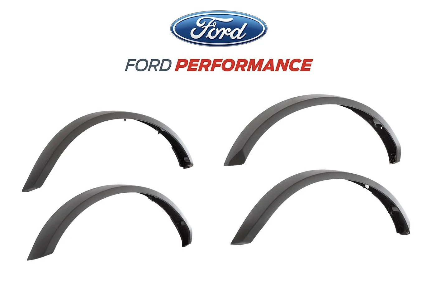

Anyone know what the OEM Fender Flare Material is? ABS ??
Im interested in testing cutting them down, and reinstalling the lip.
Or, otherwise playing with modifying them.

Usually state ABS on back if so. Test on the back with acetone. If it dissolves the plastic you have found the material and solvent used to bond them back together. You put the two pieces together and apply solvent with a syringe type applicator at the seam.
