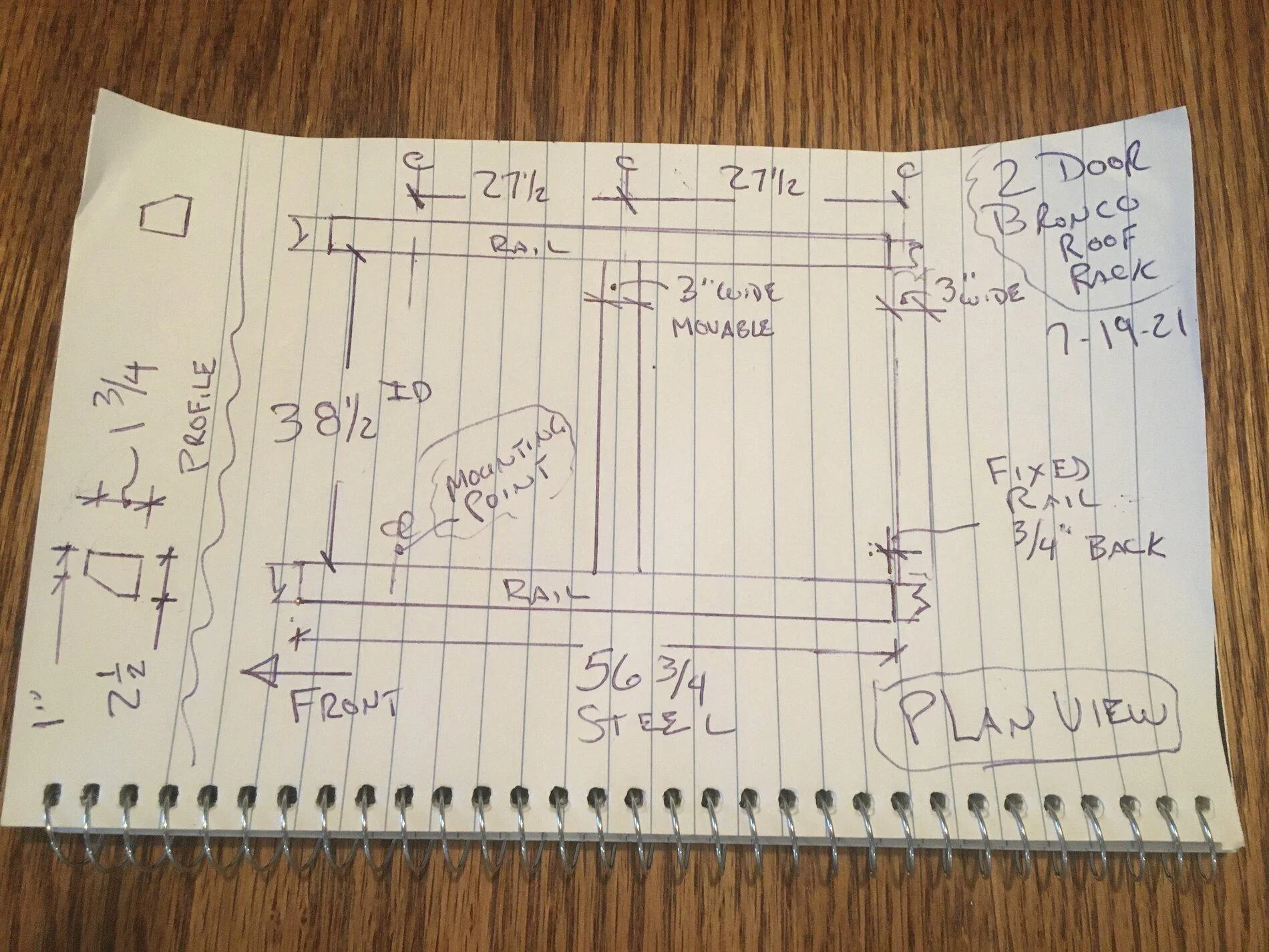

Can someone with a factory roof rack please measure the distance between the 2 roof rails (from the inside)?
As requested, I made a rough sketch of the Roof Rack Dimensions.
@dejones64
ID between the rails = 38 1/2"
Rail length between caps = 56 3/4"
Center between fixed back cross rail to mid cross rail = 27 1/2"
Center between Mid cross mount and Front cross mount = 27 1/2"

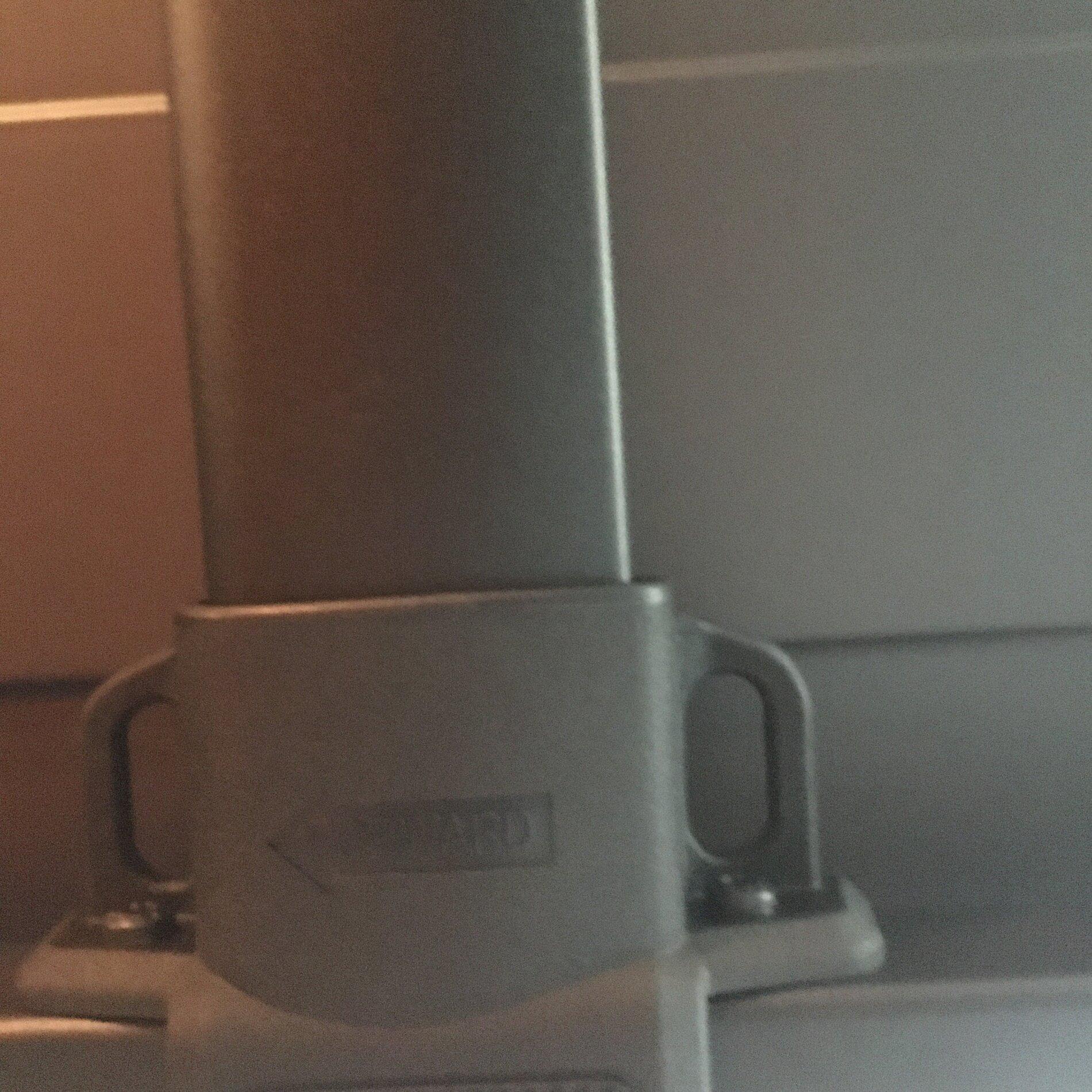

Photo shows the tie-off points where the cross rail meets the main rail
These dimensions were taken with the rack mounted.
Will update / refine as needed when I post on the rack removal.

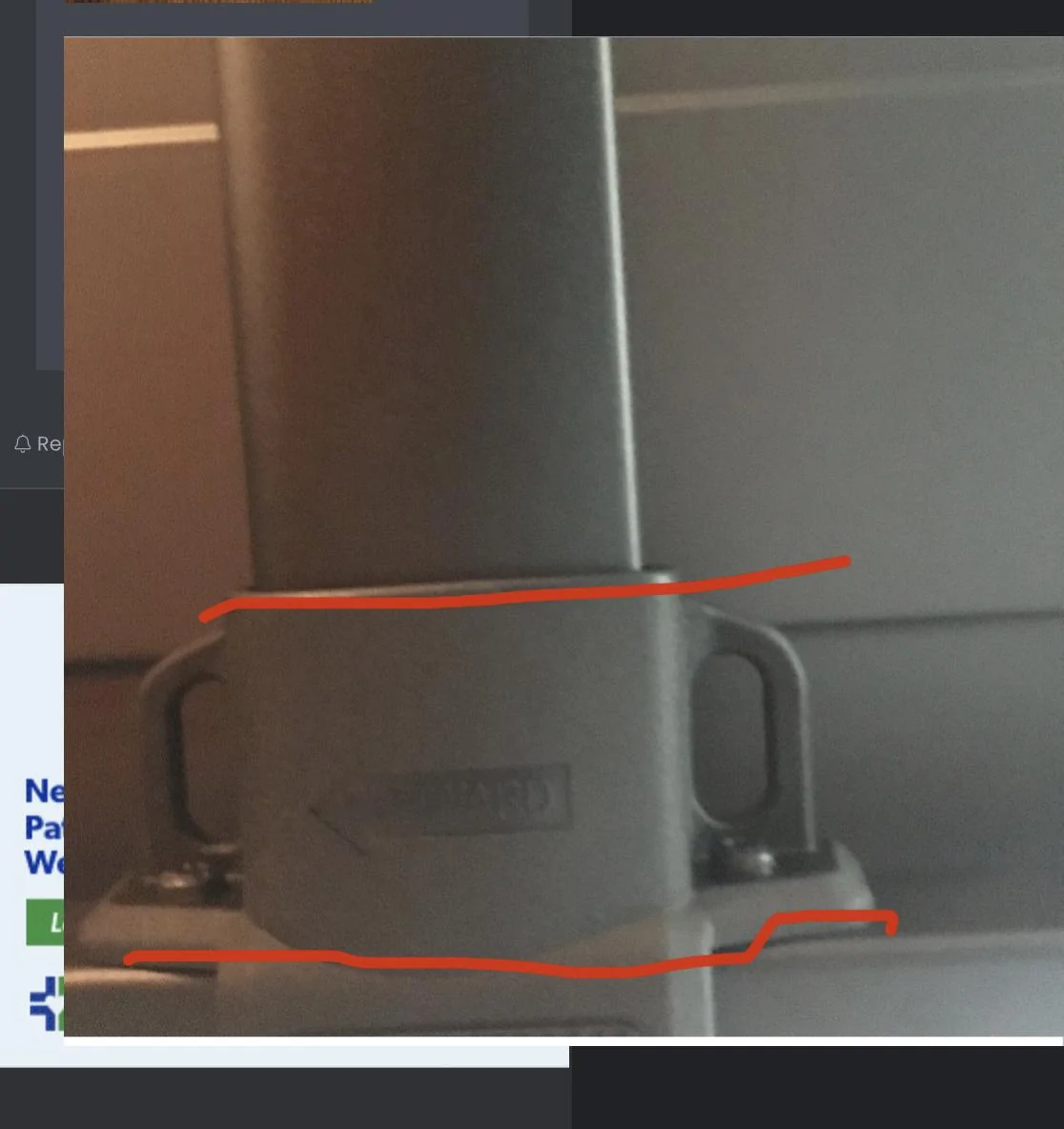

super helpful. Do you happen to have the dimension between those 2 red line in the attached picture? I am trying to determine the usable width, and the tracks of my tent need to mount directly on the bar.
So unfortunately those bar mounting points on the side are lost space for me so it’s gonna be less than 38.5"
thank you!
thank you!
33 3/8" ID on the mid bar and 36 3/4" on the back fixed bar. The bar is not flat. It has a slight curve.
