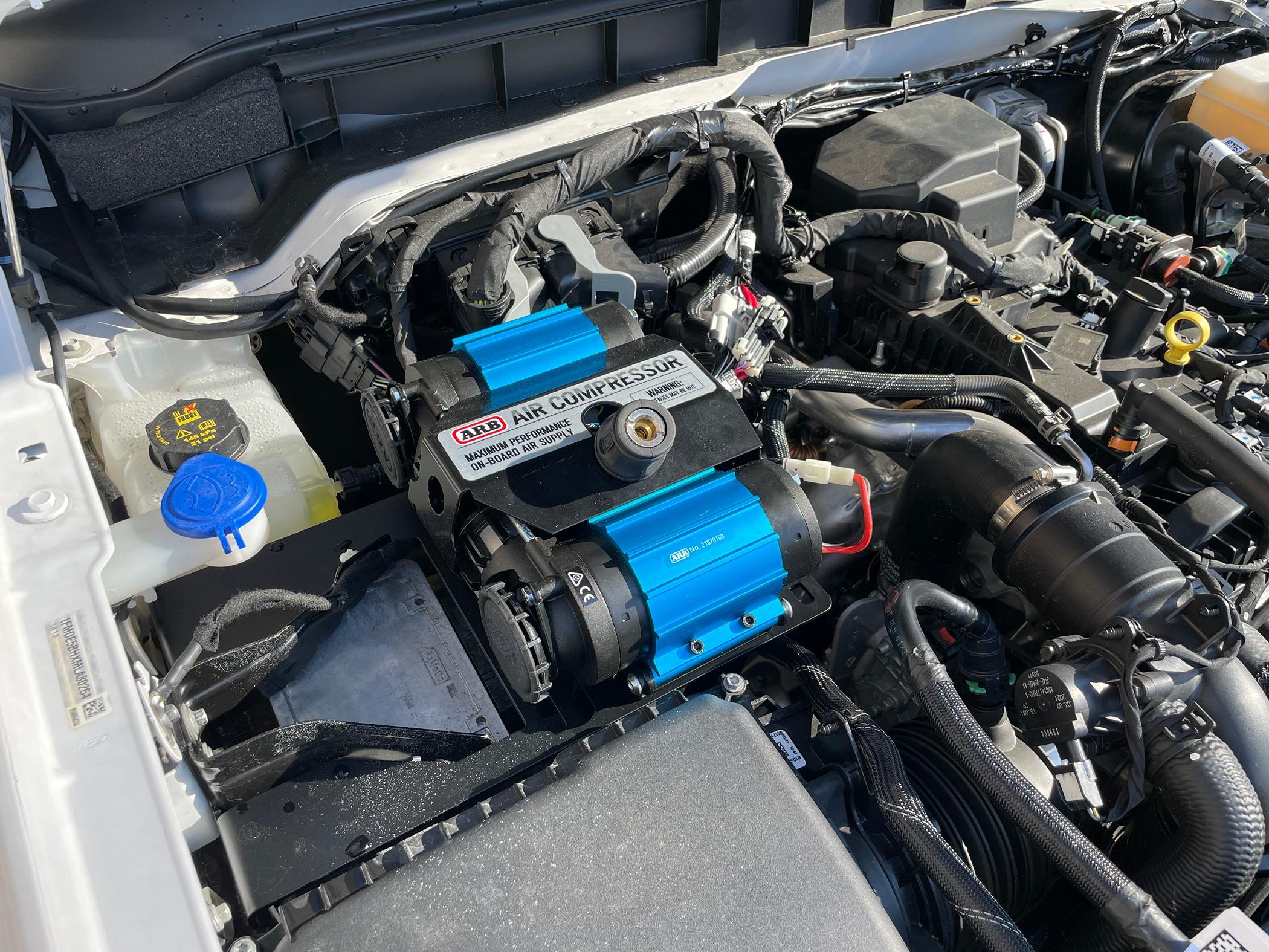

Yup. We actually have our patent pending air compressor mounting system for the Bronco available right here: https://www.4x4truckleds.com/kr-off-road-air-compressor-engine-bay-kit-for-2021-ford-bronco/
This mounts the ARB air compressor under the hood.
The rest is custom. We've had customers mount a coupler in their front bumper. Others put 2 (one on each side) but it's all custom at that point where you put the coupler. There is no "kit" for that what you want (the gas tank one). We even have one customer who has a flip down front license plate and when it flips down, he's got his air connection right there.
So you'd have to do that part custom. But as far as mounting the compressor, check out our kit. We were the first ones to come out with the onboard air solution and it's one of the most popular systems (and easiest to install)

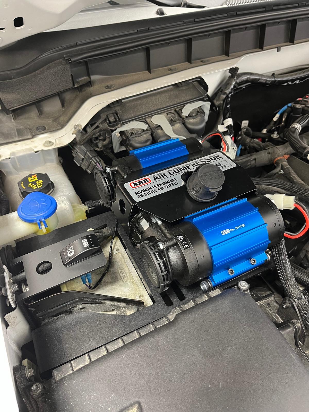

I went with the 4x4TruckLED one and am very happy with it. I opted to keep the switch under the hood vs. using an AUX switch, as I felt if I'm hooking up under the hood I would rather have the on/off switch right next to it for convenience.
You could easily relocate the hook up connector elsewhere though.
