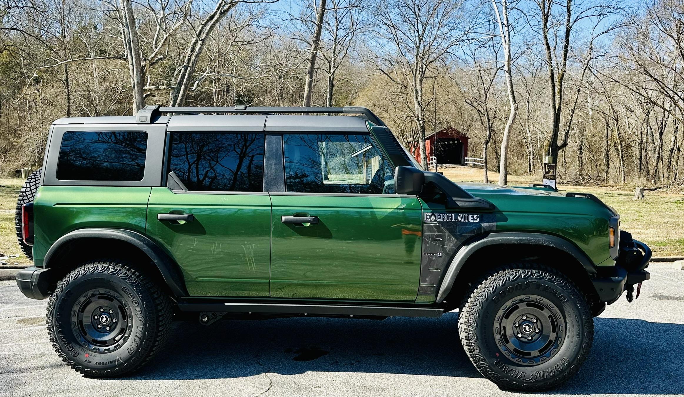

I don't notice any significant difference in rake on mine based on other Broncos I've seen.
This photo is at a slight angle so it may be a little hard to tell. I can try to do measurements if I have time later.

What a beauty. It looks pretty dang level in this picture.
It’s right around 1.5” higher in the rear according to my quick measurements.
