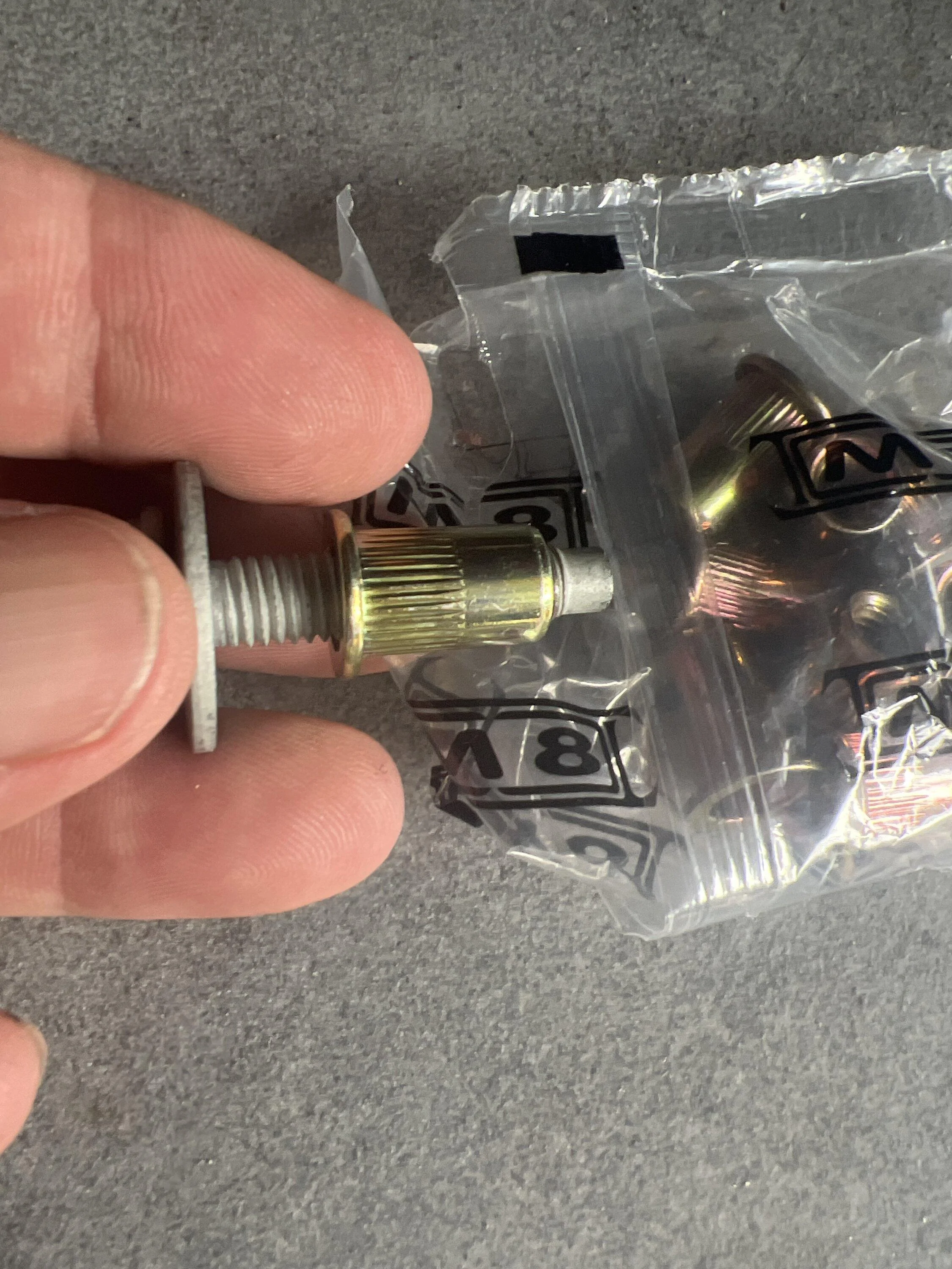

M8
Ford Bronco Door Hinge Bolt Size Gauge? imag
Ground_zero298
Apr 5, 2022
39
2,200
5,577
Scs michigan
2 different ones:
M8 -1.25x35mm flange bolt on top
M8 -1.25x16mm flange bolt on bottom
