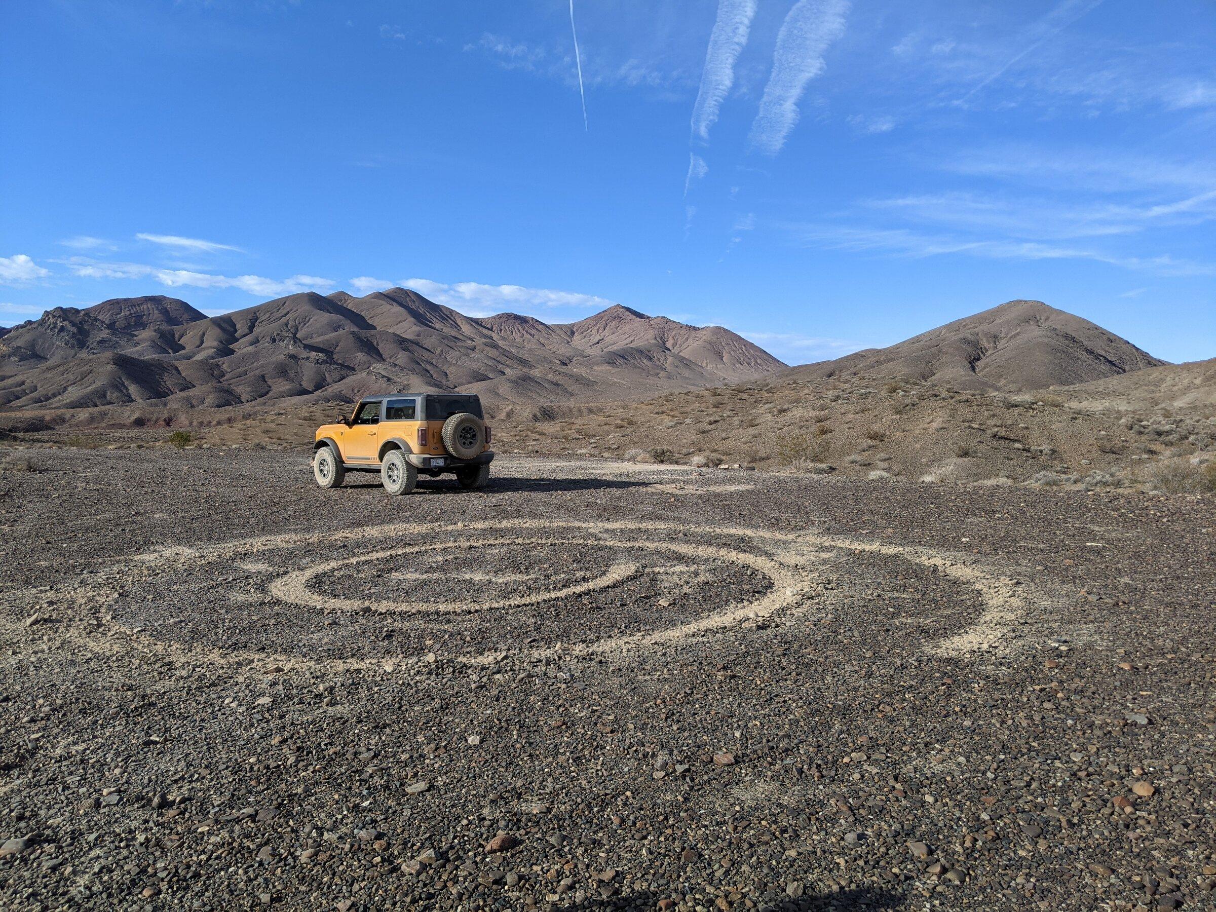

**For snow and sand only:
-Turn dial to Sport Mode
-Select 2H
-Turn Traction Control Off
-Hold Traction Control Button down for approx 8 seconds...
-Turn on Rear Lockers
**Do Not repeat these steps on Asphalt!!
