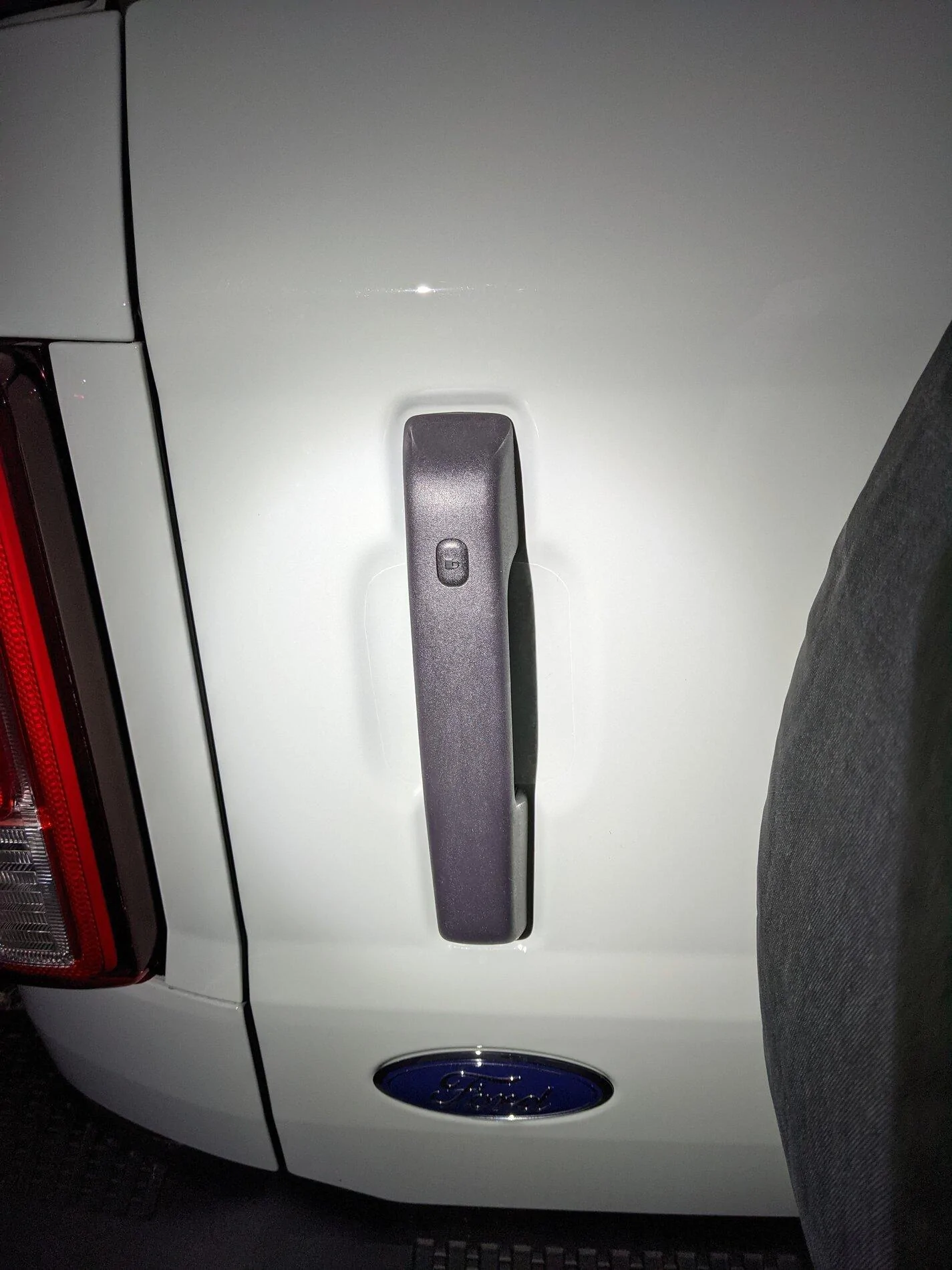

Being cheap, I ordered a 6" x 17' roll of xpel to do the front body colored portion of the bumper and the A-pillars, rather than the pre-cut which would have been 3x more expensive.
That left me with some leftover material to do the door cups, and prevent all those fingernail scratches when grabbing the handle.

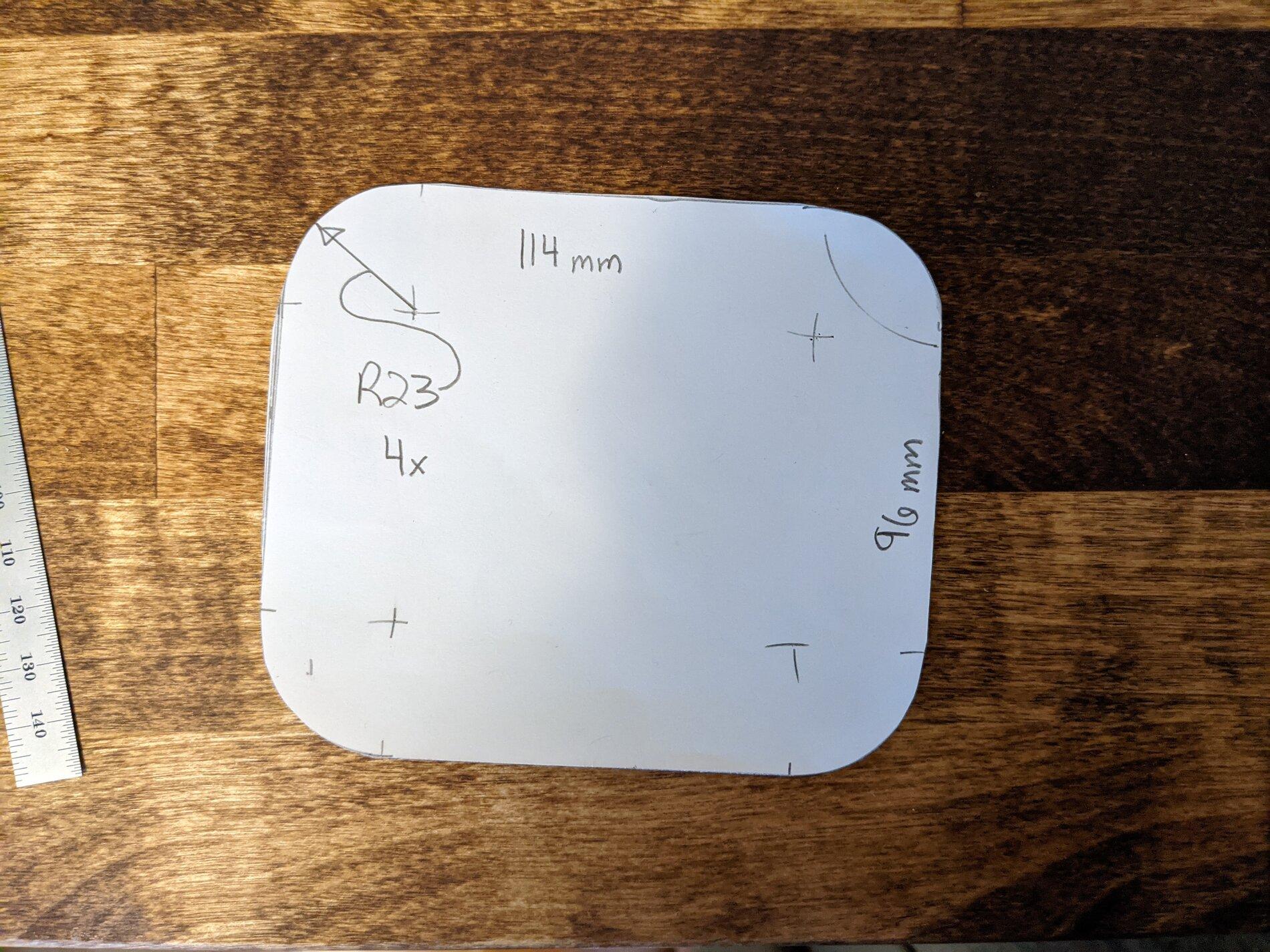

Here's the template, and an image of it installed.
Note the 114mm x 96mm dimension is before rounding off the corners.
The same pattern works on all three handles on my 2dr.
