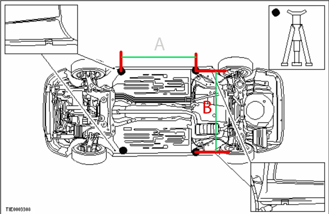

Can someone with a 4 door do me a big favor and measure the length between the jack points front-to-back (A) and the width between them side-to-side (B)? Thanks!
