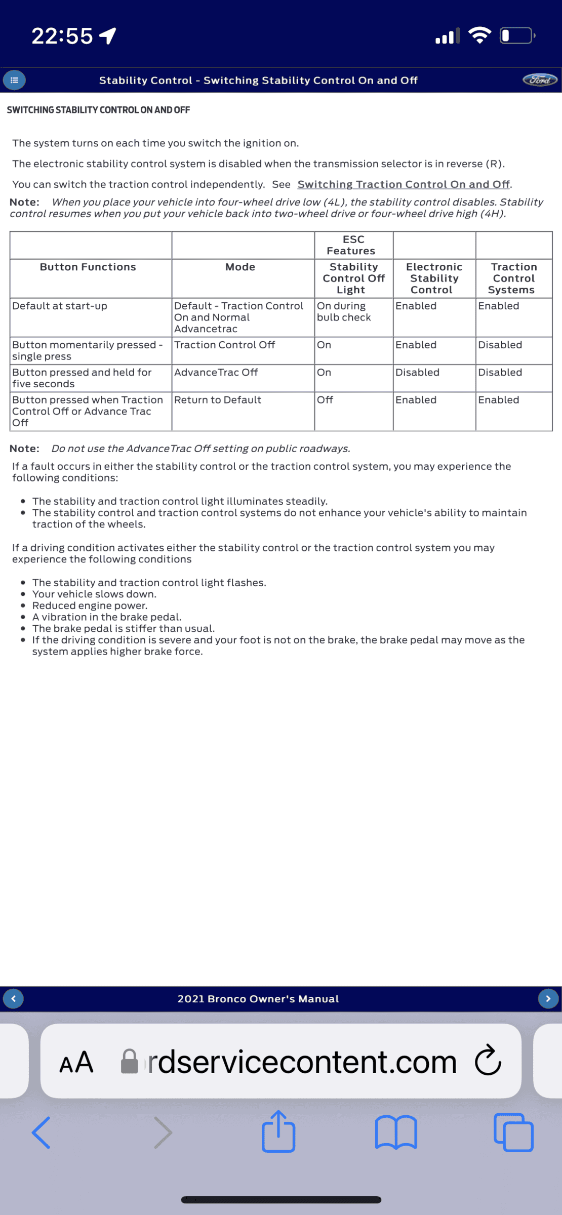

Silver-Bolt
Bill
3,173
5,308
Eureka, MT
2024 f-250 Tremor 6.7L HO, 2023 Wildtrak
You can't turn it 100% off without pulling the fuse or disconnecting a wheel sensor. Ford's "off" from holding the button down for 5 seconds still has some nannies in play.
