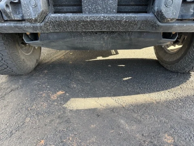

I plowed into a rut the other day that i didn't see. I hit it hard enough to bend the IAG front skid plate pretty good, but the airbag didn't go off. I was running in Baja mode so maybe they are less sensitive.
