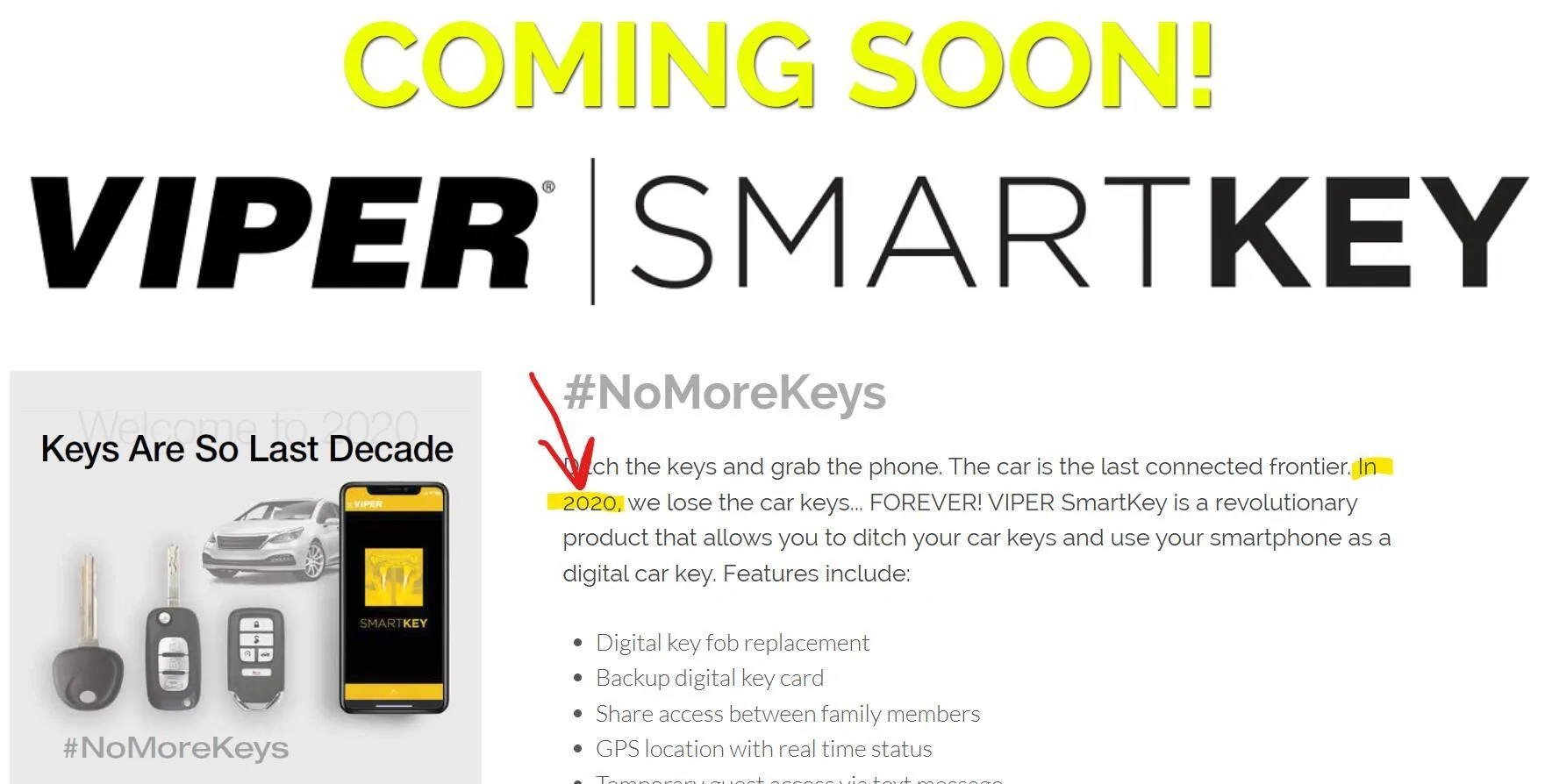

I got $50 that Ford will add Phone-As-A-Key to the Bronco well before that product even comes out. Checked the product page and looks like it was supposed to come out in 2020... it's now 4 years later and still "Coming Soon!".
Ford Bronco Digital Smart Key #NoMoreKeys 1724336242804-qi
Anyway, I personally have zero desire to use my phone as a key. Heck, I just left my house this morning to run some errands and the thing I left behind was my phone. But as someone who works in the Computer Engineering/Cybersecurity world this stuff is still very interesting to me.
Yes, I noticed that it said 2020, ridiculous :). I am an engineer(Aero) also an a hobbyist IT/Cybersecurity nerd. Currently setting up my smart home.
