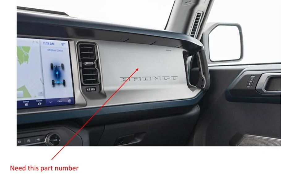

Hi all - I need to order the dash part in the image above but can't find he part number. Mine came with a few chips on the bottom under the screen which make me crazy. My dealer is useless as T_TS on a BULL! Any help you could provide would be most appreciated.

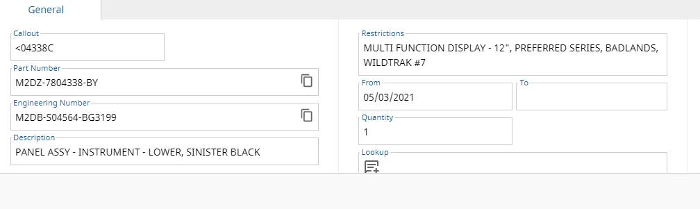

M2DZ-7804338-****
The **** will vary based on the exact model/trim/color/equipment package. Should be a 2-4 character code.
MSRP is around ~$600. Most dealers can probably get it to you for mid-to-low $500.
