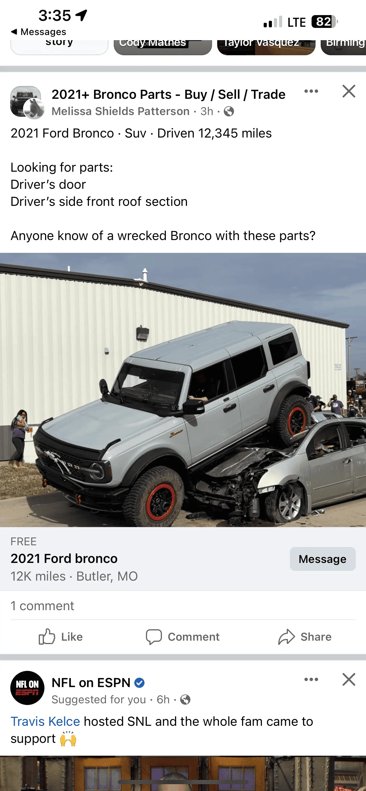

How much would it cost to get a hardtop painted to match body color??? This looks dope
Ford Bronco Cost to paint hardtop ? 9A6CF884-D6B9-461A-B4D9-AB24F4711882

The photo appears to be a wrap. To body work and paint the top I would guess in the $3k-$4k range to do it right. Remove and reinstall the glass, etc. Seeing what I have seen in the top construction, as a painter, I wouldn't touch it. The "skin" of the top is extremely thin. Not much material to sand flat. That means adding a high build primer to build up enough surface to sand it flat. The way the top moves around on the rig, the paint is bound to crack and chip.
I agree
Although flex additive works on bumpers but I’m no painter

Would a wrap be a better idea?
