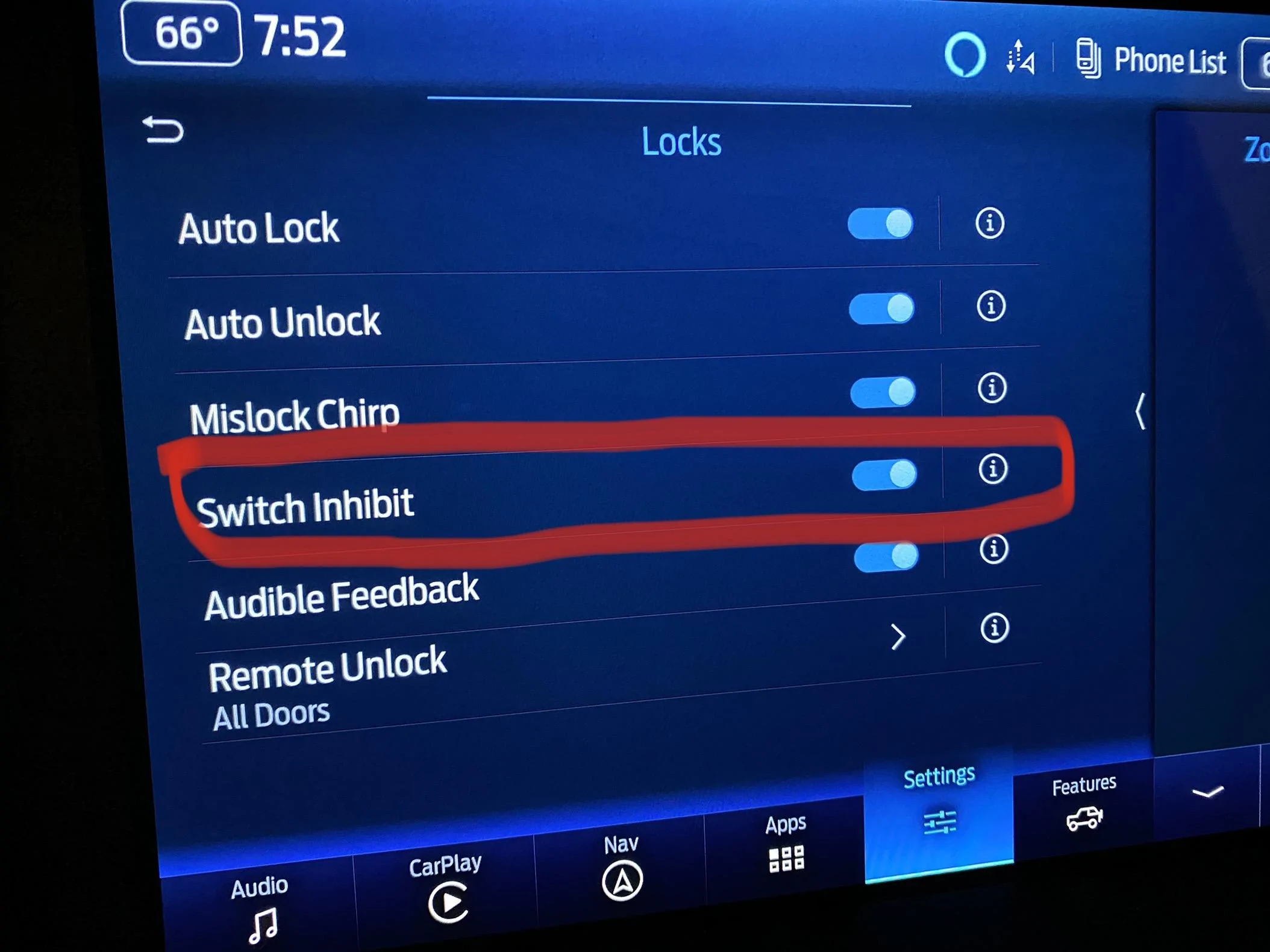

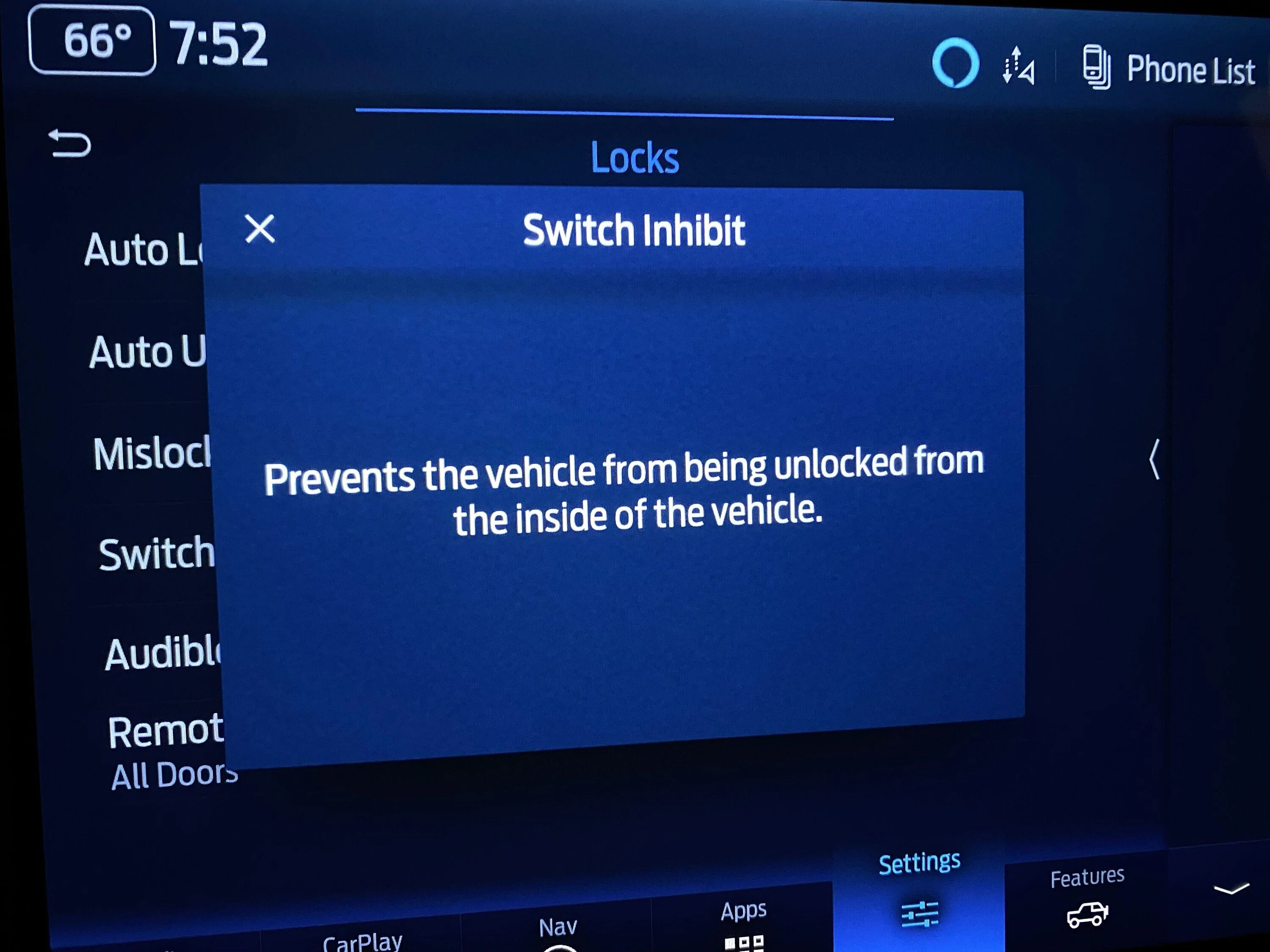

Looking at different cargo security systems and want to buy diabolical slipstream for when top off, but seems pointless if anyone can just click unlock on door to unlock rear swing door. Is there a way to disable unlock when a key is not present?
Never found anything in the owner's manual about it, but for future reference, there's a setting for that:
[Settings > Vehicle > Locks > Switch Inhibit]​
It disables the unlock button on the doors 20 seconds after you lock it with the fob/handle. I tested it on mine and it works as expected; if the key fob isn't nearby, the unlock button is entirely disabled.
