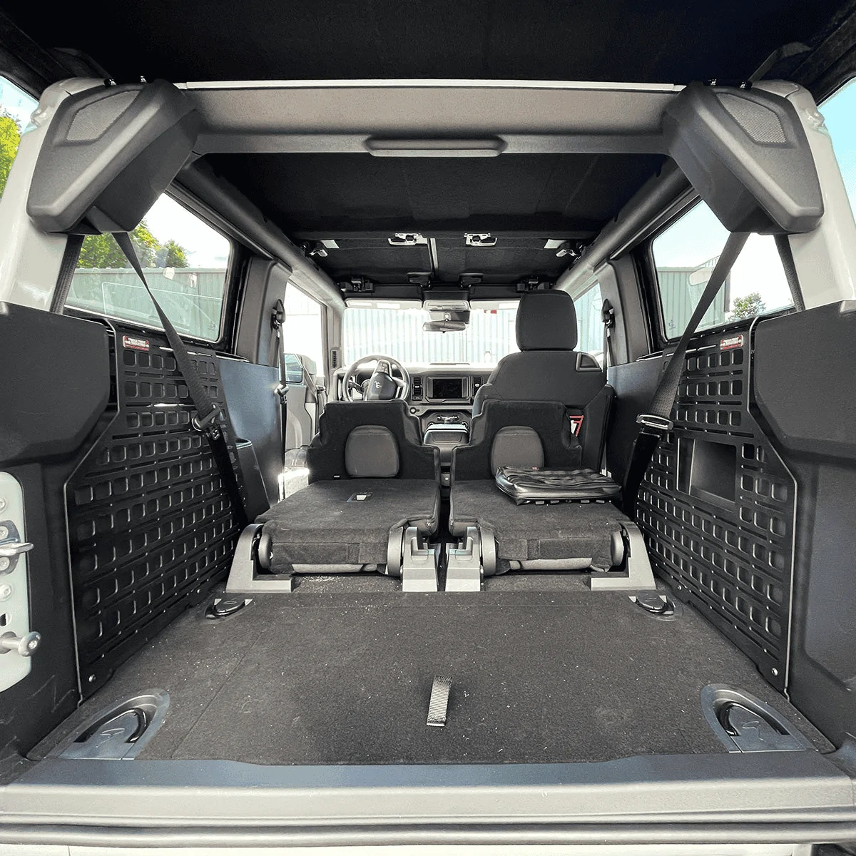

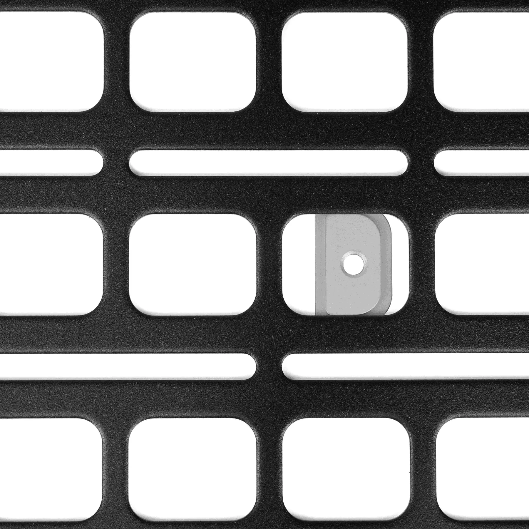

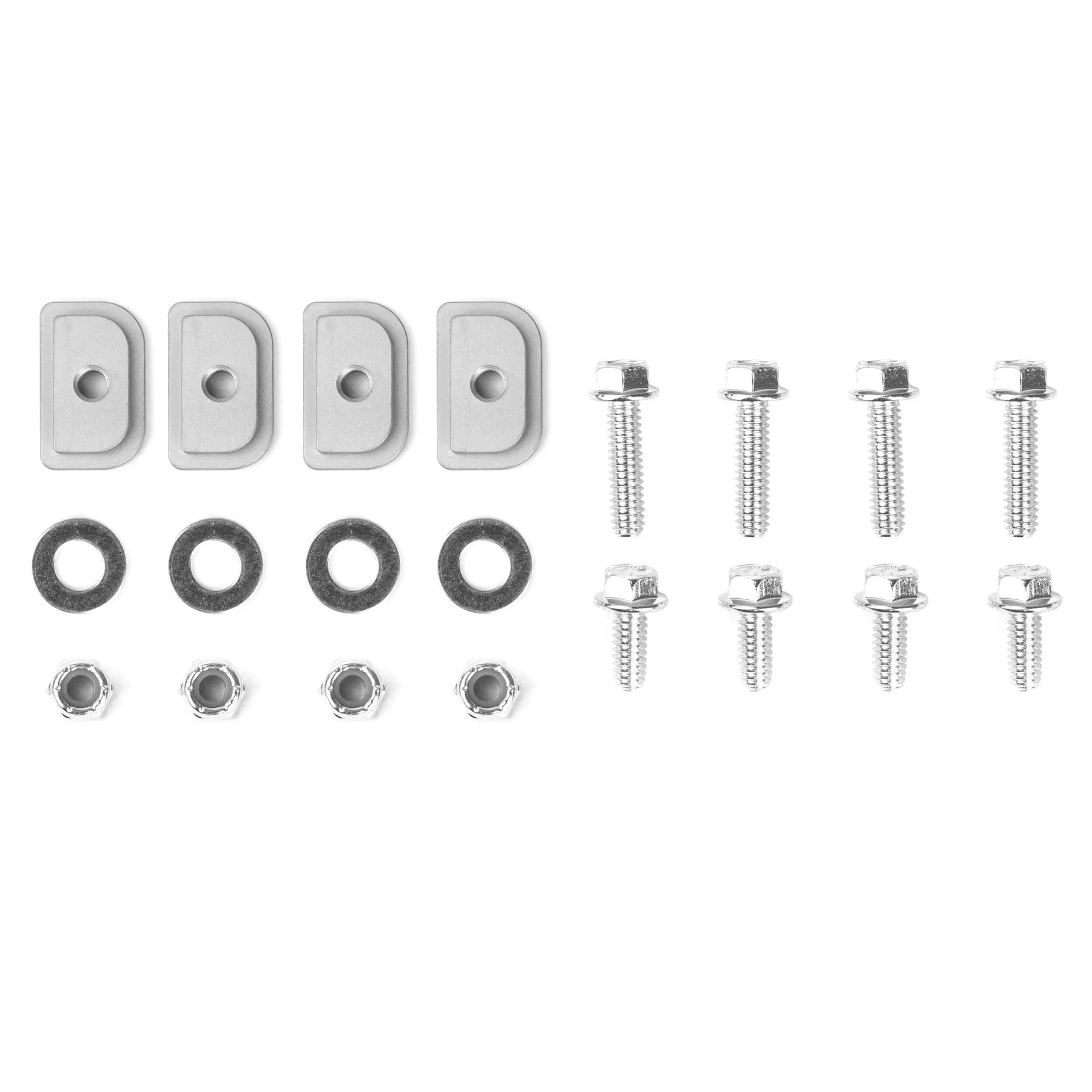

You were asking if BuiltRights proprietary molle nuts will fit/work for your seat back molles. In another posters picture below you will note the shape of the squares/rectangles, whatever you want to call the shape. The BR molle nuts have a very distinct curve to them on the inside portion that fits in their panels and prevents it from turning when trying to tighten down the bolt that comes with their system, really meant more for a precise metal cnc'd cut, not this plastic webbing (IMHO). I was suggesting two things, the first being that I am not sure how great of an idea it is trying to tighten down their metal nut and bolt system against the plastic seat molle panel. The other thing I mentioned is that the dimensions/curves of their nut system may or may not work on the shapes of the below molle back. That's all. Sorry if I made it more confusing.

These
Ford Bronco BuiltRight Molle nuts 1645198763813
Are meant more for these:
Ford Bronco BuiltRight Molle nuts 1645198828075
and these:

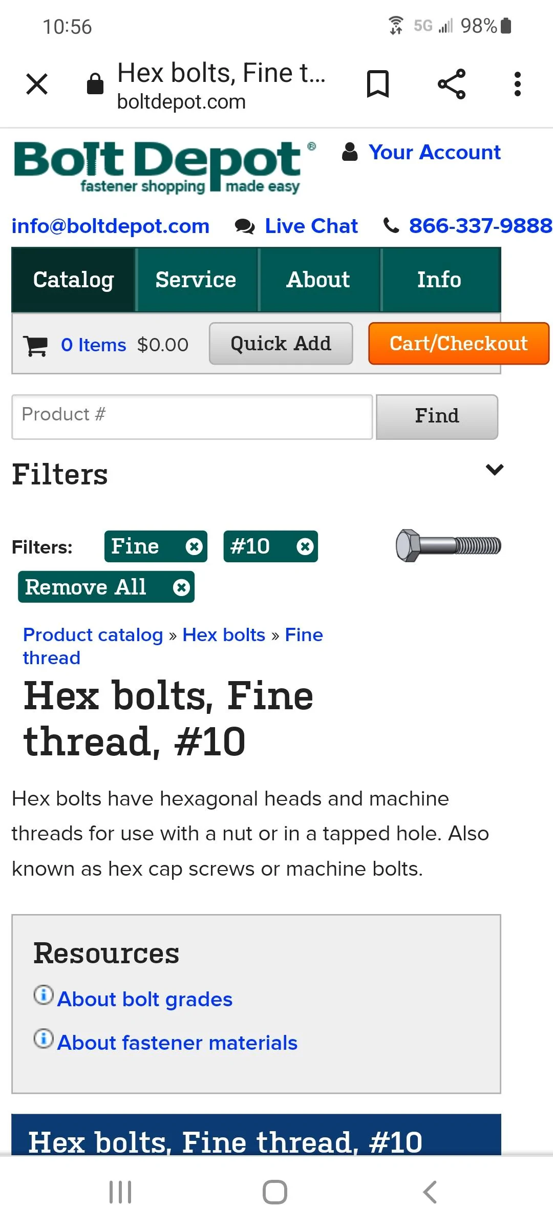

No not at all man! I'm in the dark here so anything helps. What is a "regular #10" with the nylocks you were talking about in your first post?

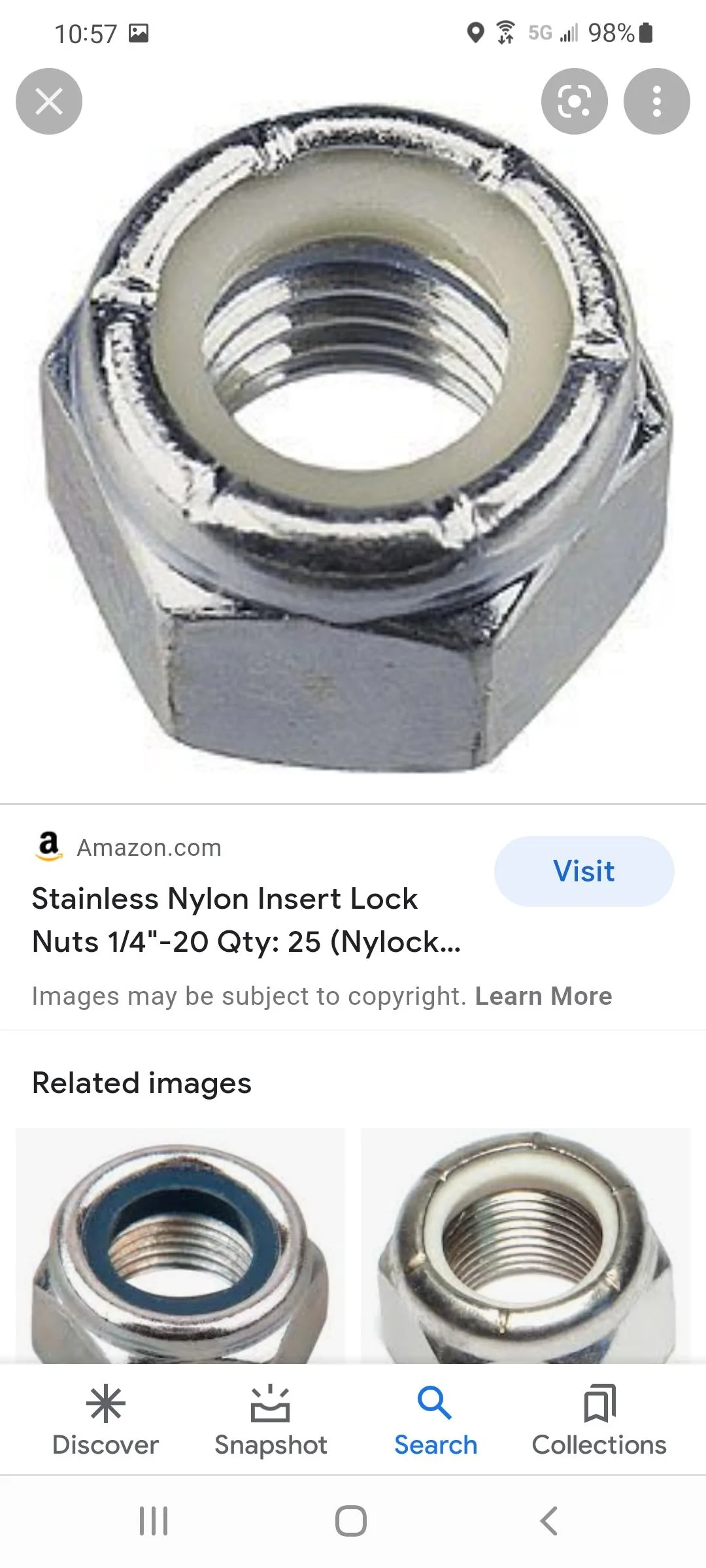

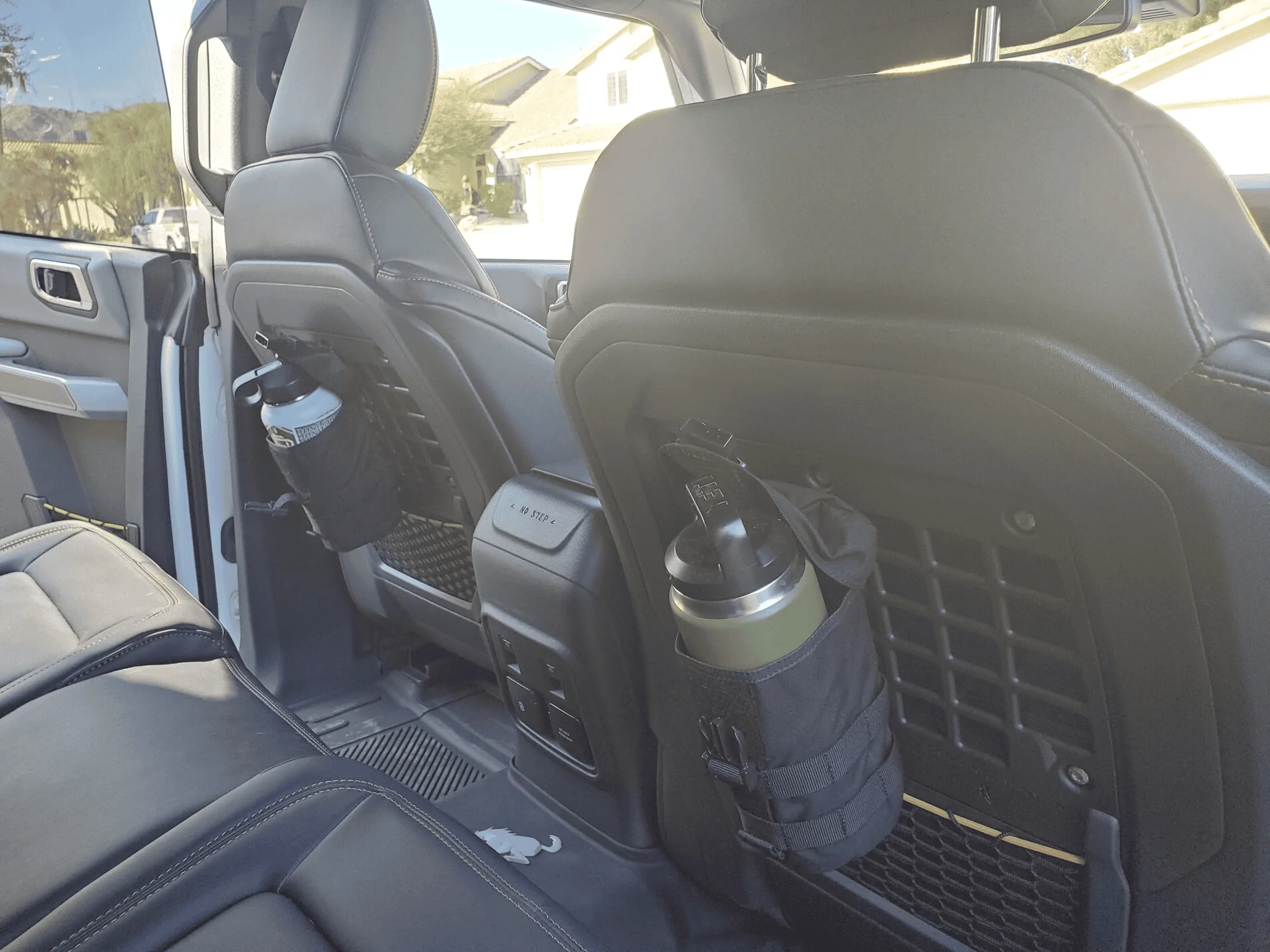

See below, but when I referenced these, I was referring to using them on BR's metal molle panels for use with their clamps (instead of their proprietary molle nuts) not using them for the plastic seat back molles, you definitely wouldn't use these for that. If it were me, I would grab a couple small carabiners and a couple molle pouches for water bottles and call it a day. If you have young ones, that is a little more tricky.

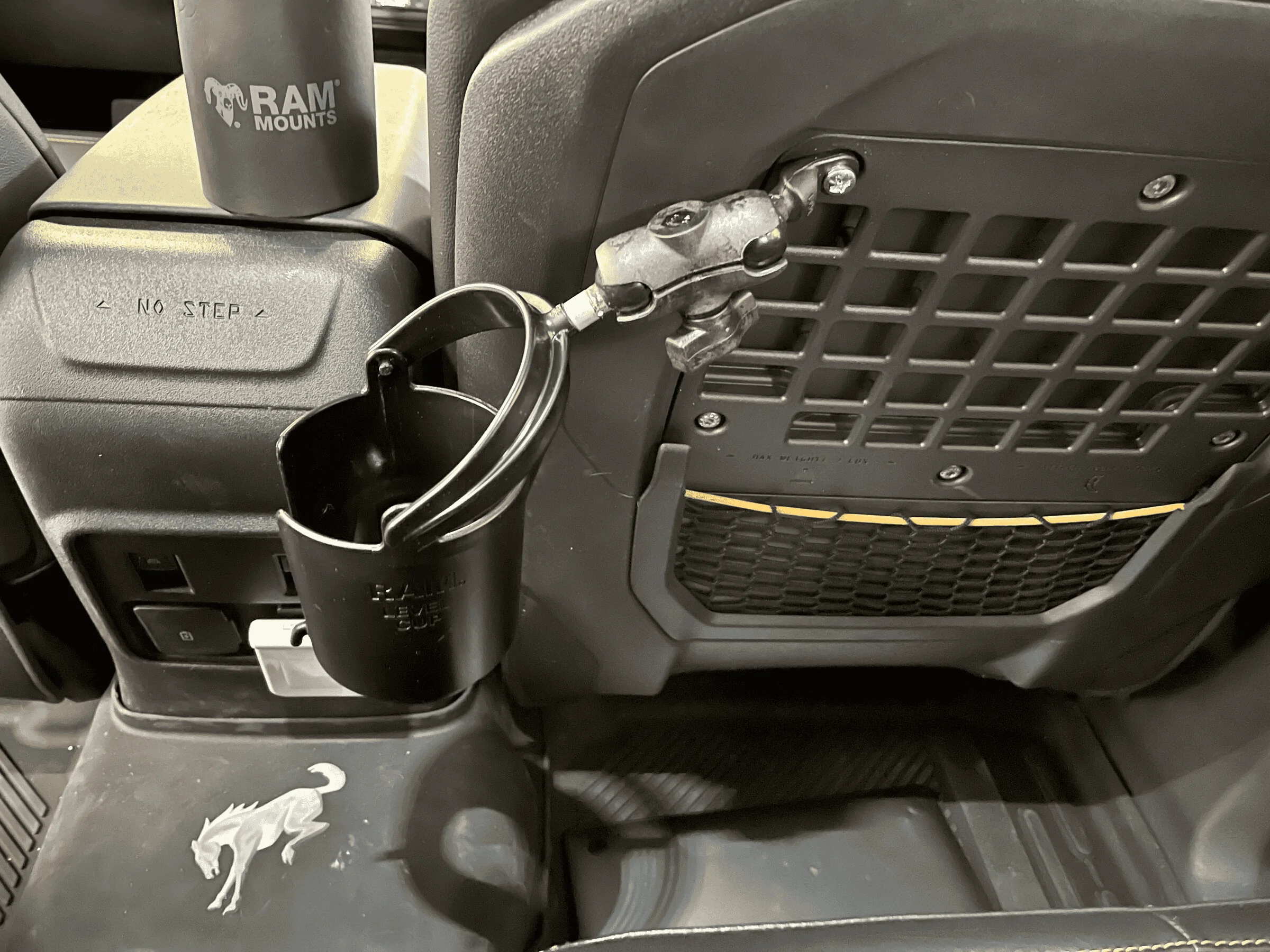

Thanks @Herbie I've taken up plenty of your time! I do have little ones in the back and was thinking about a cleaner setup than this, although it looks pretty damn good! (credit: @doccoch )
