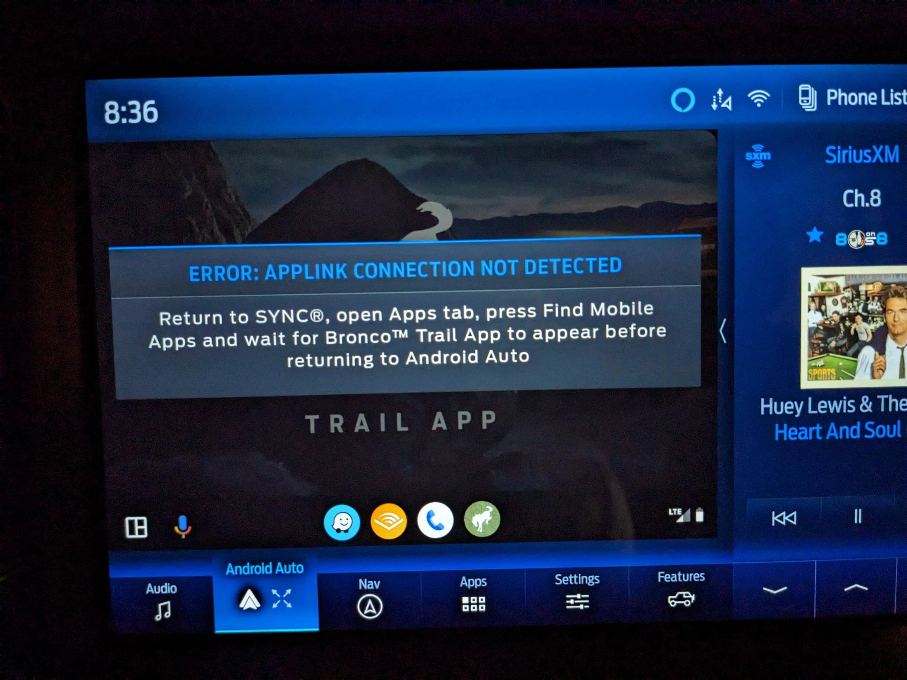

Oh no. That’s the point. Hit the big red button…..crash😂. But someone is claiming it’s my fault and it must be only me. Despite the king thread here right others experiencing it, or the reviews on App Store with others experiencing it. But gotta be just me right.

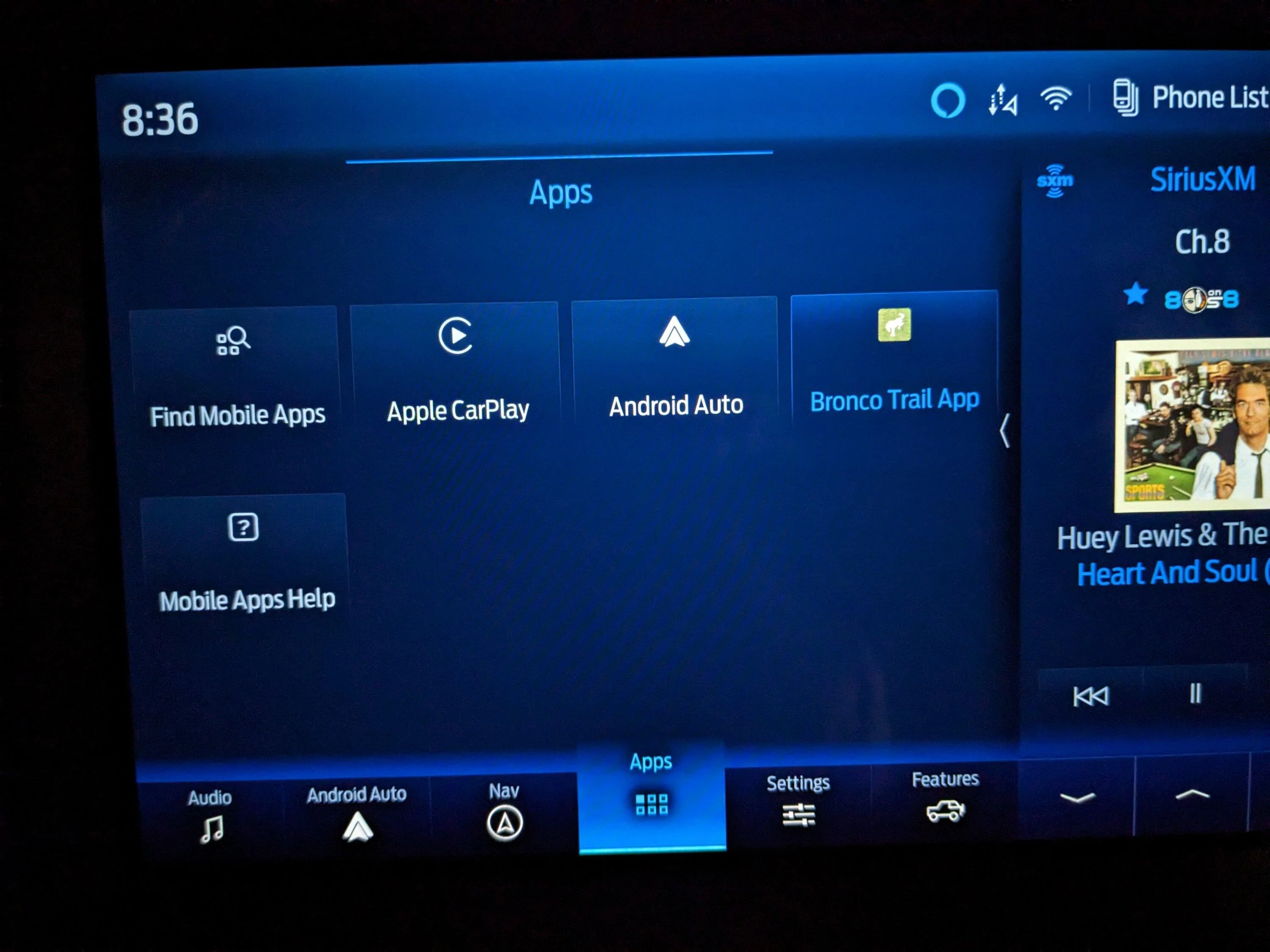

I figured out that you have to do things in a particular order.
1. Make sure Bronco Trail App is NOT running on your Android phone.
2. Start you Bronco and allow Android Auto to connect.
3. Select the Bronco Trail App on the Sync4 screen in the Bronco
4. Once you have the map displayed in the Bronco, press the [camera] icon.
5. It will say that you have to start the app on your phone. Now go ahead and start it on your phone.
6. Suddenly, you will see the video being shot from the camera in your phone on the Sync4 screen.
7. You will have to mount your phone to your windshield or dash.
Note: when you start driving the screen goes black but it is still recording. When you stop the video displays again. When you hit the [<] button the recording ends. The actual video file is on you phone and the overlay of the roll/pitch, speed, rpm, etc. shows up on the recorded video not the live display.
Hope this helps... figured it out by trial and error.

Tried using the camera function today on the trails, was excited to try it out…. And crash….. reset everything, and crash, again crash…… followed the steps and then boom crash

This did not work for me. I hope they figure it out and release an update.
