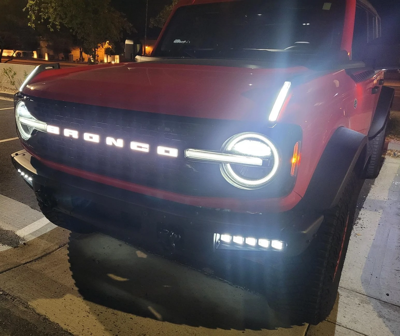

I have the Putco ones and had to do several things to make this work
1. There isn't enough power coming from the Headlight harnesses for this to work so a relay is needed.
2. The white halo lights only come on at night when the button is set to auto, which is selected every time the vehicle is started. When this is wired in, I need to turn on the drls manually each time I start the vehicle for the letters to light up. At night, when the headlights are on, all lights are on.
