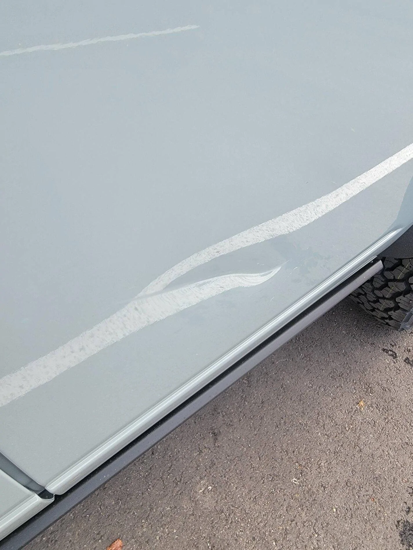

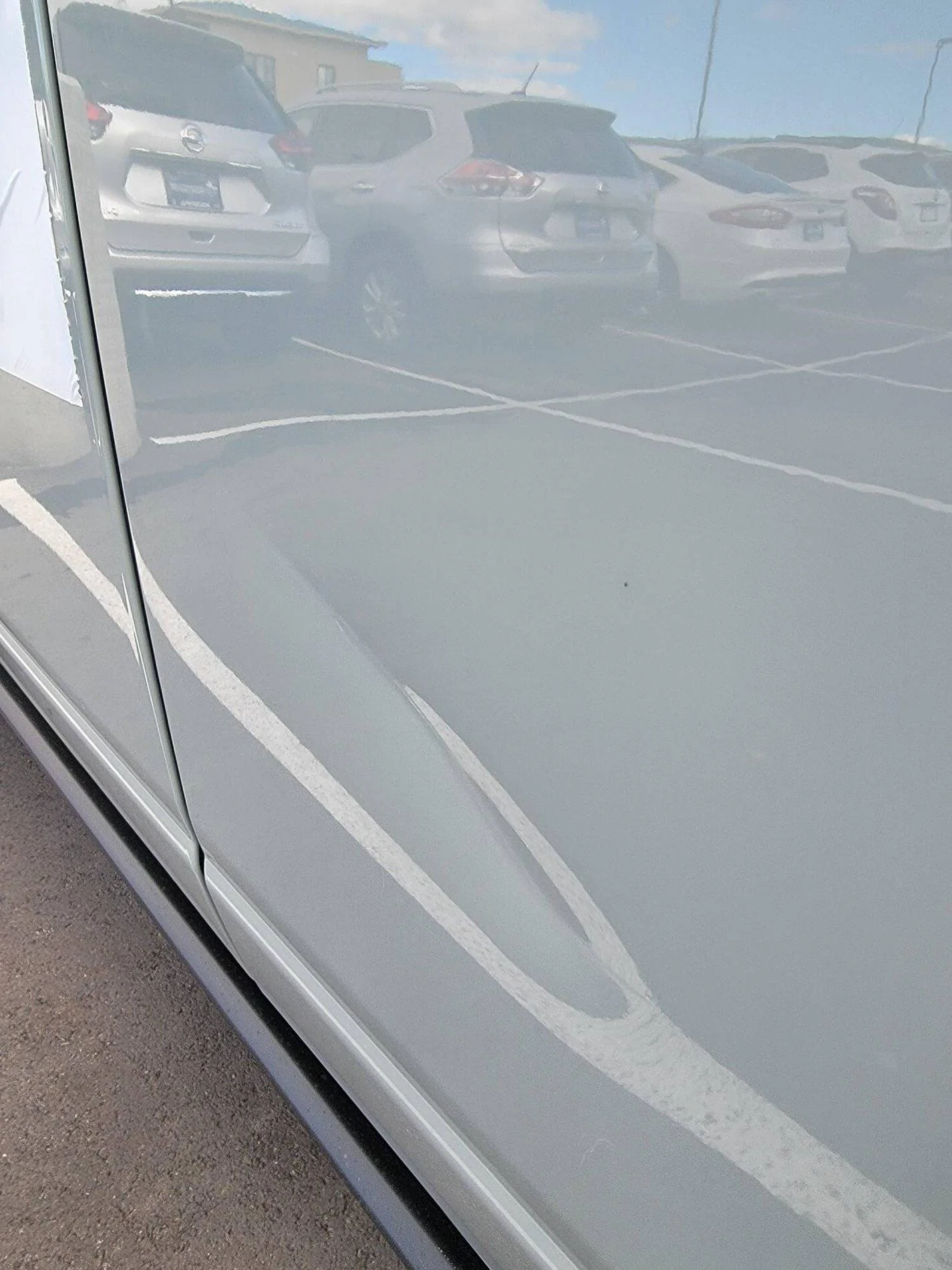

Yes drivers side rear door. We’re surprised they’re fixing it and not replacing the door

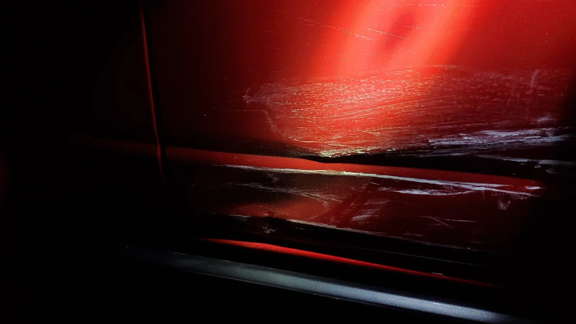

My Bronco was recently hit while parked. It dented the door. I dropped it off Monday for repair.
Ford Bronco Bronco damaged. What to expect? 20211020_222755
The reason I post this is because of what the shop told me.
They said that a door skin replacement is not so good. It won't be like factory. Plus they found an additional crease in the door. So they ordered a whole door shell for me. No back order. They said it would arrive by this past Wednesday.
I'd push for a whole shell. Your argument being that the vehicle is still brand new.
The other crease they found was on the inside. He found it immediately. Definitely check yours.
It was on the inside, just opposite the outside dent. Ever so slight but it was a small crease.

Problem is they’ll probably blend paint into an adjacent panel depending on how close to edge the dent is. Hopefully blend within the panel. But the blend better be superior otherwise the repair will be apparent to a trained eye. Plus there will be a car fax record of the repair, assuming shop reports it up through their estimating platform (normally this is what happens). There’s no replacement for a factory paint job I don’t care what anyone says.
With a non metallic paint, there is no reason to blend into another panel, just a perfect color match is needed. You should definitely get a new door and not a bang and putty job. Dealer ships are typically not known to have the best body shops. You would be better off getting a discount for the new door then picking your shop wisely. Thats my opinion.

Correct, new door.
Blending into adjacent panel is WHAT you want, looking at how close the damage is to the fender. A panel spray will stick out like a sore thumb!
And you know they will panel paint it because to do it properly would mean prepping and clearing potentially the entire side of the truck. 🤷🏻

There’s no need for a new door, and from what I can see no need for paint. They’ll pdr the dent then cut and polish the panel you won’t be able to even tell. Trust me you don’t want it to be painted. I had a vvery similar dent they did PDR and can’t even notice now.
