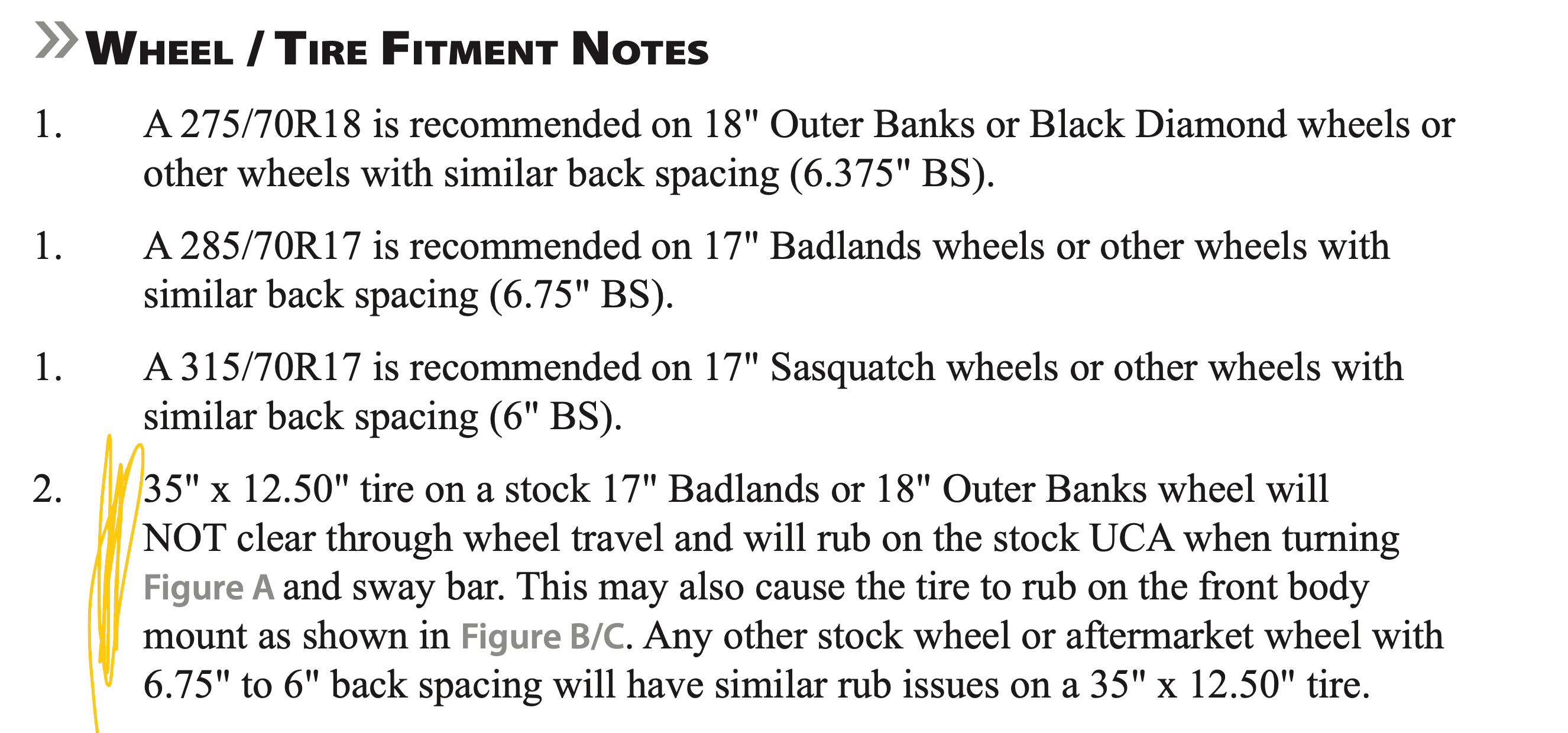

Do you have any issues? I am looking for the same, but this is unclear to me:
I will have 35/12.5/17 Mickey Thompson on Methods 35/6.2". It should be close to stock, and MT 35 is the same size as MT 315/70. So will I have that problem or not?
I reached out to them, and I got the answer: If your new wheel is close to the same as stock then you will have issues. It has to do with the back side of the wheel coming into contact with the upper control arm and less to do with tire size its both but the wheel has to clear the arm first.

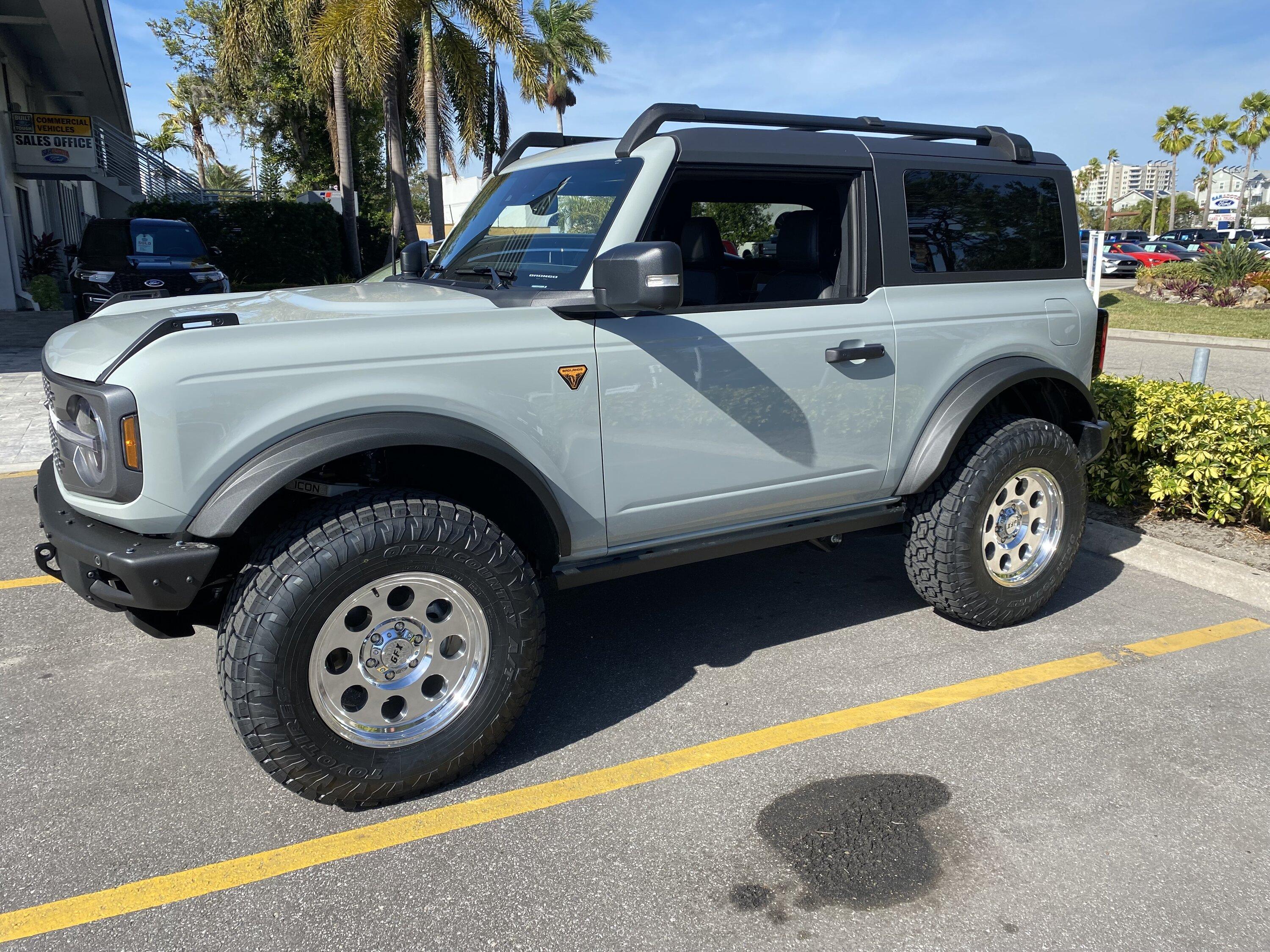

1" Rough Country level lift up front. It has small spacers top and bottom of Coil-Over.
Here is my 23 Badlands Sasquatch with the 1" Level lift. 285/75/18s which are taller than the stock Sasquatch tires. Less than an inch rake now.

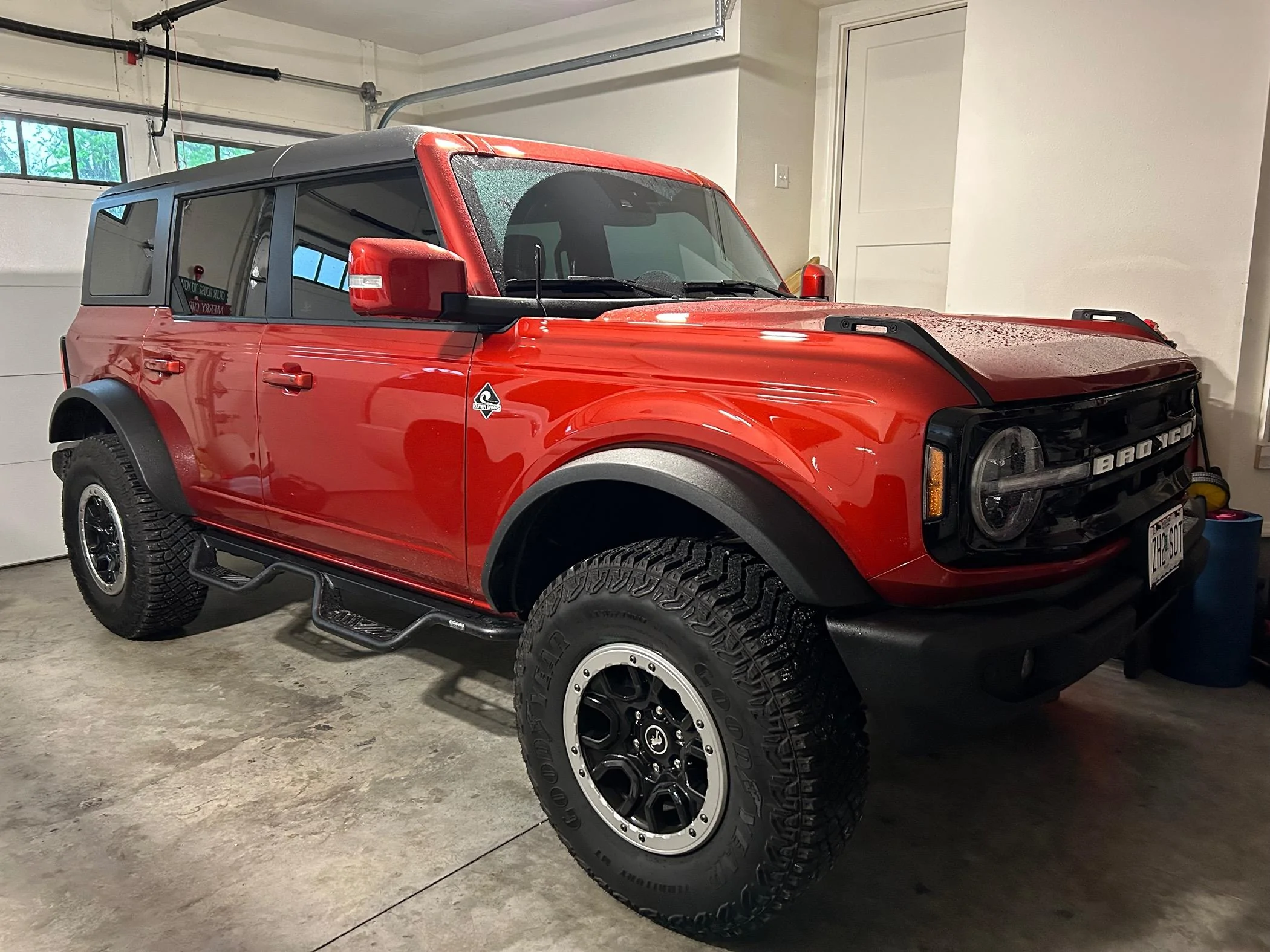

I just had the Rock Krawler 1” level kit installed. I’m happy with results. Part number FB10AS. Not the best pic but all I could get tonight.
