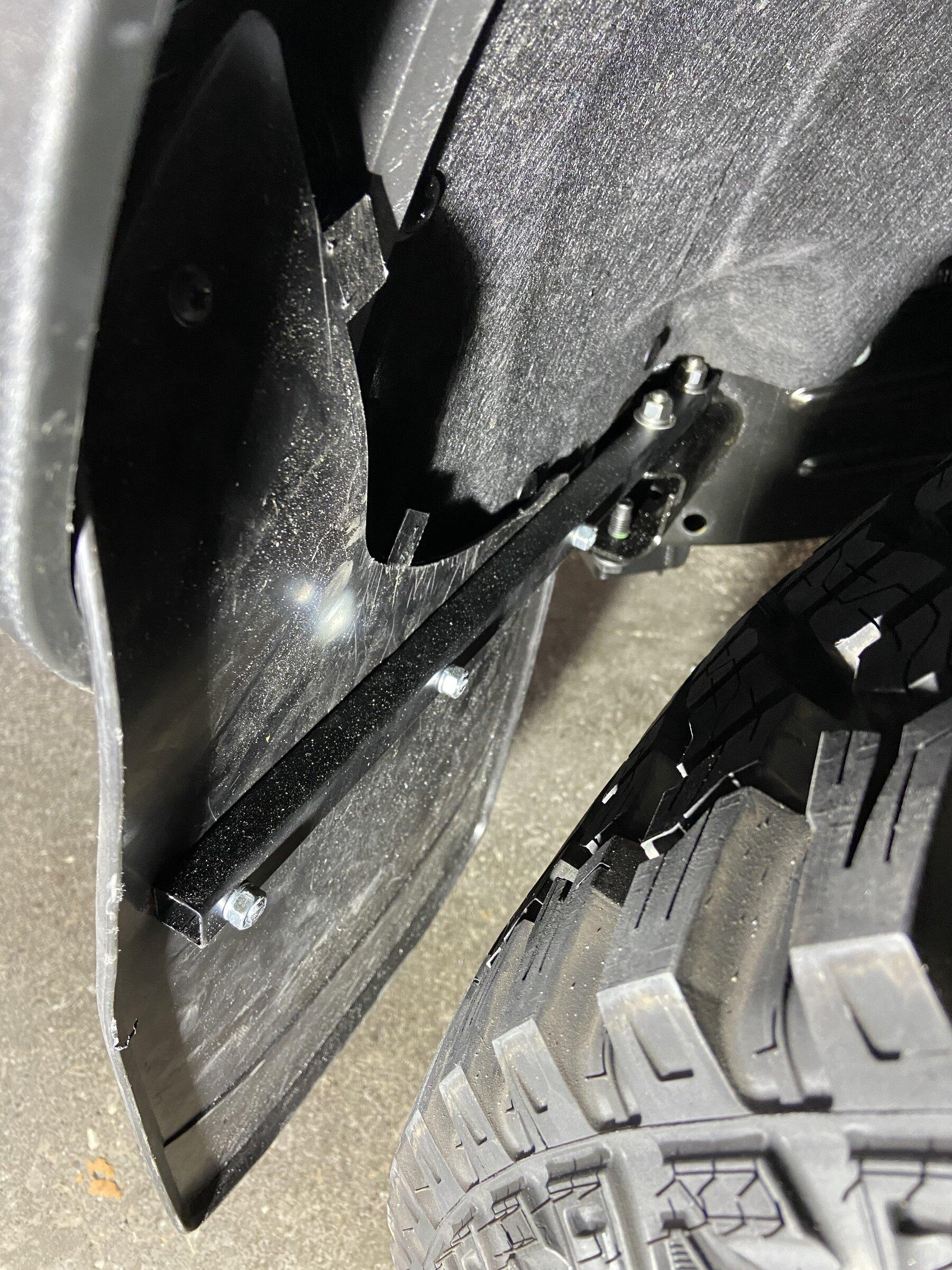

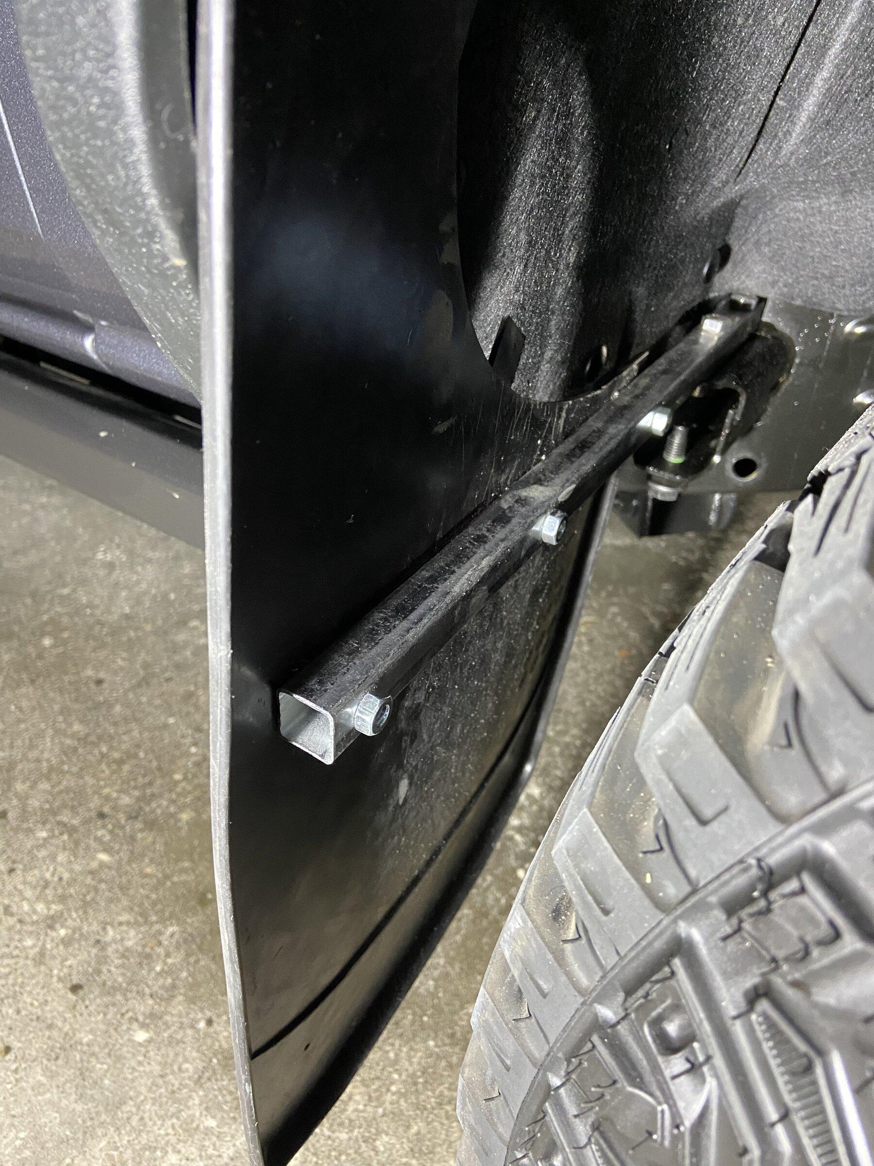

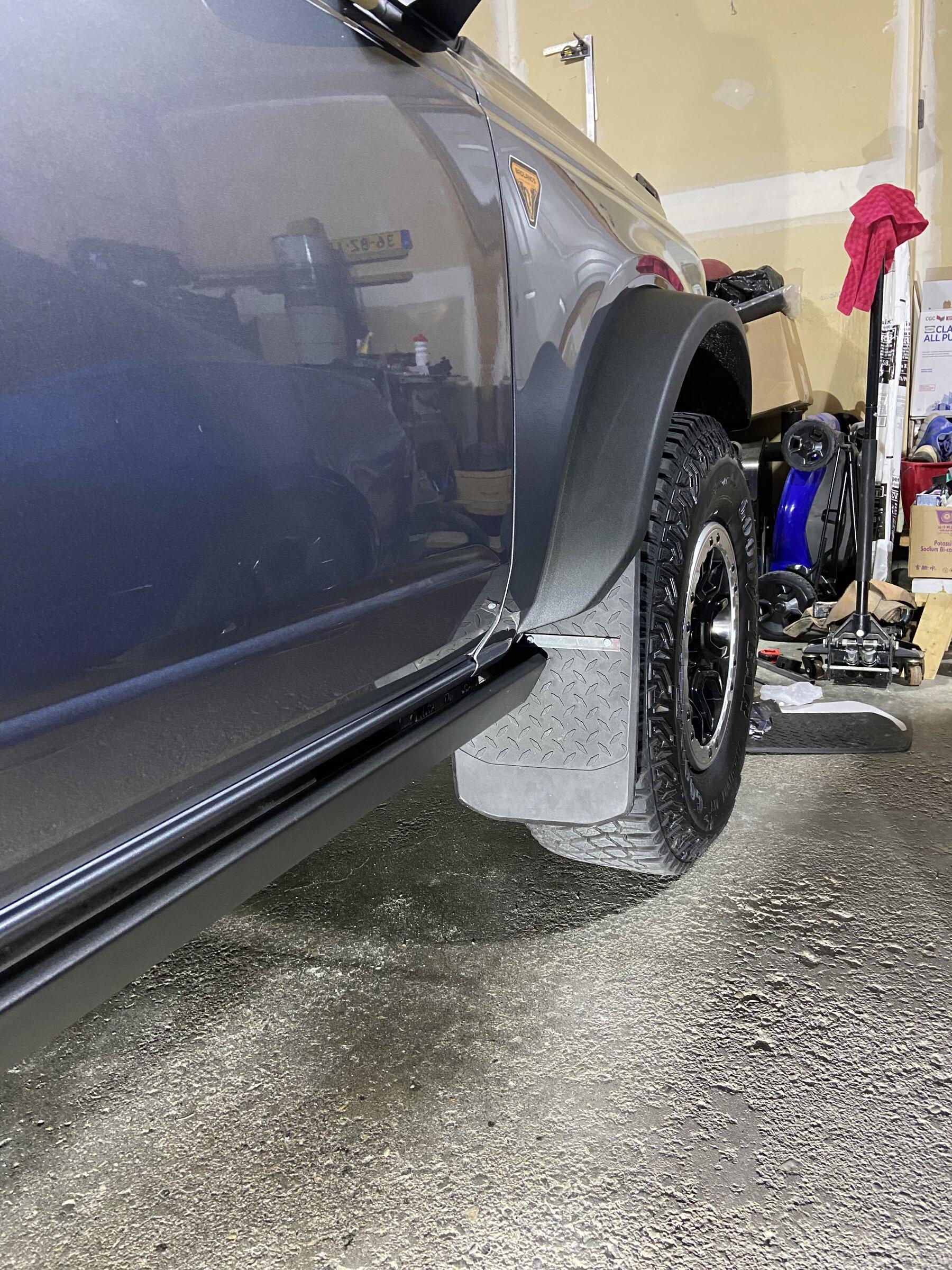

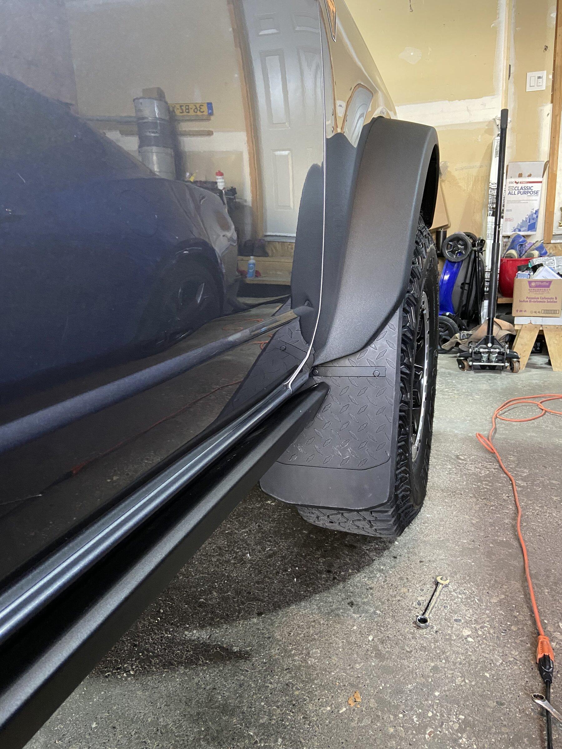

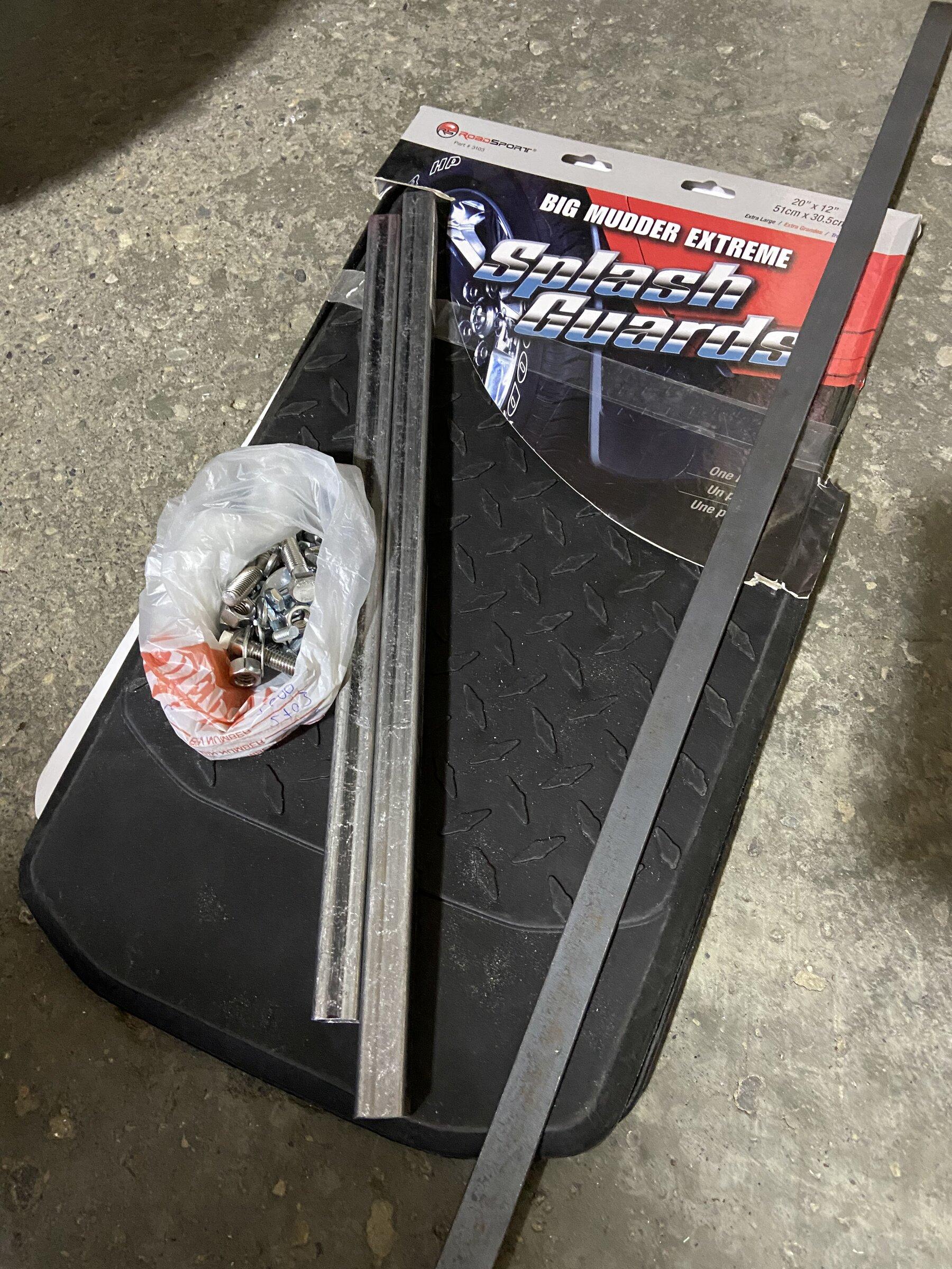

The first things I did to mine was apply paint sealant, spray everywhere underneath with rust proof spray, and make some custom mud flaps for the front wheels. I'm not a fan of the way mud flaps typically look however after seeing some horror stories on this forum and knowing how many gravel roads I traverse decided they were necessary. Here are the finished mud flaps, they cost about $80 for the flaps and hardware:

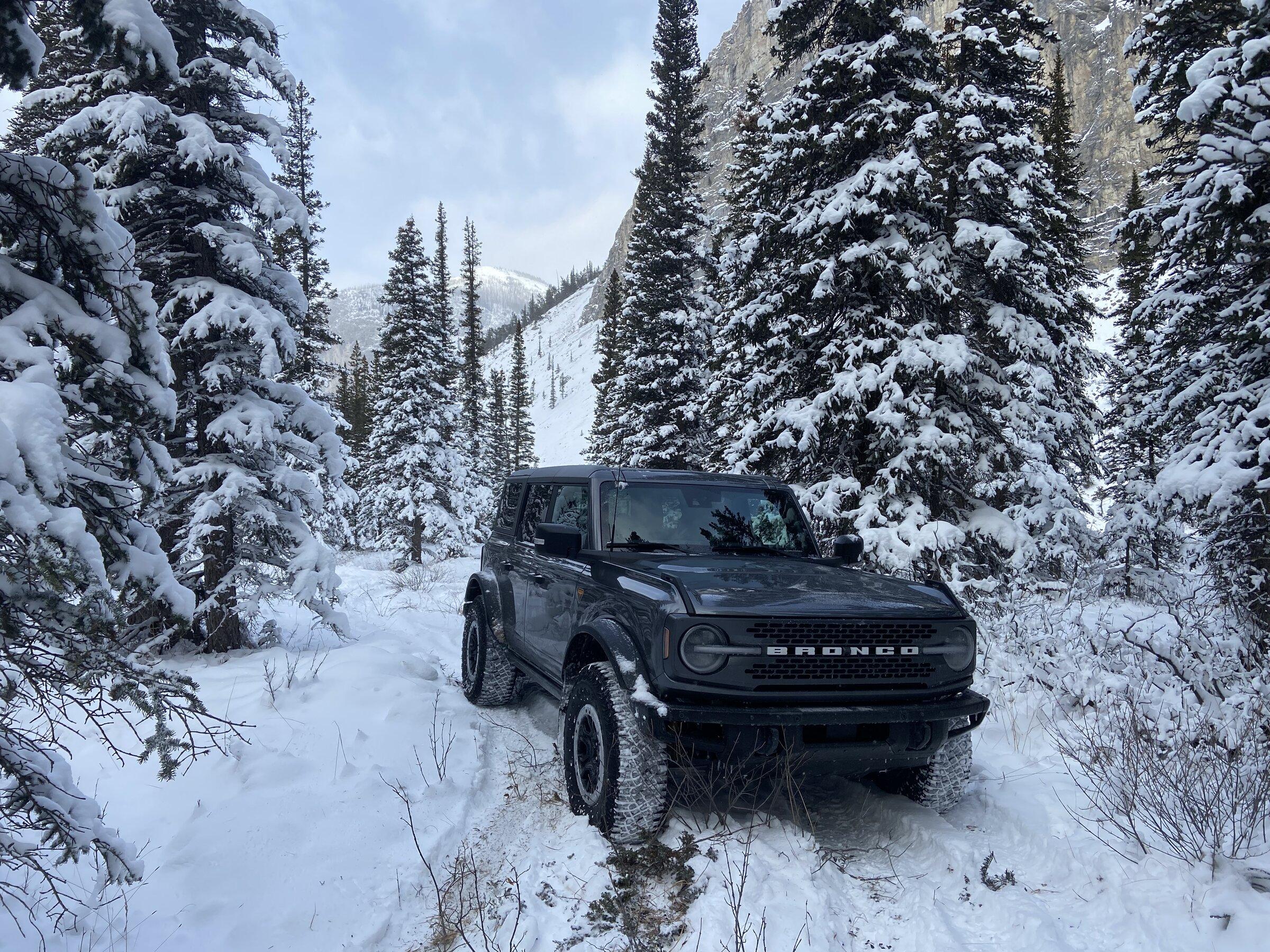

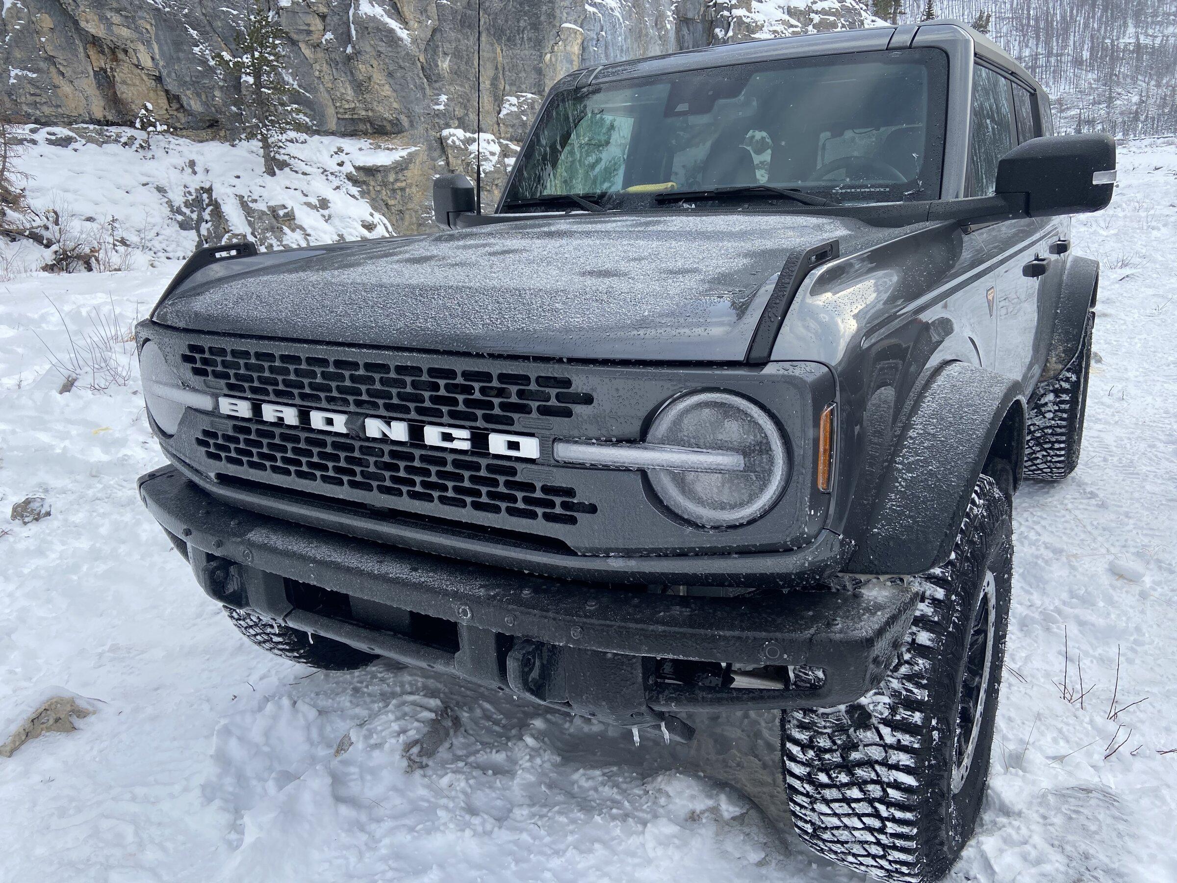

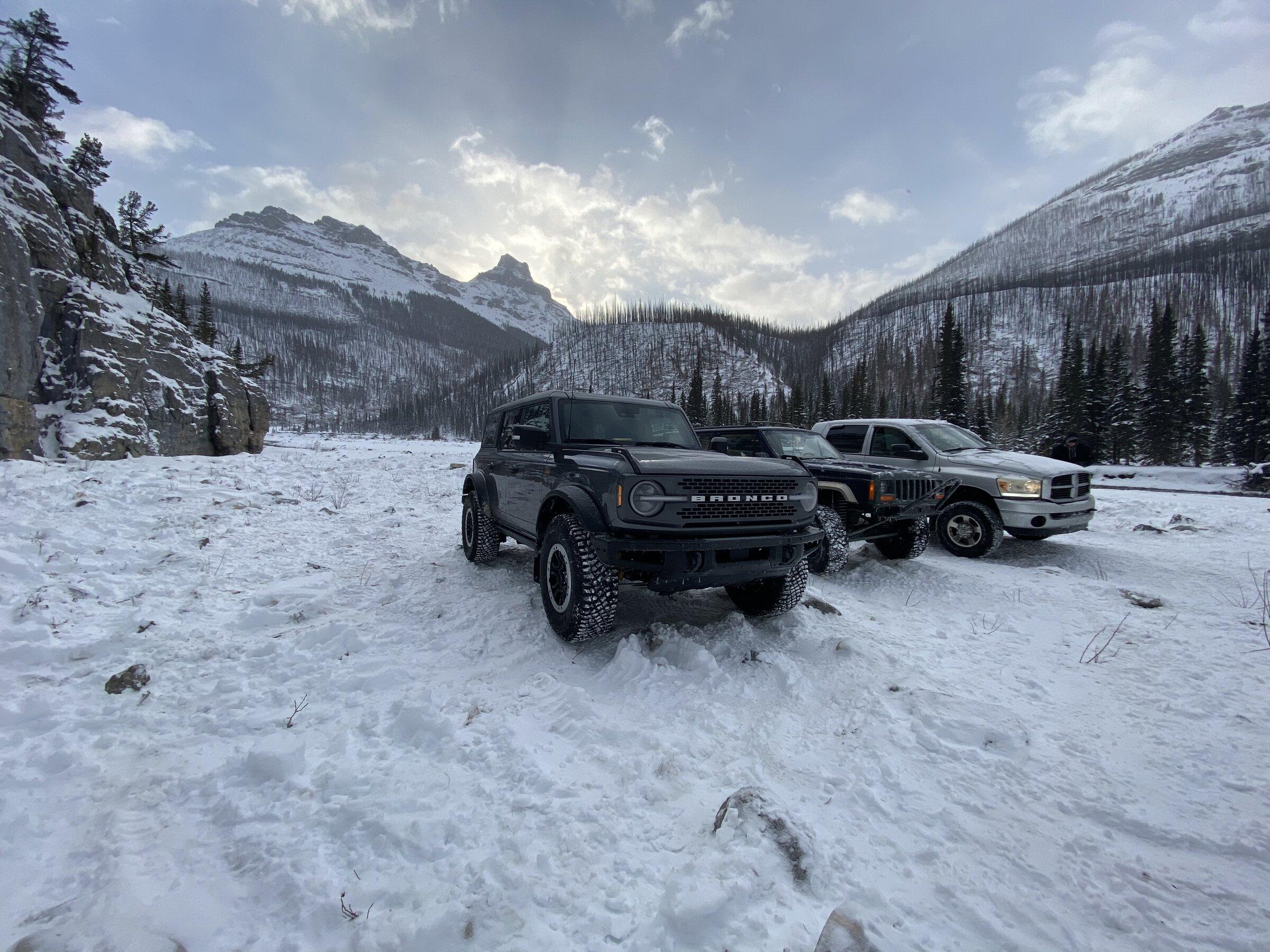

We got to take our Bronco off road for the first time today and got some pics and dash cam footage. I only make these videos to share with friends and family once in a while as I don't like to live through a camera. This forum has been like a family for quite a long time now though so I'll share some of the pics and video here too
This is a very easy trail so long as the ice isn't too bad and today we only used 4 high with the sway bar disconnected when going slower. The tires were aired down to 23psi which gave us tons of grip and a pretty smooth ride. We did use the sliders underneath on a few large unseen rocks and this can be heard on one of the clips but looking underneath when we got back home there wasn't anything interesting there. Also ice buildup makes the proximity sensors go haywire but fortunately there's a disable button. Here's the footage for your enjoyment:
Oh yeah and almost everyone we passed on the way back from the end of the trail was smiling and waving, lots of friendly folks out today - cheers!
