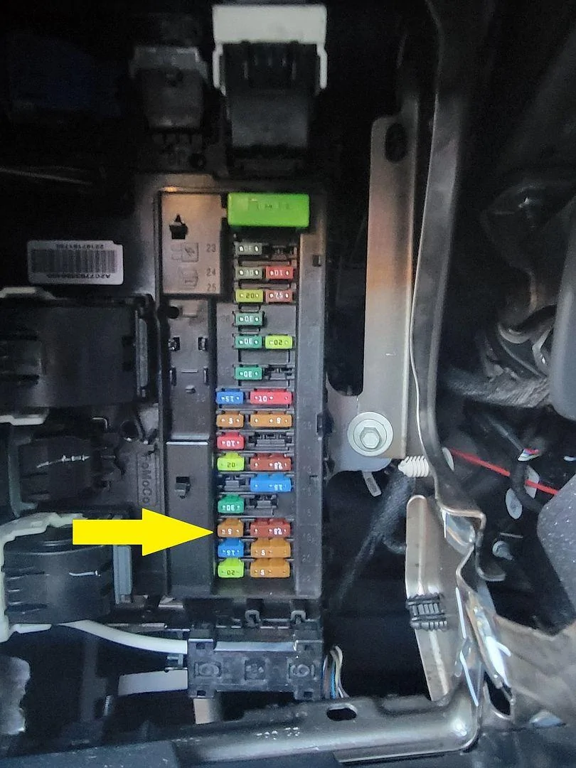

We have a 5A switched 12V circuit on the fuse panel under the dash. It is slot #35, diagram on page 317 in the owner's manual and the description is on page 319.
Ford Bronco Badlands - need dash power 12v and USB Bronco_Under_Dash_Fuse_Panel_03
This is where I powered my dashcam by adding an Add-A-Circuit (size: Mini) and ran the power line up thru the dash, under the A-pillar and windshield trim then down to the cam. You may be able to do something similar with an aftermarker USB panel, there are a bunch of types and styles on Amazon.
It is only 5 amps, but it is a start.
