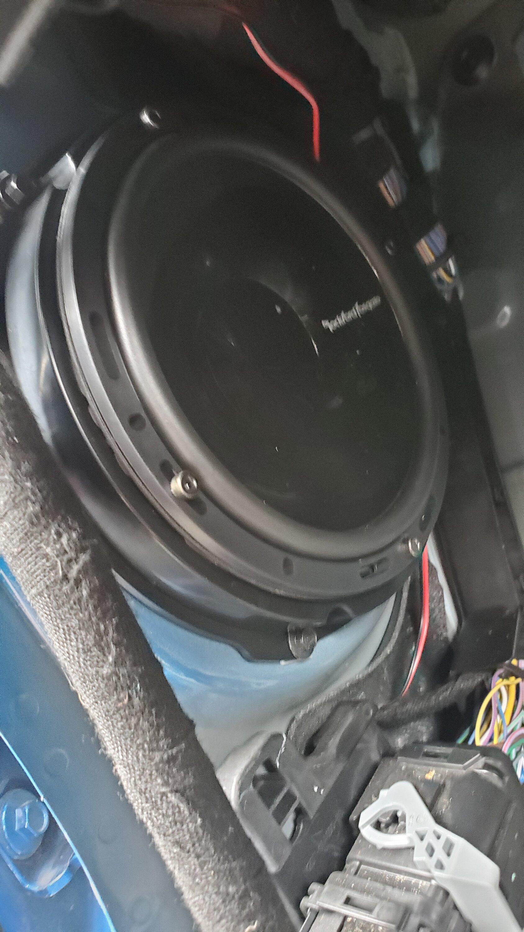

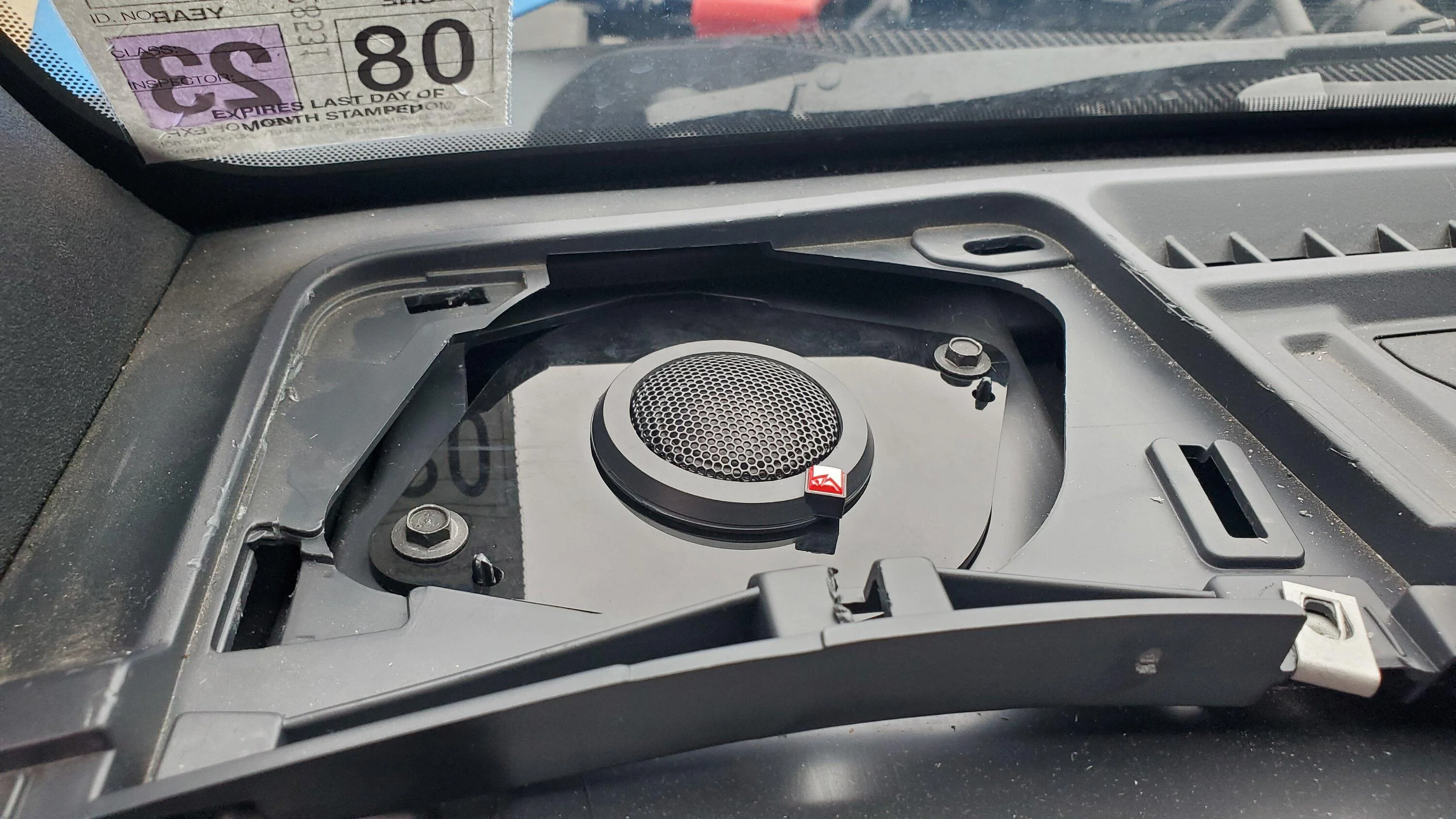

Only pics I have. This is when I replaced mine. 6.5 in kick panel and tweeter in dash.

Your window sticker is denoting that the *subwoofer/amp* was deleted from your build. There are 2 audio systems in the 2021+ Bronco: the "base" audio system with 6 speakers that's delivered with every trim level that isn't "Lux" and the "Bang & Olufsen" (or B&O) 7 speaker (there's a middle-dash speaker) system that comes with the "Lux" trim level.
The B&O system has had a sub/amp since intro. Beginning with MY23 the non-B&O systems were enhanced to also include a sub/amp. Barely a month into production something happened (presumably supply constraint) and Ford is now installing dummy units in the sub area.
Your system should still have the 6 functioning speakers referenced earlier upthread - 2 in the dash corners, 2 in the very back top corners and 2 mid-woofers in the kick panels (by your feet ahead of the doors). All of them are protected by fairly thick grilles so that could make it difficult to eyeball the actual units underneath.
