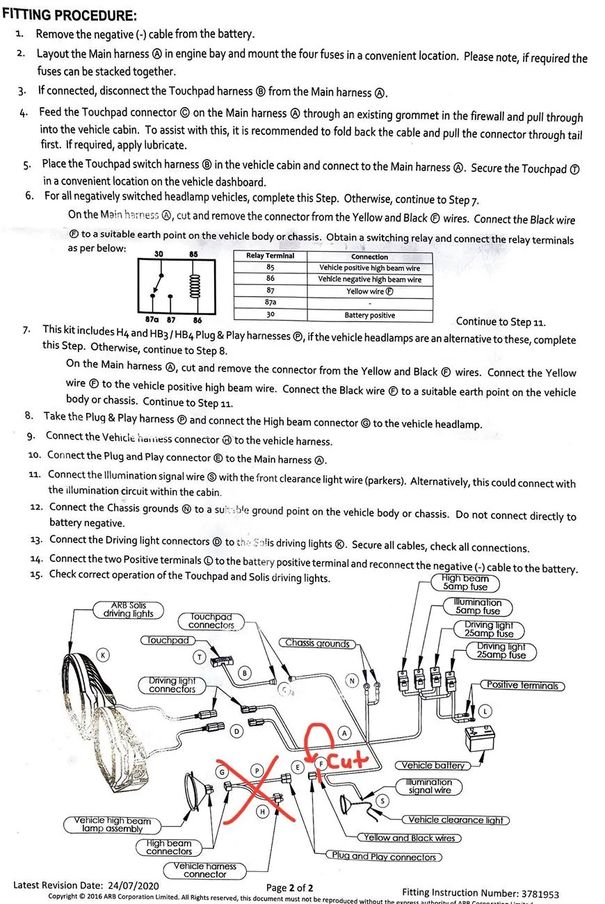

The ARB harness does have relays wired in. Not sure how/why you want to use the upfitter if you plan to use the dimmer. The ARB dimmer is also the on/off switch. ARB used to have a pigtail that eliminated the dimmer and allowed you to connect to the upfitter. They discontinued it. I have the same lights on our Bronco and I just installed them on our F250 Tremor. On the Bronco I used the ARB pigtail and used upfitter #1. ON the F250 since I couldn't get the pigtail I stripped the ARB harness down to 3 wires. Red to battery, Black to ground, and green to the upfitter connection. No other wires needed. For me the dimmer is not needed. If I need the lights, I want full brightness. If I have an oncoming vehicle it is quicker to turn them off rather than try and dim them. The dimmer switch is kind of a pain to use. The lights are not DOT legal so driving around with them dimmed can still get you a ticket. Full power on/off works for me.

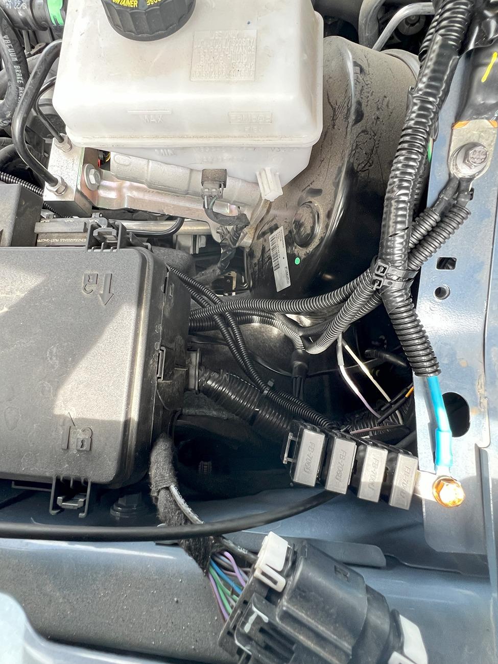

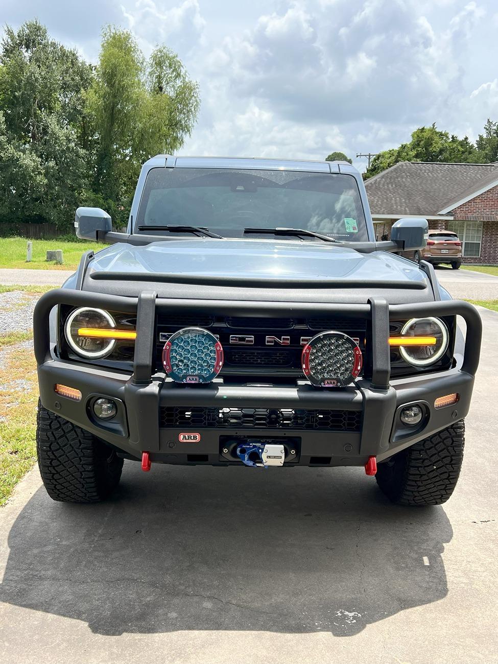

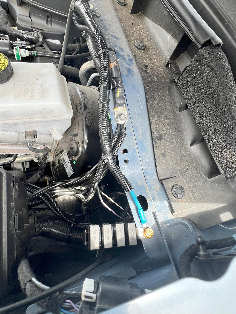

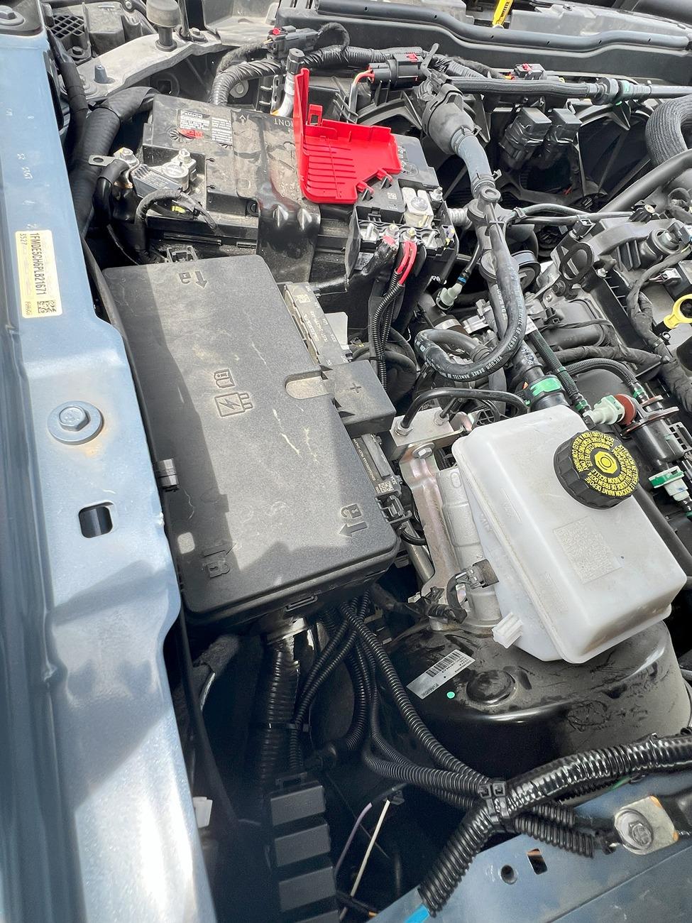

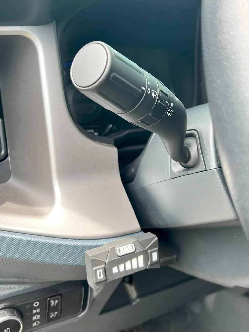

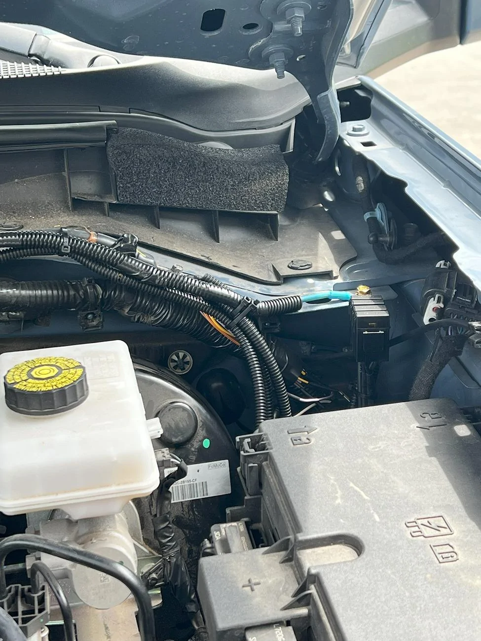

I was able to install the lights over the weekend and everything works as it should. I simply cut the plug off as shown in the diagram (Black/Yellow wires). Then spliced the Orange and Yellow together with a short length of 16 gauge and connected that to Aux 2 Green/Brown Wire and ran the black to chassis ground. Ran the Dimmer into cab and mounted on left side dash near steering wheel. Dimmer still works as well but like most I want ALL the light intensity when I flip it on so I leave it on the highest setting that way when I flip the Aux 2 Switch it's max brightness. Ran the loom under the fuse box, under the battery then to bumper and connected the lights. They give plenty of length with the loom so just cleaned it up with some zip ties and all done. All in all it was an easy install. These lights are bright!
