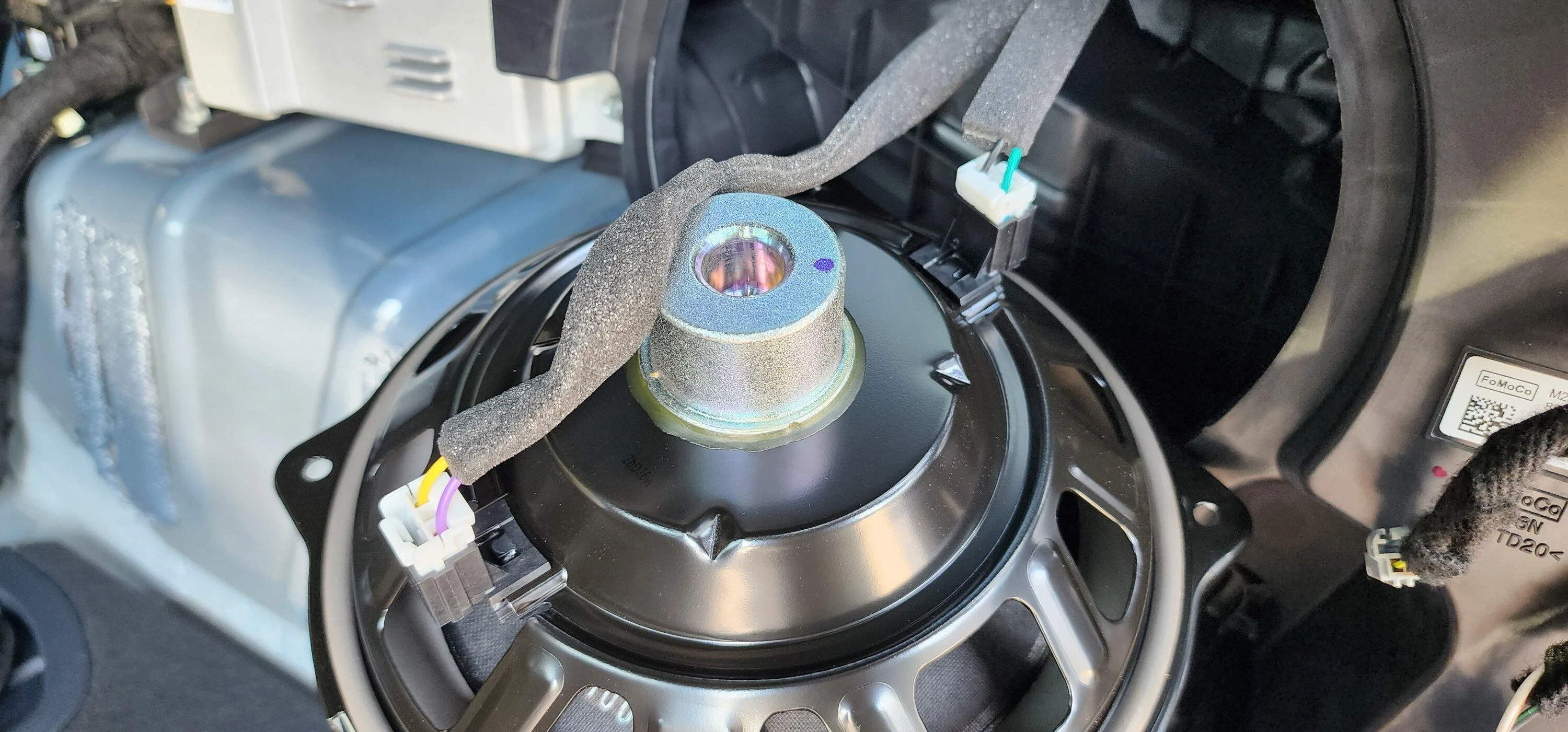

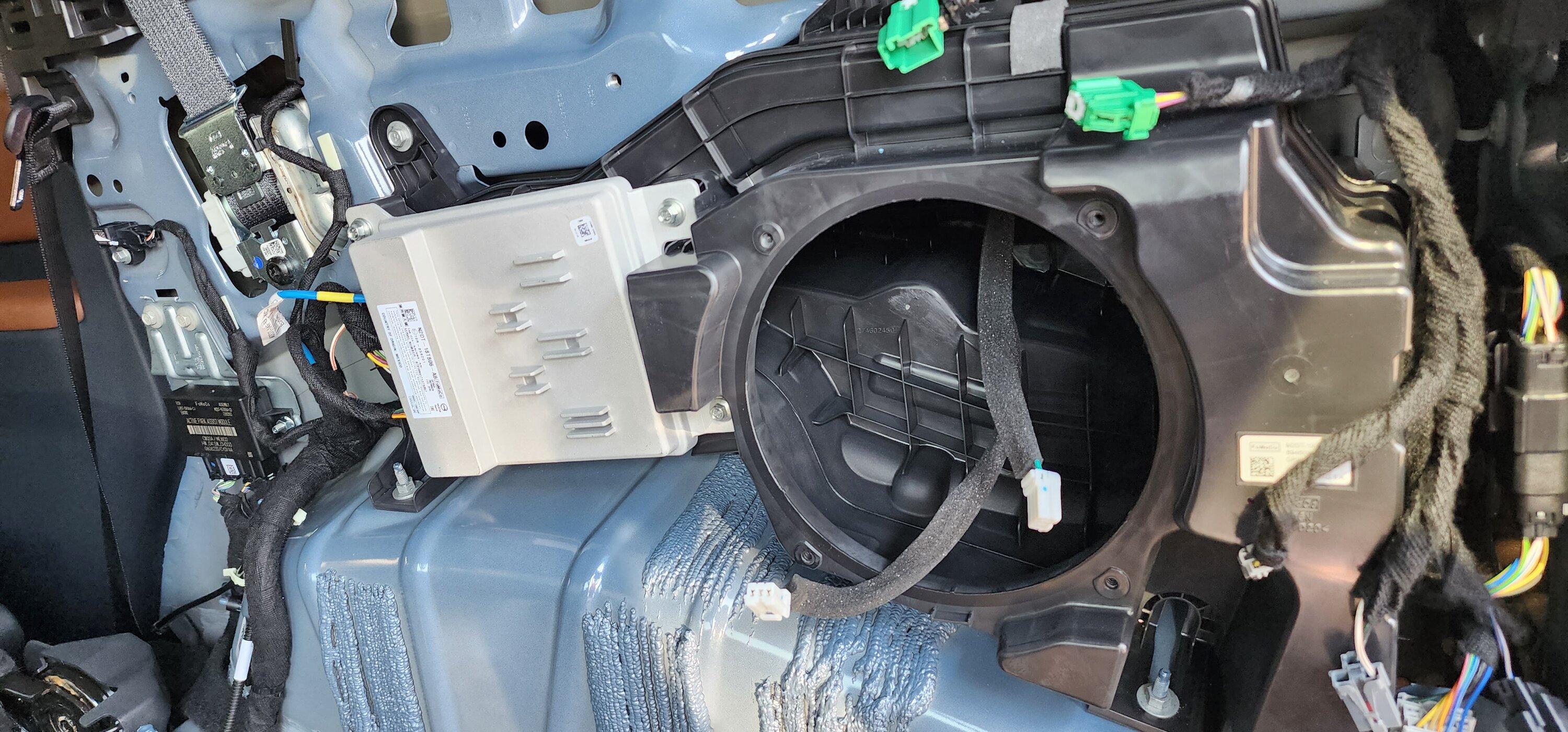

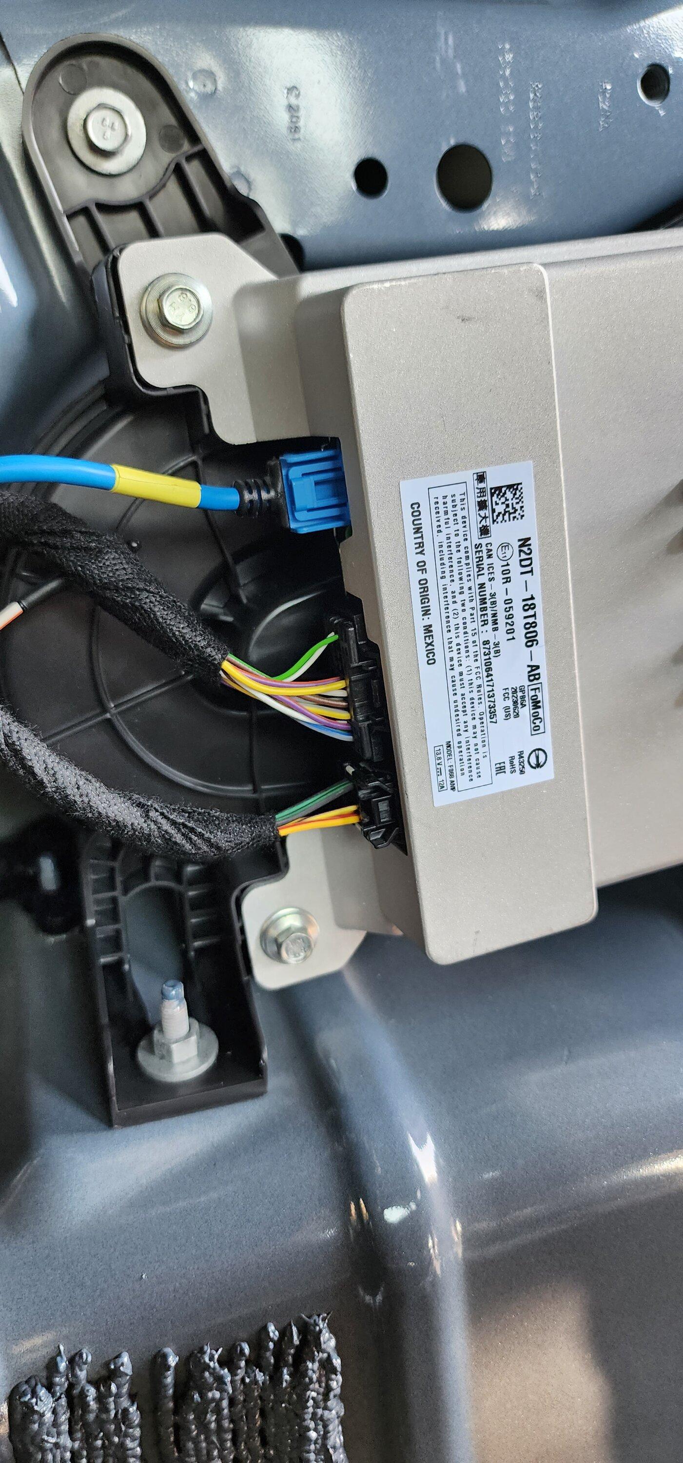

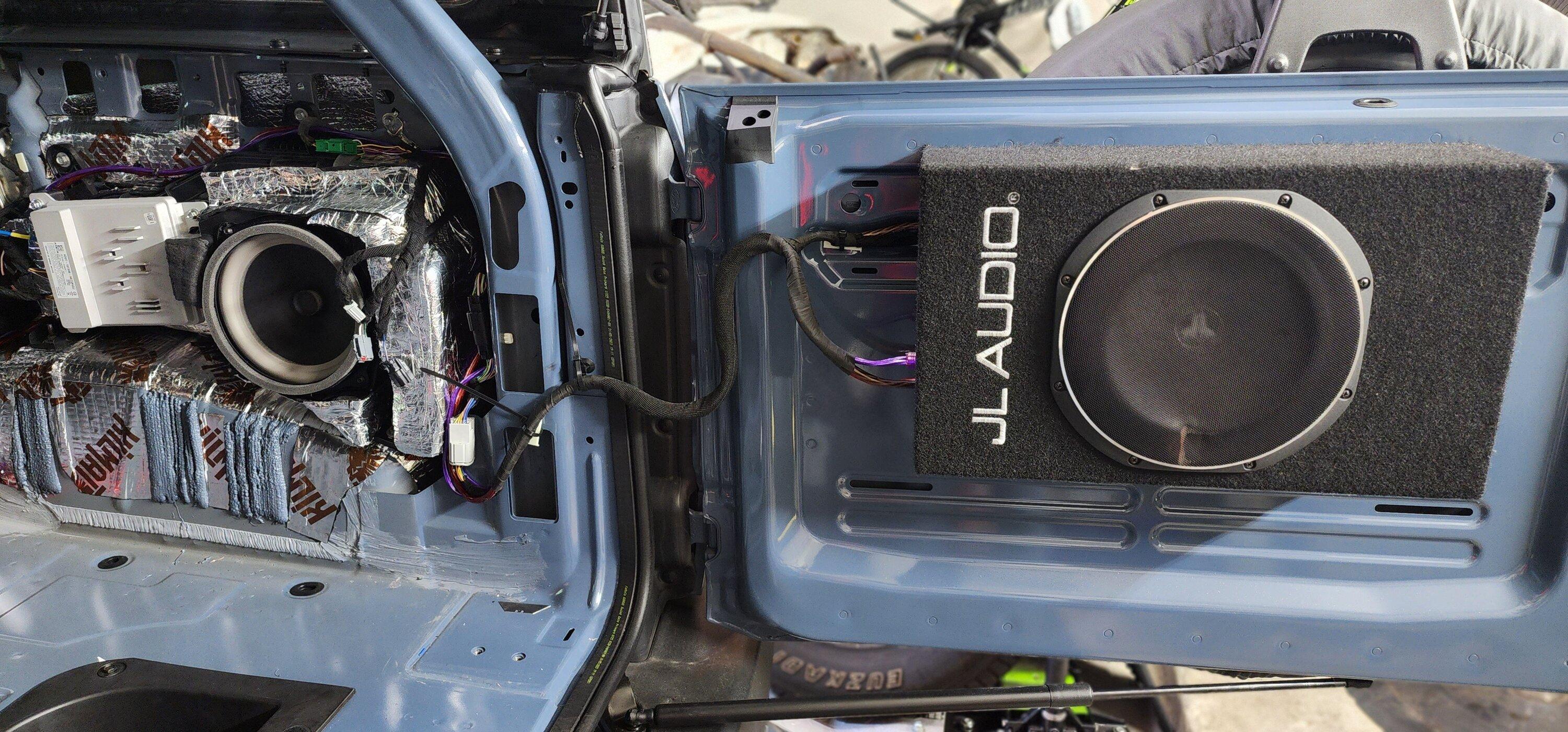

Hello. We just received our 2023 Bronco outer banks with the B&O sound system. the sound it is pretty loud and sounds pretty good despite the bad reviews all over. But i would like to add more bass to the system. I have a JL self power box that i want to mount on the back door. I will add some pics . I hope someone can guide me on this. Appreciate the feed back.

So the subwoofer outputs from the factory amplifier needs to be spliced into the "High-Level Inputs" on your JL Audio box.
One the factory wiring...
  • Green/Yellow: Positive
  • Black/Purple: Negative
Done.

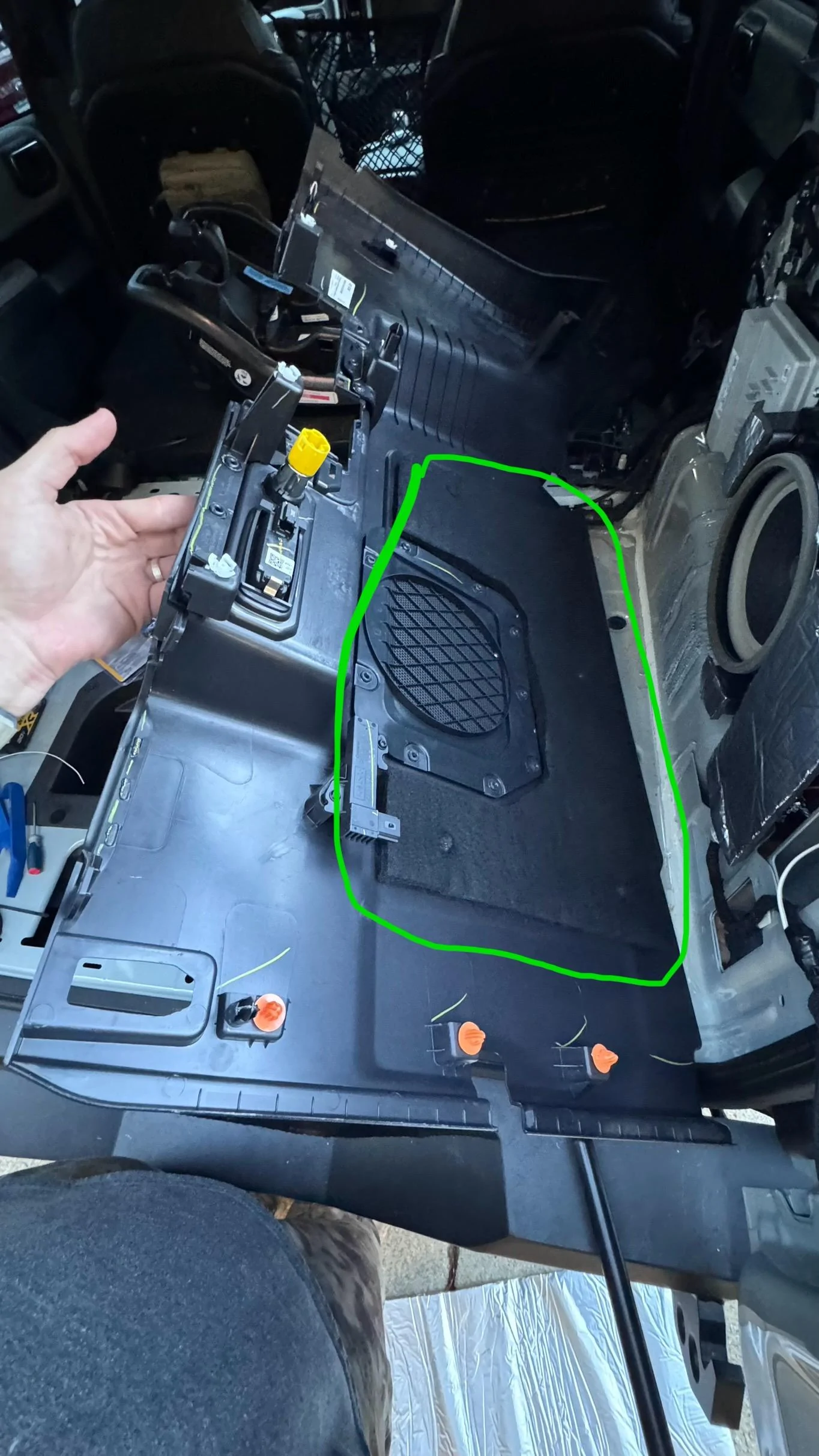

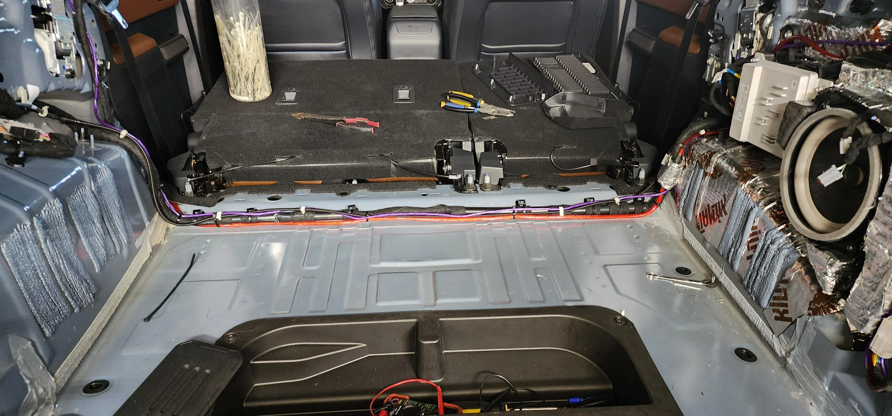

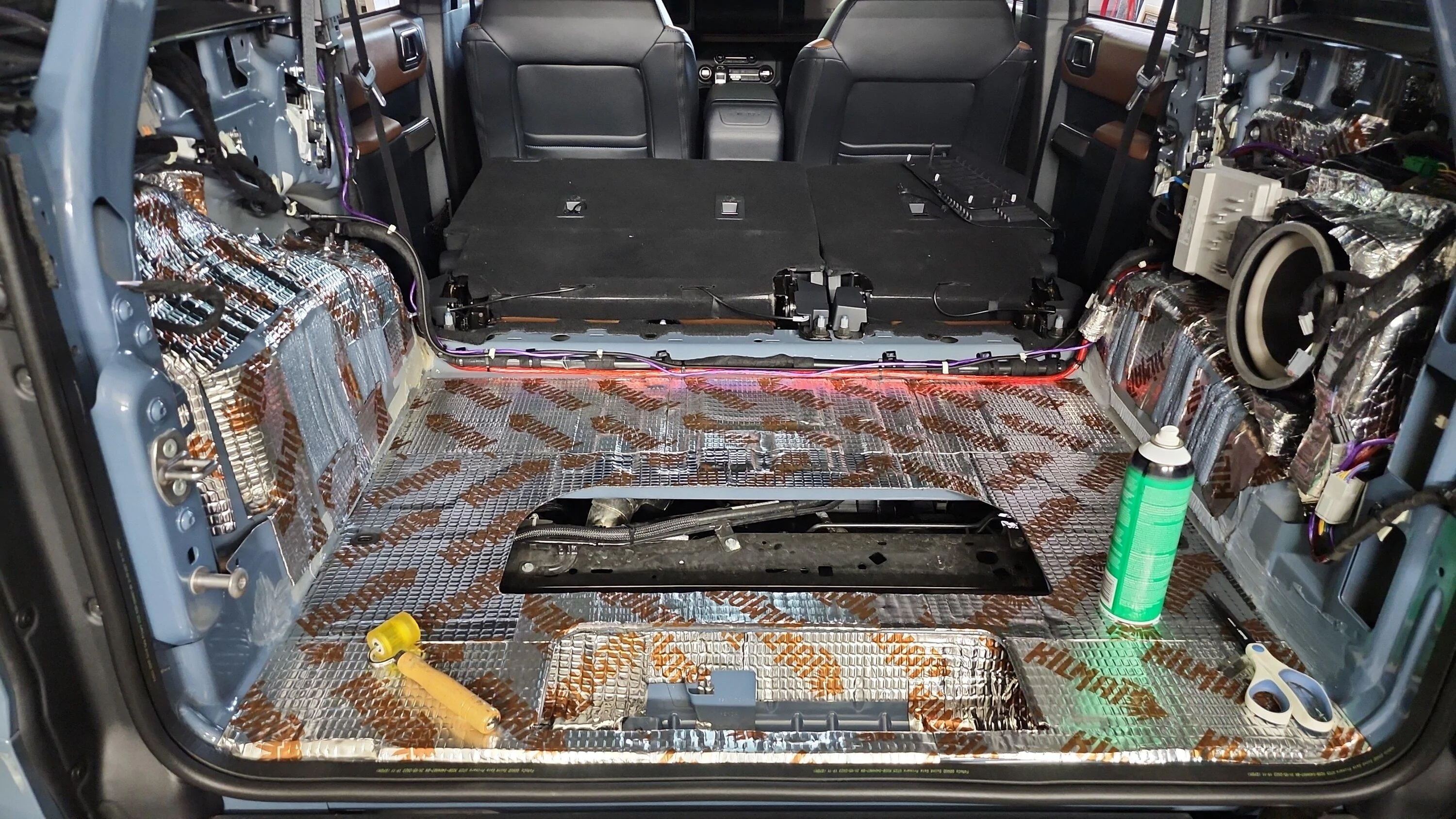

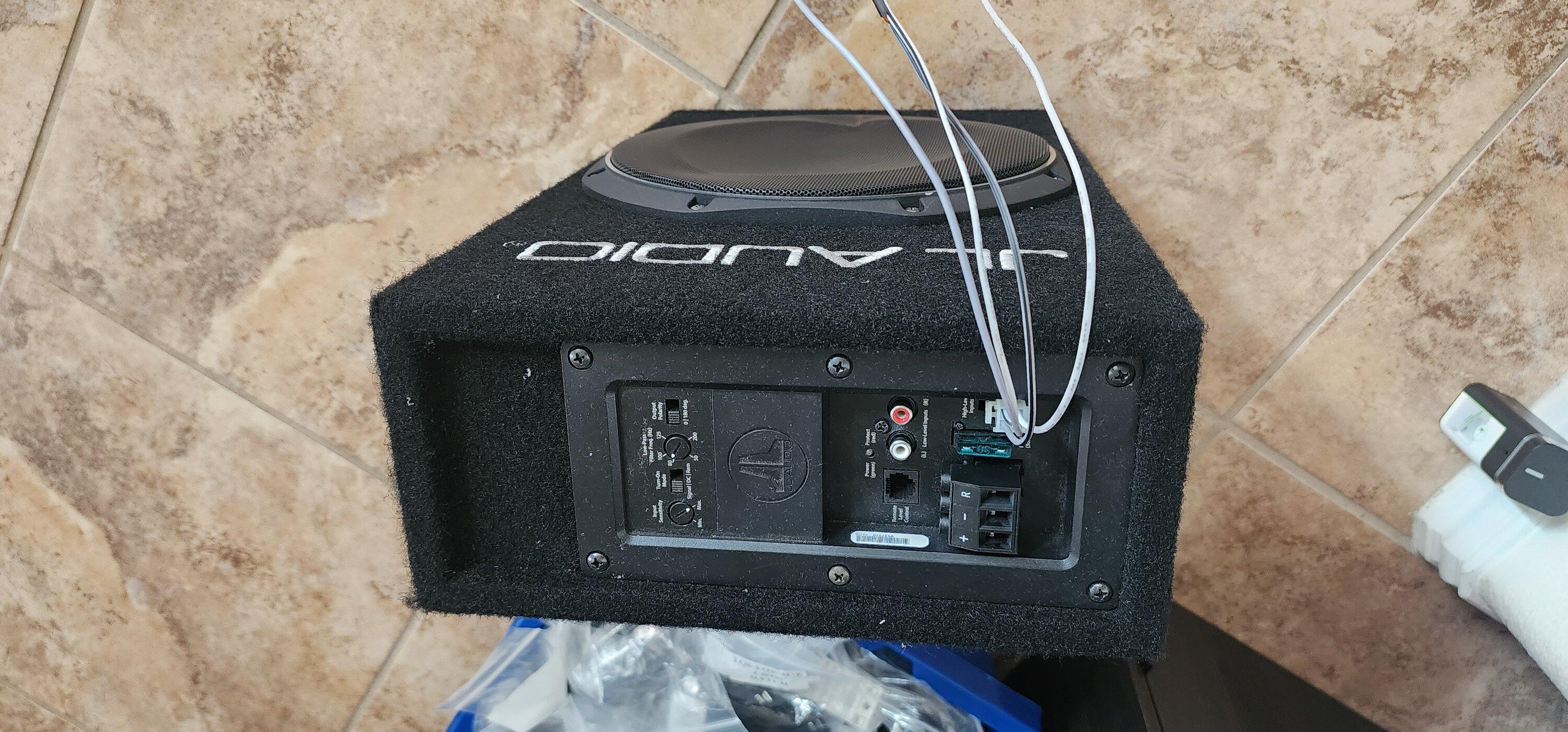

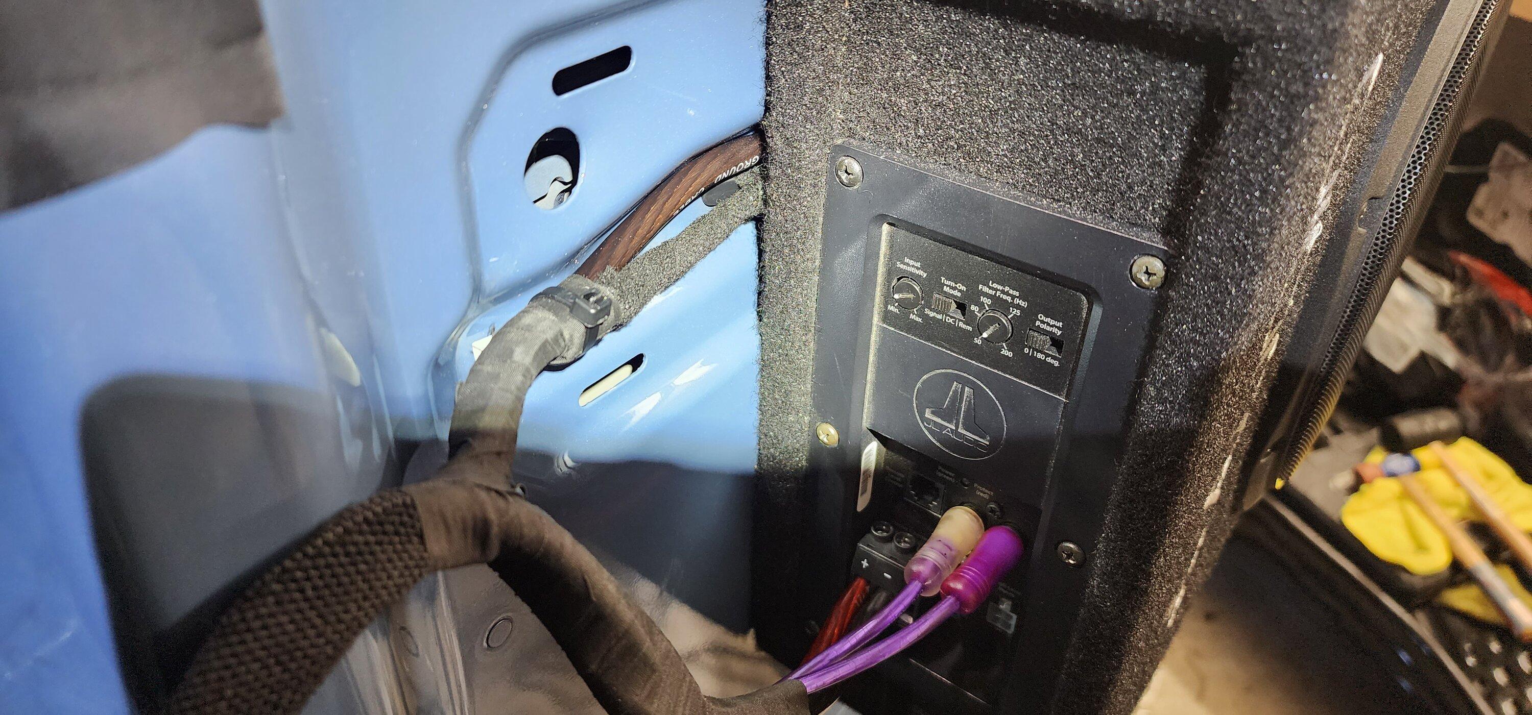

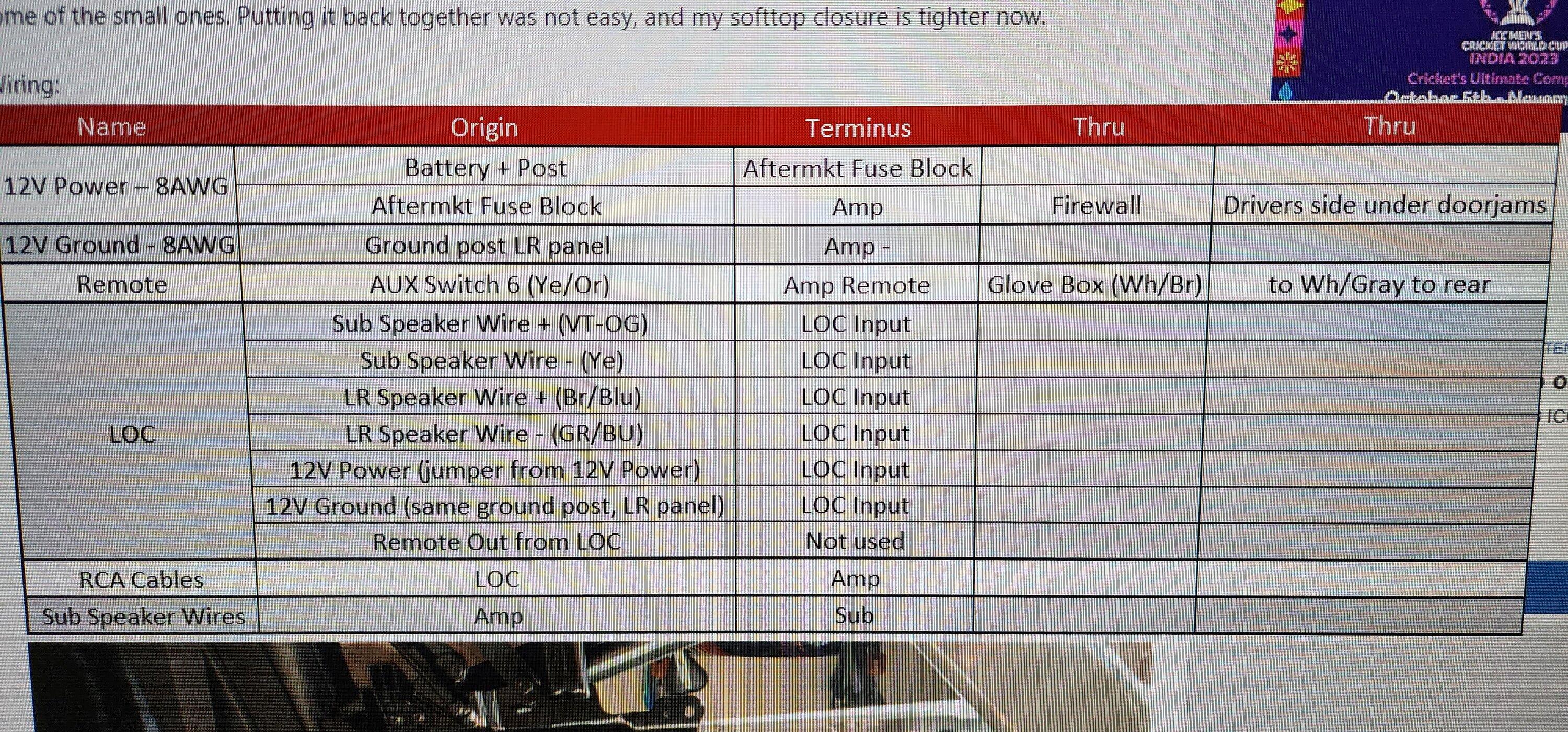

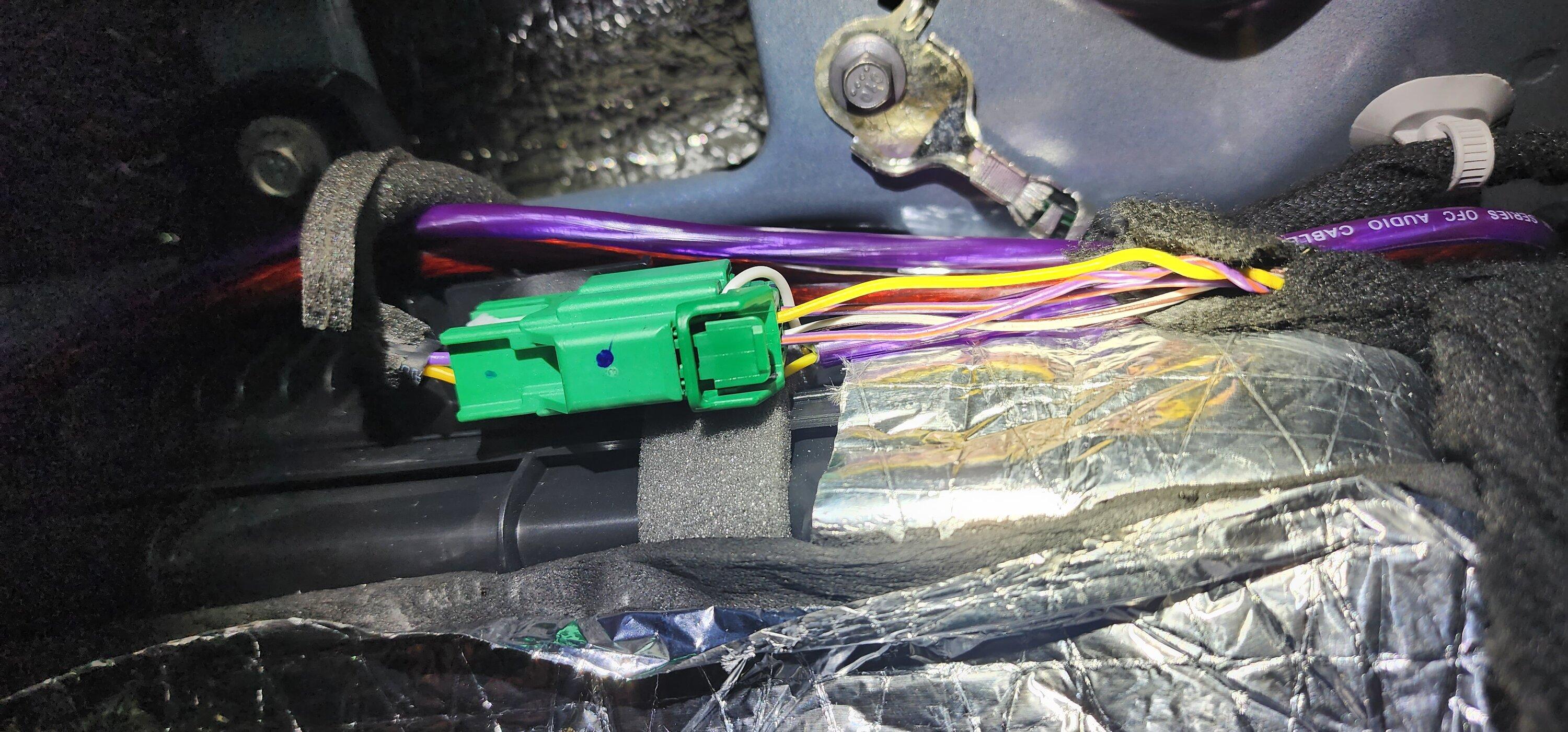

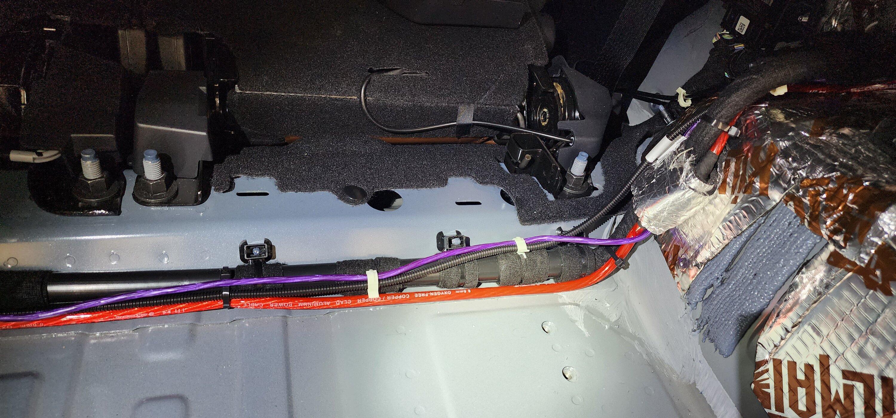

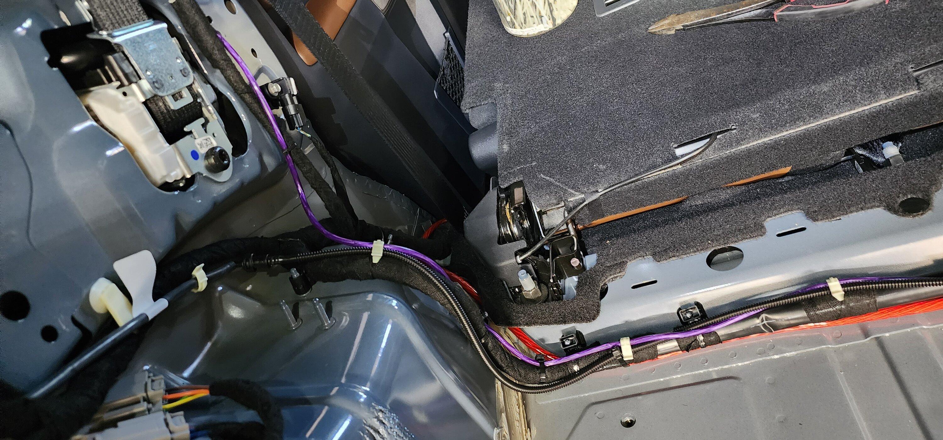

Hi. I finally got around to add the subwoofer to my bronco. It was confusing at first. but i did more research and i was able to to figure out. I will add pictures. I tried hook up from the factory sub to my Amp on the high inputs. That did worked. Then i tried hook up to the low signal with RCA's and that worked but i had to turn the sensitivity all the way down. This Is how i hooked up: the factory sub have 4 wires (2 on each side of the sub) so I hooked up the 2 RCA's one on each side and connected to my Amp. Still have to turn the sensitivity all the way down. Now i have a lot of bass. I think too much now lol. I will get a bass control to decrease the bass. It made a huge difference. Well check out the pictures and if you guy have any question let me know.

What was the build date of your Bronco ? Looks like the new B&O subwoofer has color coded connectors versus older pictures from 2022 where the B&O subwoofer showed +/- on the connectors - Would be curious if the subwoofers between 2022 and 2023 on the B&O are actually different ? Anyone know ?

mine was built in September of 2023.
