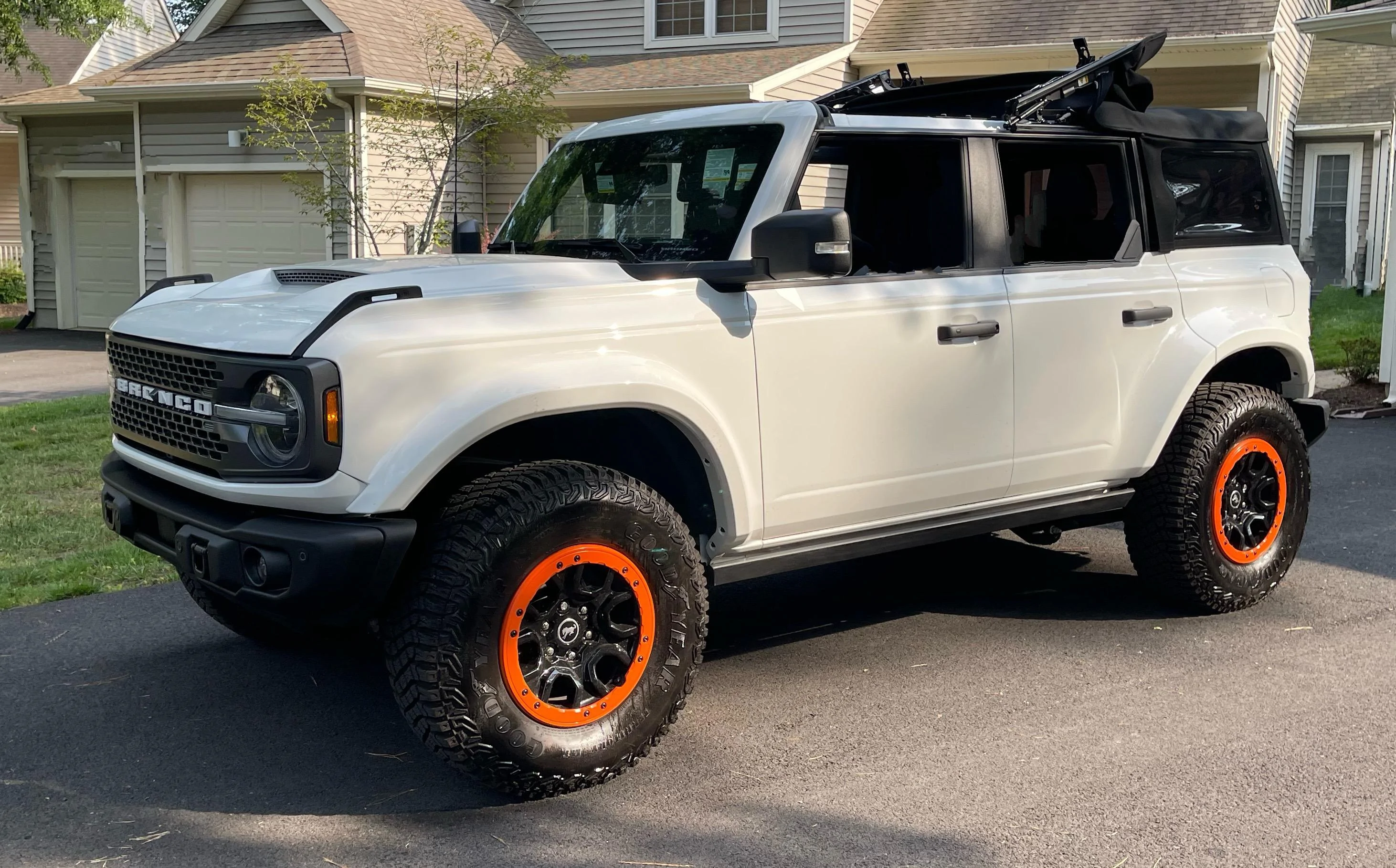

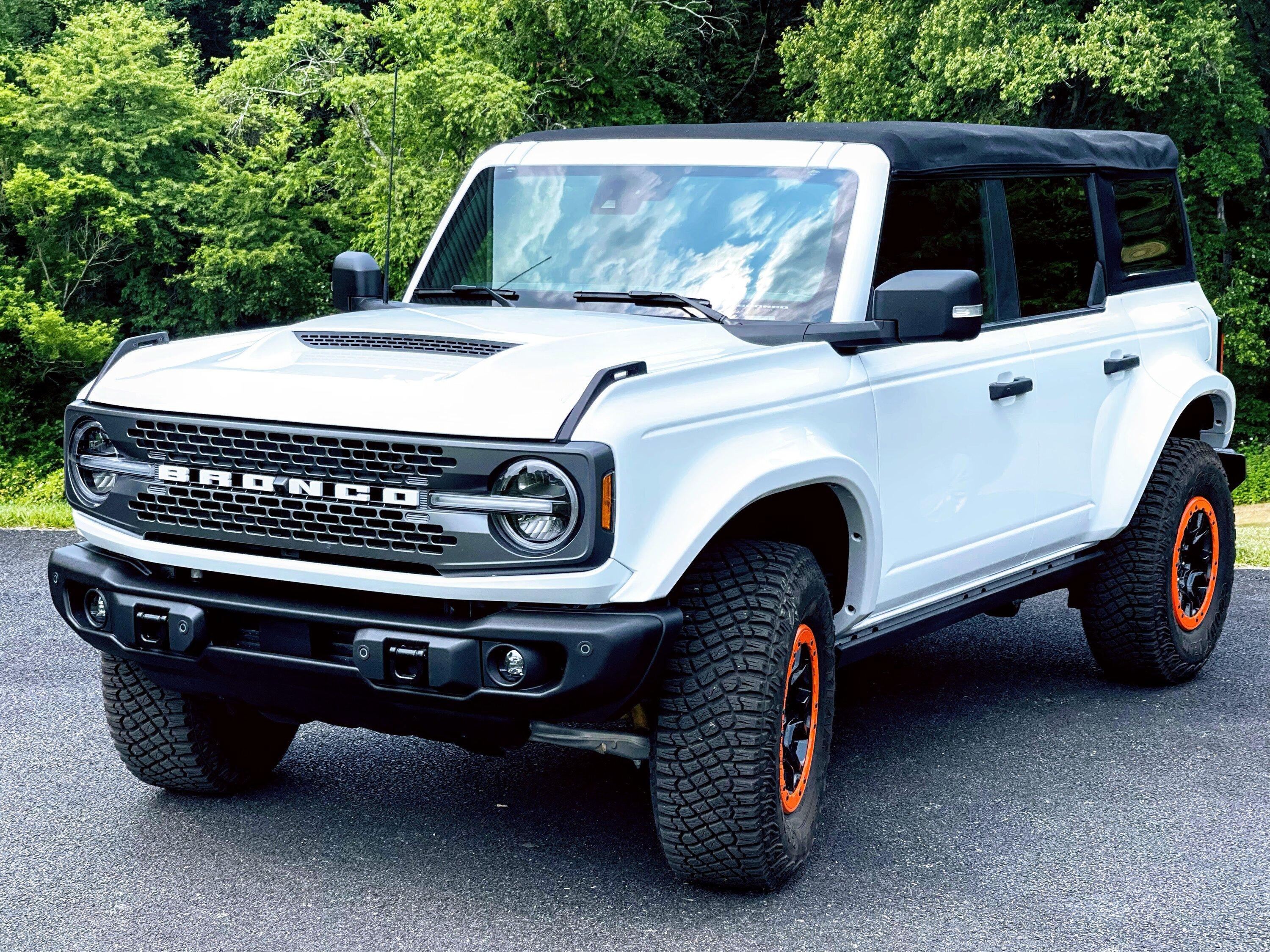

Getting the Advanced Fiberglass Concepts fenders+hood on the Bronco has been one heck of an adventure. @ADV Fiberglass was great to work with, but don't be fooled, it's an effort to achieve a professional-looking installation. After a really really really long process, it's finally done. I'm pretty stoked at how it turned out.
Some highlights:

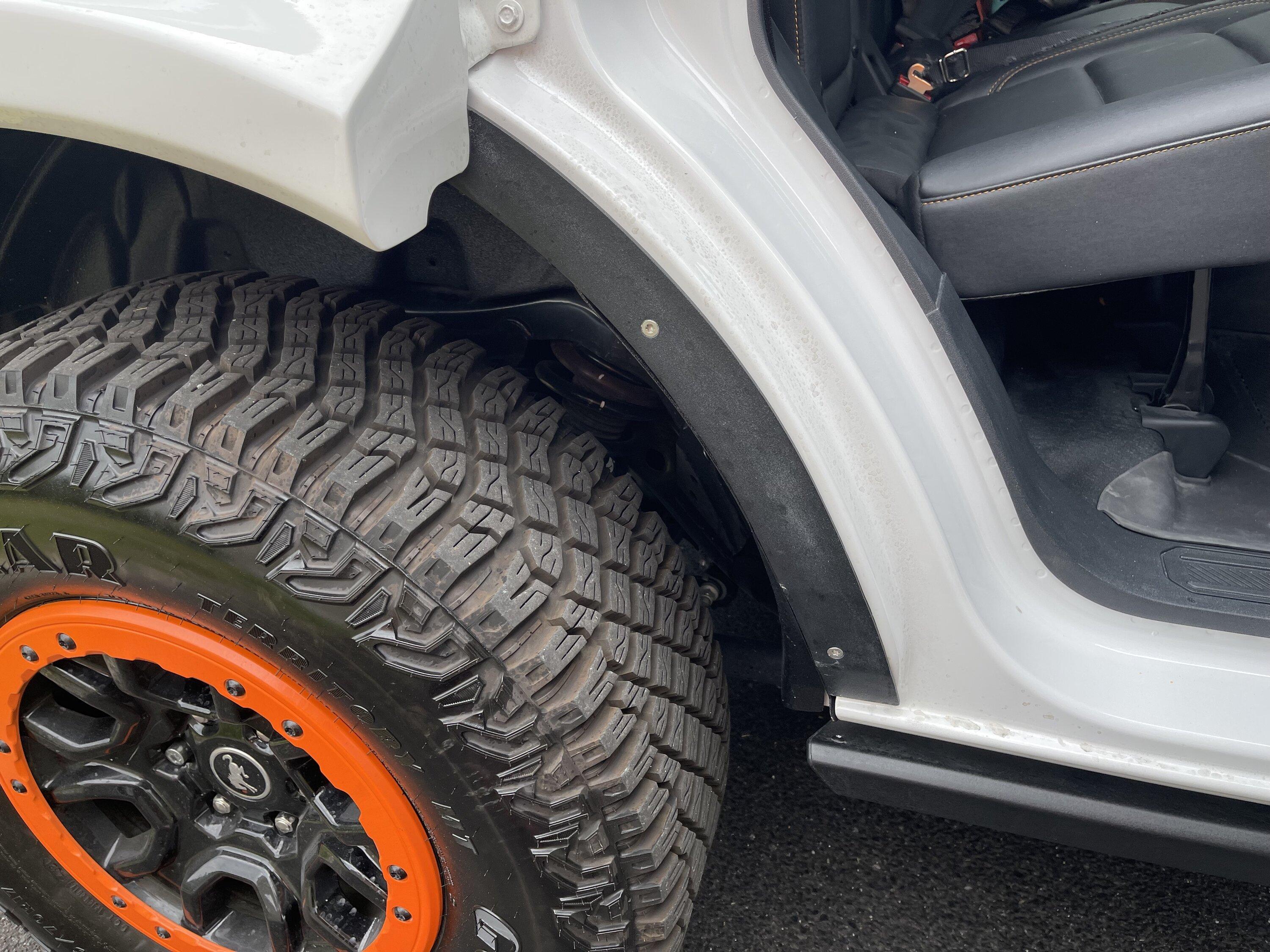

  • I added a fender delete kit to hide where the previous fender connected so I could take the doors off without calling attention to that section
  • The rear quarter door add-ons have been molded into the door to make them look OEM (no lines!)
  • The liners were rhino lined to make them look extra crisp
  • A pop of color on the wheels
It just got out of the shop so hopefully more pictures to come once I can get it into its natural habitat!

What was so difficult about installing the fenders+hood? Finishing and paint matching?
j_r_s
Apr 4, 2022
52
Maryland
VW
All of the above and then some for the fenders. If you read other forum posts about installation, you'll see a common theme. Full disclosure, I did not do the work myself. IMO, the molding is something unique and came about due to fitment issues and questions about what kind of conditions could cause some of the pieces to come off given Broncos are meant to be off-road. Molding ensures no piece is left behind given ADVs recommendation is to use two sided tape.

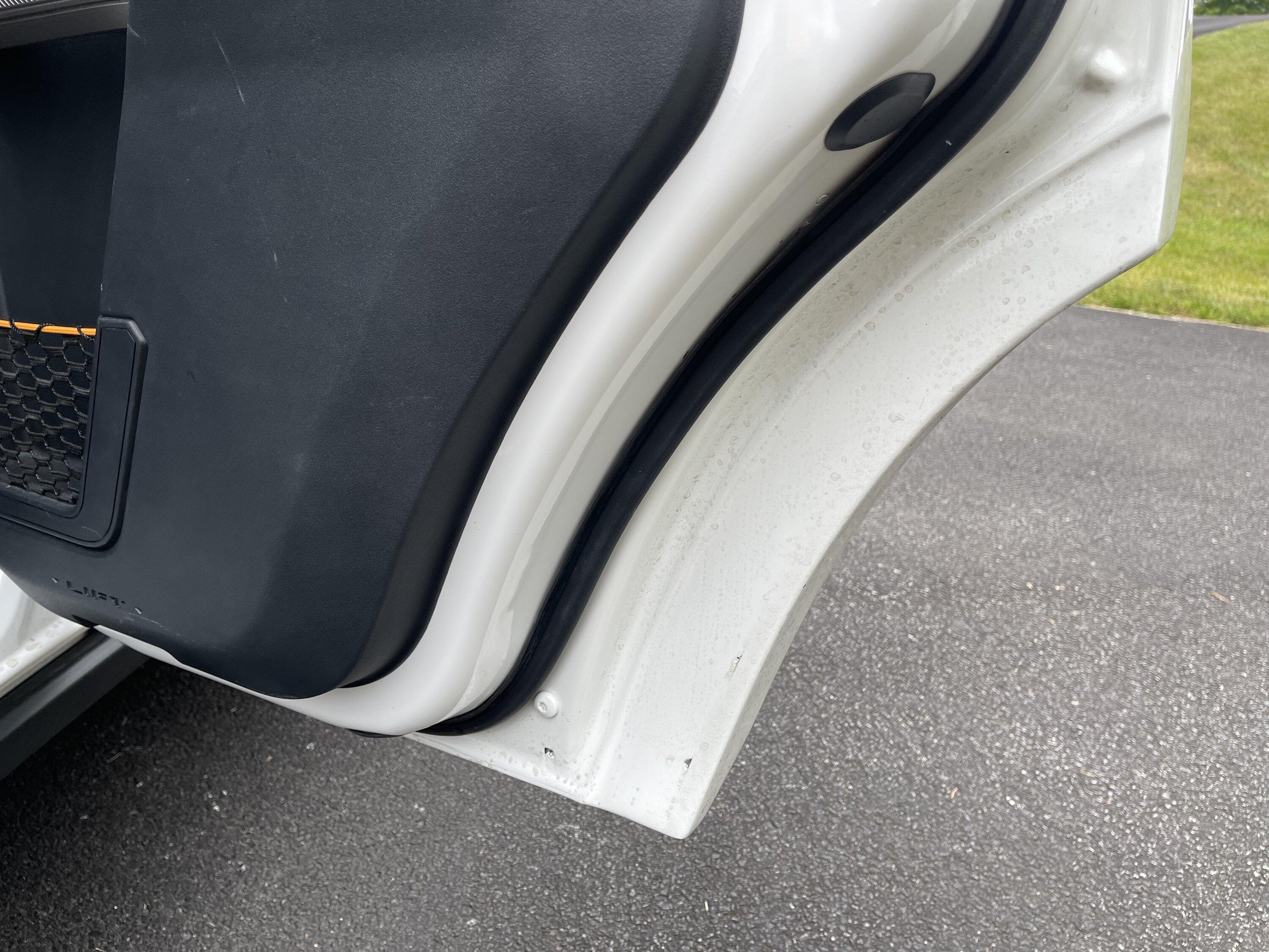

Looks very nice. Did ADV do the work or somewhere else? How did they blend the fiberglass into the aluminum door?
Bondo?
Bondo?
I'm on the east coast otherwise I would have used ADV for the install. Everyone's experience is different, but if you've never done anything like this before and its a possibility then I'd highly recommend having the company that manufactures the part also do the install.
Regarding the doors, I believe they screwed the fiberglass into the door to secure it and then filled the seams with duraglass.
