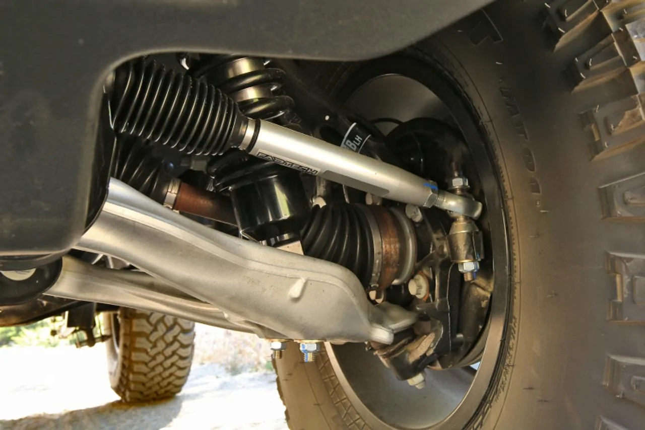

In stock and ready to ship is the Fabtech Heim joint tie rod kit!
FEATURES
  • 3/4" ID PTFE Lined FK Heim ends
  • 17-4 Heat treated stainless steel clevises and tapered pins
  • Billet aluminum adjusting sleeves with wrench flats for easy adjustments
  • Nitrile rubber spec dust boot to protect steering rack
  • No drill installation
  • Direct replacement for factory tie rods assembly

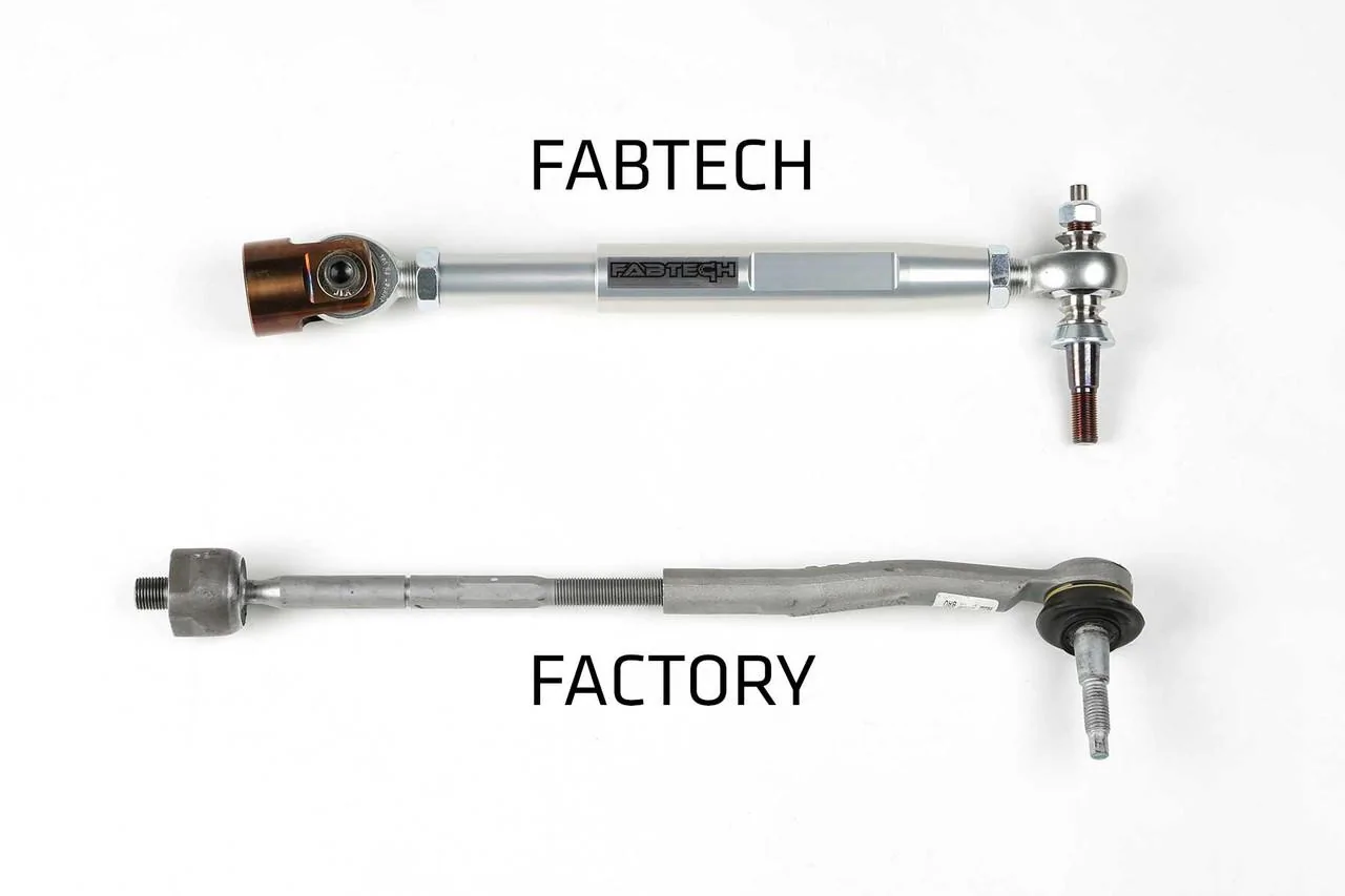

Amateur hour:
What is the benefit of an aftermarket tie rod?
Is it to add performance compared to the stock tie rod? Or most so to make up for deficiencies with the stock tie rod?

Amateur hour:
Questions are welcome, we are here to help.
The stock tie rods are the known weak point on any IFS system. Our Broncos are not immune from that problem. Look at the comparison pics. When torque is applied to the front wheel the natural physics want to pull and bend the weakest link, the tie rod. Also hitting rocks from the side bends the weakest link.
