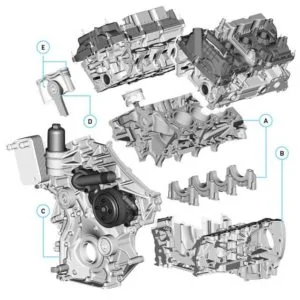

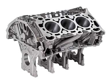

The 2.7 has dual injection vice direct only injection & also CGI lower block. Not hearing that about the 3.0.
Both use CGI blocks. the block is really a two-piece design with an aluminum outer lower casting.
Sintercast is the cylinder block supplier for Ford. 2.7 and 3.0 are pictured in the link
https://www.sintercast.com/market/sintercast-passenger-vehicles/
Ford Bronco Bronco Raptor .. crazy JUMP in the first 10 seconds!  On and off road driving experience ford-2
shitty res but A. is the CGI block and main caps and B. is the Aluminum lower casting.
Ford Bronco Bronco Raptor .. crazy JUMP in the first 10 seconds!  On and off road driving experience ford_2-7_3-0_ecoboost-300x300
I will agree that dual injection is better than just direct, both for performance and long term reliability. Using Top Tier fuel is a must and personally, I would say a catch can is a must have mod for the 3.0.
