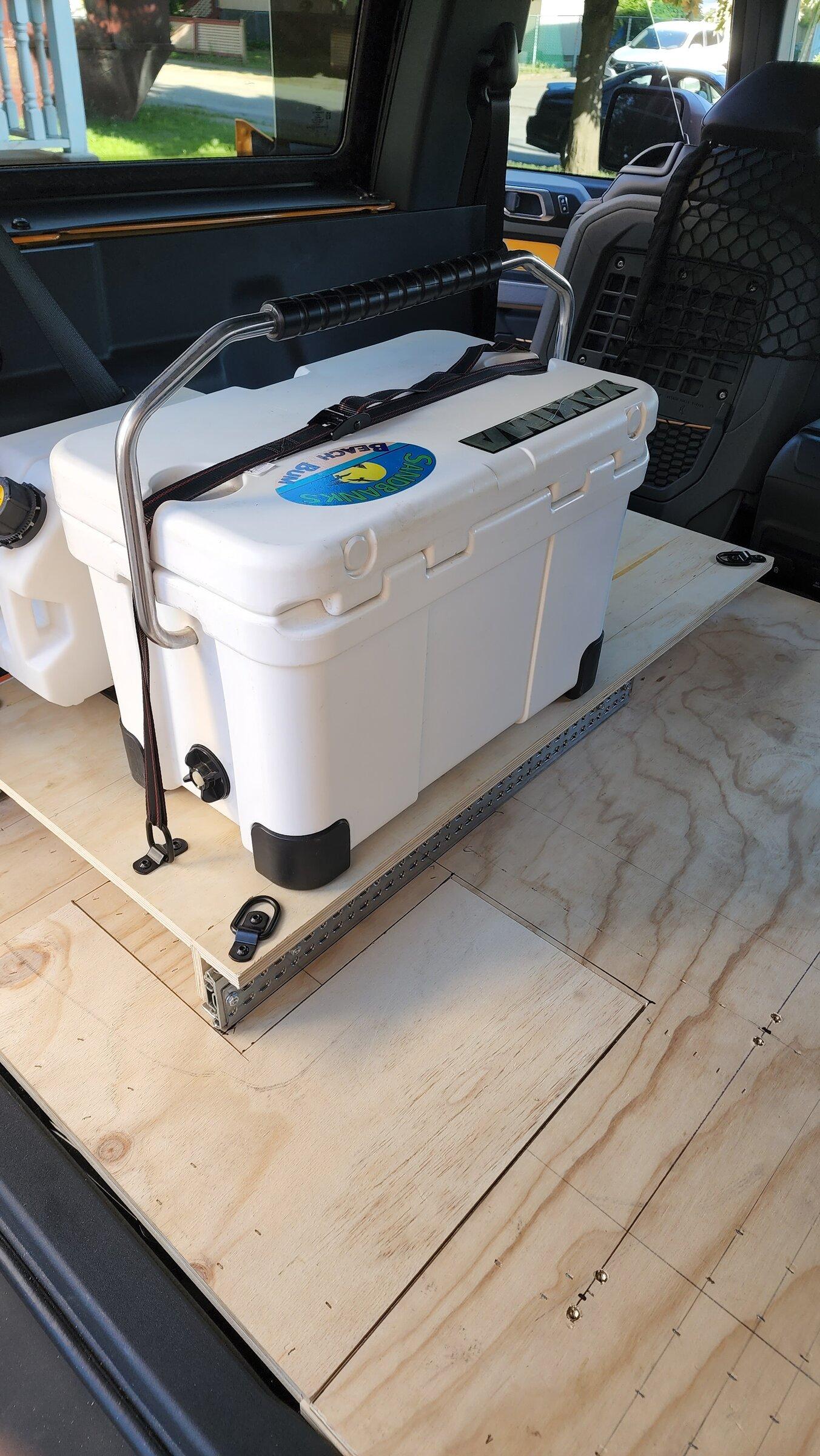

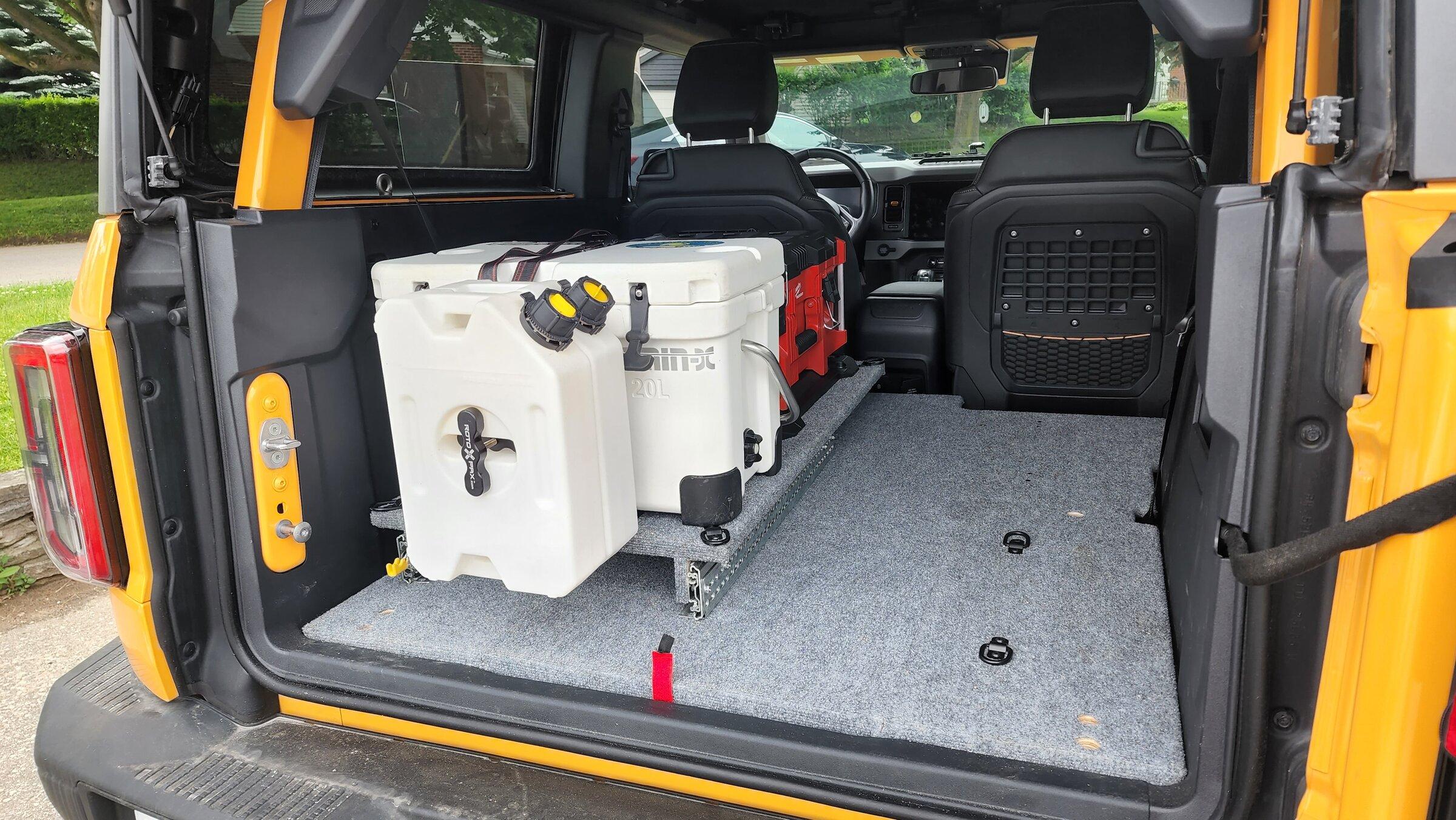

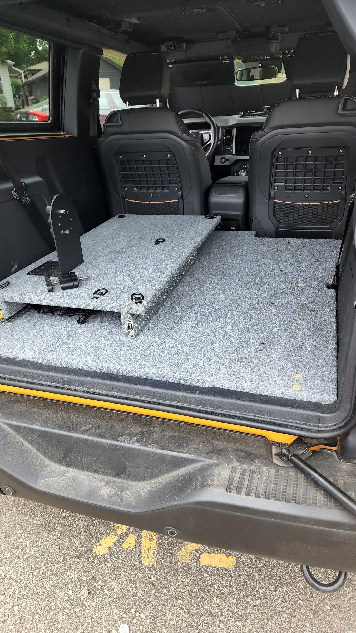

Finally finished my cargo load floor on the 'Bad Mule'...
1/2" plywood floor, 1/2" and 3/4" furrings utilizing 8 factory fastening locations. Majority of the construction is glued and stapled. My anchor mount locations utilizing 1/4-20 tee-nuts or threaded inserts.

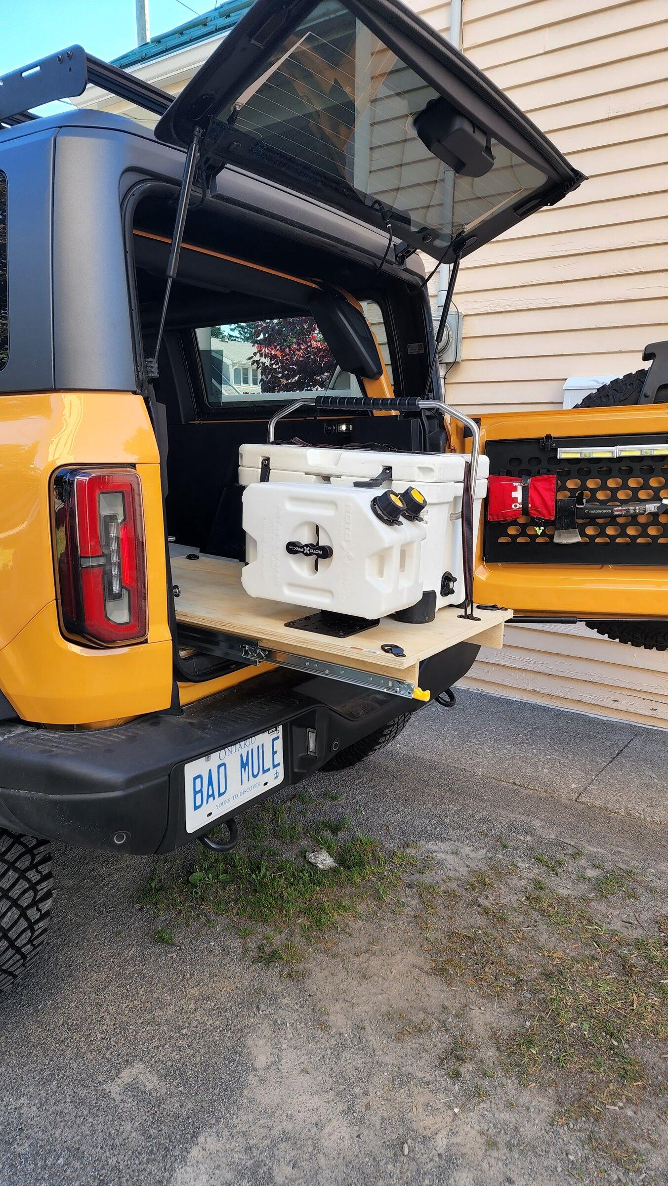

Slide platform is 3/4" ply, on locking, 28" sliders, with 1/2" jointed ply uprights.
Upholstered in unbound indoor/outdoor carpeting.

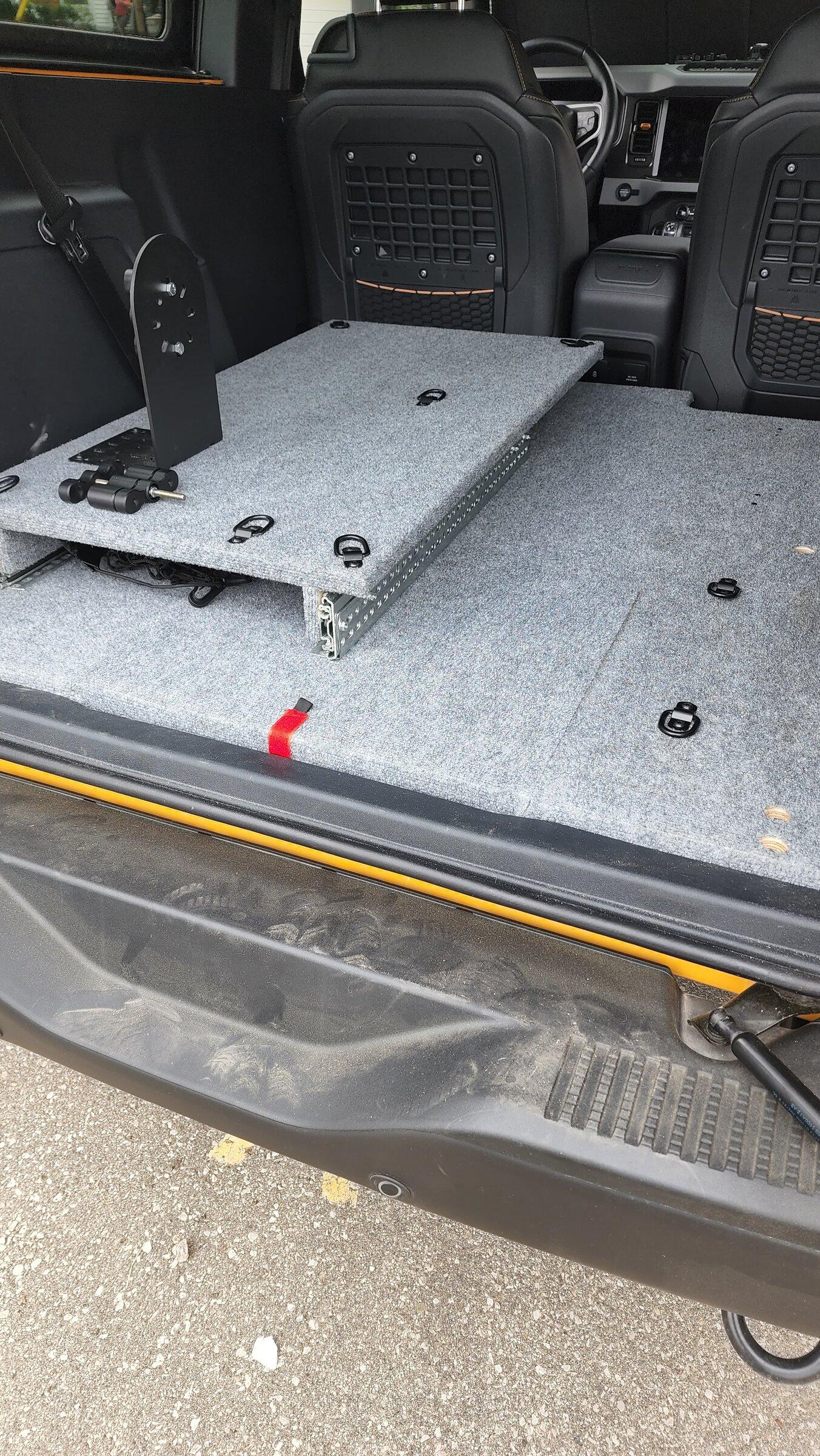

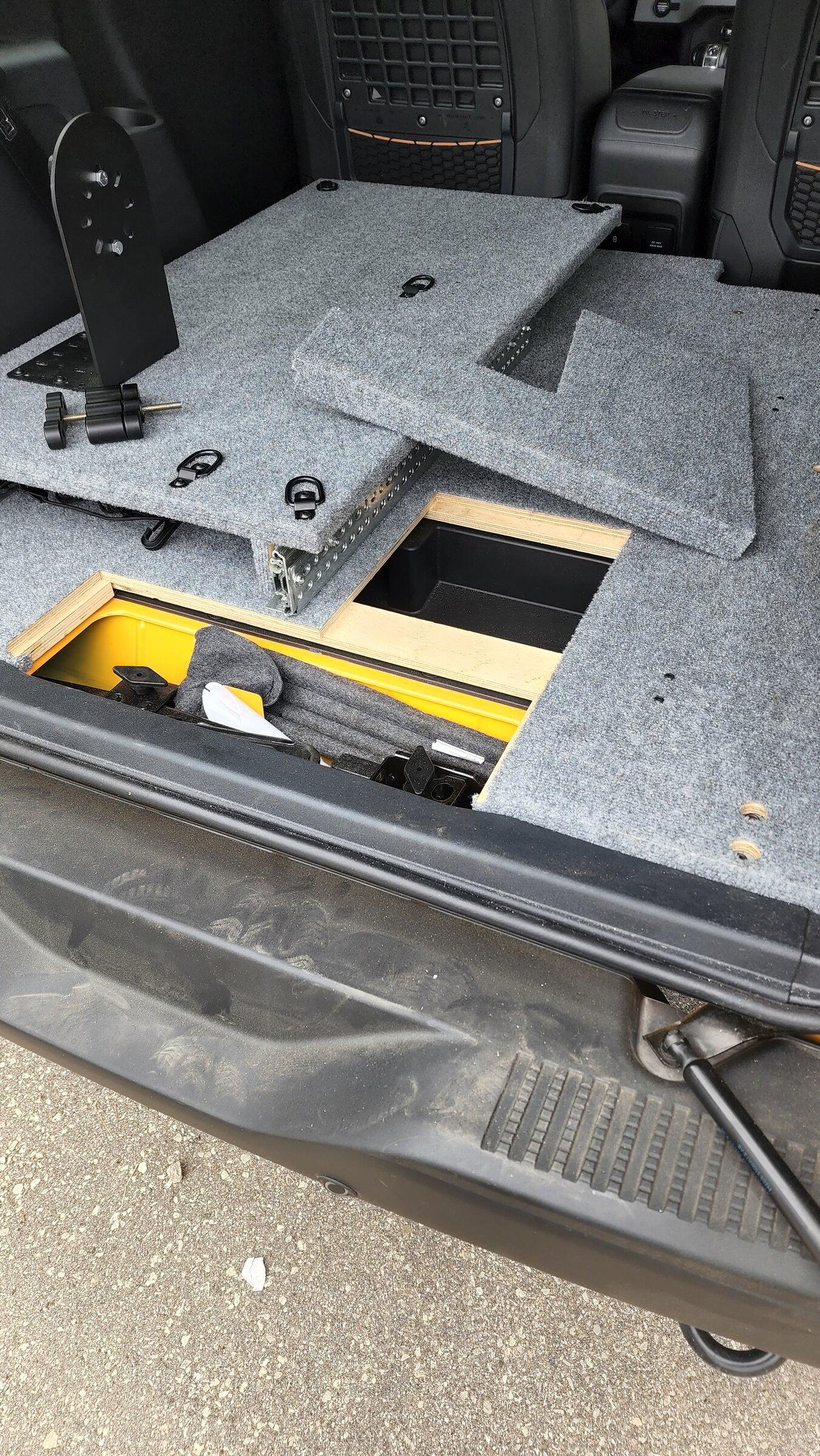

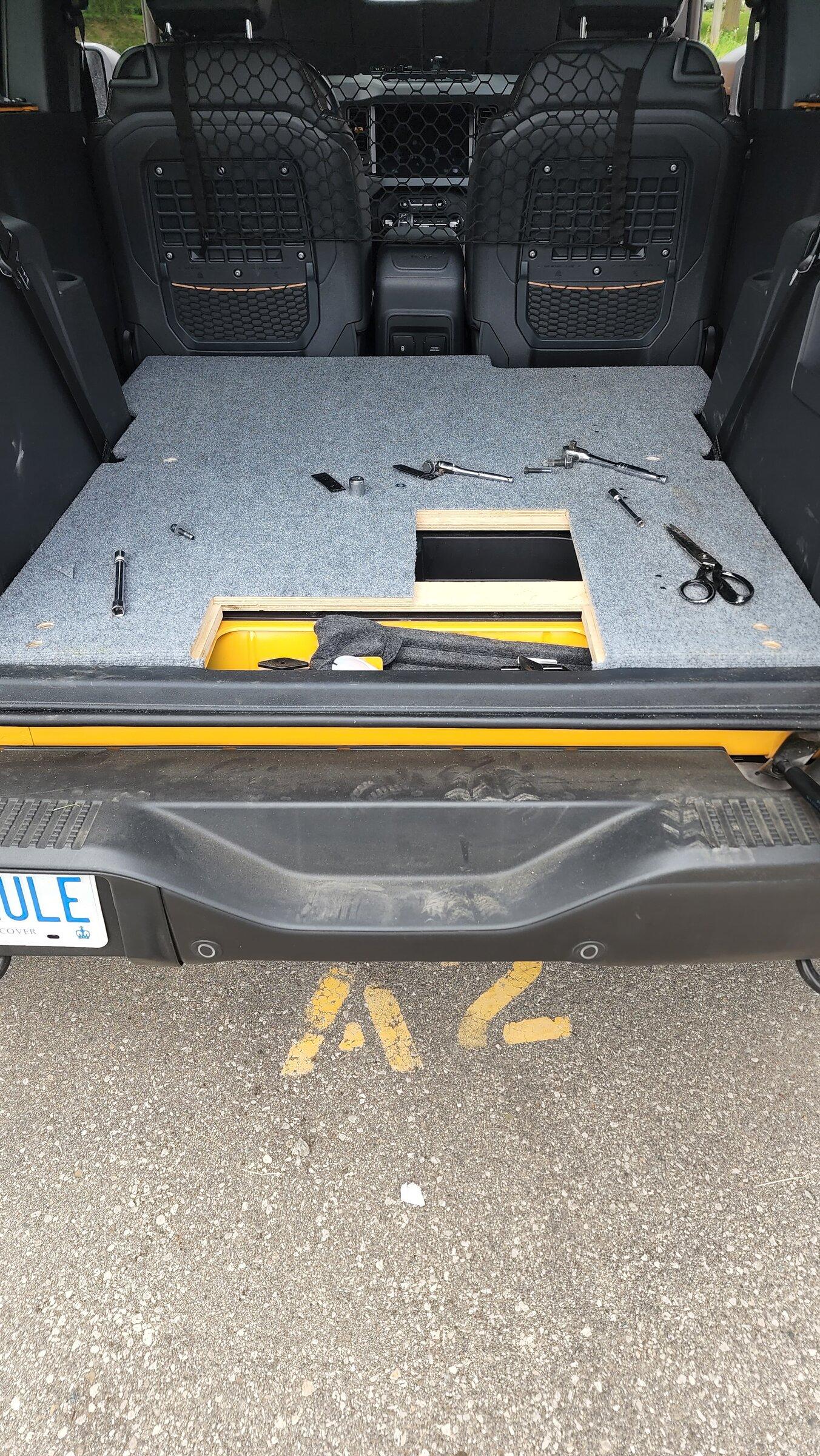

Full access to the jack and storage cubby...
Ford Bronco Custom 2-door seat delete load floor and slider 20220605_125341
Passenger side floor has multiple anchor locations to accommodate different load-outs (showing just the button-head hardware for place marker)

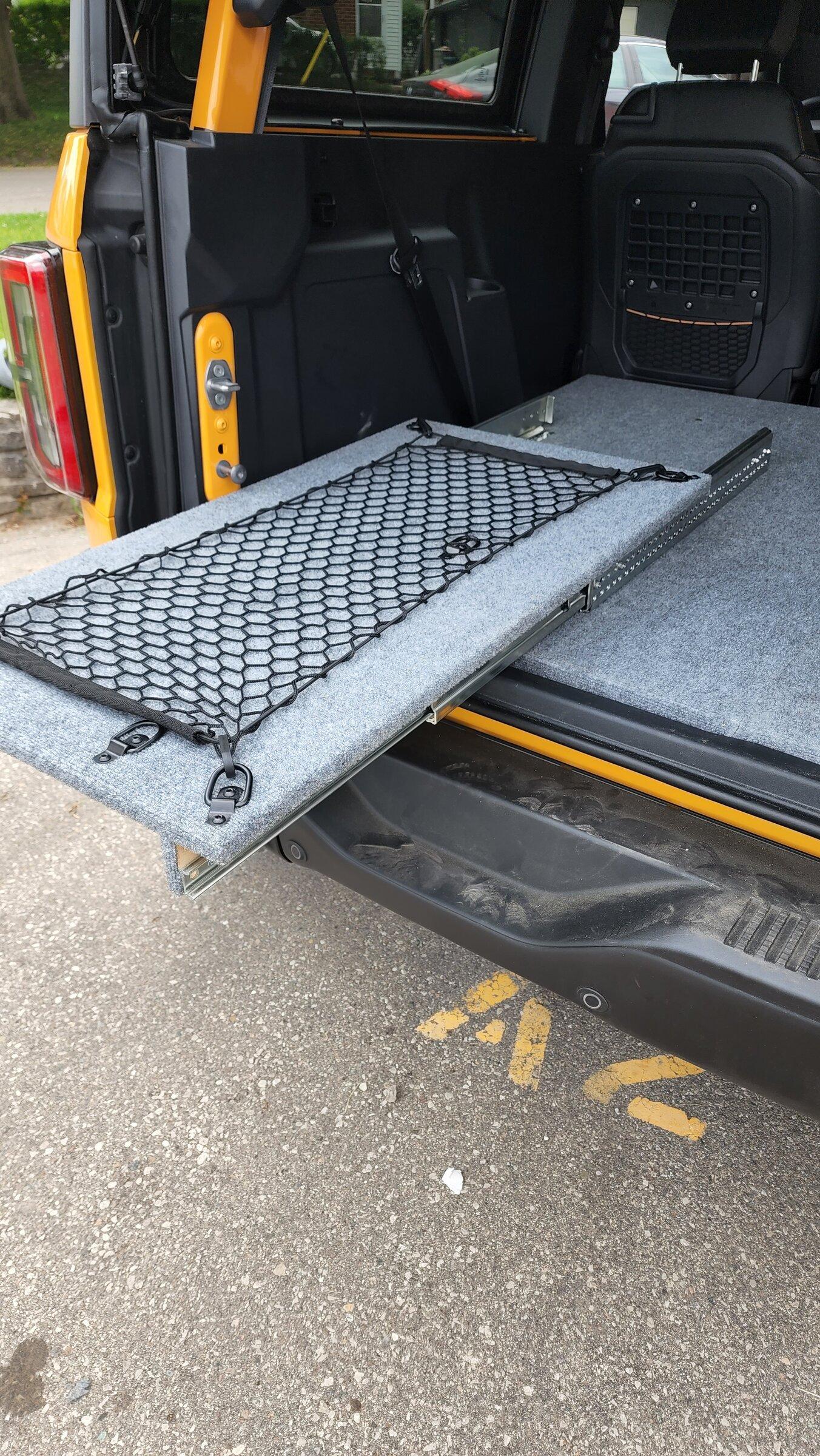

When not camping, I setup a cargo net for the grocery runs 👍🏻
Ford Bronco Custom 2-door seat delete load floor and slider 20220605_125009
Ford Bronco Custom 2-door seat delete load floor and slider 20220605_121849

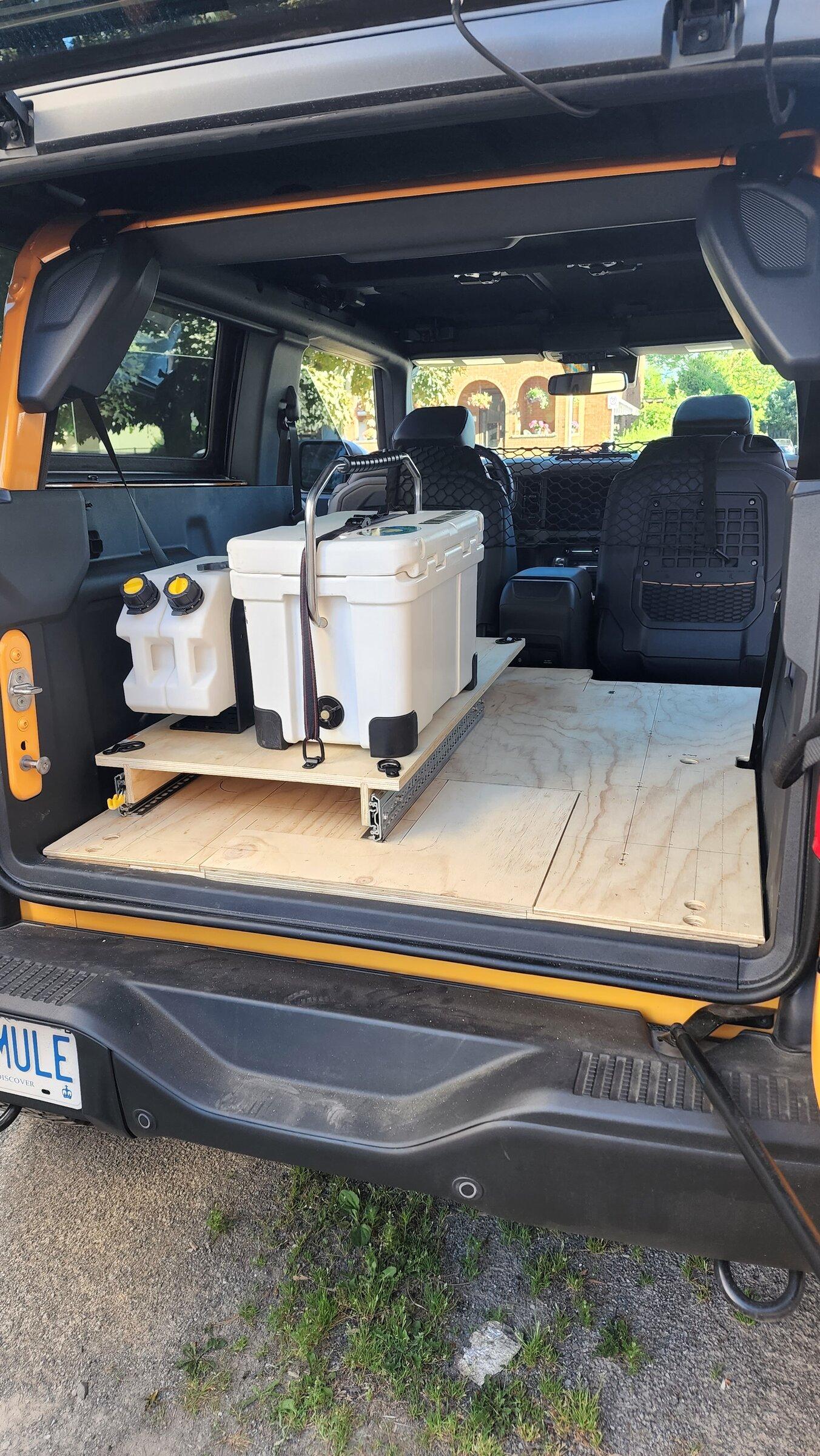

Here is a what the typical load would look like on the platform (before I carpeted it)
Space in behind the cooler/Rotopax is for dry-good storage

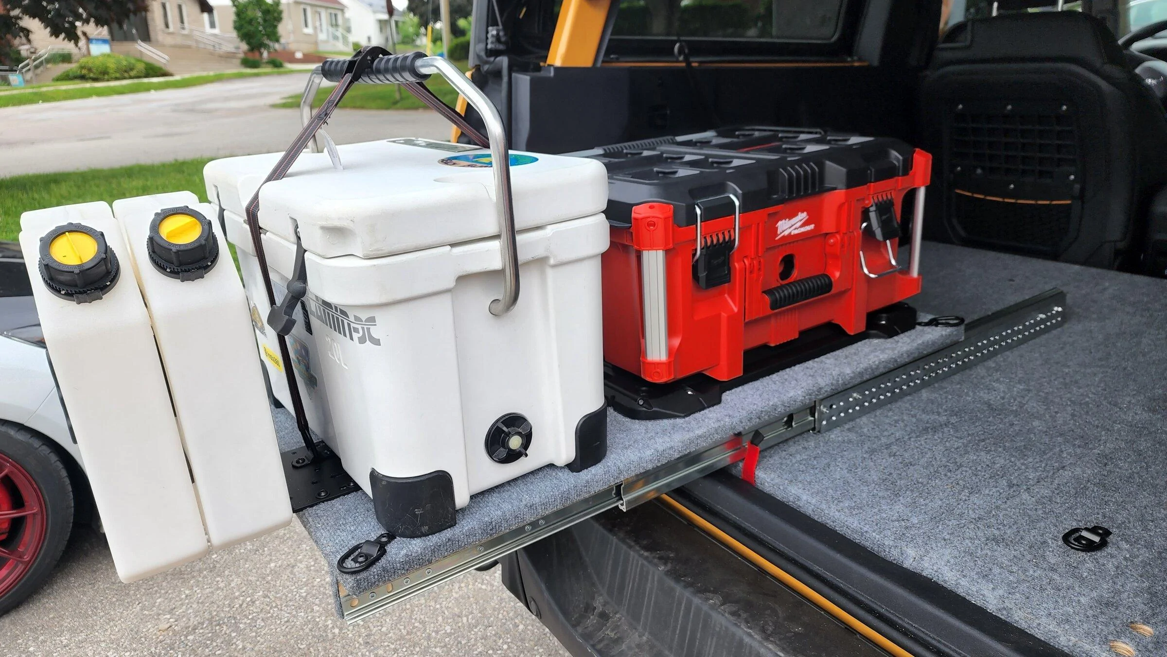

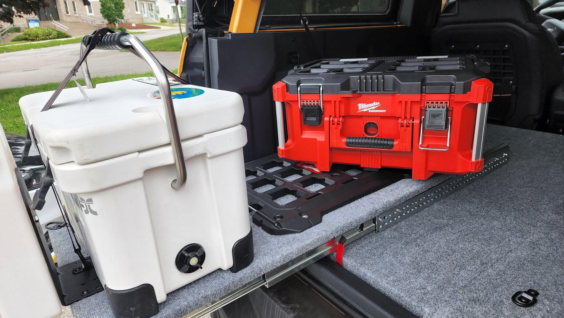

UPDATE:
Okay... I think I have my system finalized now...
Added a 22" Milwaukee Packout box and plate to the slider for dry-goods 👍🏻

Looks like that Cooler might have a slot next to the handle, to insert a flat metal tiedown point (or just running the strap through it), so you could open the lid without unstrapping it? A nicely done build.
Yup, it does... Has slots for a strap on either side. I'm a little short on straps right now 🤣
It's not too inconvenient to get at the way it is. Once I'm parked for the day, the cooler will come out and I use the space as a prep area...in this regard, 1 strap over the top is way easier 👍🏻

Nice. That looks really good. I need something like that. Please post measurements!
If I recall, the actual platform CAN be done with a half sheet of ply wood...
48" deep and somewhat less than that across at the widest will work.
I bought a full sheet and I'm 50 or 51" deep
