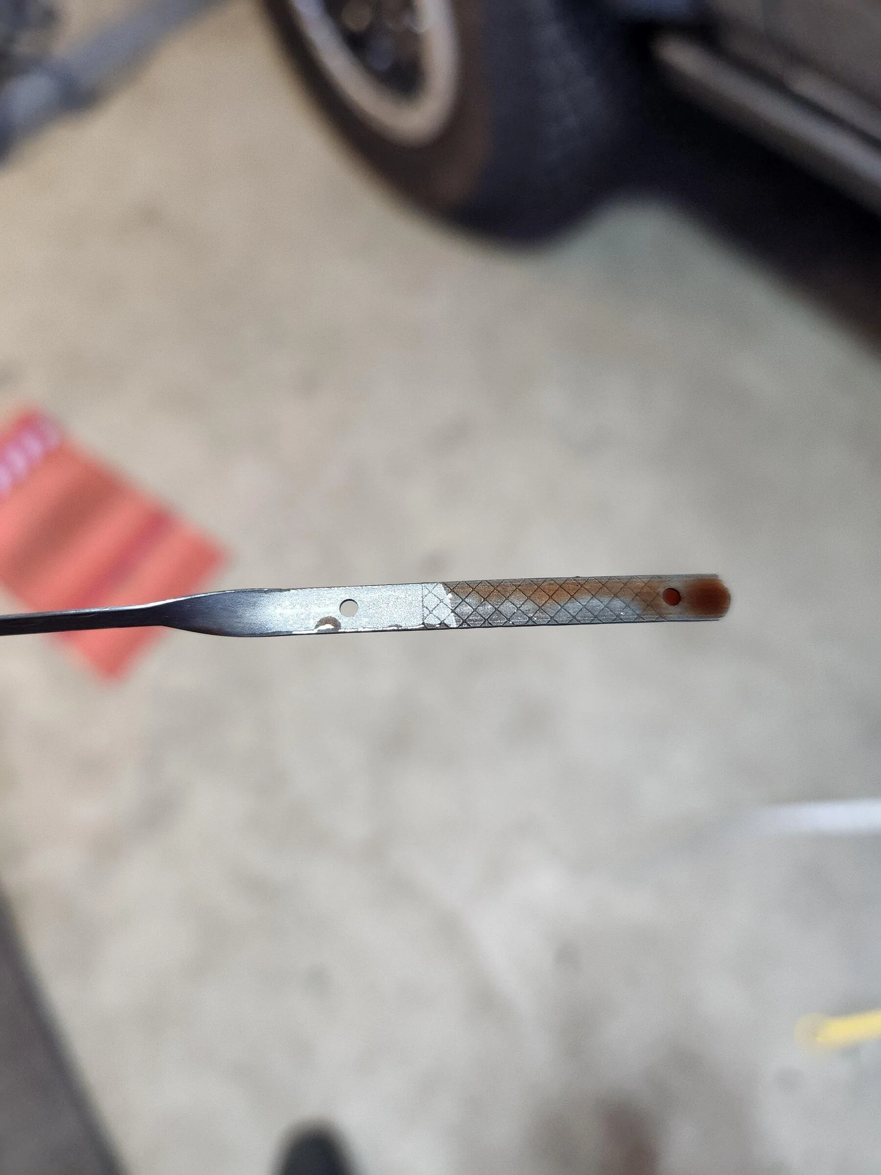

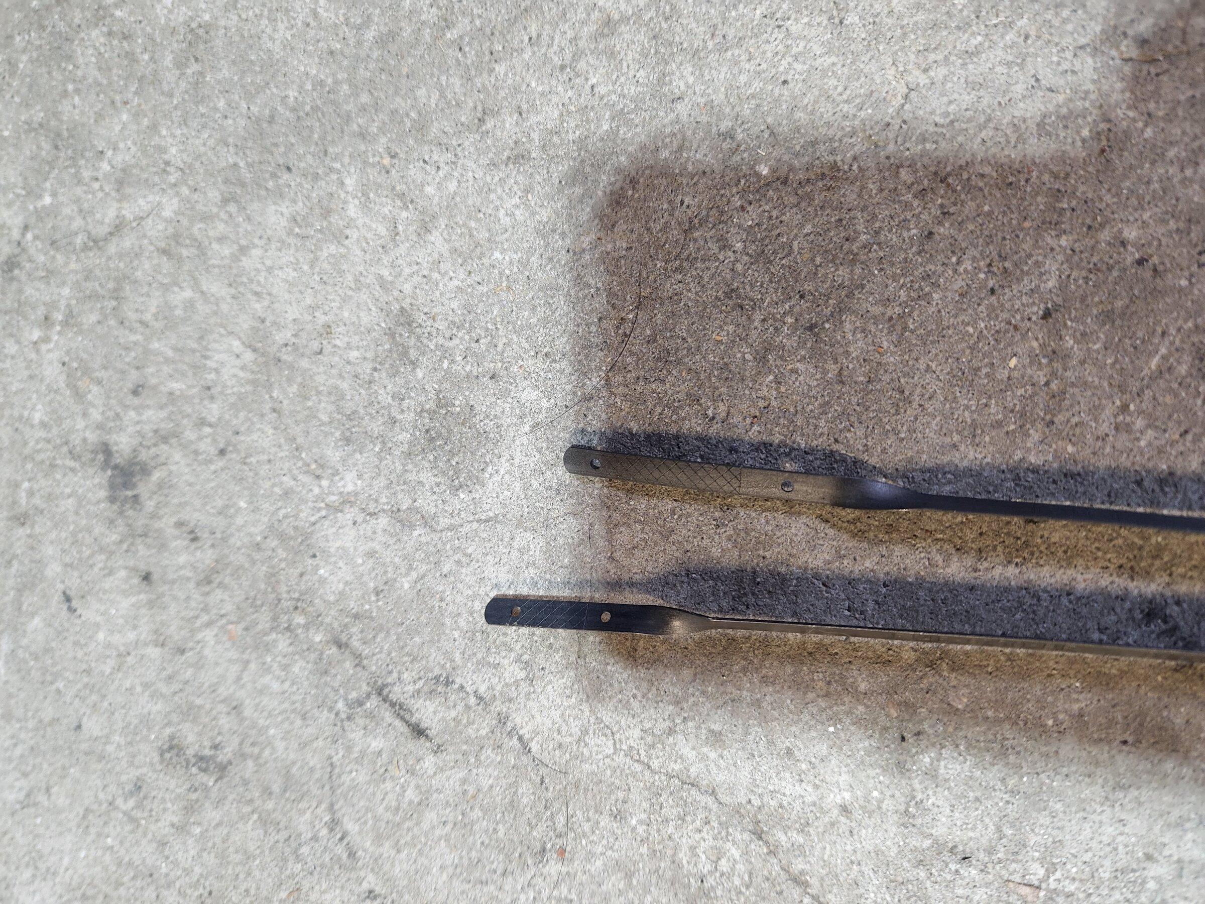

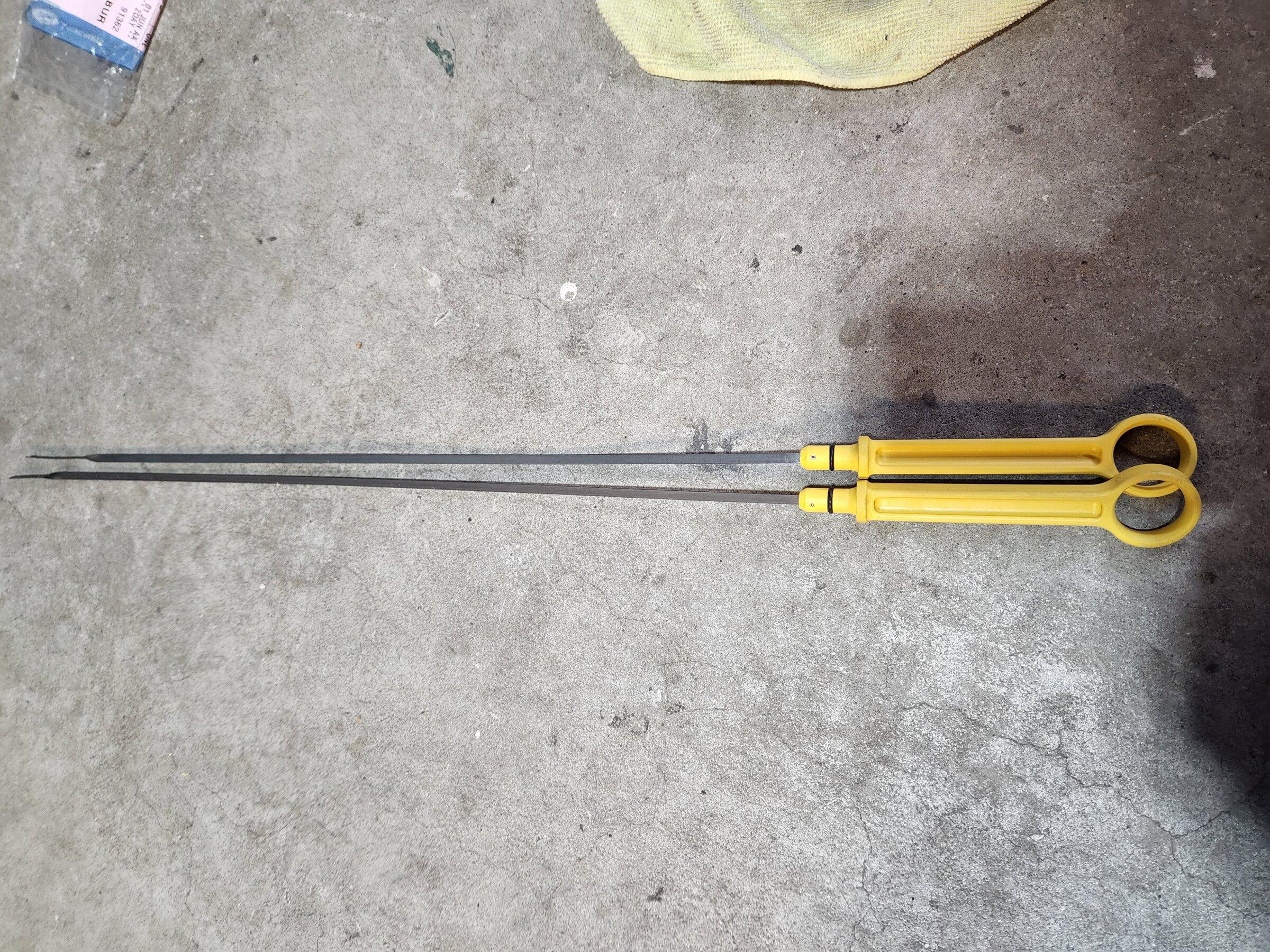

Here it is...the definitive answer to our issues! The facts:
The correct stick is PN MB3Z-6750-B
It is 7/8 of an inch shorter from the base of the handle to the MAX line than the current sticks in our Broncos.
Note the pics...showing side by side comparisons of overall length and max mark lengths. Also note my oil position as measured PER THE MANUAL on the "new" stick. If you want an accurate oil measurement using the procedures indicated in the manual, with 7 quarts, buy the MB3Z-6750-B. I ordered it from my dealer Friday, it came today...19.45.

You are most welcome...this stupid dipstick thing has haunted me since my first oil change back in October...my hope now is that it is TRULY the correct stick (it is now listed as such in the parts database) rather than Ford teasing us with a "7 quart oil capacity" and then later figuring out that although it holds 6 that it needs an entirely different stick to get an accurate reading (which the new one does beautifully). Call me skeptical but it seems really odd that the "solution" to the initial stick reading a quart off is repurposing an existing stick intended for an entirely different engine perplexes me. Even so, it makes me happier that at least all appears well as soon as I measure my oil.
I would wager that a lot of folks, however, will buy the right stick, then check their oil immediately after adding it and not wait the at least 15 minutes, and then complain that their oil measures too low...wait for it...
So to everyone...if you buy the correct stick, please wait until AFTER 15 minutes has passed after shutting off your car/adding oil to check the level (as per the manual).
