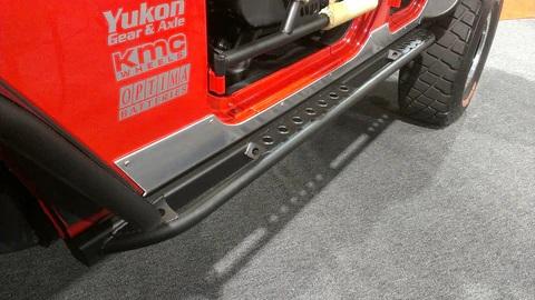

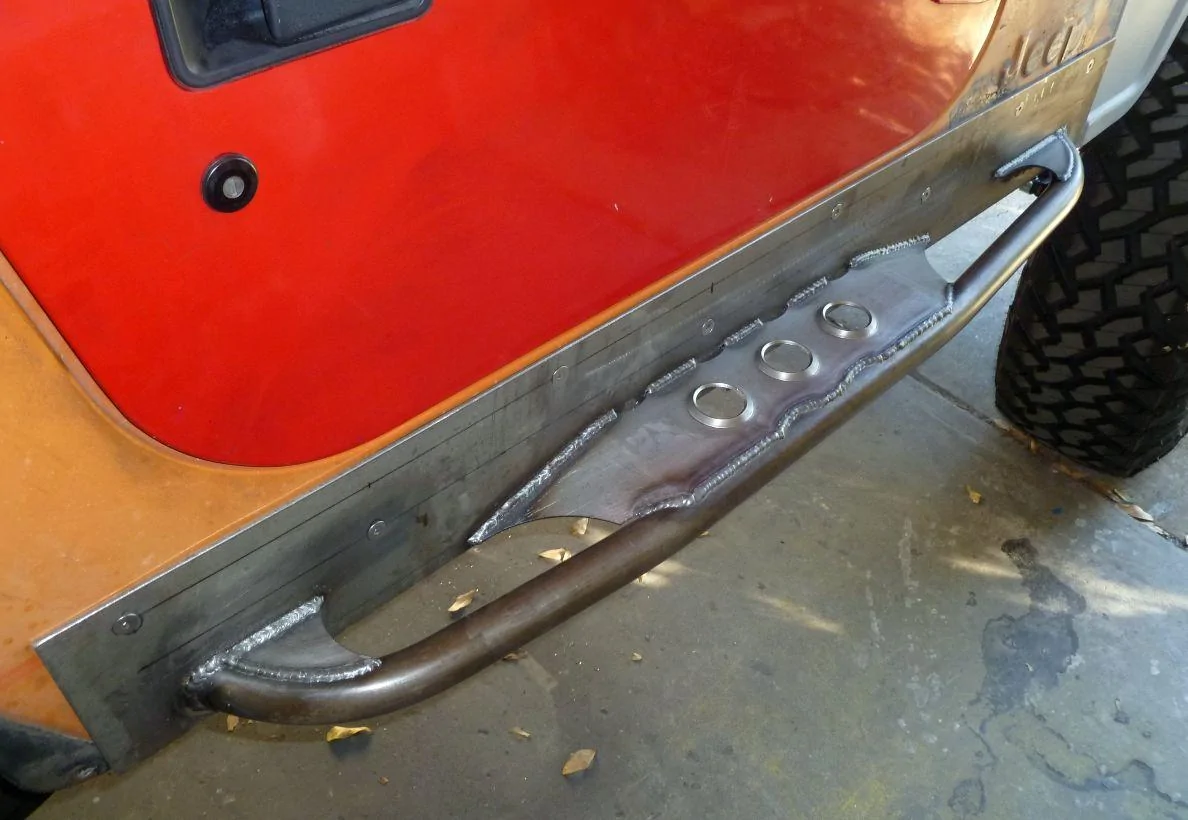

I was all set to bend up a pair of rails myself but it turns out DIY kits are already out there for 07-18 Jeep JKs which seem to be the right length for a 2dr Bronco. For roughly 2 bills, I found 2 options I'm considering. I can't buy steel and give my time any value for that price. Stay tuned to see which I buy and how they look installed.
Warrior 54002:
Ford Bronco Adding Jeep Rubicon rails to Bronco stock rock sliders 54002-step_0
Poison Spyder DIY-50-040:
Ford Bronco Adding Jeep Rubicon rails to Bronco stock rock sliders F146122151

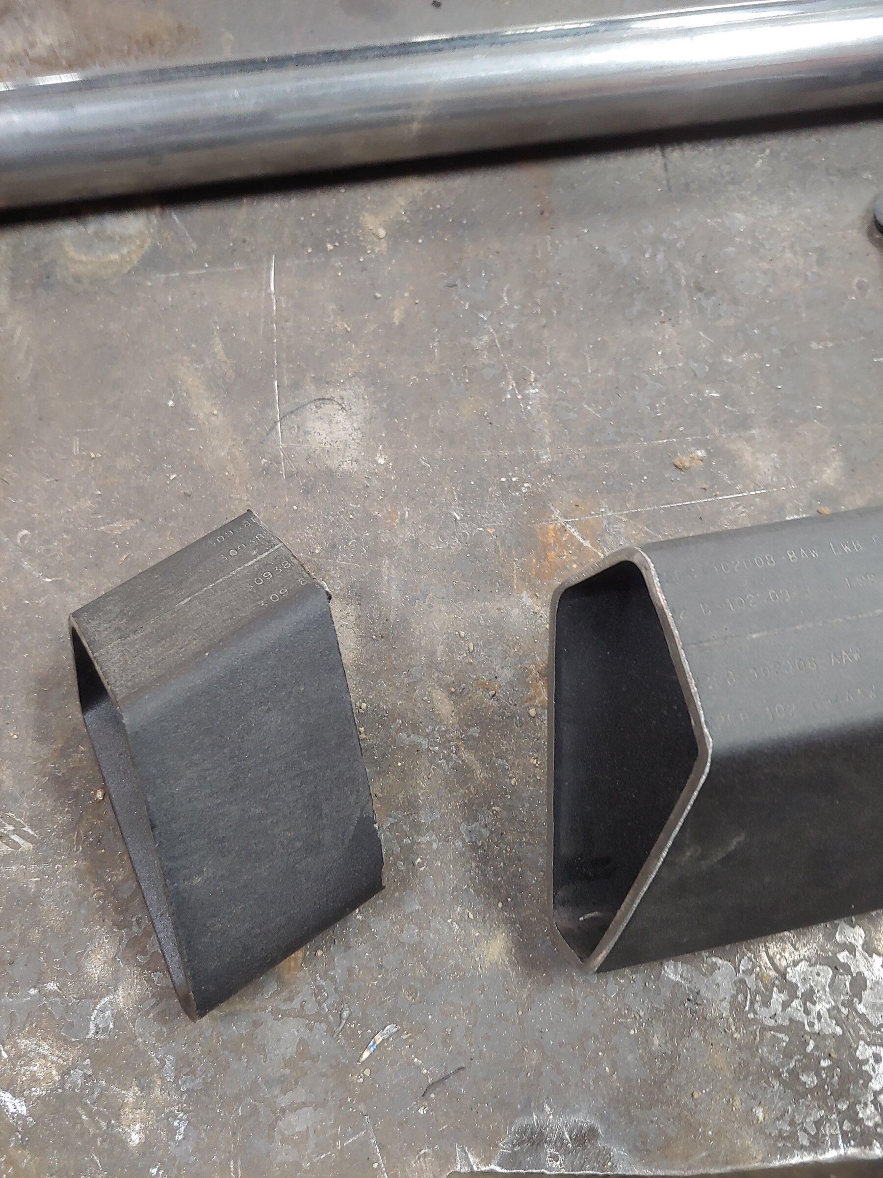

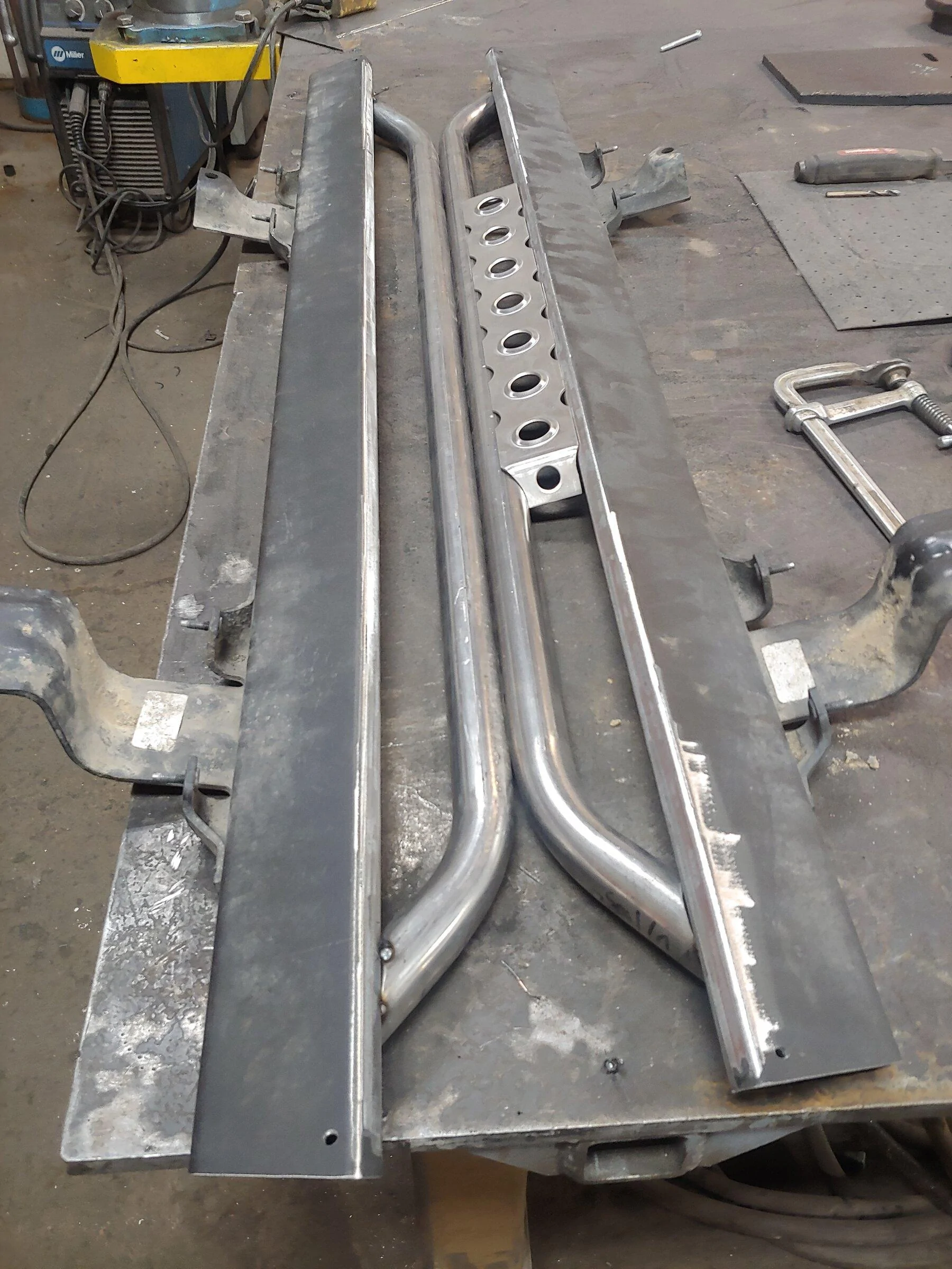

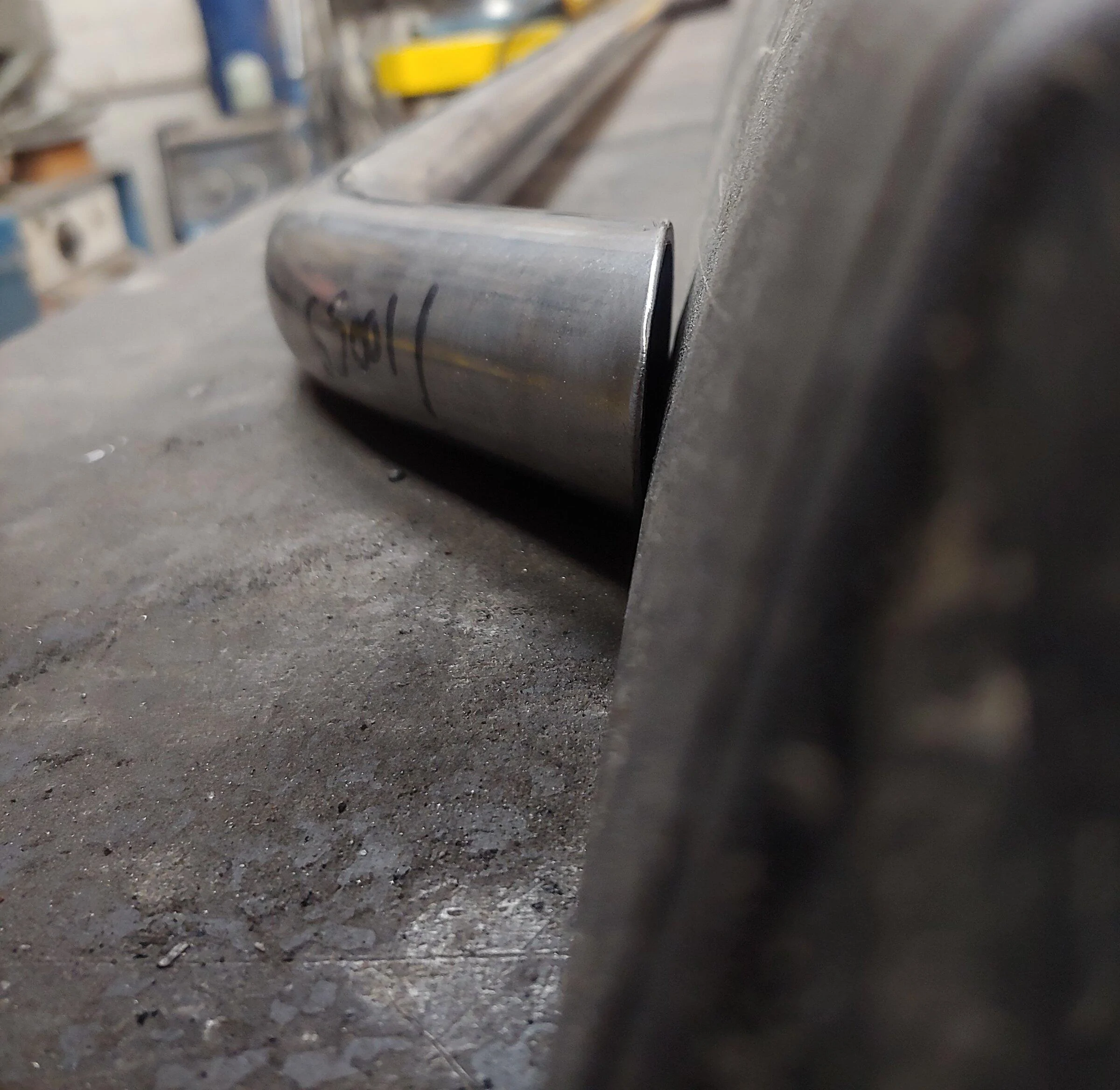

March 19, 2022

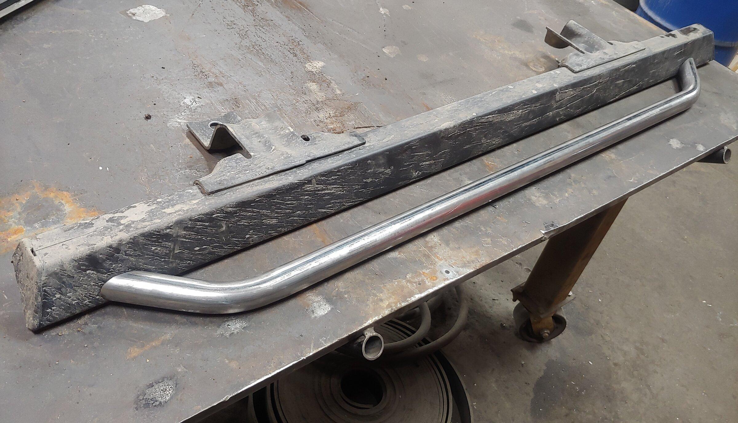

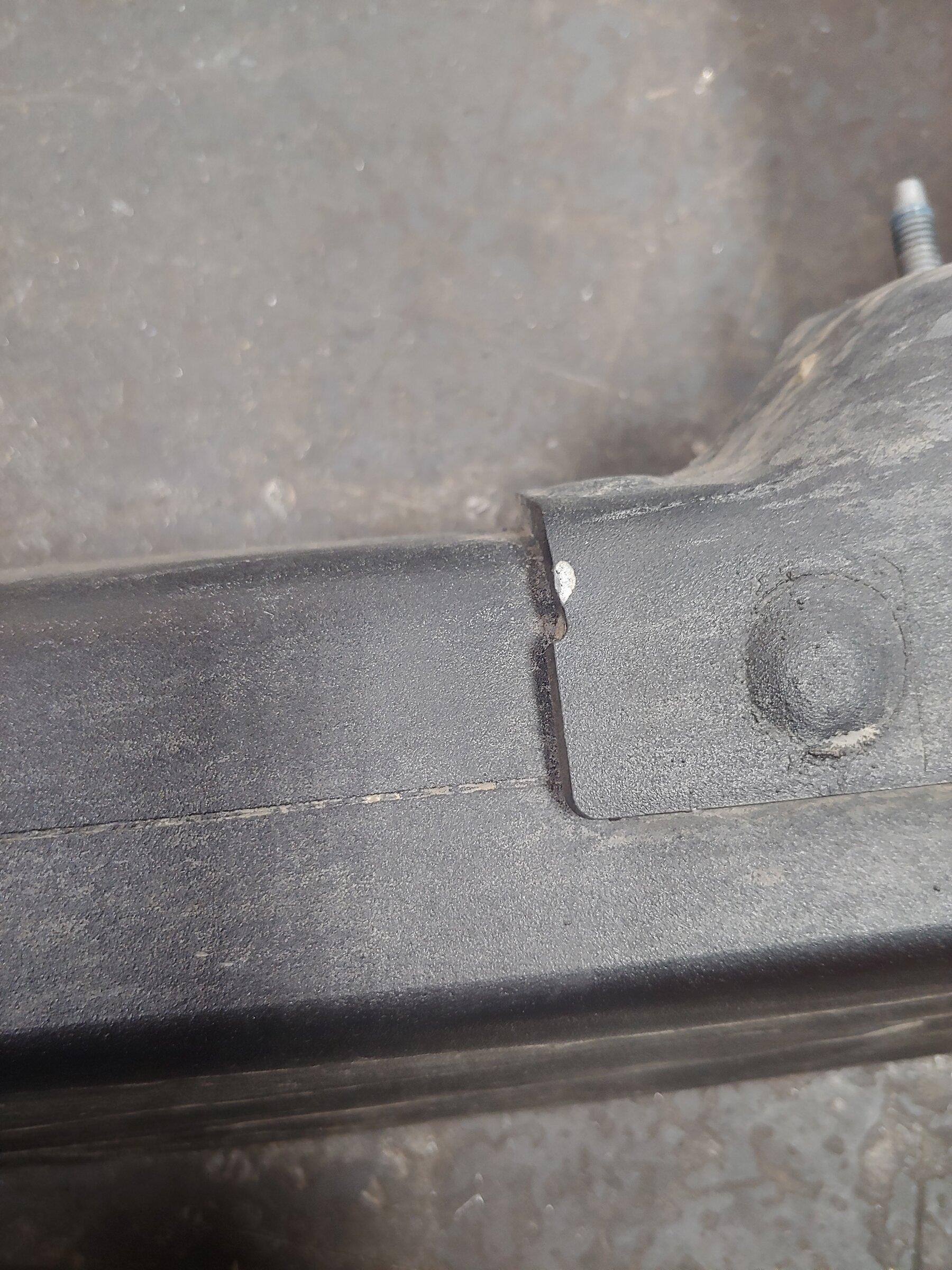

Starting the rail project today.
There is a slight angle difference but it looks like an easy correction.
Noticed the bottom brackets and a pronounced lip which is clearly undesirable for something that needs to slide. Going to throw a bead on there to bevel it a bit.
Trimmed off 2" from the front in case I want to run mud flaps.
Ford Bronco Adding Jeep Rubicon rails to Bronco stock rock sliders 20220319_072658-
Ford Bronco Adding Jeep Rubicon rails to Bronco stock rock sliders 20220319_072709-jpg
Ford Bronco Adding Jeep Rubicon rails to Bronco stock rock sliders 20220319_091105-
Ford Bronco Adding Jeep Rubicon rails to Bronco stock rock sliders 20220319_085101-

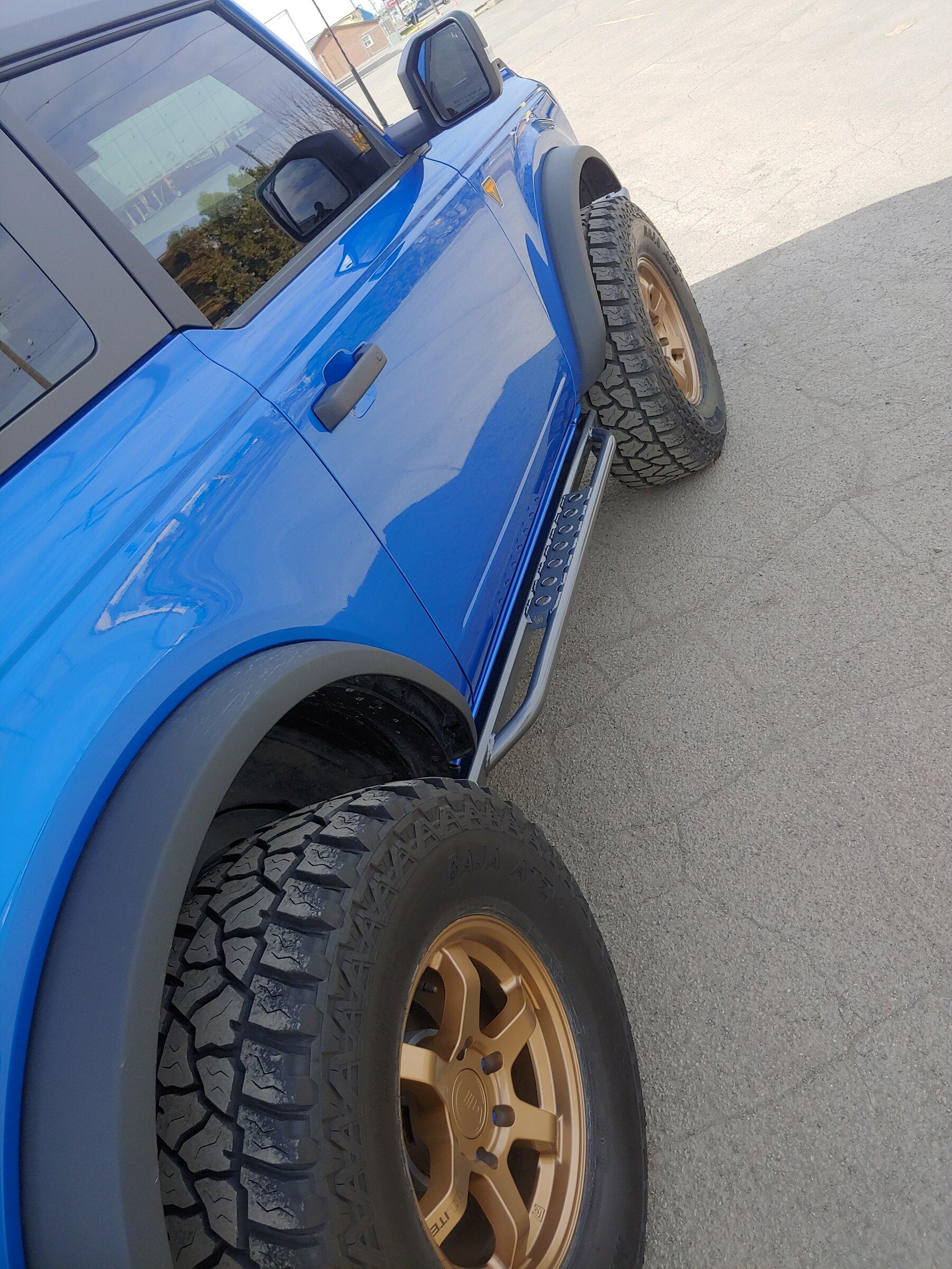

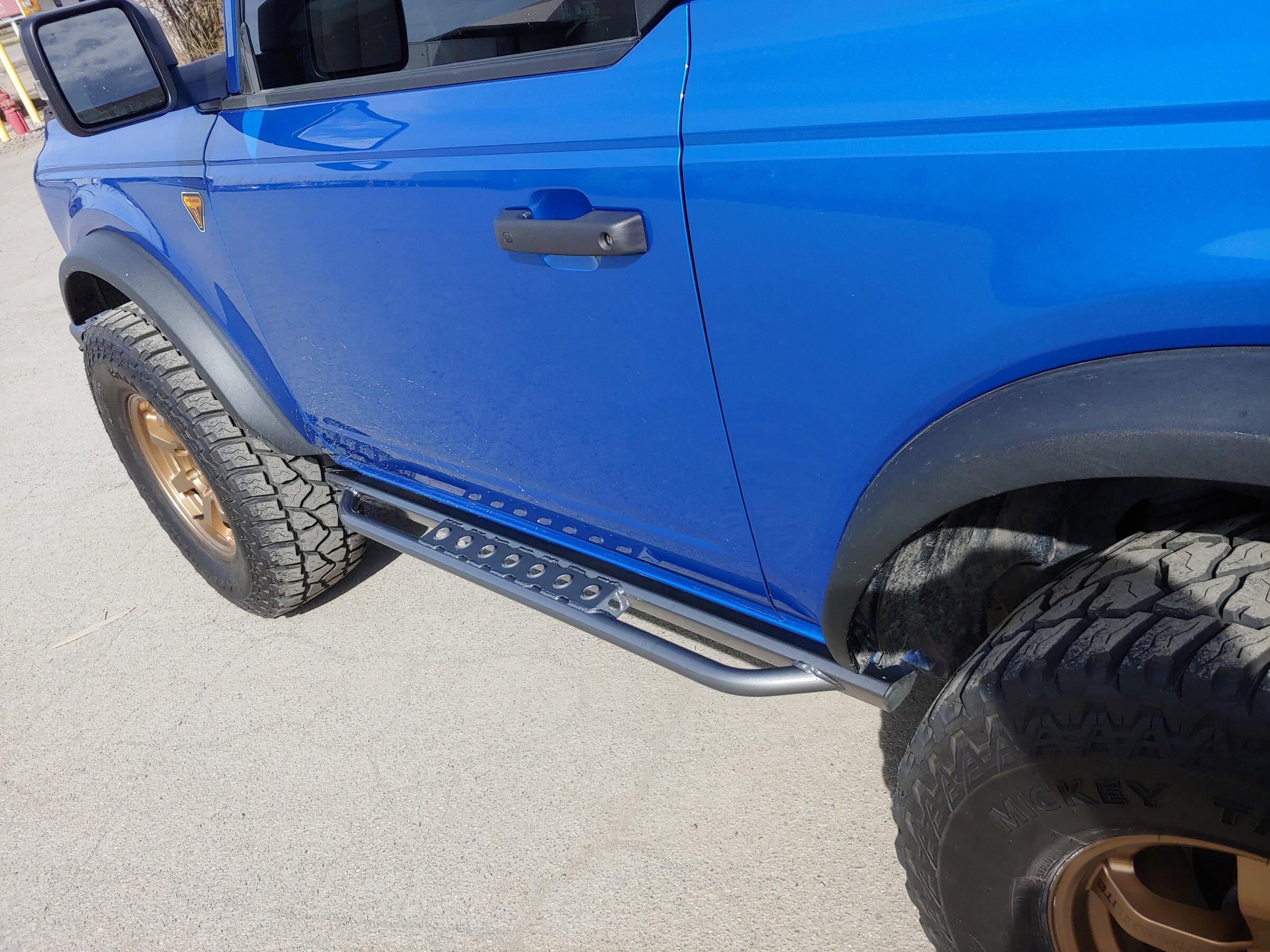

March 25, 2022
Progress
Ford Bronco Adding Jeep Rubicon rails to Bronco stock rock sliders 20220325_163249-jpg
March 26, 2020
Boom
Ford Bronco Adding Jeep Rubicon rails to Bronco stock rock sliders 20220326_110518_hdr-
Ford Bronco Adding Jeep Rubicon rails to Bronco stock rock sliders 20220326_110537-

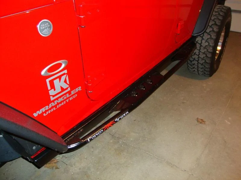

Finding pics of the 2dr Warriors installed is proving to be difficult so here's a 4dr version and 2dr and 4dr Poison Spyder.
Ford Bronco Adding Jeep Rubicon rails to Bronco stock rock sliders PSC Rico steps 003
Ford Bronco Adding Jeep Rubicon rails to Bronco stock rock sliders 54006-1_098aa1c3-88a2-4d48_large
Ford Bronco Adding Jeep Rubicon rails to Bronco stock rock sliders rico10

Settled on the Poison Spyder set and ordered. It looks like Jeep oem sliders have a flat face vs our slight angle, so they will require some trimming to get the angle right.
