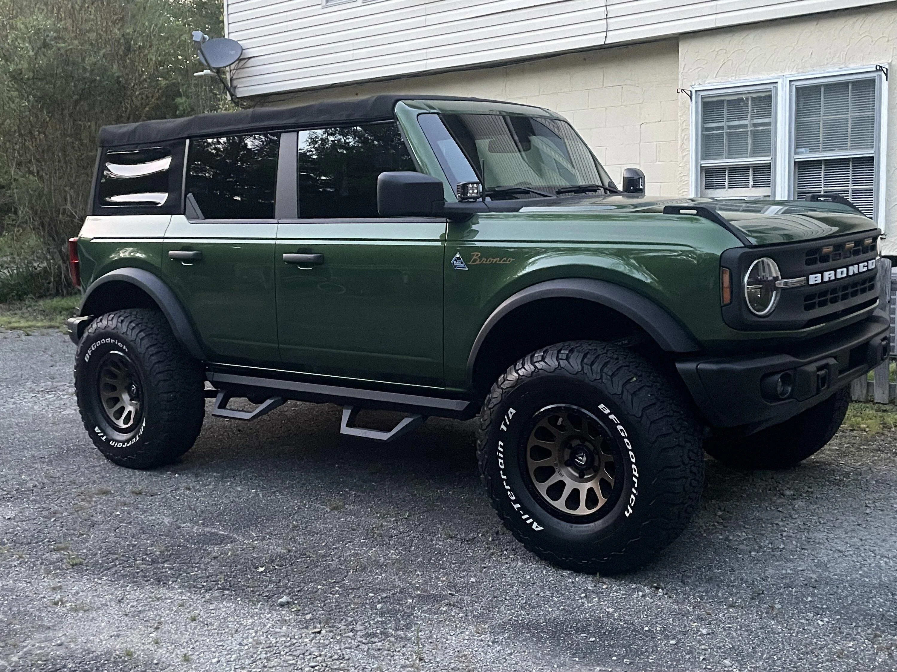

Ford Bronco 37x12.50r17 will not fit? 20230521_125435
BCT1212
brad
Aug 31, 2025
117
130
GA
two door bronco
Have a 3" zone lift. 1.5 borne wheel spacers.
37 12.5 r17 nitto recon Grapplers
Ditch that 1.5 spacer and you will be good. I’m running 37x12.5 ridge grappler on stock suspension and stock wheels…. No issues
