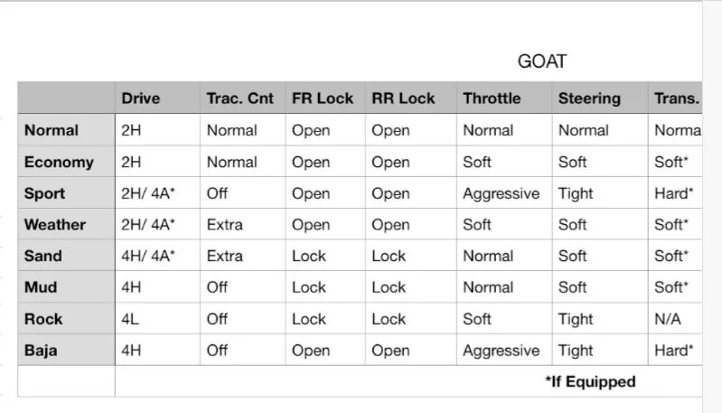

Do the GOAT modes manipulate steering and suspension?
Obviously steering will feel different in 4WD, but is the actual steering rack or anything else changed? Also I didn't think the suspension was capable of being stiffened/softened at all?
Steering, yes. Sport/Baja/Slippery modes in particular.
Same with Throttle - it's more aggressive on Sport/Baja, and less aggressive in Eco/Slipper.
Suspension - only on Raptor. It's the only model with active suspension stock.
And then the forward camera, in Baja and Rock Crawler modes (I think)
There's a good chart of what each does here:
https://www.cjponyparts.com/resources/bronco-goat-modes-explained
(according to that post GOAT modes can also affect the sensitivity of Traction Control, which I didn't know)
