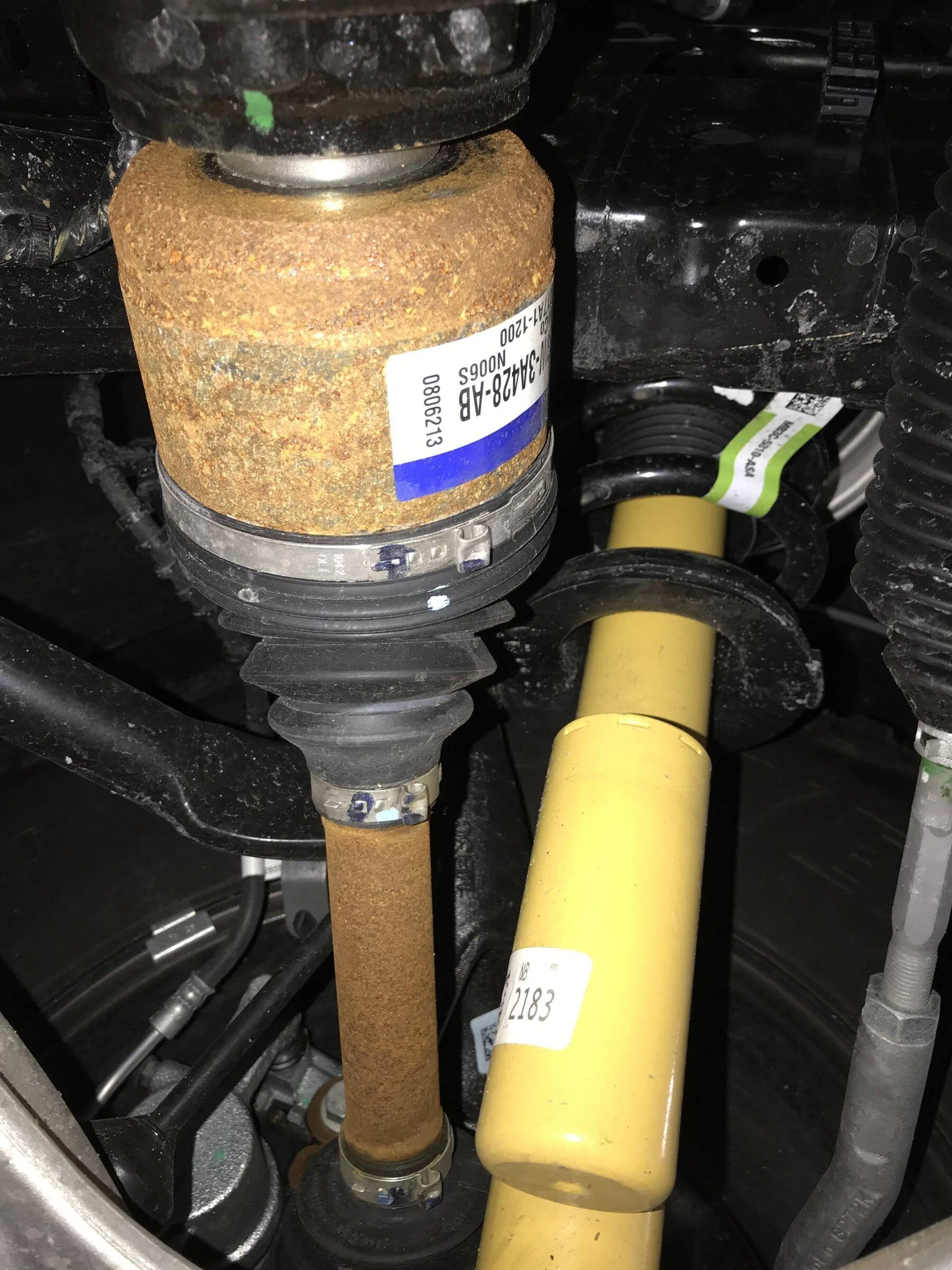

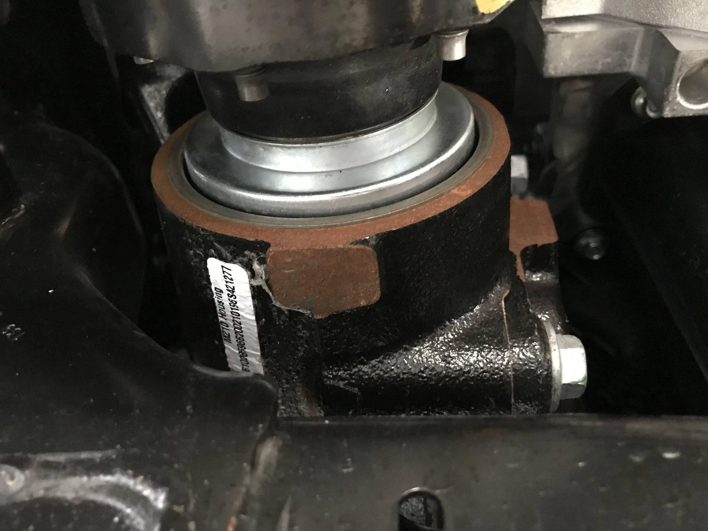

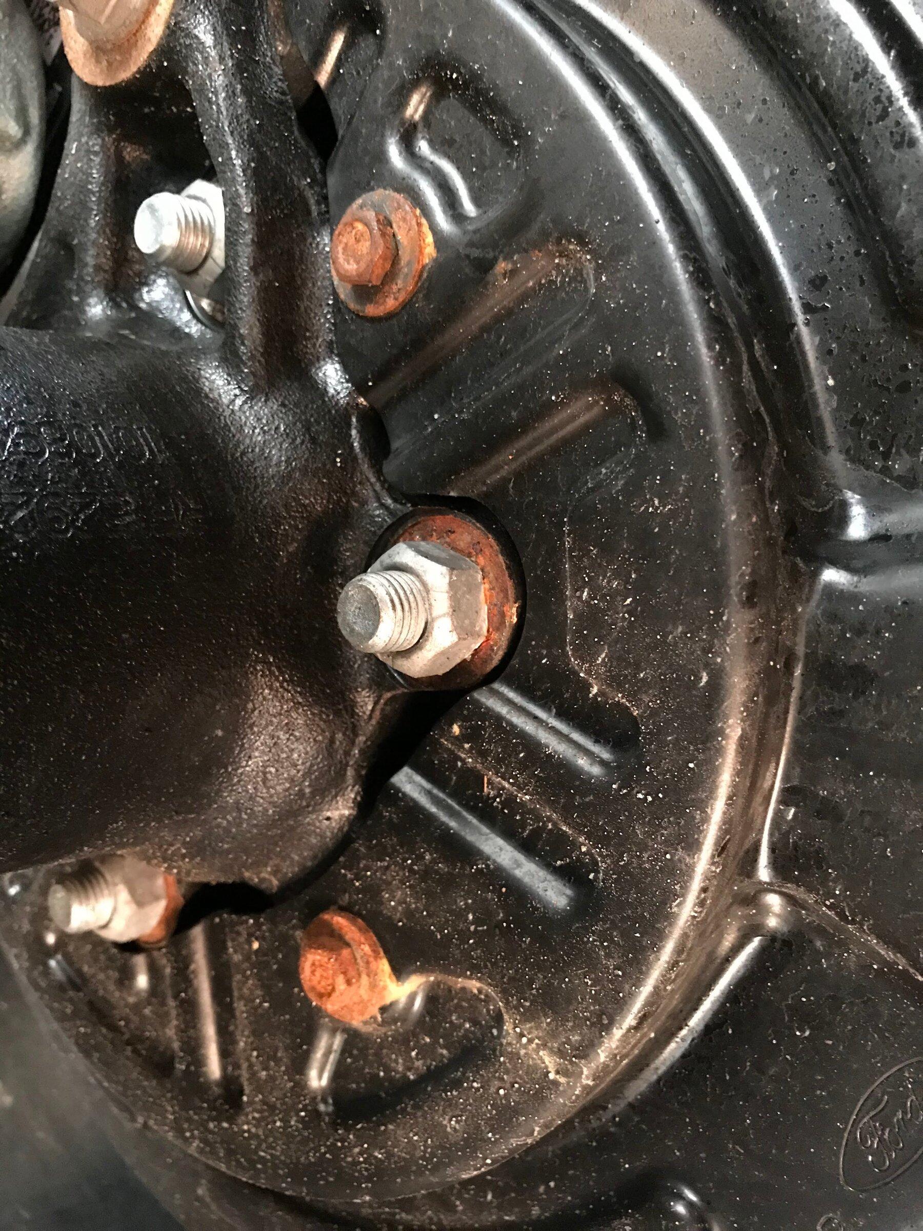

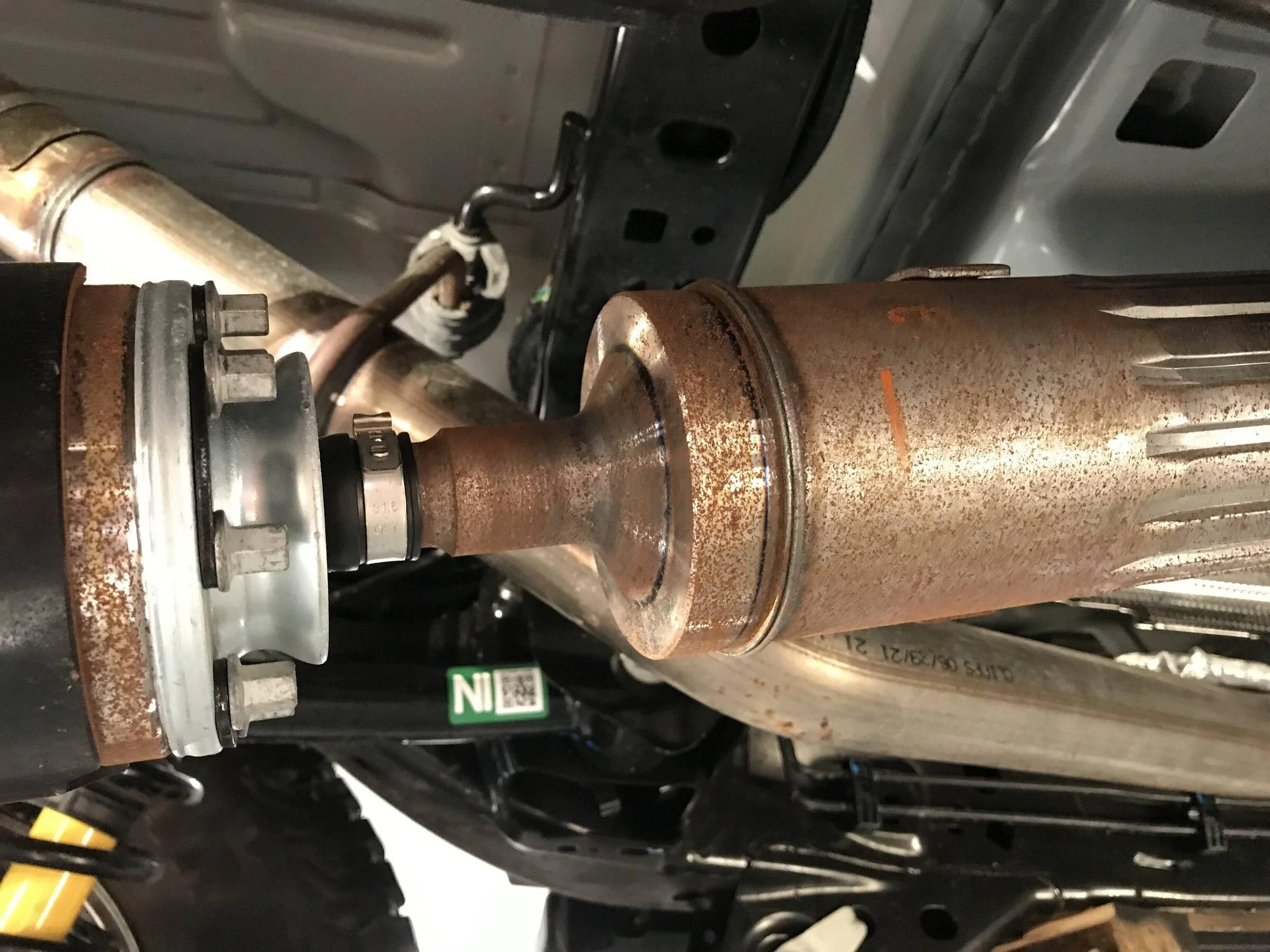

And here are some BEFORE pics (keep in mind this is from less that 2 weeks of ownership so it's obviously still in great shape overall and there is no rust on frame yet, but...):
Ford Bronco Professional rust proofing my Bronco - BEFORE/AFTER with pics and videos IMG_0127.JPG
Ford Bronco Professional rust proofing my Bronco - BEFORE/AFTER with pics and videos IMG_5485
Ford Bronco Professional rust proofing my Bronco - BEFORE/AFTER with pics and videos IMG_5486
Ford Bronco Professional rust proofing my Bronco - BEFORE/AFTER with pics and videos IMG_5488
Ford Bronco Professional rust proofing my Bronco - BEFORE/AFTER with pics and videos IMG_5538

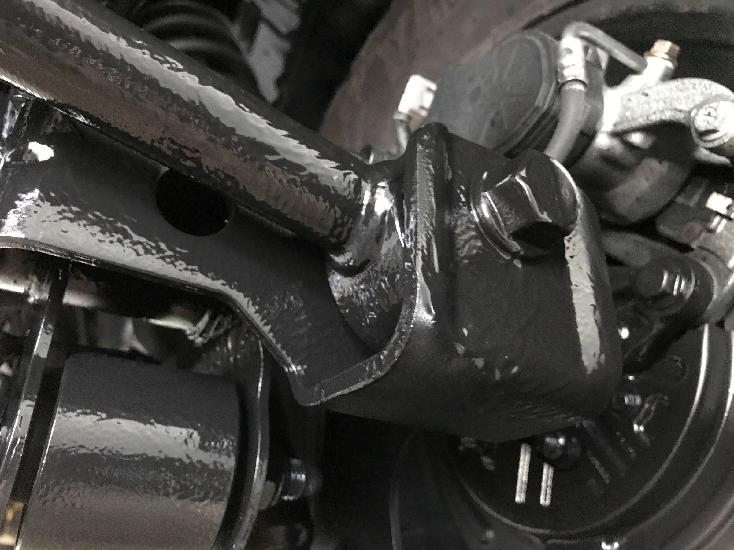

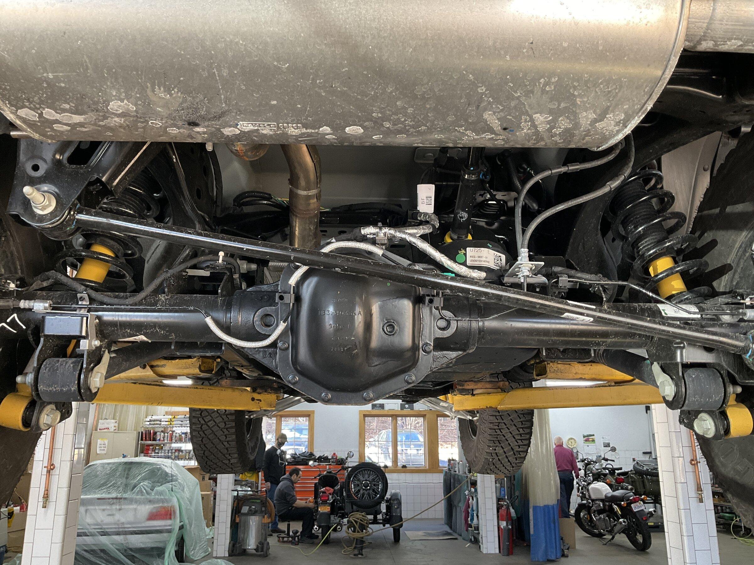

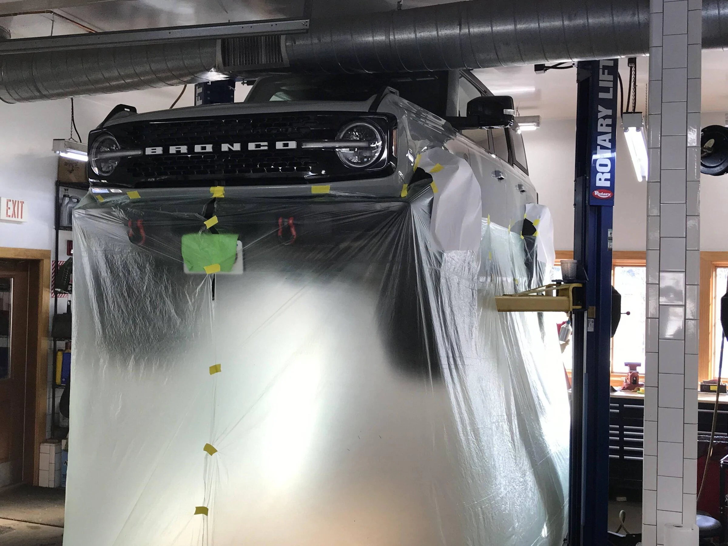

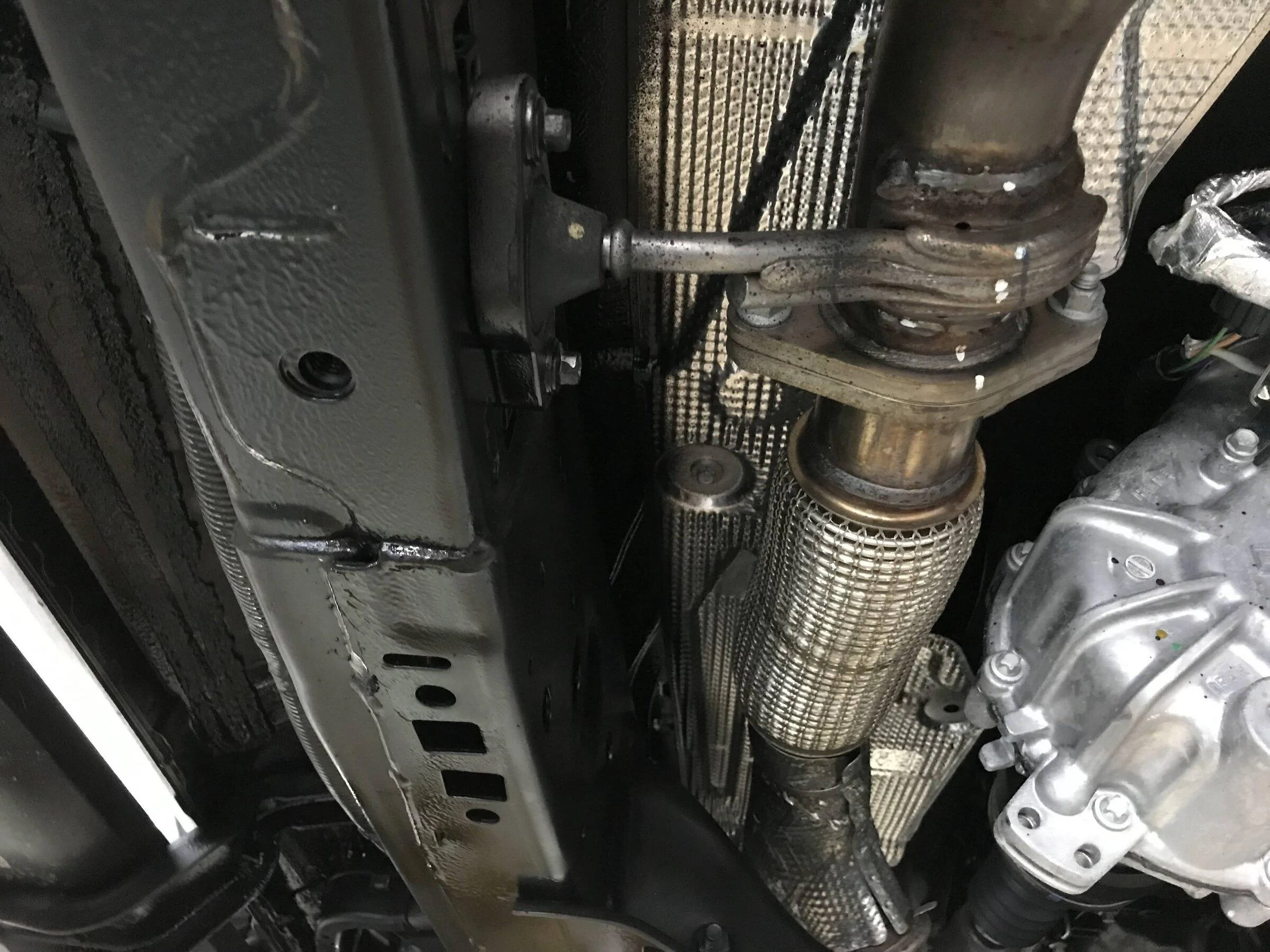

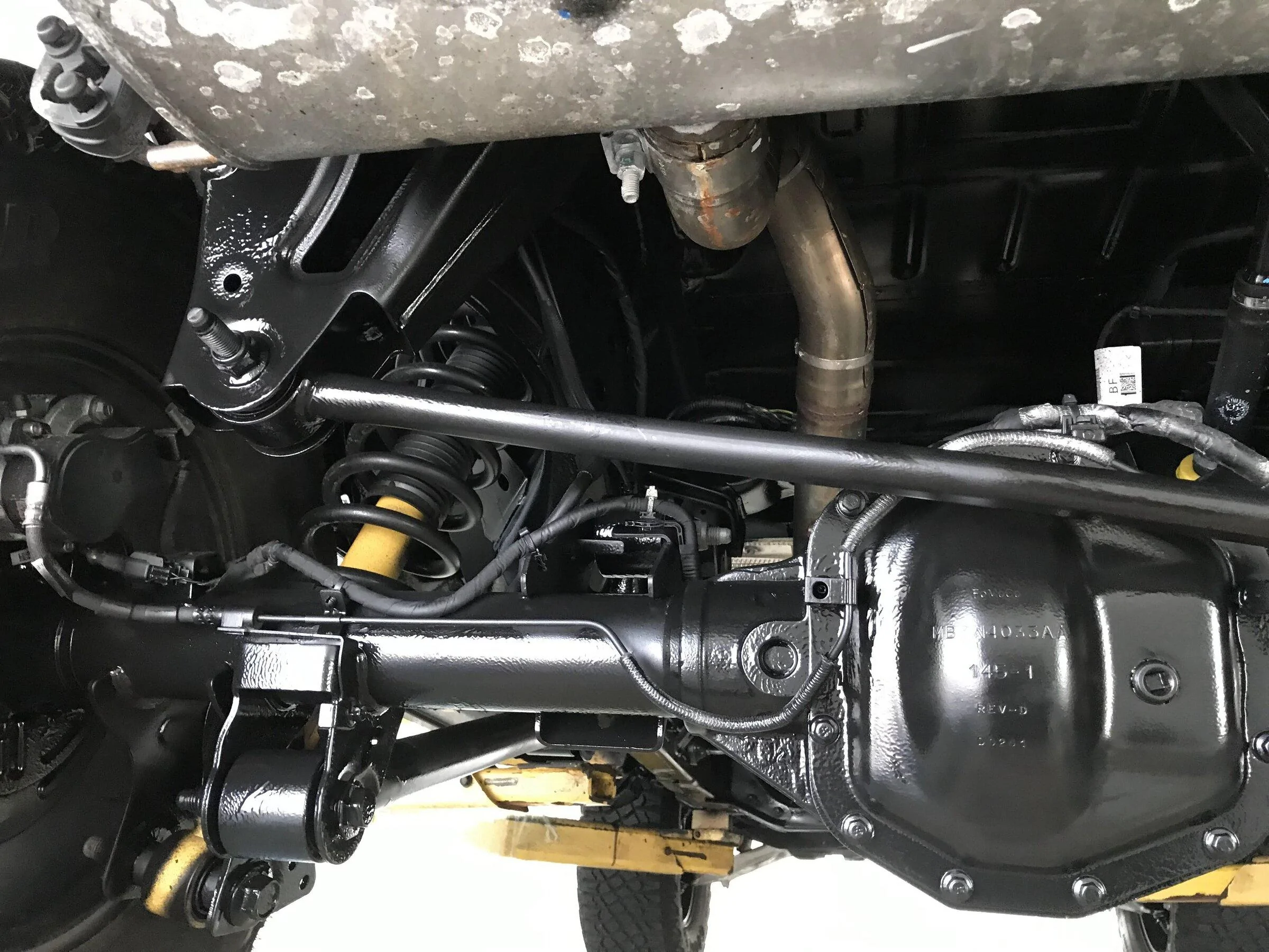

And here are some AFTER pics (between 3rd and 4th coats):
Ford Bronco Professional rust proofing my Bronco - BEFORE/AFTER with pics and videos IMG_5586
Ford Bronco Professional rust proofing my Bronco - BEFORE/AFTER with pics and videos IMG_5613
Ford Bronco Professional rust proofing my Bronco - BEFORE/AFTER with pics and videos IMG_5614
Ford Bronco Professional rust proofing my Bronco - BEFORE/AFTER with pics and videos IMG_5615
