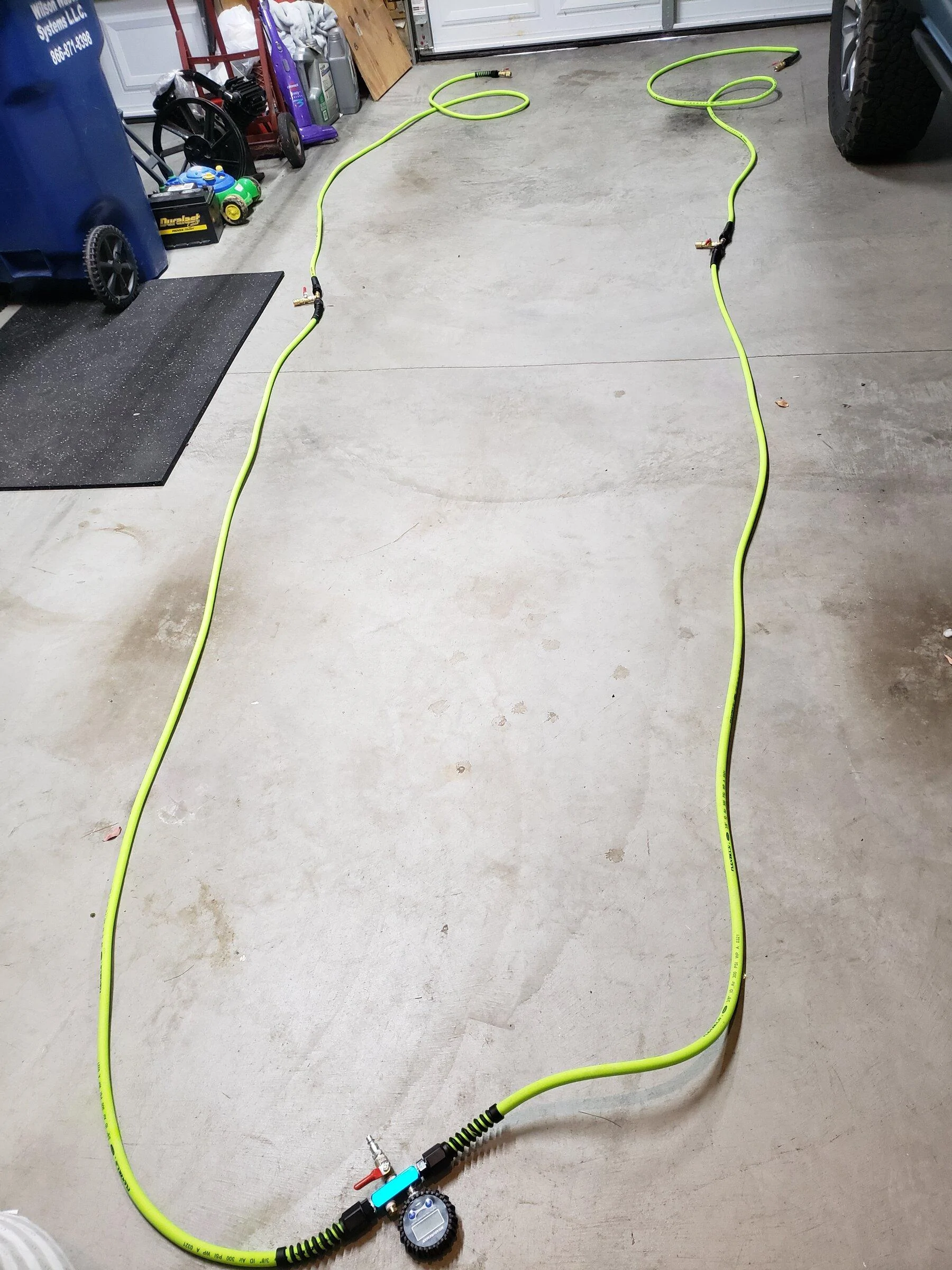

Made my own 4 tire inflator/deflator using flexzilla hose and ends.
I bought 50ft of 3/8 hose, 2 swivel ends and 4 regular ends. I used 2 Tee's, 5 ball valves, and 4 open air chucks. I found a generic manifold on Walmart's website and a measureman air guage.
Measured between the front and rear tire at the tread to give some lax wiggle room. Came up with 12ft 8in.
So lengths are working back to front.
12ft 8in rear tire to front tire.
10ft from front to manifold.
Leaving about 4ft extra that I will make into a short hose.
I put the swivel ends at the front tire connection to the line that goes to the manifold. since this will allow for the front tire to rotate and avoid some loop/tangle.
Layed out.

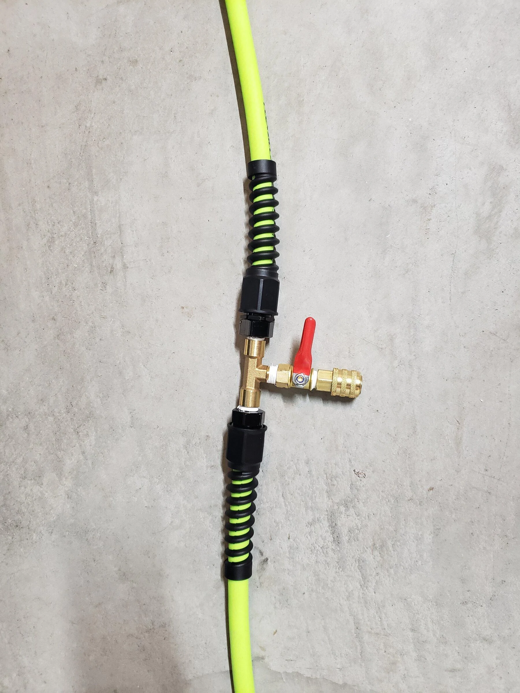

Front Tee

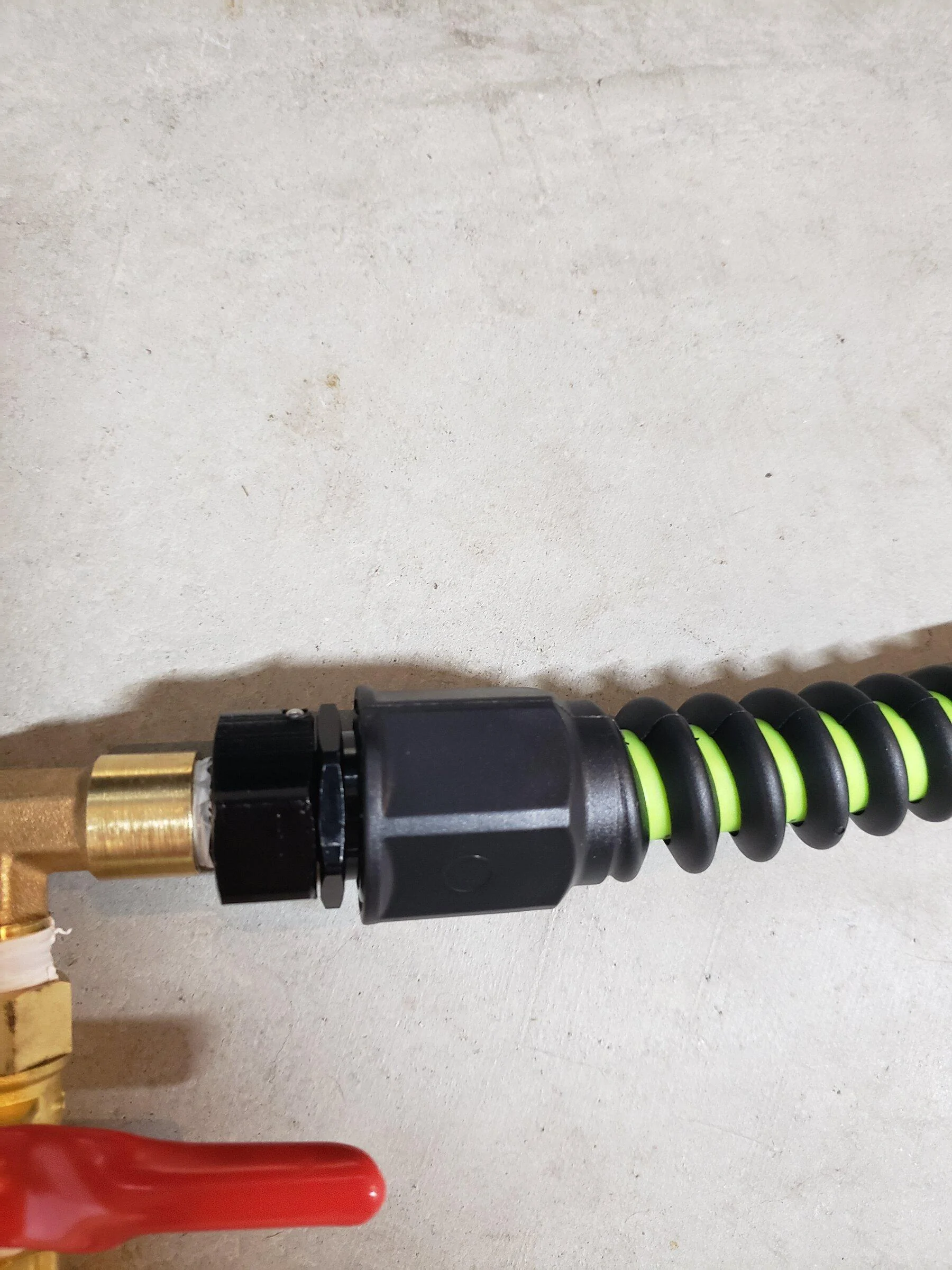

Swivel

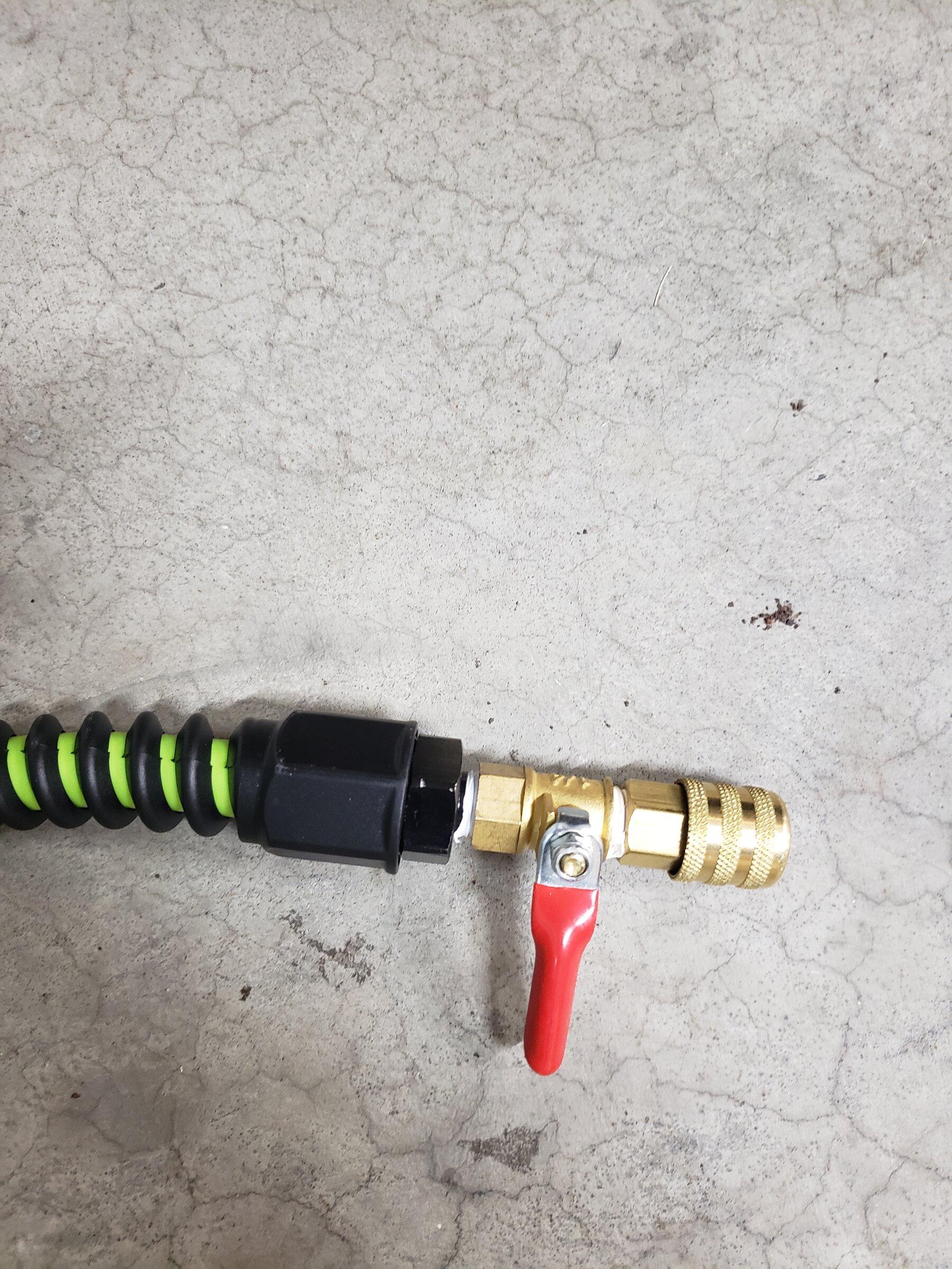

rear air chucks end

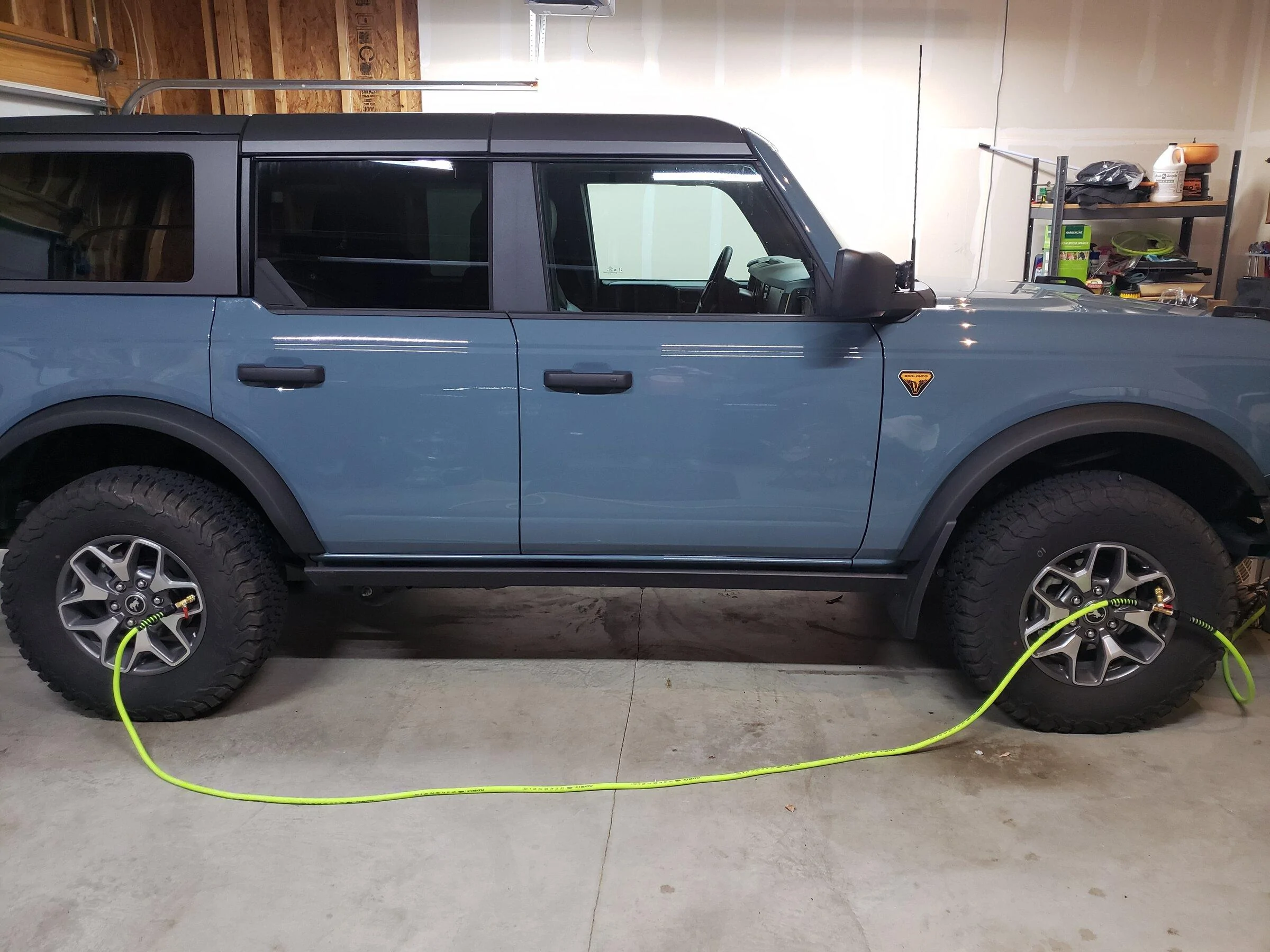

Passenger side hooked up

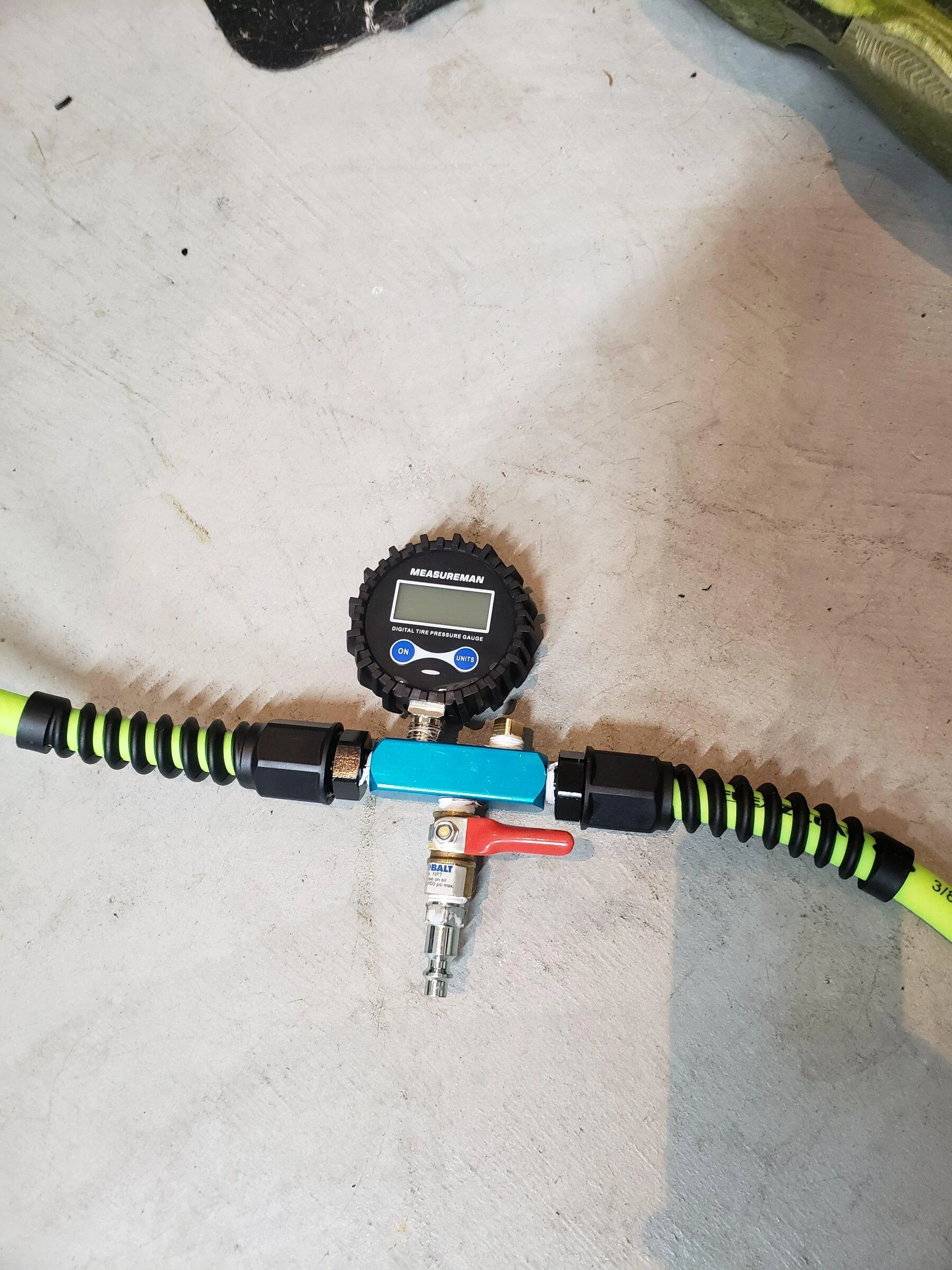

Manifold

I did not notice the "Closed" tire chucks until I got the "Open" ones I ordered and opened them. I would have ordered these closed ones vs the Open I ordered as it would save me the 4 ball valves. Not a huge deal.
Also I totally missed the fact when I ordered my Measureman that when I changed it to the long thread version it also set it to the 0-15psi instead of the 0-60psi. I have ordered a new one and why there is no tape and a LOT of threads showing. I installed it and it errored out right away live and learn...double check your order before submitting.
