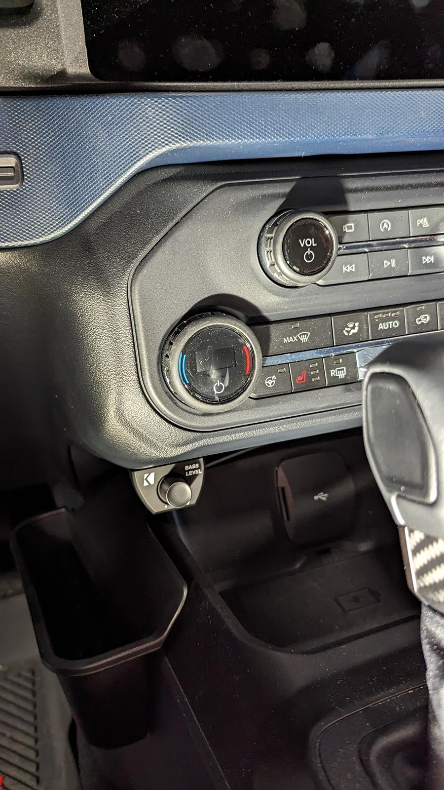

If you have to run power and ground to the amp anyway - the Kicker volume control knob should take literally 10 minutes to run during that process. I ran mine down the pass side under the glovebox/footwell carpet and behind the center console to the drivers side. very easy and more than enough cable with it unless you require a right angle adapter - but then that's easily sourced on Amazon as well. I used the 8" dual voice coil 4ohm also. I was originally not going to do the volume knob - but the varinces in recordings I have over the years in my stored music and using itunes/amazon/spotify is enough to drive you crazy - so I'm glad I did.

Without the volume knob, the only ability you have to control subwoofer output is to manually adjust the setting on the amp - which will need access to the amp, or to adjust the Bass EQ setting in Sync - And that will kill all bass to everything in the system, not just the subwoofer.

@Johnny Mo @Brian_B Thanks for the help. Looks like I need to install the Kicker AMP Bass Level control knob and run the wiring. Seems an easy add for the added functionality. I have one in my boat and agree it makes life easy listening to all the different bass levels from my recordings. I'm just used to my other cars having a separate sub-level controller software slider...
