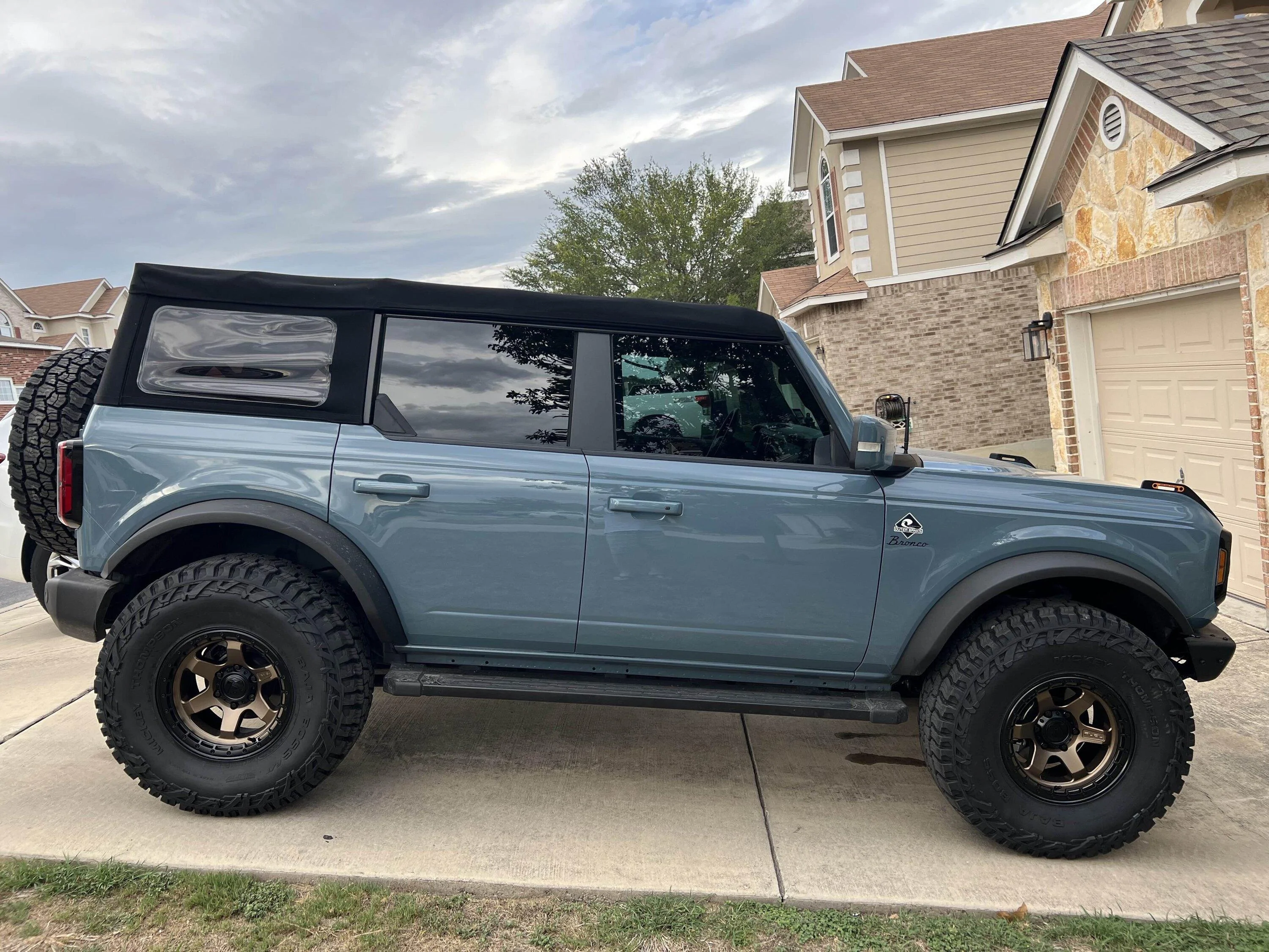

So ended up going different route than the items listed above. After doing some more research, I settle on Zone 2" Lift Kit for Badlands/Sasquatch. There are several threads in the forums on this kit, I liked it because it doesn't interfere with the Factory Ride Quality and designed to work within operating limits of the factory UCA's. I even had the guys at my local 4WheelParts store confirm this upon installation. Below is the site I bought the kit from, not really expensive at all. Installation on the labor was around $600. I put 37" Mickey Thompson tires and I only get very slight rub when I back out of driveway (I have a steep angle). I could probably eliminate completely if I added a spacer as I'm about 1+ Offset right now.
https://www.cjponyparts.com/zone-of...Confirmation&utm_medium=Email&utm_source=Pony
Here is photo of my Bronco after the lift install:
Ford Bronco 2022 OBX Sasquatch Lift Question 2022OBXAfterLift
