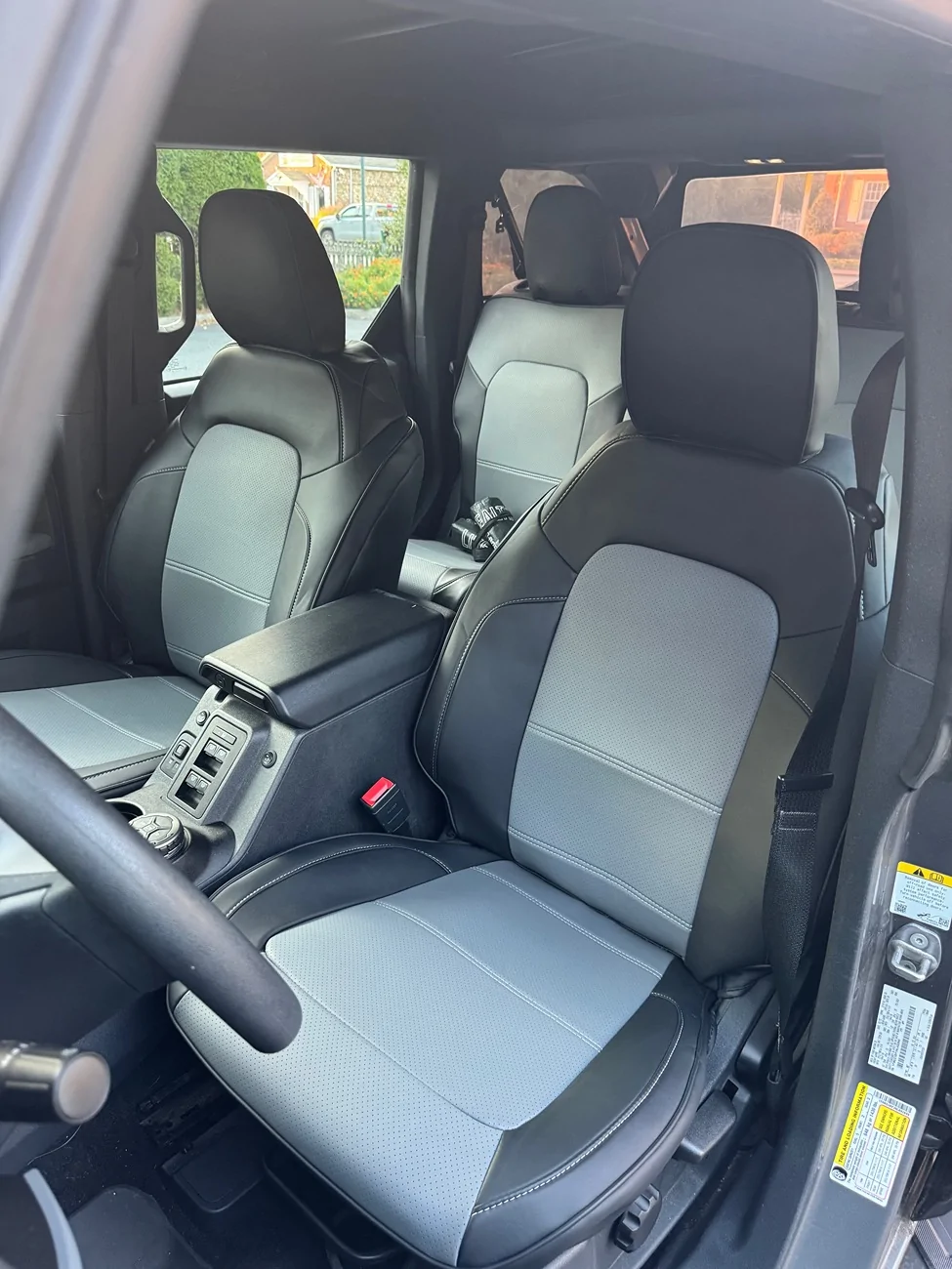

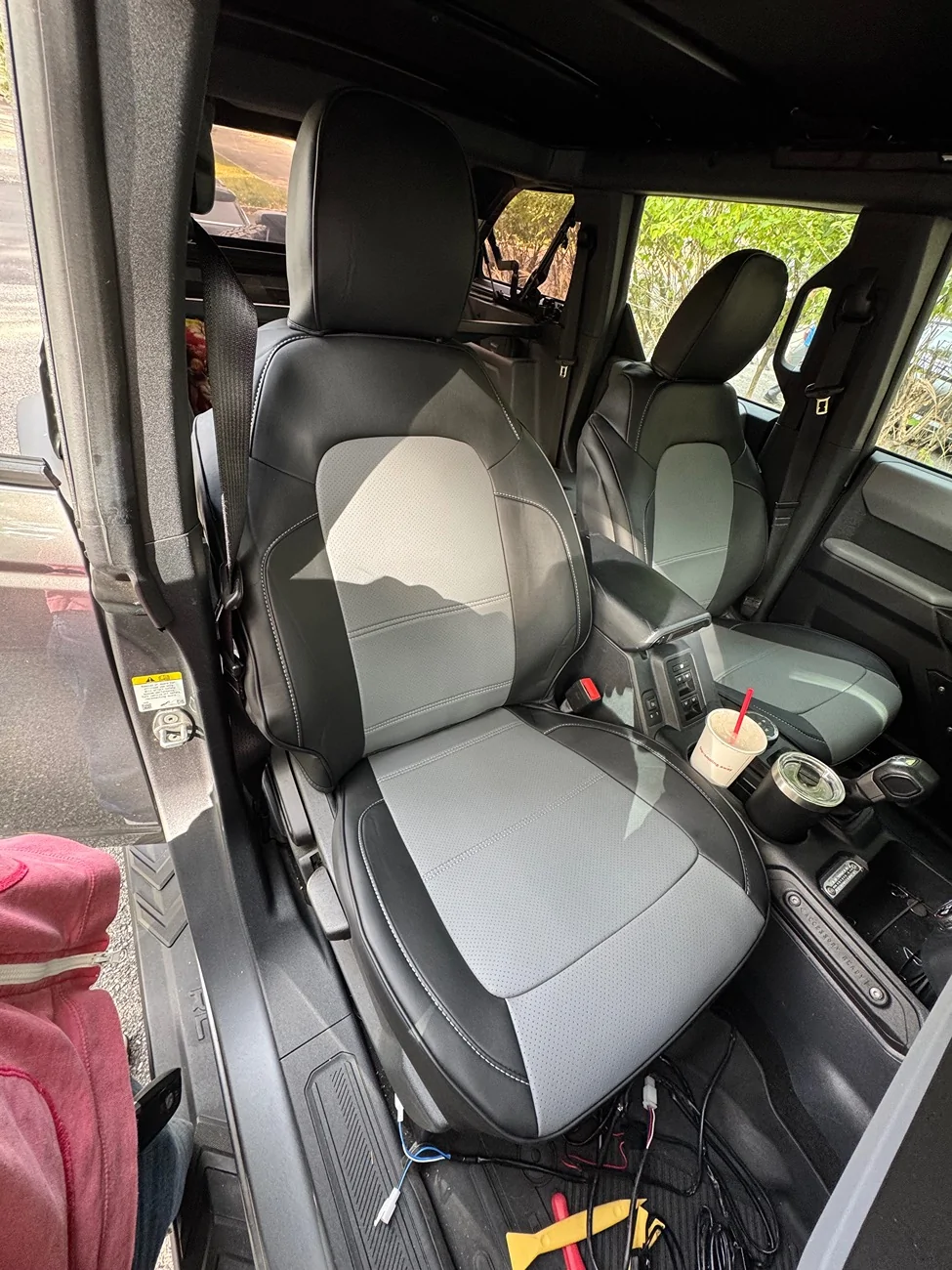

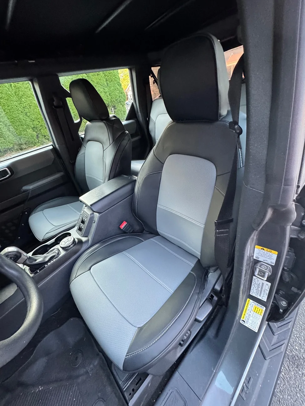

Extremely happy with the seat heat kit and covers. Need extra tape for heating pads (over old cloth seats) and the covers are a little time consuming. I put in dryer on low heat for 10 min - helped.

Are those the stock seat covers?
Any pics of the heat elements on the seats before the seat covers went on?
How were they fastened?
Can you feel them through the covers?

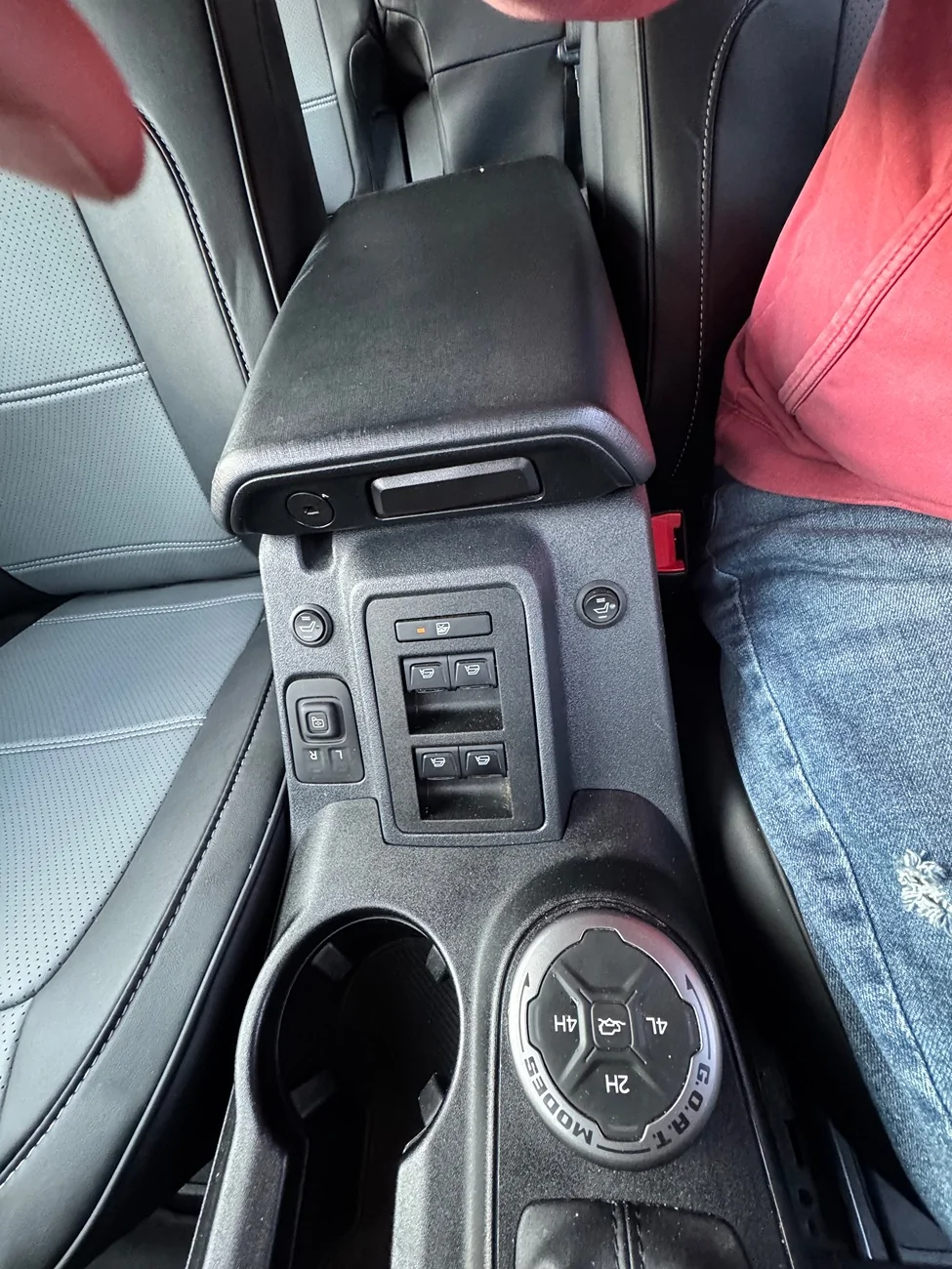

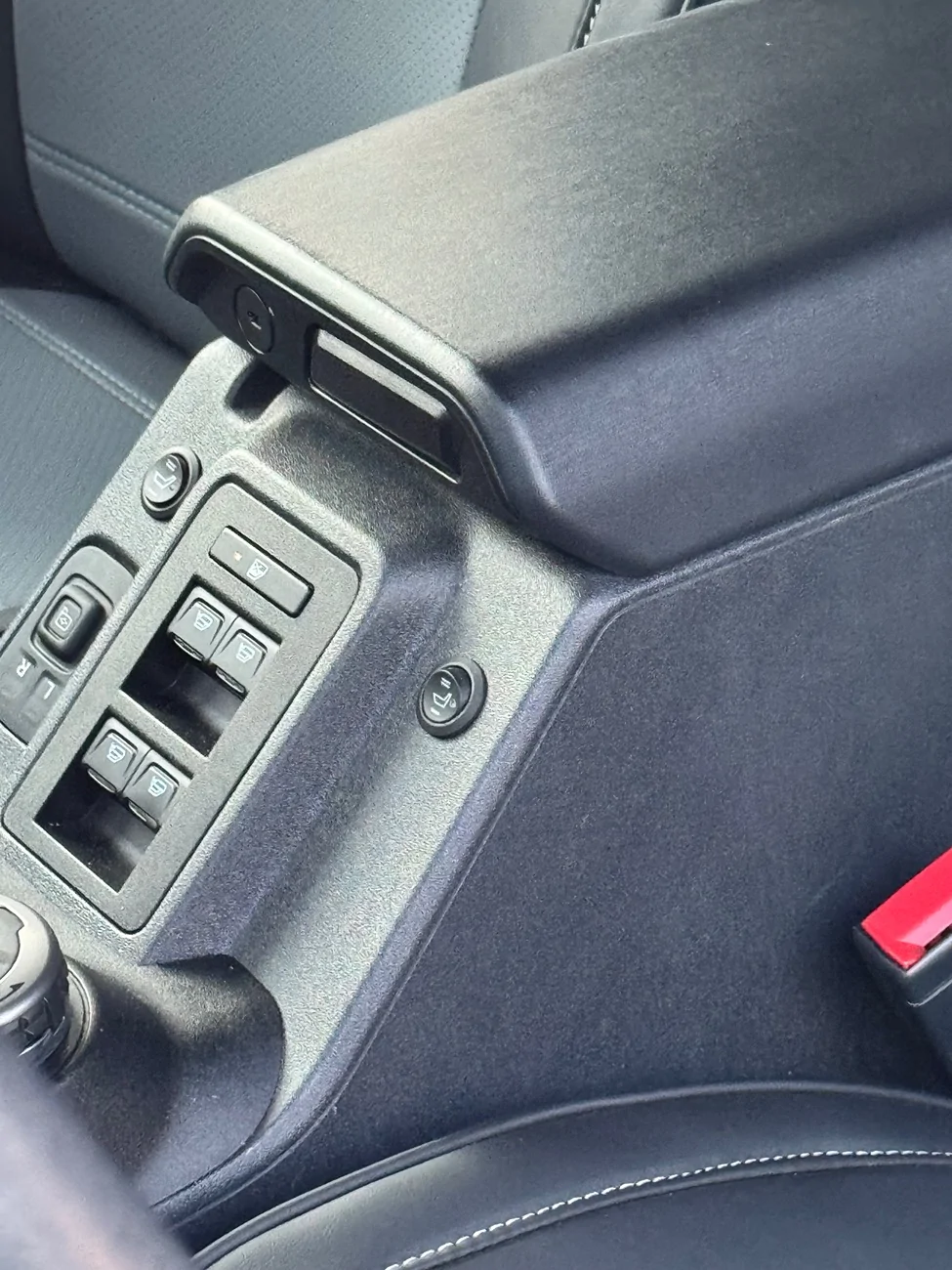

Nice....I'm in the process of doing this. I attached the elements to the seat covers and installed them. I haven't wired them up yet. I just keep pushing it off. Guess I dread drilling into the center console.
I assume you just popped the top of the shifter console up to connect everything and run the wires to the fuse box.
  • The seat covers are a standard out of the box option from Amazon - link is in the post
  • The original seats were black and grey cloth
  • The heating elements have double sided tape and I added duct tape around the edges
  • The seat covers are tedious but easy - if you go to the amazon product link there is a video but basically the backs have a side zipper and slide over and tie in with some straps. The seat bottoms slide on and have straps and bands underneath too
  • You can feel the heat, even on low setting.
Did not have to pop the shifter console. Pry out the window switch, there is a ton of room in there. If you push seats forwards, you can easily pry up the bottom rear of the center console down by the floor and use your hand to push connectors trough and connect under the seat. For power, I came of the panel under dash and simply worked across under the dash and you can just use your fingers to push under center console and then up into the cavity where window switches go.
drilling the console was stressful. The switches were about 3/4". I used a step drill and went to 13/16 and then used a dremel to take some raised areas of the switch barrel (it is keyed). I used a metal rule to go up 9.5mm from the bottom and 2.5cm from edge of the hole where window switches go towards the doors.
